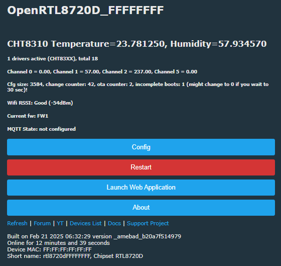

    I can pull PA12/13/14 high and low to control onboard BRG SMD LED. I think on this variant it's:
    Added after 42 [minutes]:
    SHT30 i2c detected
    CHT8310
    Screenshot of OpenRTL8720D interface displaying temperature, humidity, and network configuration information.

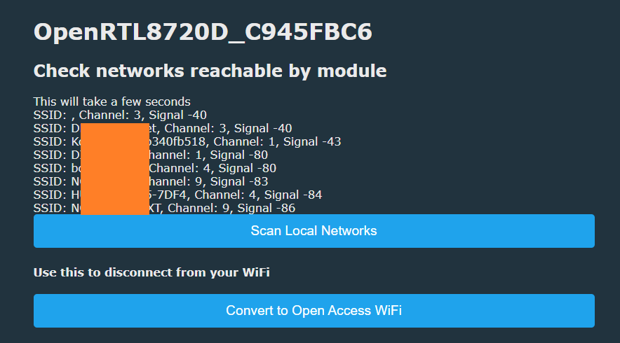

    Several new features: wifi scanning (all realtek), mac address change (AmebaD only), connecting to WPA3 networks.
    Mac is written in easyflash, not in efuse. To reset it to original easyflash 'partition' has to be wiped.
    Need to test scanning on Z/Z2, because instead of AP mode it now starts in STA_AP mode. When i started implementing scan, ap showed up and i connected to it, but i couldn't get ip, and uart log showed dhcp assigning every ~10 seconds. And while i fixed it on D, i don't know if it's not broken on Z/Z2 (but it shouldn't).
    @divadiow my bw16 is with proper mac address, begins with 94:C9:60 (Zhongshan B&T technology.co.,ltd). Is BW16E somehow special, or oem only?
    Another sad thing is WBRG1 doesn't have a 5G antenna. I can see 5G networks on BW16, but not on WBRG1.
    And it seems i can't perform OTA on my BW16. Flash is so slow, that i get ERR_CONNECTION_RESET before it is erased (~20 sec).

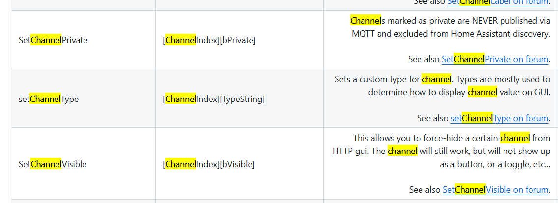

    @p.kaczmarek2 Is there a way to mark a channel as internal? Meaning it wouldn't show on main page or HA discovery.
    I would like to hide the zigbee led, since it isn't meant to be manually controlled.

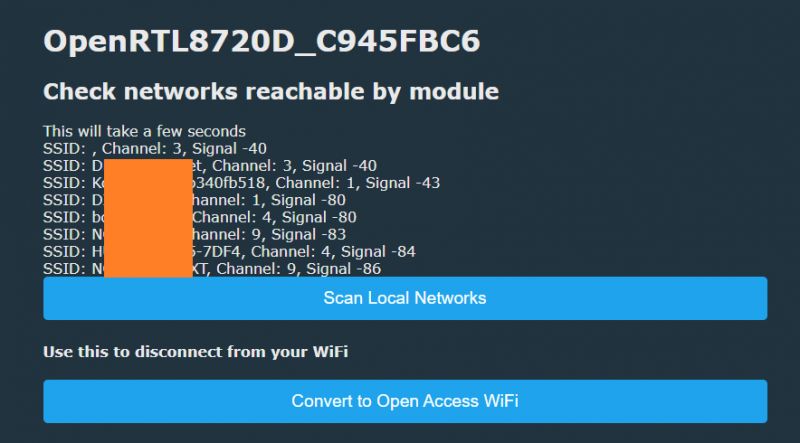

  • #254 21452827
    There are two commands for that:
    Table of channel settings with highlighted Channel words.
    I'll try to check latest on RTL soon
  • #256 21452893
    Built on Feb 23 2025 13:45:12 version _amebad_66090d778957
    Online for 1 minutes and 46 seconds
    Device MAC: 38:A5:C9:45:FB:C6
    Short name: rtl8720dC945FBC6, Chipset RTL8720D
    Screenshot of a network interface showing a list of available Wi-Fi networks with options to scan and convert Wi-Fi.
    NTP driver ok, can you enable SSDP? It requires this IGMP flag in Lwip, do you know which?

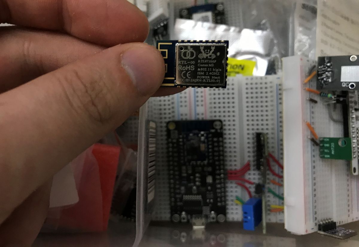

    I have this module - RTL8710AF:
    Electronic module held in hand against a breadboard with components in the background.
  • #257 21452931

    RTL8710AF is no good, no xip means everything is loaded into ram. And there is only 512kb. I initially tried to compile for it - something overflowed by about 200kb. So only RTL8195 and RTL8711AM is supported.

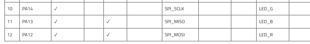

    Code: Text Expand Select all Copy to clipboardLED_R PA13
    LED_B PA12
    LED_G PA14
    wrong (for NiceMCU_8720_V1),
    red P12
    green P13
    blue P14
    set all 3 to AlwaysHigh and they're all off. Pull each low in turn in GPIO dr and they light as per above colours to pin. PWM obviously not an option in main GUI for PA14. Testing on BW16E
    but I get that PWM is not ticked in the function table for PA14, so not sure what this means
    Excerpt from a table showing GPIO ports with pins, SPI functions, and LED colors.
    Added after 6 [minutes]:
    it's not a PWM LED? lol. just low/high

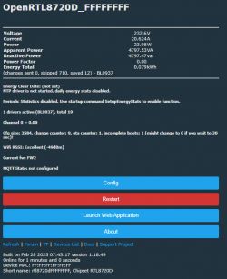

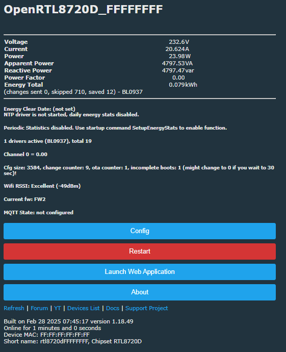

    probably a rubbish test and maybe you've already tried BL0937 properly to satisfaction, but here's BL0937 using Arduino/ESP/PWM sketch on ESP32-WROOM-32 to simulate CF, CF1 and SEL
    Screenshot of the OpenRTL8720D interface with energy and status data.
  • #269 21460867
    This is a good idea for testing BL0937 without a physical BL0937 device.
    By the way, couldn't we move interrupt on change counter to HAL and introduce new pin role - Counter? I was something similar in Tasmota.

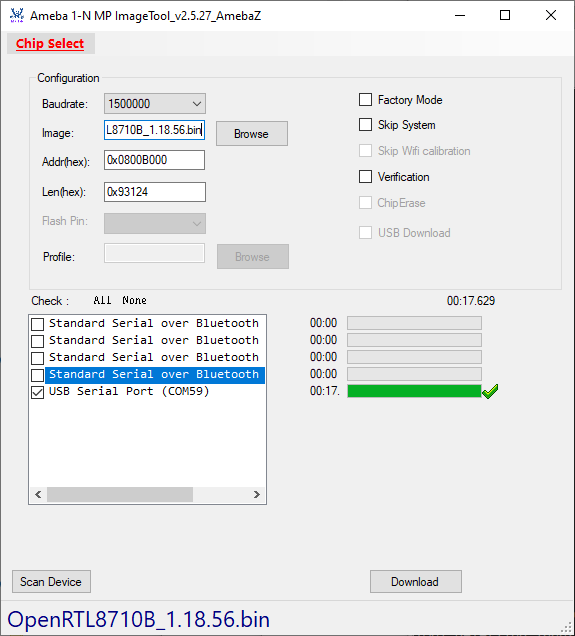

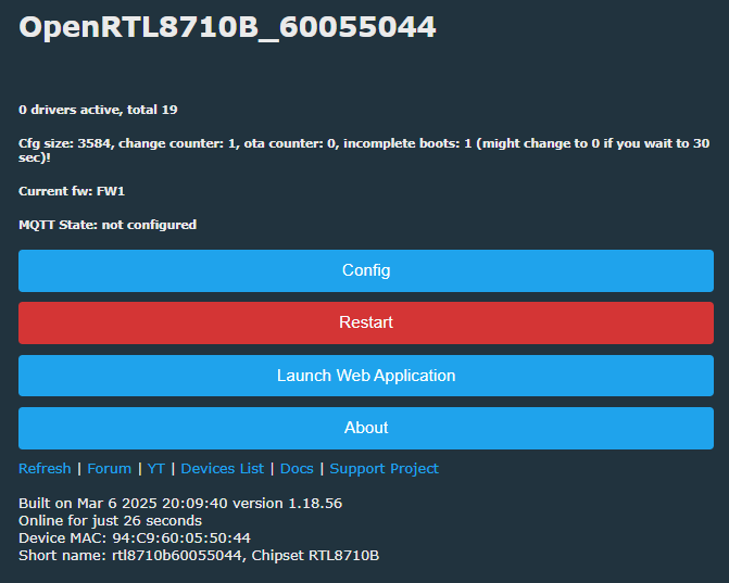

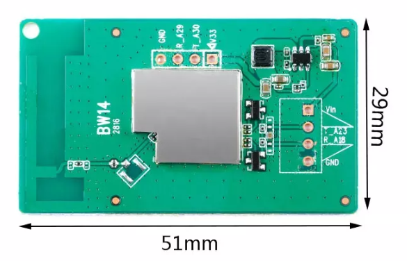

    for no reason I added a 2mb Ai-Thinker B&T BW14 RTL8710BX module to an order of things from China
    Small green printed circuit board with electronic markings.
    Ai-Thinker_B&T_BW14_v2.4.3(v4.0c).bin in flashdumps.
    Screenshot of Ameba 1-N MP ImageTool v2.5.27 software during configuration and USB serial port selection. Screenshot of the OpenRTL8710B_60055044 software interface displaying system information.
