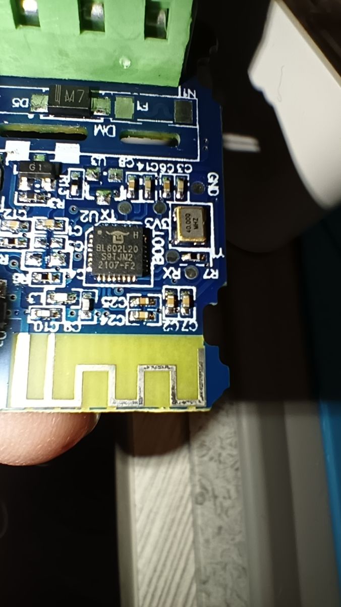

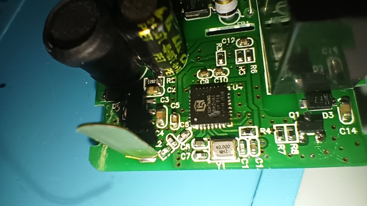

    xakercdcom
    >>21811084
    The hole in the controller can't be fixed, and you can't buy a separate microchip on AliExpress. I also have a BL602 relay that I also burned out with my experiments, and they don't sell microchips for it either.
    Close-up of green PCB with microcontroller, capacitors, and surface-mount components.
    Close-up of electronic module with BL602L20 chip and PCB antenna
