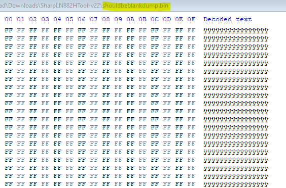

    v22
    Dumps
    115200 - 184.0506484s
    460800 - 47.5169445s
    921600 - 24.772409s
    1500000 - 184.050883s
    had to keep A9 low now because post-dump reset would bring up AP and a few bytes would change in between dumps
    brb the rest of tests
    Added after 3 [hours] 4 [minutes]:
    erase
    [Youtube] LN882H module pinout and setup for flashing - step by step video guide
    write to blank (write fixed at 921600?)
    OpenLN AP comes up as normal
    Added after 8 [minutes]:
    flash of Tuya backup to erased flash
    SmartLife AP seen and pairs in Tuya app.

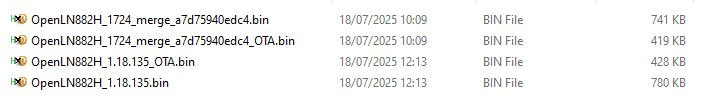

    I managed to create a terminal version with fast dumping, but changing the baudrate in code doesn't work for some reason. If changed manually in terminal, it works fine.
    Binary attached. Protocol is the same, 512 bytes of flash + 2 bytes crc.
    fdump [addr] [size]
    Delay before read output is about 2 seconds
    Writing/erase should work as well.
    https://github.com/NonPIayerCharacter/OpenLN882H/tree/_ramcode
    • ramcode_ln882h.bin (14.93 KB) You must be logged in to download this attachment.

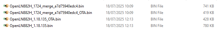

    [postid:7bfc69fcbe][/postid:7bfc69fcbe]
    Nothing really major. We had v2.1_rc1, this one is v2.1_rc5.
    Wifi libs update, pvPortRealloc, pwm demo update (perhaps it will be possible to use original driver, instead of my reimplementation) etc.
    Plus i enabled -Os, so binary should be lighter.
    In v2.1_rc2 "Enhance the robustness of WiFi retransmission in extreme interference environment"
    It still need to be tested. Or if it even boots. I enabled test commands in https://github.com/openshwprojects/OpenBK7231T_App/pull/1724

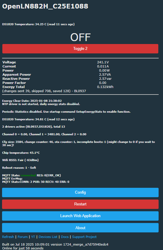

    We don't "have" ADC in OBK.
    In code, we use ADC channel 0. The one used for internal temperature and wifi calibration. For everything.
    Added after 12 [minutes]:
    It boots. Version is 1724_merge_a7d75940edc4
    All tests are successful.

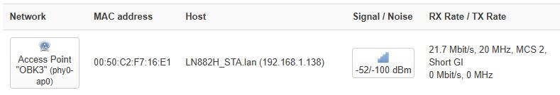

    ok. firstly, initial boot:
    Success joining WPA-SAE (CCMP) AP
    When AP is disabled, disconnecting OpenLN, LN constantly scans and displays all nearby APs over and over. Upon AP re-enable it connects again very quickly.
    Network UI showing connection details to AP OBK3 by device LN882H_STA.lan
    In WPA2-only and then in WPA2/WPA3 the behaviour is the same for successful connection and then scanning and re-connect after AP disappears.
    Feels like a big success.

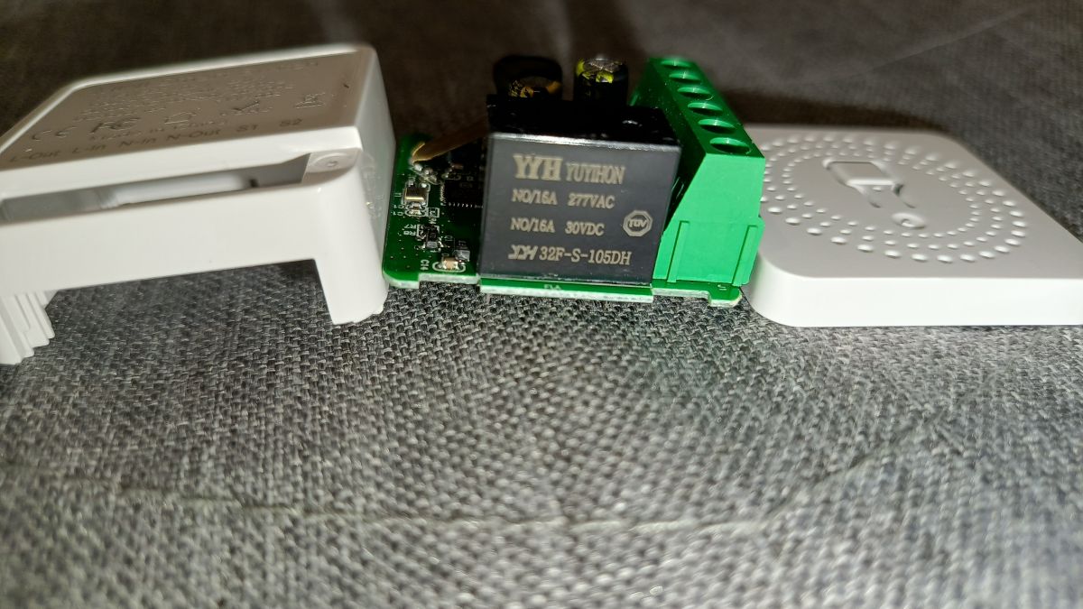

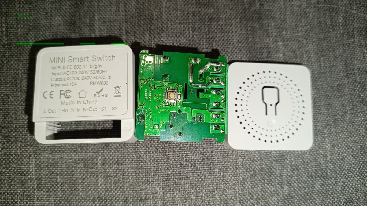

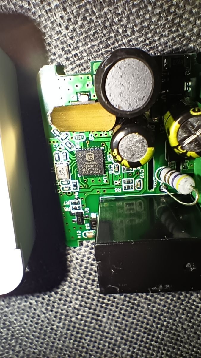

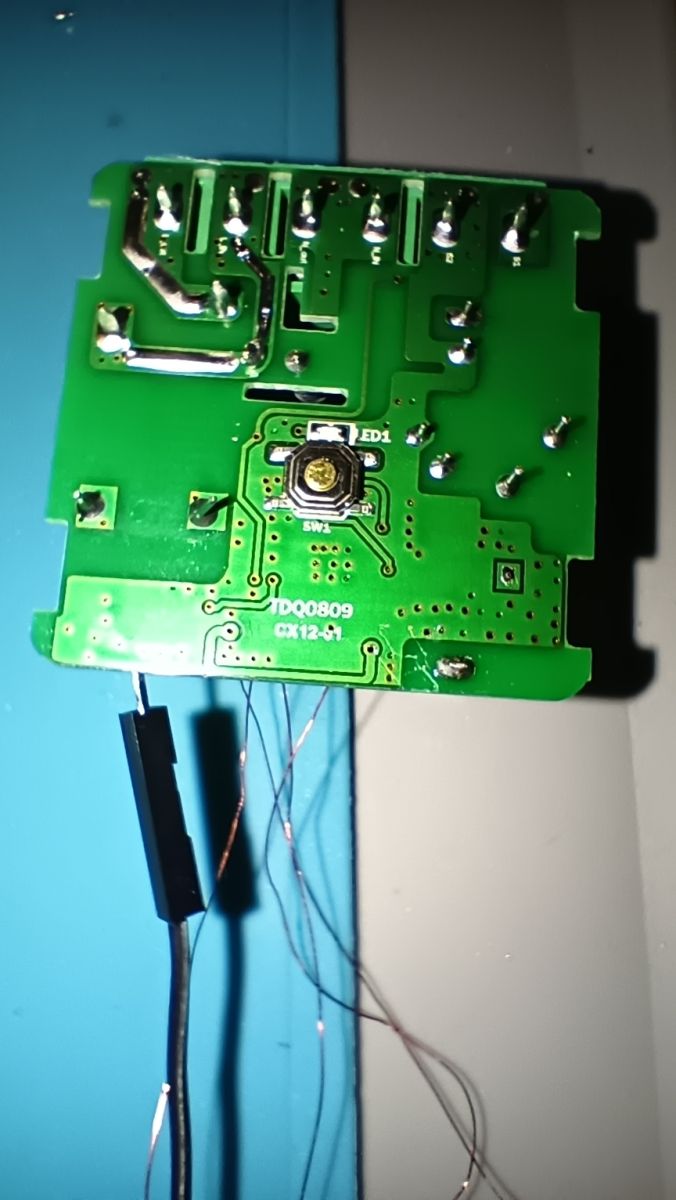

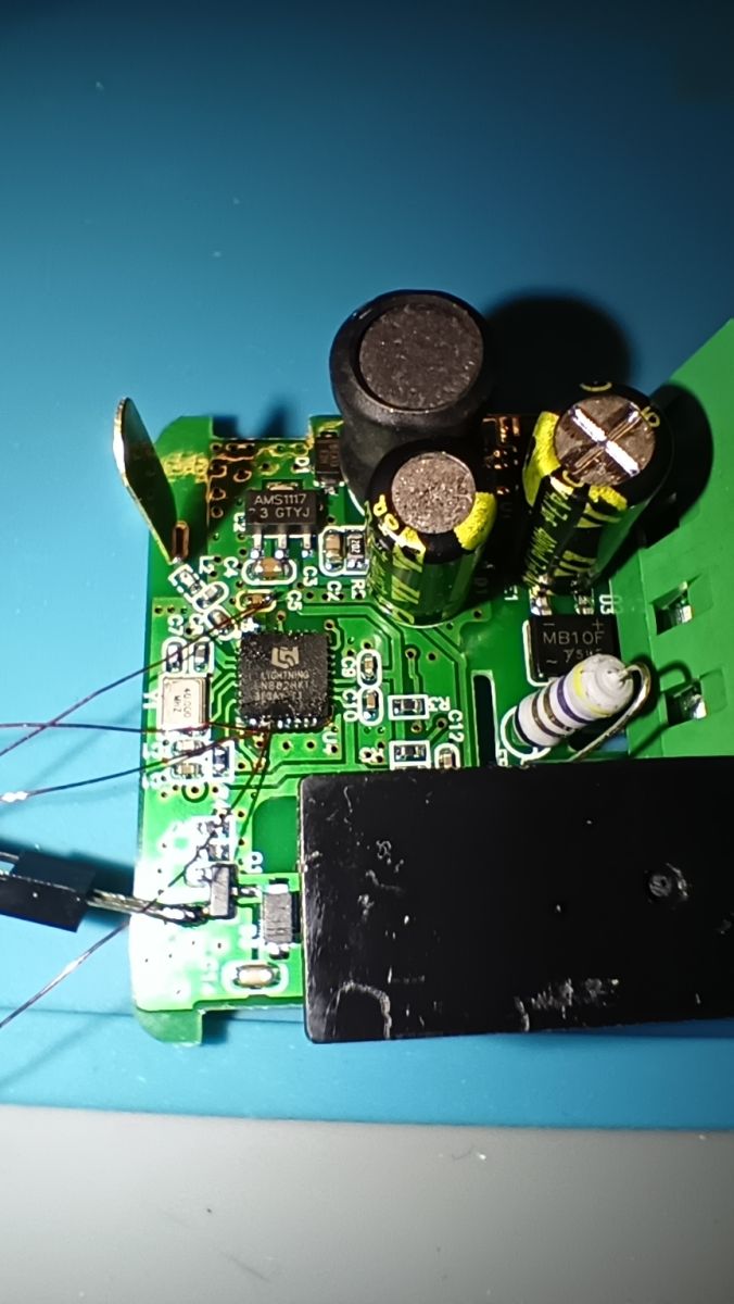

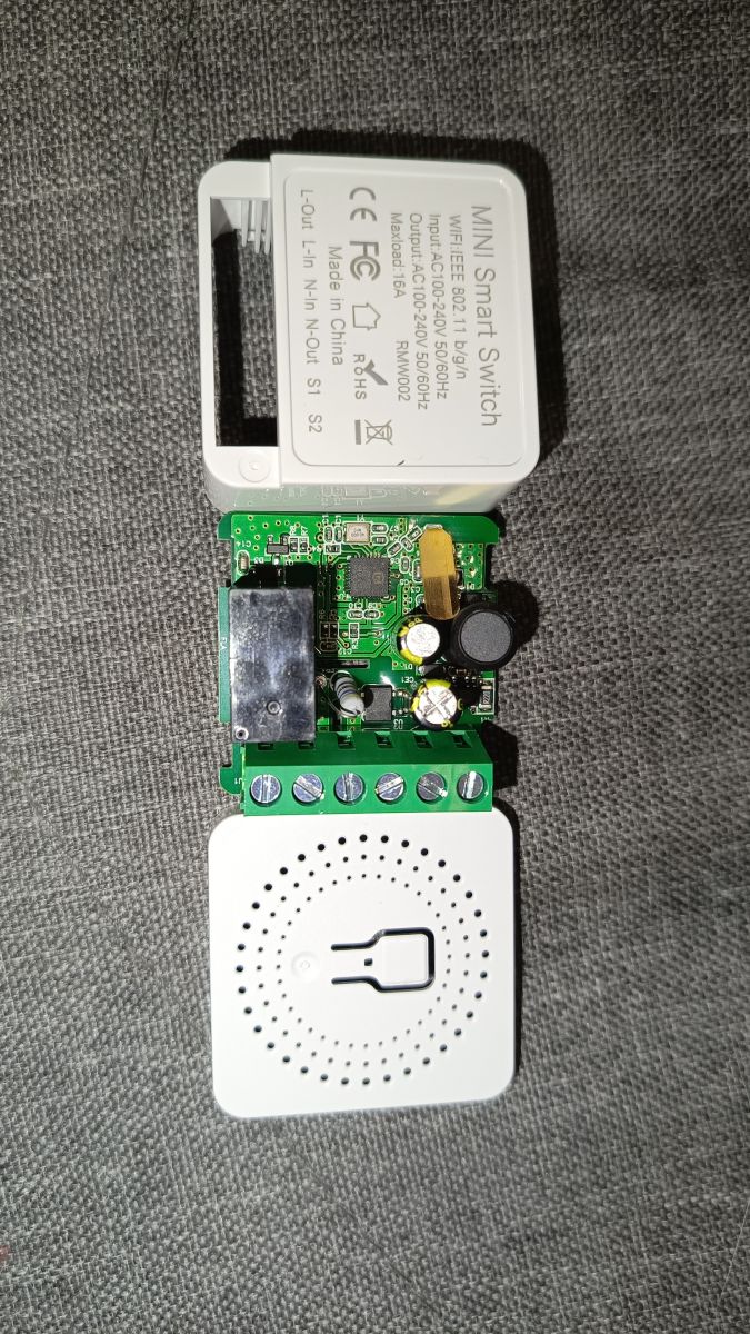

  • #177 21810978
    xakercdcom
    Hi, I flashed your firmware, but the relay isn't working. It only works through Cozylife; I wanted it to work through Tuya
    Spoiler:
    Close-up of PCB with capacitors, relay, and LNB82FKL microchip Disassembled mini Wi-Fi smart switch with visible PCB on fabric background. Yuthon relay module with green terminals and opened white casing Disassembled mini smart WiFi switch with visible PCB and casing parts Printed circuit board with capacitors, microchip, and fine wires for measurement. Close-up of a green PCB with tracks, solder points, and connected wires.
    • readResult_LN882H_1_2026-16-1-21-18-13.bin (2 MB) You must be logged in to download this attachment.

    xakercdcom
    >>21811035
    P1 (RXD2)
    Rel
    Ch:
    62
    It's the relay itself. I didn't have time to check the buttons and LED; it accidentally shorted out and ruined the controller.
  • #180 21811084
    Posts: 14591
    Help: 654
    Rate: 12612
    What was shorted? Maybe it's recoverable.
