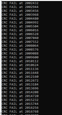

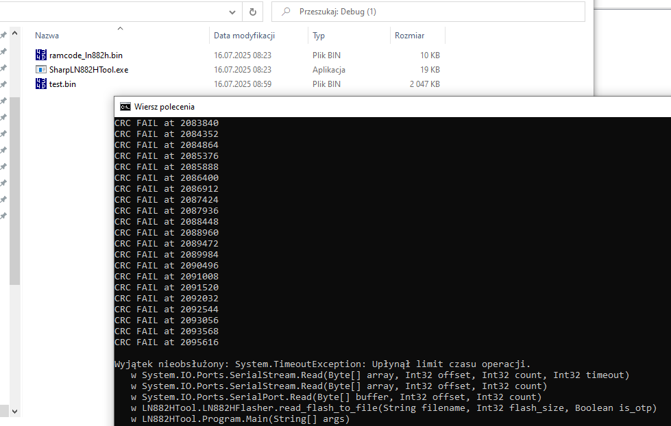

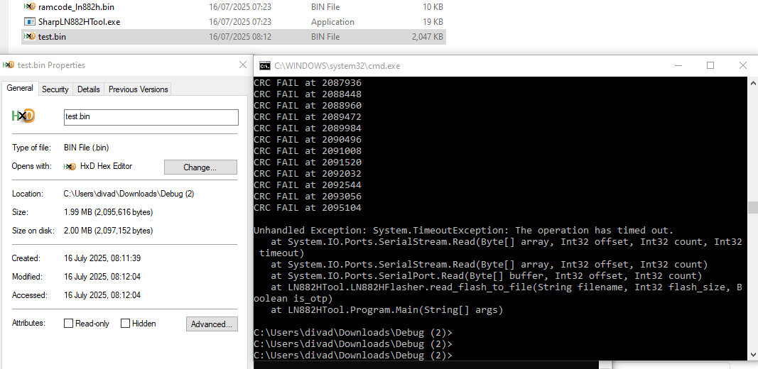

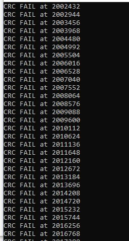

    I am not sure if I tested that, but here is a run of your binary:
    [Youtube] LN882H module pinout and setup for flashing - step by step video guide
    but binary looks correct in the end

    >>21608214
    If CRF FAIL - then it is for sure incorrect. And even final binary size is 2047kb, not 2048.

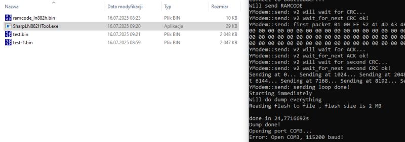

    Strange, it works fine for me.
    Version with 921600 baud and integrated ramcode
    • SharpLN882HTool.exe (29 KB) You must be logged in to download this attachment.
  • #137 21608238
    Posts: 14591
    Help: 654
    Rate: 12612

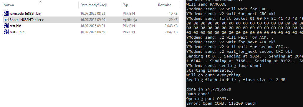

  • #138 21608239
    Posts: 5039
    Help: 438
    Rate: 891
    >>21608233
