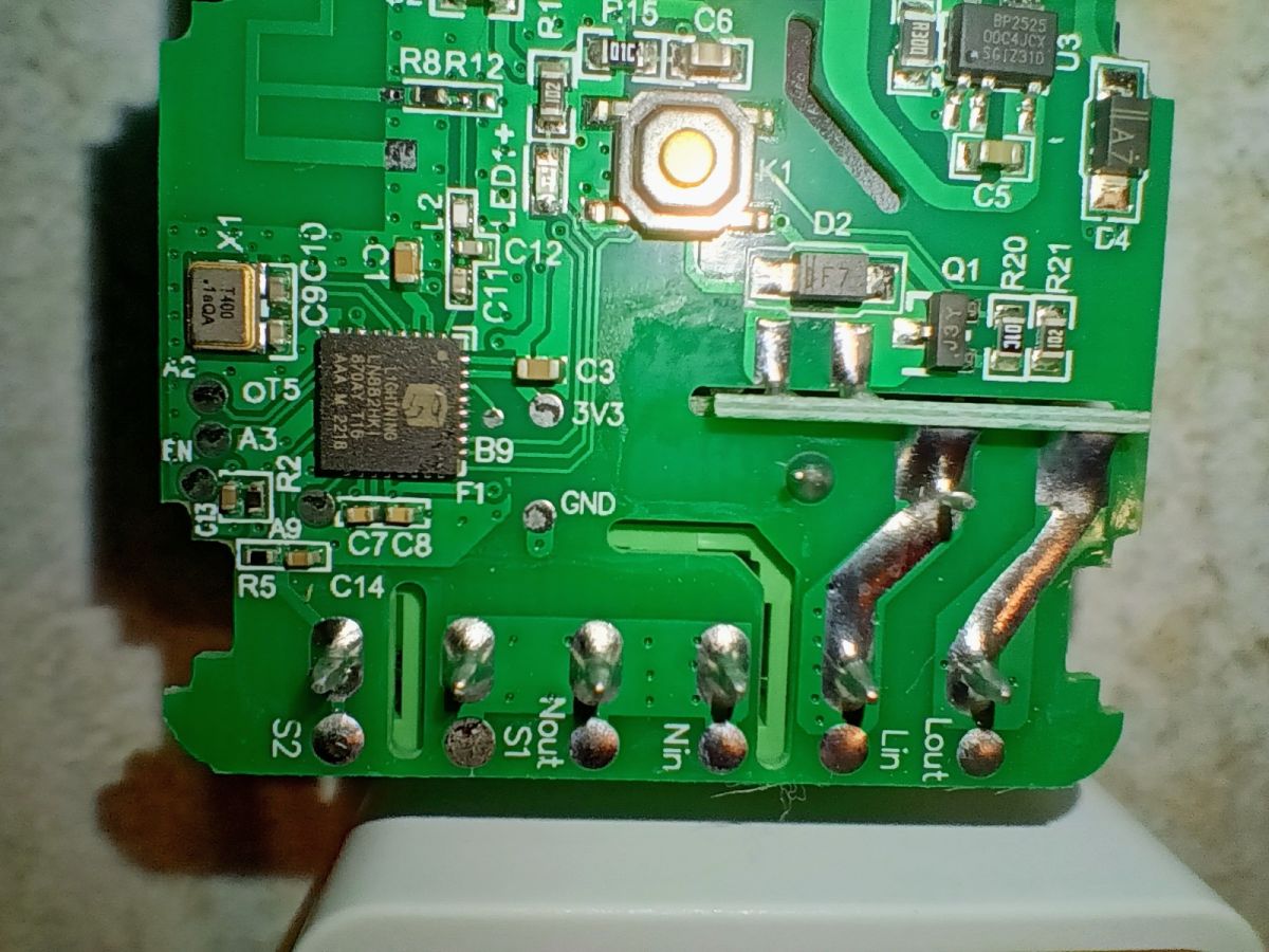

    I bought the same smart switch as in the YouTube video. However, the LN882HK1 is mounted directly on the circuit board.
    GND, 3.3V, and EN are present and labeled as contact points. But where are Tx and Rx?

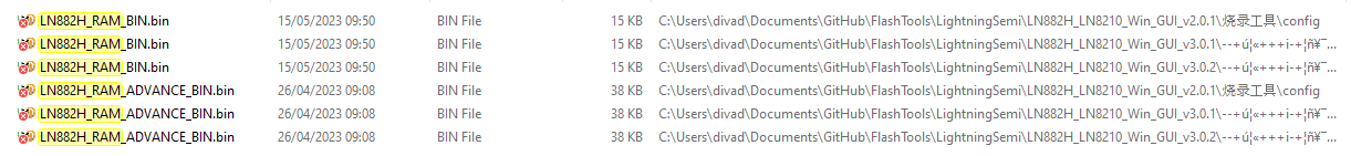

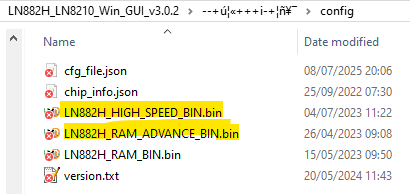

    LN882Loader repo already appears to use the larger stub, though its code isn't identical to the 3 above
    Added after 23 [minutes]:
    ah, so the 9 minute 2mb dump is if you use stub LN882H_RAM_ADVANCE_BIN.bin
    trying higher but it doesn't seem to faster
    Added after 36 [minutes]:

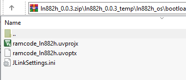

    wait. The Tuya SDKs for LN882H contains source for bootloader and ramcode?

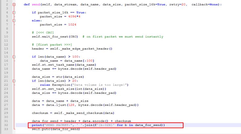

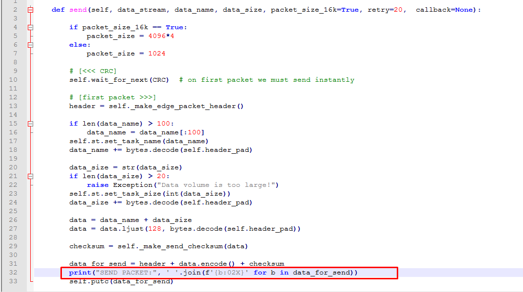

    Try V6. It will dump packet. If still not ACK, then open YModem.py and add this:
    [Youtube] LN882H module pinout and setup for flashing - step by step video guide
            print("SEND PACKET:", ' '.join(f'{b:02X}' for b in data_for_send))
    I have a mistake in packet header and comparing bytes may help
  • ymodem.py appears to be an external dependency

    v6 original
    ymodem.py is not part of the project code though?
  • #77 21606677
    Posts: 14770
    Rate: 12913
    ymodem.py is the code I base on:
    https://github.com/mandl/LN882Loader

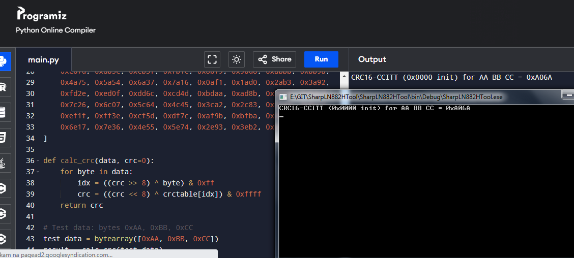

  • CRC range likely excludes the final two bytes
    #79 21606692
    Posts: 14770
    Rate: 12913
    Oh no, so the CRC is bad?
    01 00 FF 4C 4E 38 38 32 48 5F 52 41 4D 5F 42 49 4E 2E 62 69 6E 00 33 37 38 37 32 00 00 00 00 00 00 00 00 00 00 00 00 00 00 00 00 00 00 00 00 00 00 00 00 00 00 00 00 00 00 00 00 00 00 00 00 00 00 00 00 00 00 00 00 00 00 00 00 00 00 00 00 00 00 00 00 00 00 00 00 00 00 00 00 00 00 00 00 00 00 00 00 00 00 00 00 00 00 00 00 00 00 00 00 00 00 00 00 00 00 00 00 00 00 00 00 00 00 00 00 00 00 00 00 A6 E8
    01 00 FF 4C 4E 38 38 32 48 5F 52 41 4D 5F 42 49 4E 2E 62 69 6E 00 33 37 38 37 32 00 00 00 00 00 00 00 00 00 00 00 00 00 00 00 00 00 00 00 00 00 00 00 00 00 00 00 00 00 00 00 00 00 00 00 00 00 00 00 00 00 00 00 00 00 00 00 00 00 00 00 00 00 00 00 00 00 00 00 00 00 00 00 00 00 00 00 00 00 00 00 00 00 00 00 00 00 00 00 00 00 00 00 00 00 00 00 00 00 00 00 00 00 00 00 00 00 00 00 00 00 00 00 00 99 E5
    Added after 5 [minutes]:
    Wait, CRC functions are ok. Do I calculate CRC for a correct bytes range?
