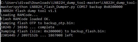

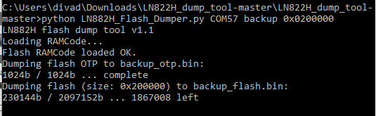

    #31 21441525
    niterian
    Posts: 12
    @niterian Are you looking for other tools because flashing does not work for you? Then please show your connections. I don't think that the tool is at fault.
    I don't think it's the tool's fault either. I was looking at other tools to try to understand what I'm supposed to see on the wires.
    I've flashed 6 BK7231N/BK7231T/T34 based devices, all through uartprogram. I wasn't able to get the "official" Windows-based GUI tool to work correctly under Linux and just decided that a simpler open-source tool is easier to debug.
    I'm not ready to ask for help. I have a few things to try. My main suspicion is that my 3.3V supply is not good enough. I had way easier time flashing when I was able to reuse the on-board AMS1117 voltage regulator than powering from my cheap PSU (Yihua 305D). When reading would often start talking talking to the flash and then after a few seconds fail. Writes wouldn't even start, I assume they are more power intensive.
    I have a few spare AMS1117s, so the next step is to try it.
  • CH340G UART fixed LN882H flashing issue
    #32 21443865
    niterian
    Posts: 12
    >>21441525
    I was finally able to flash LN882H (WL2S).
    I've switched to powering it from https://botland.store/power-modules/1482-supp...ontact-plates-mb102-33v-5v-5904422300739.html which is really just AMS1117-3.3V in a convenient form with all the necessary capacitors. Later it turned out to be unnecessary. My PSU worked just fine.
    I had to pull out my logic analyzer to finally find out that my FTDI232-based UART wasn't actually sending anything on the TX line.
    I've changed it to a CH340G-based UART ( https://pl.aliexpress.com/item/1005006880183678.html , CH340G-2) and it worked just fine with LN882Loader.
    I've also tried another FTDI232-based UART ( https://pl.aliexpress.com/item/1005006157753097.html , Red) and it also worked.
    Strange, given that I've flashed 6 BK7231 chips with the old FTDI232 UART.
    I've tried running the LN882H_V1.0.16 Windows-based tool under wine on Linux with no luck. It might be that I don't know how to pass the correct COM port, given that a Linux equivalent is /dev/ttyUSB0 or similar.
    The tyutool_cli successfully communicates with the chip, but it just doesn't allow reads. It exits with "Don't support read.".

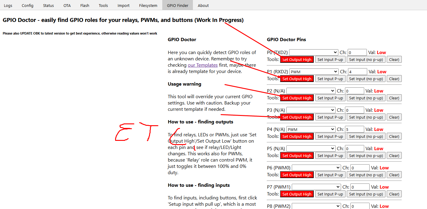

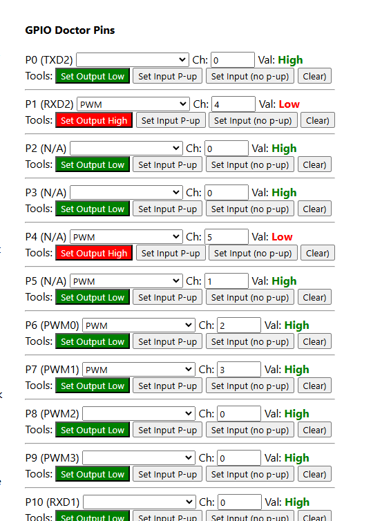

    I'm testing another LN882H device and I have a question to anyone who can do checks on another LN882H piece - can you click through all pins in GPIO doctor without getting WDT reboot?
    User interface of the GPIO Doctor tool with visible GPIO pins and configuration options.
    @divadiow (I'm not sure who else has LN882H at hand)
    I'm on 1.18.42

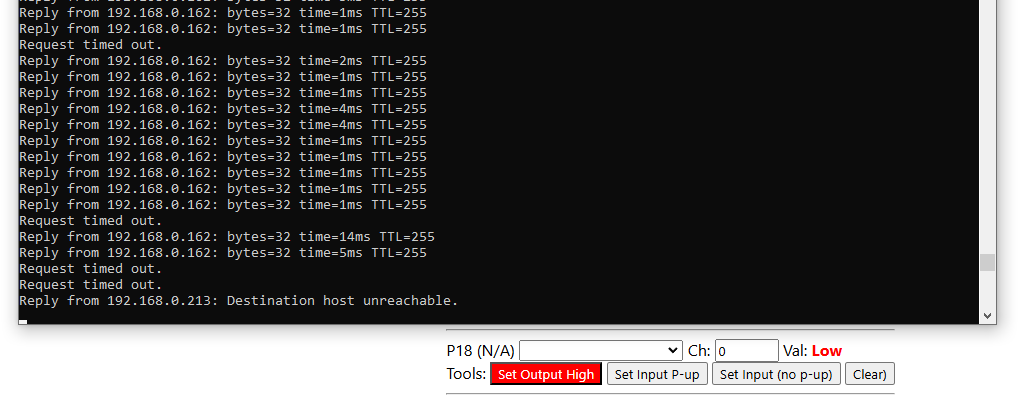

    My LN882H consistently crashes on "Set Output High" on P13 on 1.18.42.
  • GPIO_HIGH_SPEED may crash some LN882H pins
    #38 21446503
    Posts: 14770
    Rate: 12913
    It crashes but only while setting to digital output, right? dInput and dInput without pull up works for me:
    User interface for managing GPIO signal settings.
    https://github.com/openshwprojects/OpenBK7231T_App/blob/main/src/hal/ln882h/hal_pins_ln882h.c
    Code: C / C++
    Maybe some pins don't like GPIO_HIGH_SPEED?
    https://github.com/search?q=repo%3Aopenshwprojects%2FOpenLN882H%20hal_gpio_init&type=code
    Code: C / C++
  • #39 21446533
    insmod
    Posts: 1432
    Help: 168
    Rate: 455
    It's not that, gpios from A13 to B2 shouldn't be used at all, they are reserved(?) for QSPI, which i believe is internal flash.
    I, of course, could be wrong. But that is what i believe. There is also no FULLMUX for them.

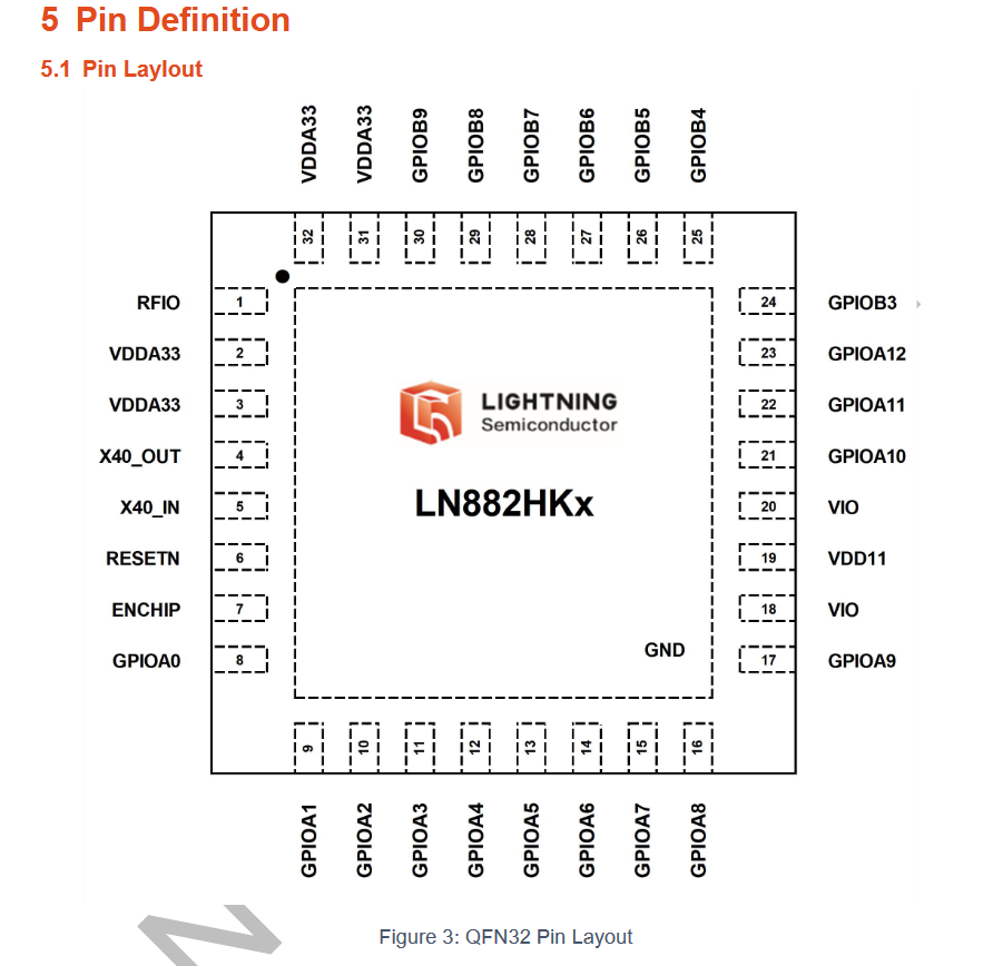

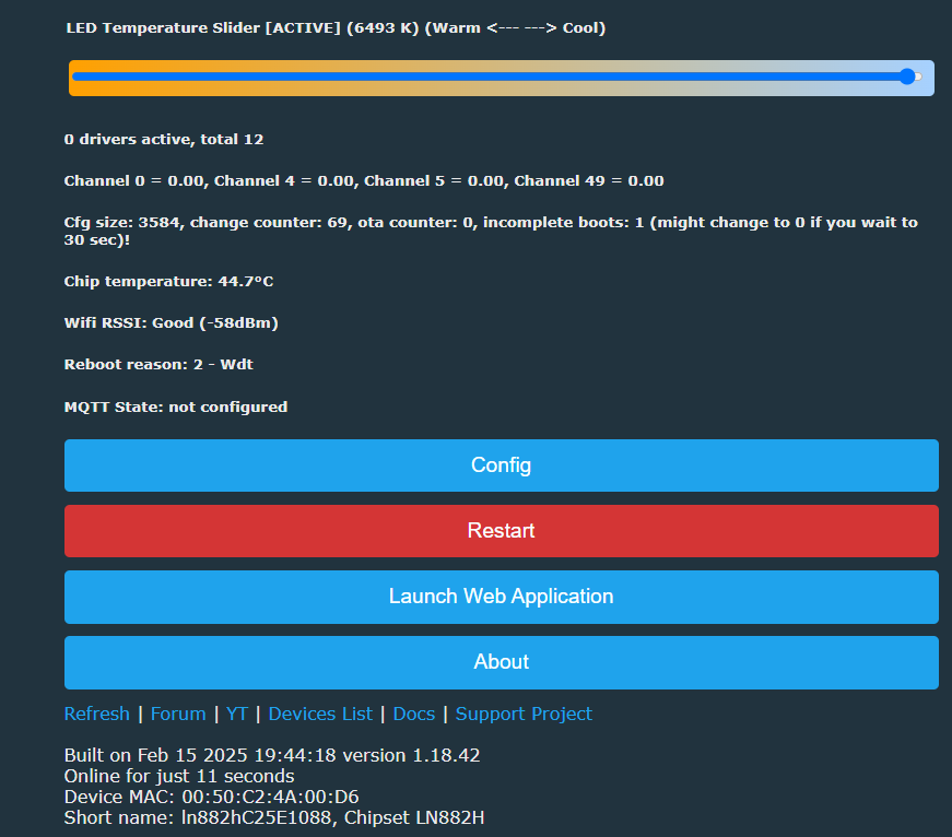

    I'm not sure. I'm confused at the moment. I've just flashed this LN882H bulb:
    https://www.elektroda.com/rtvforum/topic4107260.html
    and I am almost sure that I am unable to find the RGB pins, I have only CW working. And I really feel like I saw greenish tint for a moment while playing near P14 or P13, not sure.
    I will retry.
    Of course, taking out the board of this bulb could help to follow the traces, but I don't want to damage it.

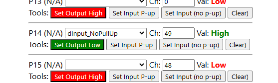

    Checking right now ,starting from the end of the list., Crashed at P18:
    Screenshot showing ping command results in a console and pin settings in an application.
    Screenshot of the web interface with configuration options for LN882H bulb.
    Of course, the separate issue is that it's not really P18, those are Beken labels, they weren't changed for LN882H yet.

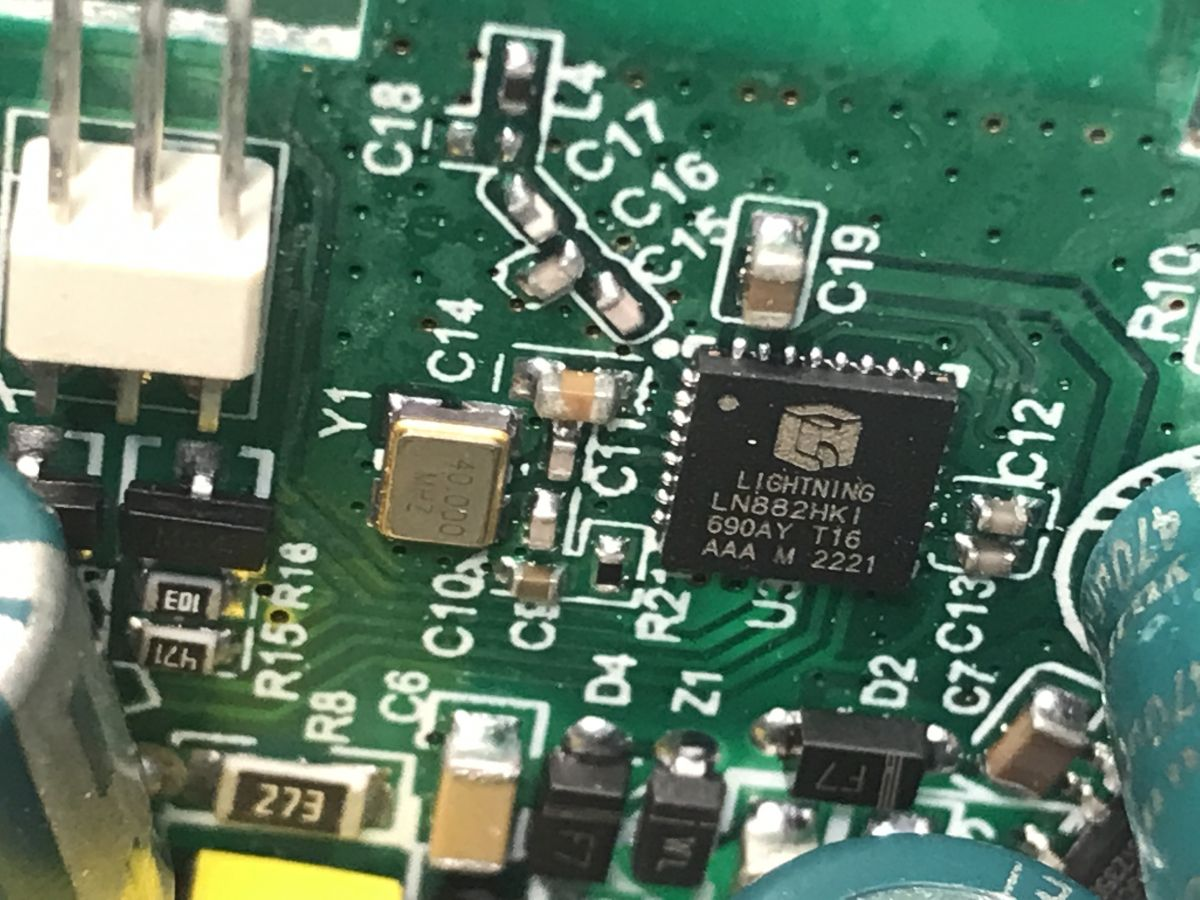

    Maybe I can try to use the photos I took...
    Close-up of a circuit board with a LIGHTNING LN882HK1 chip.
    Pin layout diagram of LN882HKx chip from Lightning Semiconductor.
    Added after 4 [minutes]:
    Update: I've found other PWM pins, so it seems that everything is ok except the fact that we need to disable those few pins in HAL so they don't crash

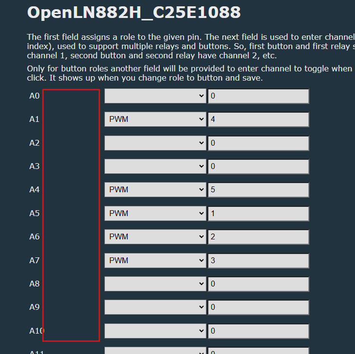

    I feel like we need a separate check for gpio, something similar to HAL_PIN_CanThisPinBePWM, but if it can be input or output.
    Something like void HAL_PIN_CheckGPIODirs(int index, bool* input, bool* output)
  • Expose PWM aliases and hardcode web app names

    We also need to expose PWM names (or generic aliases) to Configure Module tab:
    Screenshot of OpenLN882H_C25E1088 pin configuration with PWM settings.
    And get correct names for the Web App:
    User interface for managing GPIO pins with various settings and values.
    For the Web App, I think we could get away with hardcoding those names in VUE files.... we don't really need to fetch them via API from OBK, or do we? Hardcoding them in Web Page may be less elegant but that is also lesser stress for WiFi module and it has no extra api requirement.

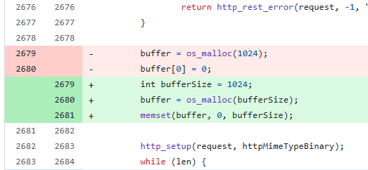

    Posts: 14770
    Rate: 12913

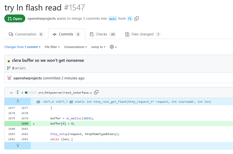

    @divadiow I've checked what we spoke about and it seems the flash read was not present for Web App on LN882H, I will try to add it now:
    https://github.com/openshwprojects/OpenBK7231T_App/pull/1547
    Added after 5 [minutes]:
    I also figured out why it returned log content on unsupported platform - buffer has random garbage from ram that was there before alloc...
    Screenshot from GitHub showing a pull request about a code fix.

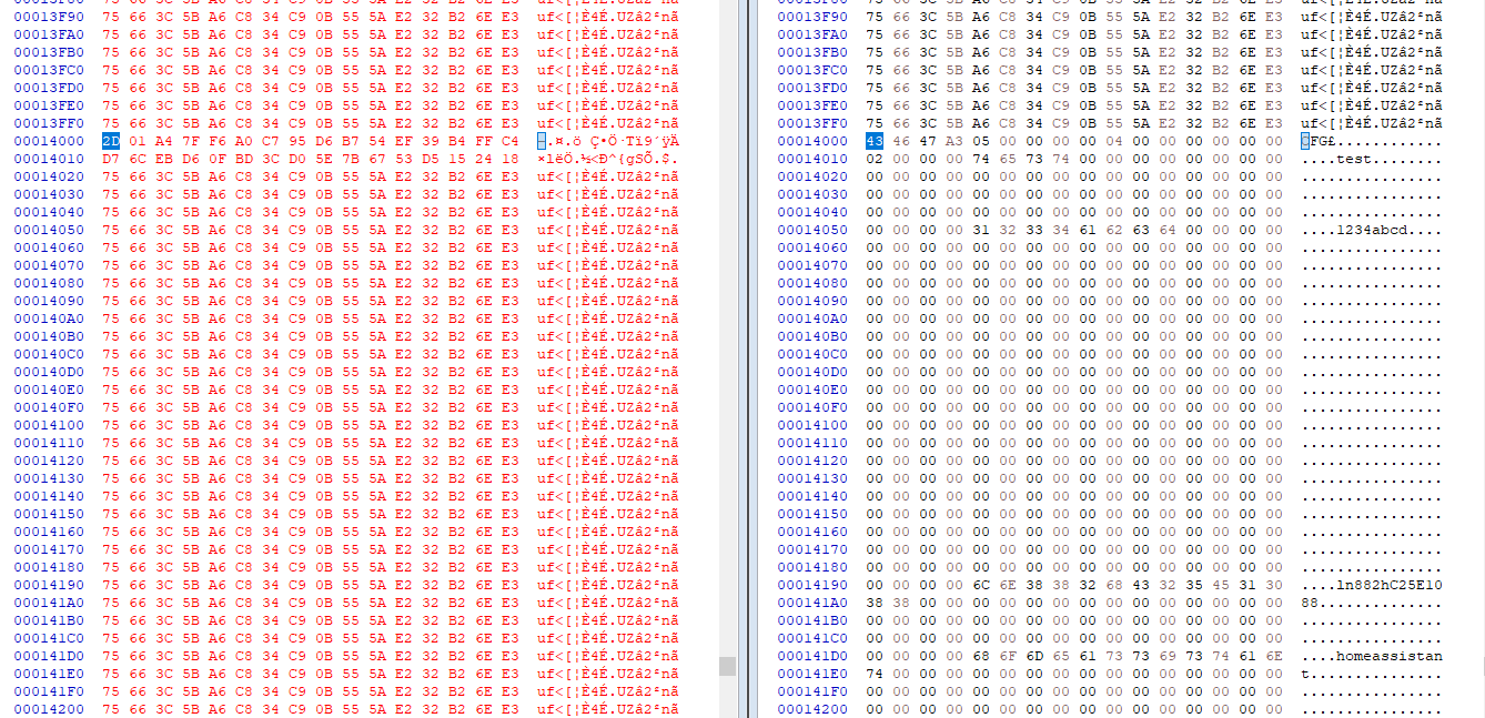

    Posts: 5220
    Help: 449
    Rate: 918
    yes, that's better.

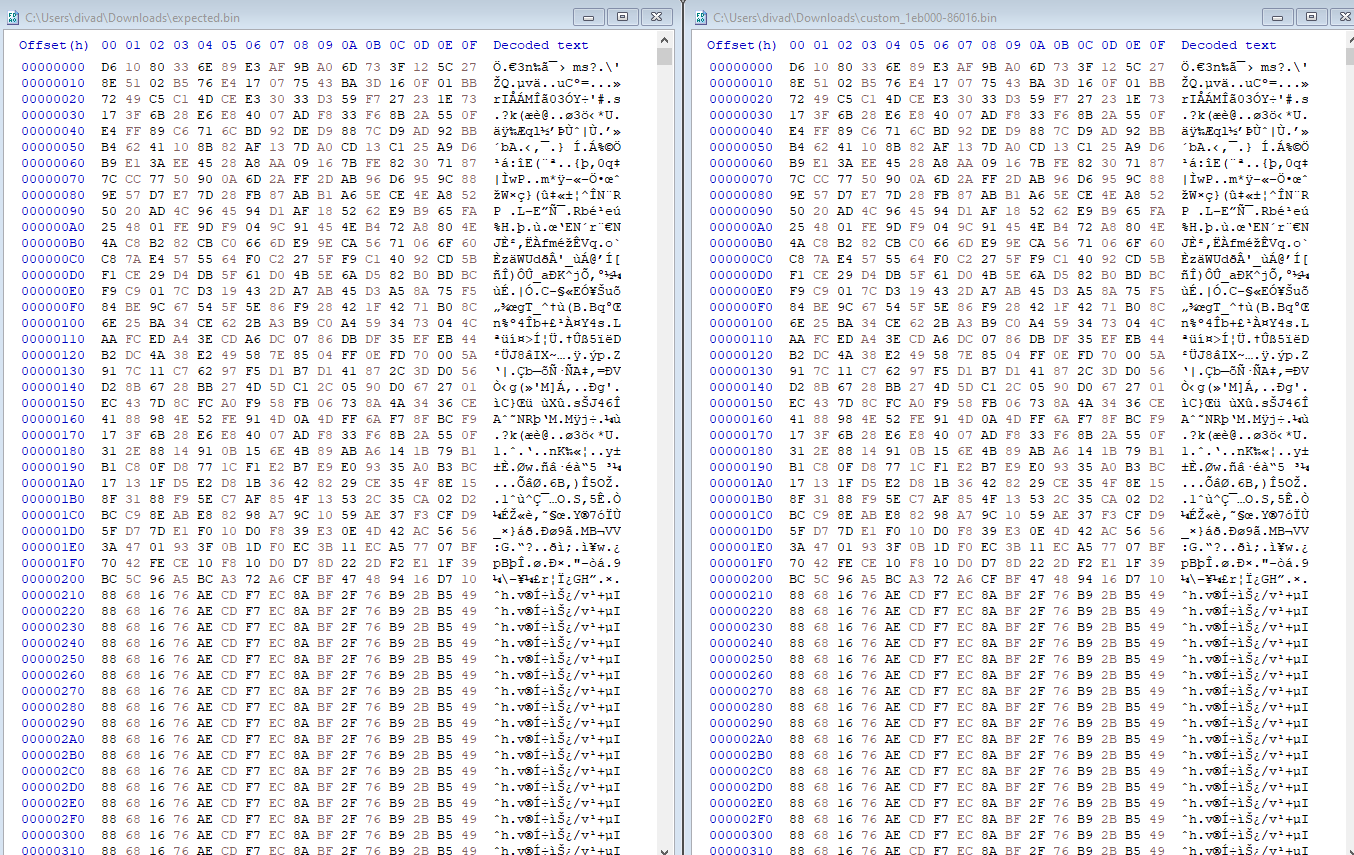

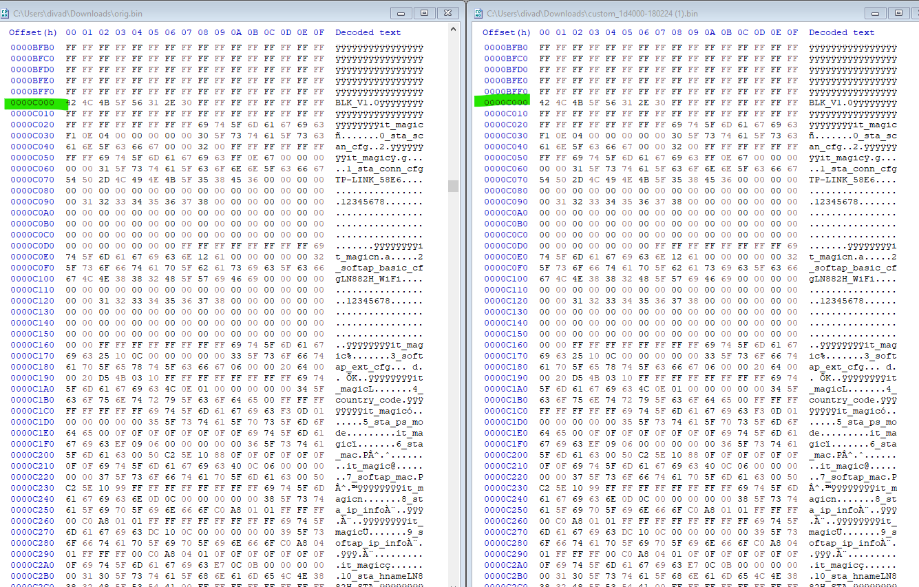

    I've read from offset 0x1D4000 and length 180224 bytes in the web app and compared the saved result to a fresh dump of the whole flash of the LN882H.
    it's almost the same so not sure why a little different. I'll wipe and start again to be sure
    Two hex panels with decoded text for binary files.
    the first offset difference when comparing:
    Comparison of two files with hexadecimal data and text.
    Added after 22 [minutes]:

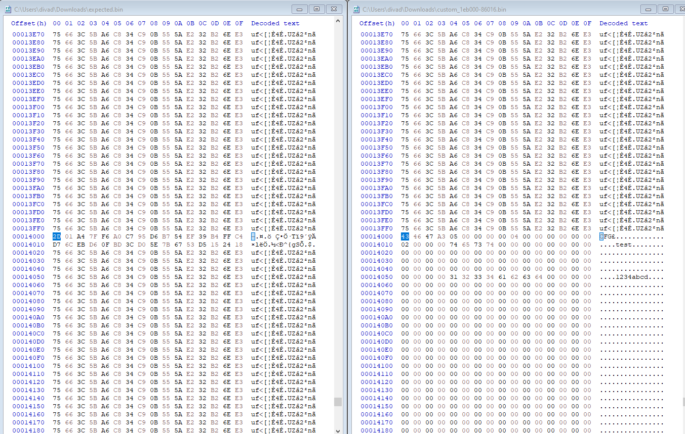

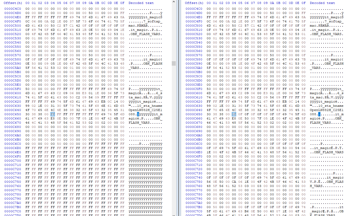

    hmm. it's a bit weird. The second attempt was:
    -erase full Tuya flash from 0x0
    -do not boot
    -flash OBK to 0x0
    -boot OBK and dump from 0x1D4000 and length 180224 bytes
    compare 0x1D4000-0x2000000 from Tuya bin to extract = not identical. Assuming OBK is perhaps making changes in its boot between 0x1D4000-0x2000000 I next tried:
    -extract from 0x1EB000 (where it seem the Tuya config starts) for 86016 bytes and compare to the same range on original flash. Comparing looks OK at the beginning
    Screenshot of two opened binary files in a HEX editor.
    but then goes off the rails. the "test" and "1234abcd" is the AP it's connected to. Is something console/log still finding its way into the dump?
    Two program windows displaying binary data and text.
    files for own comparison
    • compare.zip (7.42 KB) You must be logged in to download this attachment.

    It should not if read works, but maybe it fails at some point. I can fill buffer with 0x00 just to be sure.
    Code snippet with version differences, showing changes in memory allocation and initialization.
  • OBK config data explains the dump contents
    #51 21456320

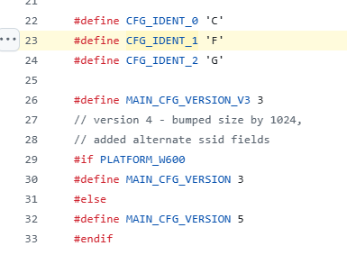

    Posts: 14770
    Rate: 12913

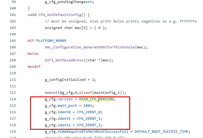

    divadiow wrote:
    75246500_1740513401.png]Screenshot of two opened binary files in a HEX editor.[/url]

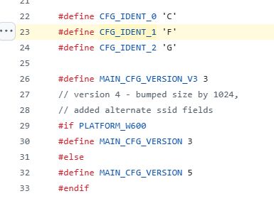

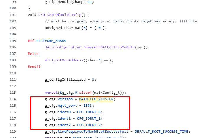

    I've looked closer and hey, it's our OBK config! It's added by OBK on OBK start.
    Fragment of C source code with a configuration function.
    Source code snippet with macro definitions in C language.
    CFG (ascii text) is the ident of OBK config structure.
    So it seems everything is okay.
