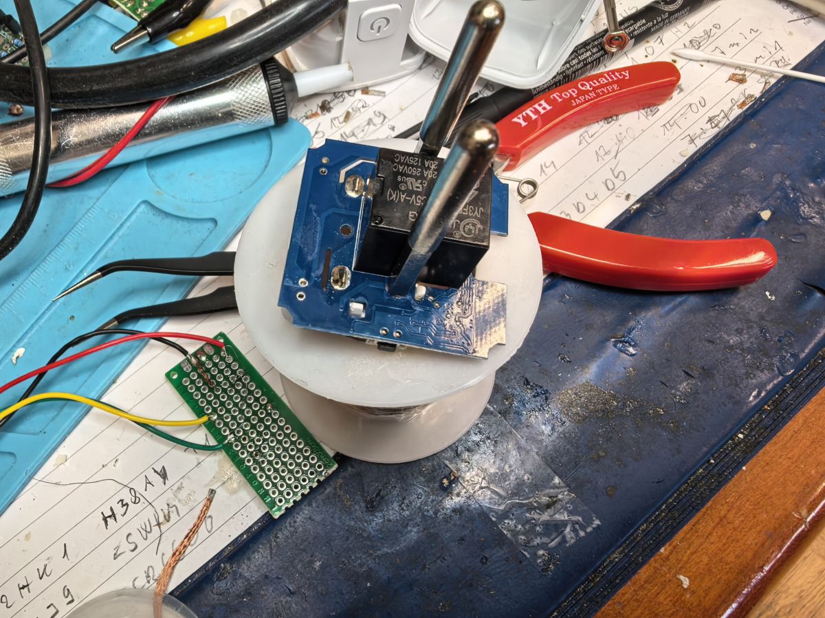

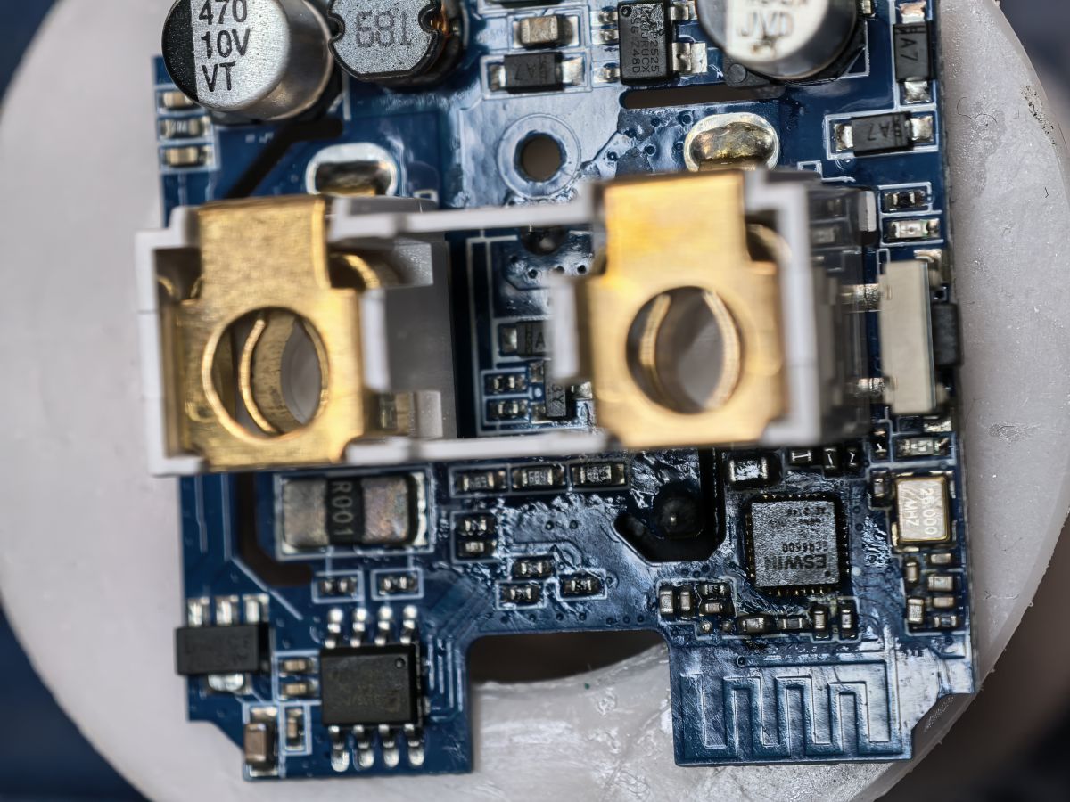

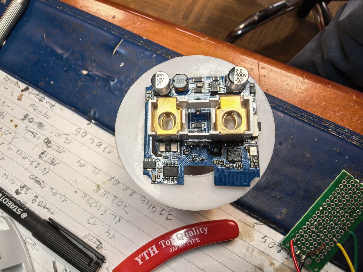

    have you checked the other side of the PCB?
  • #123 21906898
    Blisk
    Level 4  
    Posts: 16
    >>21906818 Yes I did, there are pins on the other side, I measure it.
    pin 1 is connected to pin 3 on chip, pin 2 is connected to pin 4 on chip, pin 3 is connected to pin 16 on chip, pin 4 is connected to pin 14/15 which are together on chip and pin 5 is connected to pin 10 on chip
    PCB with two relays and connected wires on an electronics workbench
