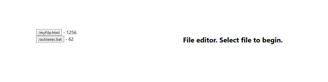

    ECR6600 test
    SendGet http://example.com/ myFile.html
    Info:CMD: CMD_SendGET received with args http://example.com/ myFile.html
    Info:HTTP_CLIENT:HTTPClient_Async_SendGet for http://example.com/, sizeof(httprequest_t) == 160!
    Info:CMD:[WebApp Cmd 'SendGet http://example.com/ myFile.html' Result] OK
    Info:HTTP_CLIENT:Parse url http://example.com/
    Info:HTTP_CLIENT:host: 'example.com', port: 80
    Info:HTTP_CLIENT:HAL_TCP_Establish: created socket 2
    Error:HTTP_CLIENT:success to establish tcp, fd=2
    Info:HTTP_CLIENT:httpclient_recv 255 bytes has been read
    Info:HTTP_CLIENT:httpclient_recv 236 bytes has been read
    Info:HTTP_CLIENT:httpclient_recv 7 bytes has been read
    Info:MAIN:Time 225, idle 0/s, free 188384, MQTT 0(14), bWifi 1, secondsWithNoPing 158, socks 2/20

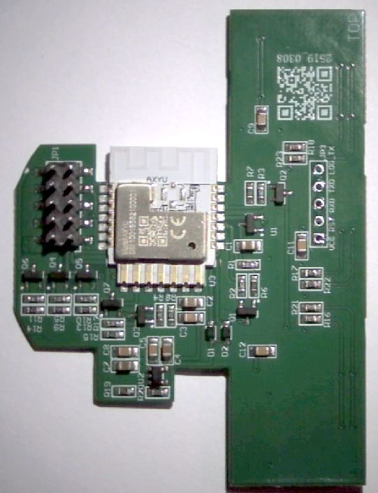

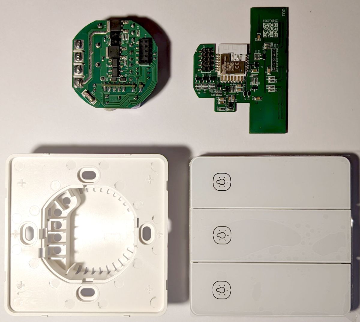

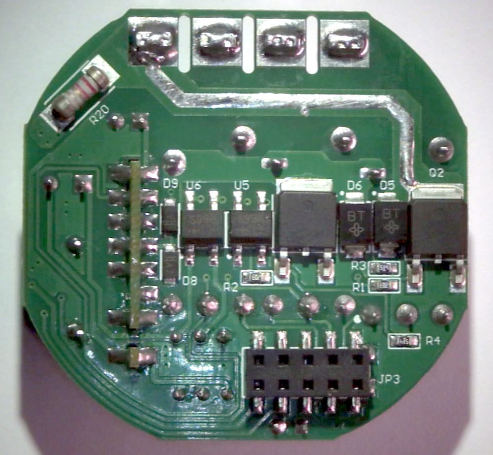

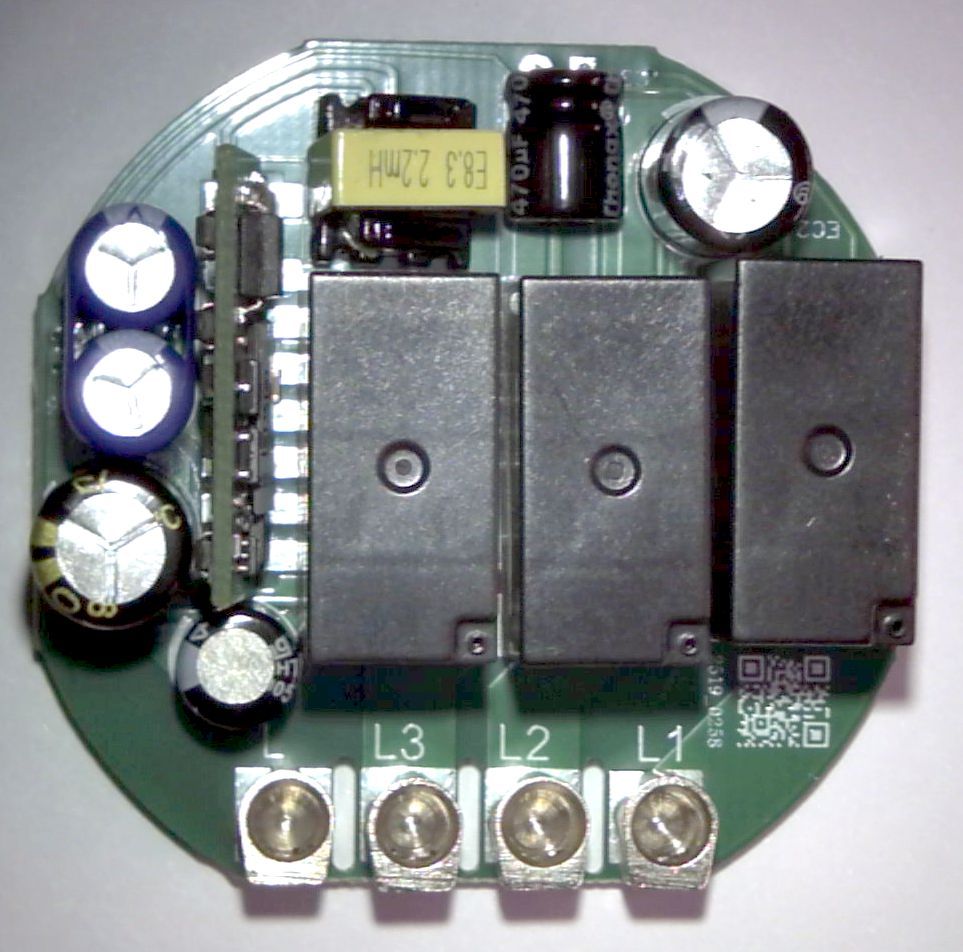

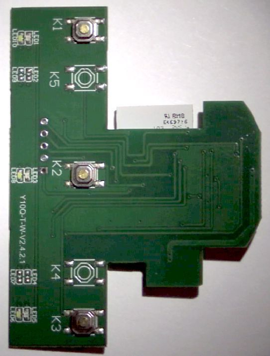

    Hi guys!
    I bought several switches MCL-Y10-L-03W in this store:
    https://aliexpress.ru/item/1005008813709294.h...2.1426903569.1753361948-1554502598.1753361948
    (not an advertisement)
    Want to cut them off from the Tuyas cloud and make them local in Home Assistant.
    Found this topic with your work and firmware. Thank you for your great work!
    I disassembled one switch and saw the AXYU board.
    Flashed one switch as written in the instructions. Everything went well.
    Now I need to configure the pins, but I have no experience in how to do this. But I have a great desire!
    I don’t know how to determine all the pins. Maybe you can help me?
    I am attaching photos and the dump file with the factory firmware.
    Top view of a PCB labeled K1–K5 with LEDs and three microswitches installed
    PCB with AXYU Wi-Fi module from MCL-Y10-L-03W switch, shown from top view
    Top view of circuit board from MCL-Y10-L-03W switch with relays and terminals
    PCB of the MCL-Y10-L-03W switch with visible electronic components and JP3 connector
    Dismantled MCL-Y10-L-03W wall switch showing PCBs and plastic housing parts
    • Tuya_MCL-Y10-L-03W_Backup_ECR6600.bin (2 MB) You must be logged in to download this attachment.

    >>21615836
    Well, you've already determined button pins.
    All that remains are relay pins.
    Put everything back together, connect it to mains and experiment in GPIO Doctor (Web app -> GPIO Finder).
    Check unconfigured pins by setting output high/low, and when relay clicks - you will know what pin it is.

    >>21615922
    Thank you! I'll try it now.
    But I still need the pins of the six LEDs.
    In the factory logic, they glow white when off and glow blue when on. On each switch.
    I do it ...

    >>21615944
    Leds are usually on the same pin as relays.
    At least it was that way on almost all switches i've seen (except moes zigbee no-neutral no-capacitor switch).
    But if not, they can be found the same way.

    Now, with all zero pins, all blue LEDs are lit. That is, the relays are in the on states.

    walligatorw
    Level 4  
    Thank you, insmod!
    Thank you, divadiow!
    I found these pins and they work!
    "pins": {
    "0": "Btn;1",
    "2": "Btn;2",
    "14": "Rel;1",
    "15": "Rel_n;1",
    "16": "LED_n;2",
    "17": "Btn;3",
    "20": "LED_n;3",
    "21": "LED_n;1",
    "22": "Rel;2",
    "23": "Rel_n;2",
    "24": "Rel;3",
    "25": "Rel_n;3"
    I haven't figured out the purpose of pin 3 and pin 4 yet.
    And also, when relay 1 is triggered, the switch restarts. :(
    I dig further...

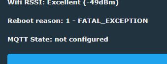

  • #103 21636152
    Posts: 5089
    Help: 441
    Rate: 900
    REST ECR6600 OTA is successful but
    Wi-Fi signal excellent, reboot reason: FATAL_EXCEPTION, MQTT not configured

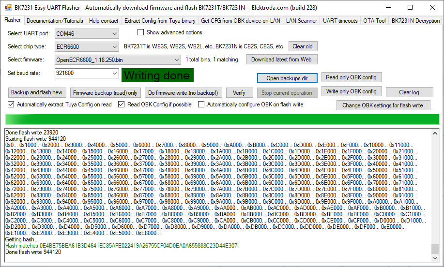

  • RDTool worked after header errors in .228
    #115 21823087
    avgapon
    Posts: 9
    Update 2026
    As of 2026, this platform read/write is also supported by our flash tool:
    The connection (soldering, wires), is the same, but you can use our tool instead of the legacy one.
    Please check it out and use it instead of legacy tools, let us know how it works for you!
    FWIW, this didn't work for me with version .228.
    Every time it started okay but then complained about wrong header.
    I tried different speeds and none worked.
    RDTool worked on the first try.

    I have flashed ECR6600 (under optimum connectivity conditions) 5 times with .228 and it's been OK. What baud were you using?

    >>21823203
    I tried 115200, 230400, 460800 and finally 2000000.
    Each a few times.
    I haven't tried 921600 from your screenshot, though.

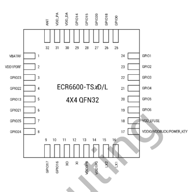

    I have this chip in my smart power plug, where I can find TX and where RX and 3.3V. ECR6600 IC205, I think this is on picture below it has 8 pins on every side.
    I have soldered out, but after that I see it has connection pins at the bottom of PCB connected directly to chip

    I have found out 3.3V is pin GPIO17, XO is TX and XI is RX, but still don't know how to upload ne firmware, nothing works.

    please show pics of your device case - make/model and PCB pics. have you searched the forum for other ECR6600 plugs to see if an identical device has already been flashed?
    this is xtal in/out for the oscillator, not uart programming.

How do I flash an ECR6600 device over UART with RDTool and OpenECR6600 for a fully local Home Assistant setup?
You flash it over UART, then join the new AP and finish setup like Tasmota. 1. Wire 3.3 V, GND, TX0 on GPIO6, RX0 on GPIO5, and preferably RST. 2. In RDTool, open the develop tool, use the download tab, choose the all-in-one OpenECR6600 UART binary, click Start, then reset or power-cycle the board immediately. 3. After flashing, power-cycle again, connect to the firmware access point, open the configuration page, and add it to Home Assistant locally. The thread states this was already working in March 2025, though the release was still marked WIP testing. [#21479963]
What are the important ECR6600 flashing pins, and how are TX0, RX0, IO13, RST, 3.3V, and GND used during backup and programming?
The essential pins are TX0, RX0, 3.3 V, GND, and usually RST. TX0 is IO6 and RX0 is IO5; they form the user UART used for backup and flashing. IO13 is TX2 and outputs boot logs at 115200 baud, so it helps verify whether the firmware starts after programming. RST lets you hit the short boot window without repeatedly removing power. 3.3 V powers the module, and GND is the common reference. The thread’s tested wiring used an ESP adapter on a WG236 module, but the same signal roles apply across ECR6600 modules. [#21479963]
What's the difference between BK7231GUIFlashTool and the legacy ESWIN RDTool for reading and writing ECR6600 flash?
BK7231GUIFlashTool is the newer multi-platform flasher, while RDTool is the original ESWIN utility shown in the screenshots. The main post says ECR6600 read and write support was added to BK7231GUIFlashTool in 2026, with the same soldering and UART wiring as RDTool. RDTool remains the documented legacy workflow for backup, restore, and flashing OpenECR6600. Later thread feedback showed mixed real-world results: one user reported BK7231GUIFlashTool v.228 failed with wrong-header errors, while another flashed successfully at 921600 baud. If you want the most proven path from the thread, RDTool is still the safest first choice. [#21823087]
How do I back up the original ECR6600 firmware, and which read length should I use for 2 MB vs 4 MB flash chips?
Back up first with RDTool’s stub workflow, then read the whole flash from address 0x0. In RDTool, open develop tool, go to single file, load ECR6600F_stub_V1.3.1.bin, set startup address to 0x10000, and trigger reset exactly when you click Start. Then switch to the flash tab, enter start address 0 and read length 0x400000 for 4 MB or 0x200000 for 2 MB. If you do not know the size, try 0x400000 first. If RDTool says "FLASH is not enough!", retry with 0x200000 and save the dump under a descriptive filename. [#21479963]
Why does RDTool on ECR6600 require precise reset timing, and what is the easiest way to catch the boot window reliably?
RDTool needs precise timing because the bootloader accepts the UART session only in a very short window after reset or power-up. The thread explicitly says "the window of opportunity is very small," so clicking Start alone is not enough. The easiest reliable method is to wire the RST pin and ground it exactly when RDTool starts, instead of pulling power each time. If RST is unavailable, power-cycle 3.3 V at the same moment. Using IO13 boot logs at 115200 baud also helps confirm whether you missed the window or the firmware simply failed to boot. [#21479963]
