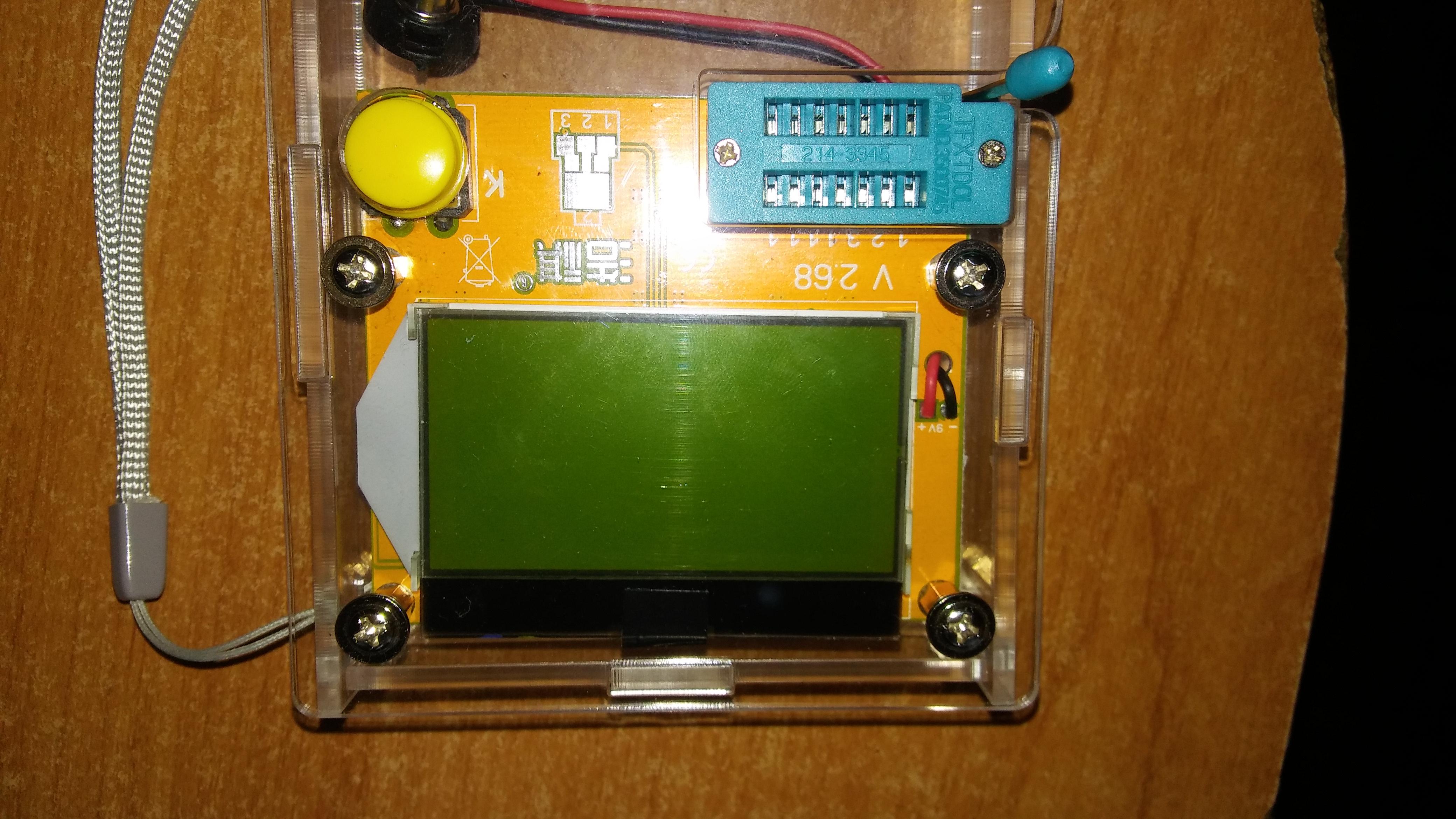

  • #458 16947579
    brofran
    Posts: 6628
    Help: 648
    Rate: 1399
    I recently got a tester, so I will share my observations. 1- measurement of layered silicon diodes - OK, while old blade type eg DOG 58 signals as a capacitor, or unrecognized 2-transistors with a metal housing should be measured without touching them during measurement, because the results then different 3- top housing plate is matte and therefore the LCD is dimmed. Maybe someone will come up with a way to polish it "to shine". :D 4- the bottom of the housing is good to stick with 4 pieces of soft plastic, because the fixing screws can scratch the delicate table tops. Well, I gave "bodies", I did not read about the film. :D :D
  • #459 16947738
    Ricoh_220
    Posts: 3714
    Help: 464
    Rate: 752
    And you peeled off the foil? That's not why it's dull. https://www.elektroda.pl/rtvforum/topic3354445-420.html#16887286

    brofran wrote:
    3- the top housing plate is matte and therefore the LCD is dimmed. Maybe someone will come up with a way to polish it "to shine". :D
    Maybe it's enough to do what:
    It can be solved in any way, it has already been described in this topic. greetings

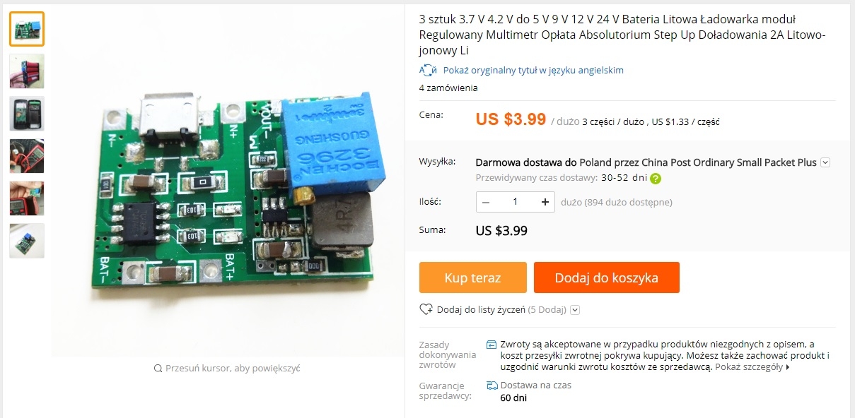

  • #467 16948668
    miszczo997
    Level 28  
    Posts: 1052
    Help: 134
    Rate: 159
    I quickly gave the step up converter with MT3608, which I bought for about 2 zlotys. For this liion battery from some Nokia 1600, and for charging and protection against discharging the battery module on tp4056.
  • #468 16948693
    nanab
    Posts: 1092
    Help: 90
    Rate: 239
    Even if they have less, it is still much more than a 9 volt battery. The cable is in the price of the tester, and soldering it maybe 1/100 hours times the 20 PLN / h is somehow 20 groszy work comes out. Besides, I would have to buy a 9 V battery (more time and money for fuel), and 18650 and converter I have at home.
    miszczo997 wrote:
    I quickly gave the step up inverter from MT3608, which I bought for about PLN 2. For this liion battery from some nok 1600, and for charging and protection against discharging the battery module on tp4056.
    Where did you connect, what kind of tension?
  • #469 16948742
    rafcio_21
    Posts: 1110
    Help: 137
    Rate: 293
    You set the inverters to which 7-8V and plug in where the 9V battery was connected.
  • #470 16948747
    miszczo997
    Level 28  
    Posts: 1052
    Help: 134
    Rate: 159
    Tp4056 to the cell, the switch was just behind, because as I gave between the cell and the charging module, at the load with the converter itself, the protection did not give the output voltage. The total cost of items on aliexpress is about 3.5 PLN, in Poland probably 2x, but that's not much. LCR-T4 electronics components tester ATMega328 - Test and Review
  • #471 16948749
    E8600
    Posts: 8924
    Help: 529
    Rate: 2494
    For this application the best will be 2 in 1 or step-up adjustable inverter and charger in one (with protection against excessive Li-ion discharge). LCR-T4 electronics components tester ATMega328 - Test and Review
  • #472 16948869
    nanab
    Posts: 1092
    Help: 90
    Rate: 239
    Is this 9V necessary to work? If it's not a bit of a sense to do around 9V first just to make them 5V. I already have small converters from power banks, but they are 5V rigid.
  • #473 16948922
    rafcio_21
    Posts: 1110
    Help: 137
    Rate: 293
    Theoretically, you need 5V, but read about the modernization of this tester, I did not delve deeply, but it's about controlling the transistor that encloses the tester and there is some problem I preferred to give the 8 V for peace and calm rather than improve.
