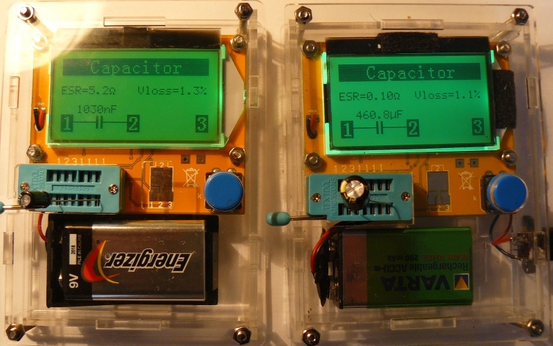

  • #504 17434588
    KMal
    Posts: 1317
    Help: 340
    Rate: 1434
    Hello. Unfortunately, in the current batch of testers the display on the side of the tape (connection) is wider, which causes the display glass to protrude beyond the plate. The upper part of the casing was already in contact with the plate (the display tape pressed against the plexiglass). In this lot of testers it is not possible to fully assemble the housing. The "quick" can be folded without the upper part of the casing (ie plexiglass from the top of the display). Be careful not to break the display, especially if it protrudes beyond the plate. I'm writing all the time that it's about the current batch of testers, or maybe I've come across such a single piece. Let the current buyers confirm.

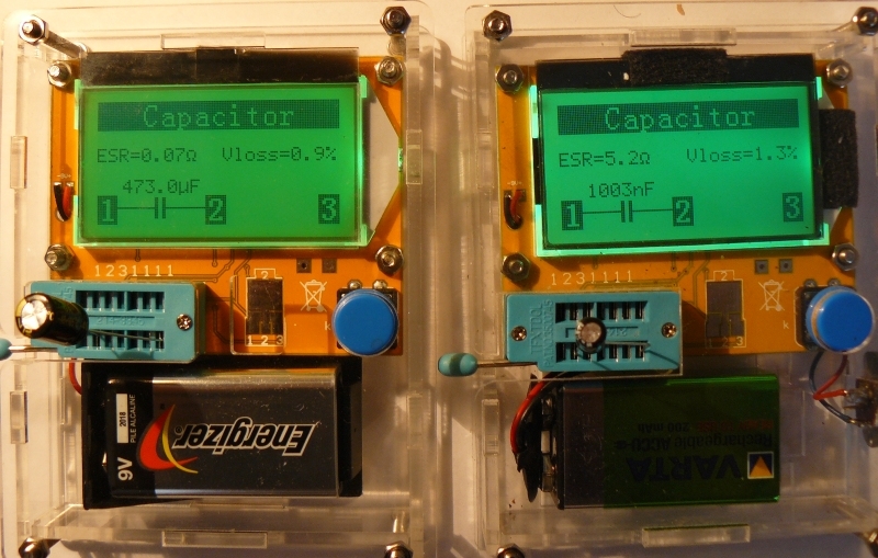

    With regard to tolerance (upper discussion), these are: the two same capacitors 470?F and 1?F only exchanged in places. No comment. ************************************************** ****************** What to post above: The one on the left is the current delivery, clearly wider display (glass on the tape side). The software is the same as last year. Battery basket. LCR-T4 electronics components tester ATMega328 - Test and Review LCR-T4 electronics components tester ATMega328 - Test and Review
  • #507 17434714
    Jawi_P
    Level 36  
    Posts: 3232
    Help: 259
    Rate: 705
    KMal wrote:
    As for the tolerances, these are: two same capacitors 470?F and 1?F exchanged only in places. No comment.
    All in all it comes out that they are measuring well. Repeat for a toy.

    KMal
    Posts: 1317
    Help: 340
    Rate: 1434
    Novile wrote:
    Because on the left, you can read it anyway.
    You can not because the testers do not change their place. The place changes capacitors. In both photos on the left is the newest tester with Energizer battery.
