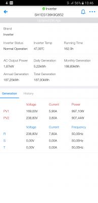

    Today I changed the inputs, I will see how it will be.

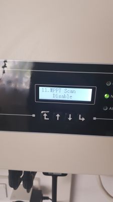

    What is the MPPT SCAN feature and should it be enabled or disabled?

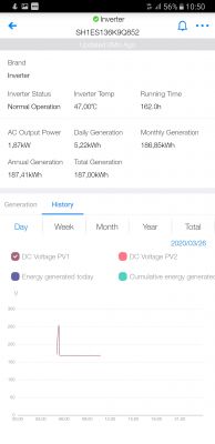

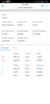

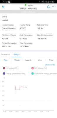

    A few days have passed since the conversion and I still notice the problem that pv1 after waking up the inverter does not raise the voltage on pv1, today it is from morning to 11.00 the voltage on pv1 is 169v current almost 6A production 0.9kw And the sun shines very much in the morning nice, the west side although not yet insolent has the same production of 0.9kw. After resetting the inverter, the voltage and production on pv1 increases. last photo, the difference in production is over 300wat on the string.

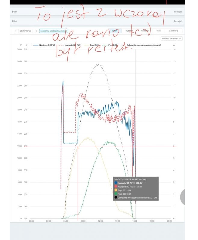

    Show, but separately, graphs of DC voltages and currents for the whole day when it was sunny

    ] Today it was quite sunny since the morning. See what happens after the reset. Inverters sometimes work ok, but often in the morning I have to reset to somehow produce it. Sometimes the reset is not even visible on the graph when it is done in the morning for the voltage to increase. SOFAR 8kW PV Installation: Opinions, Durability, Failures & Experiences with Inverters

    from this chart yesterday is a reset of approx. 8 at nap. around 207 and runs around 5.8 and I do not see any great power jump here, at least in this graph, the quality of these screens is poor

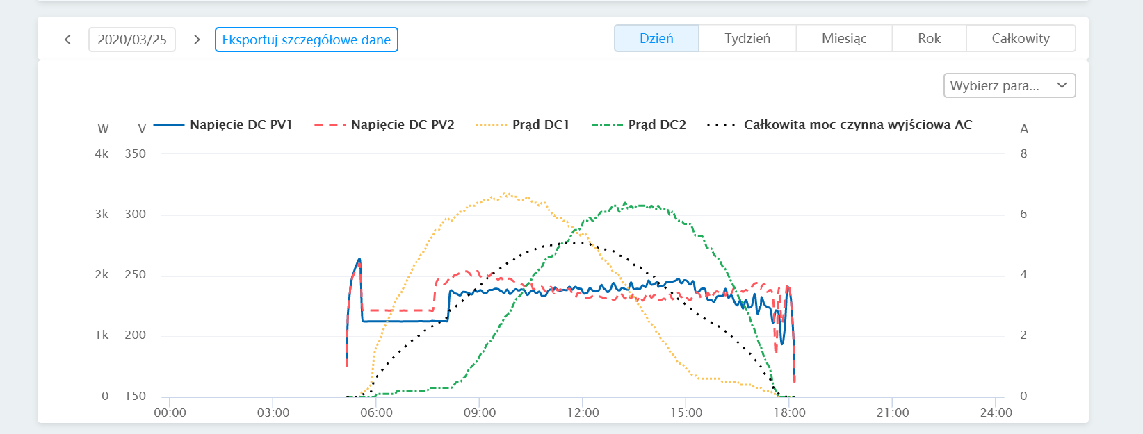

    I am tossing a graph from a similar installation and also from a solarman, and you can capture the details from this much more accurately
    And it seems to me that you have too few modules in the string, at 6 the operating voltage comes out to 190 and this is just a nap. mpp of the inverter and if the temperature of the modules jumps up, it will be even less

    According to the manufacturer, the maximum string per string is 2400W. I have 7 cells per side I wonder what in the morning after waking up the inverter with some voltage on the string, e.g. today 169V the inverter does not raise this voltage during the day but keeps it constant, even though it is sunny in the morning, only after the reset is some reaction and voltage increases causing the production to increase by over 300W. If it starts in the morning and has a voltage of 212V and a current of 5.7A, the loss is not large, but as today it is 169V and if I did not reset, the loss is already considerable
    In the inverter options, the mppt scan function is turned off, so it should be?

    I would turn it on because for peasant reason it is a function that actively searches for the best MPPT point if, for example, the panels are partially shaded ... I do not know if you have such a case but you can experiment with this function.

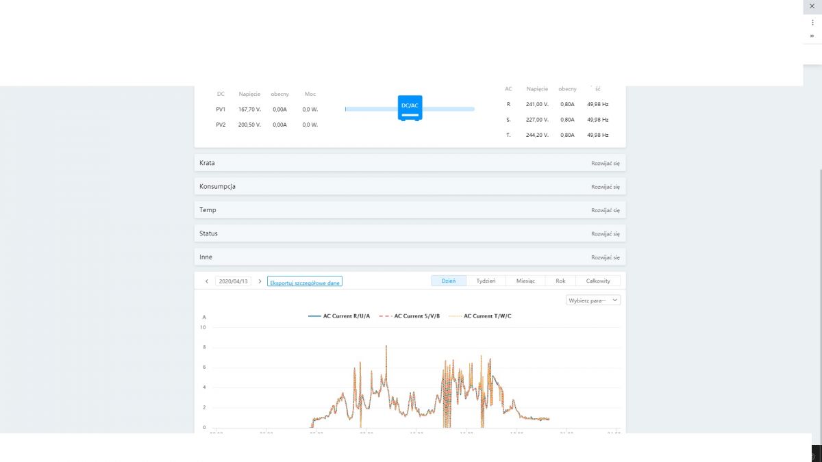

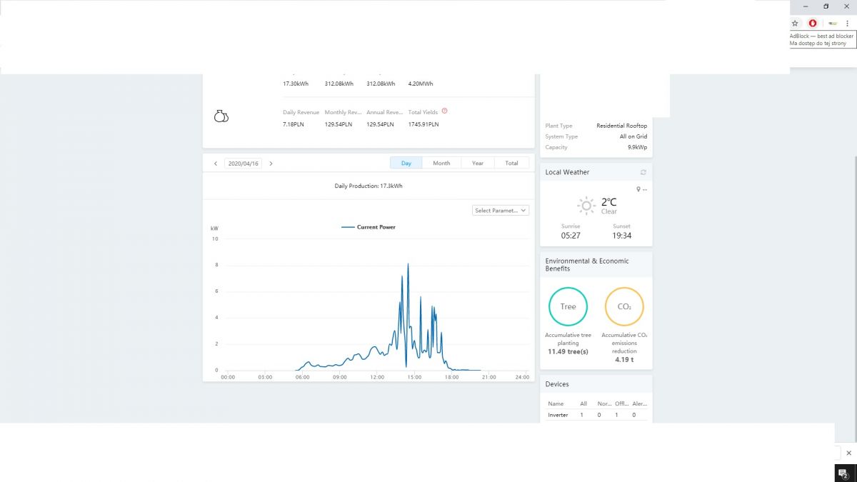

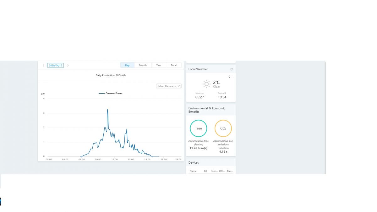

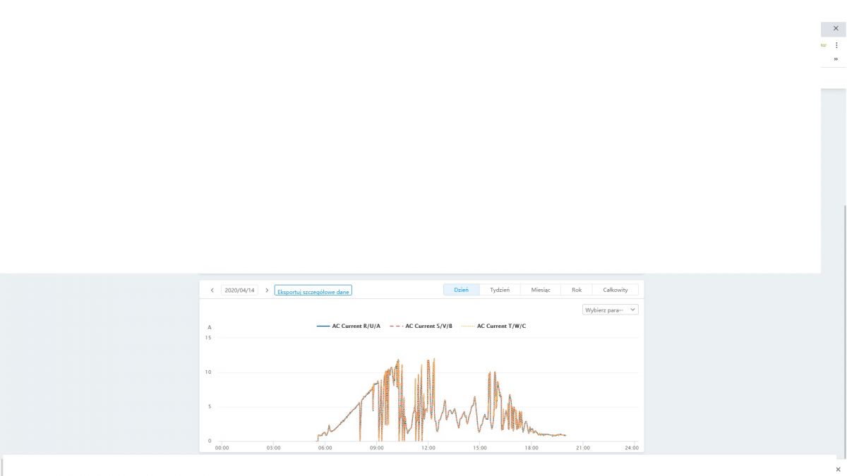

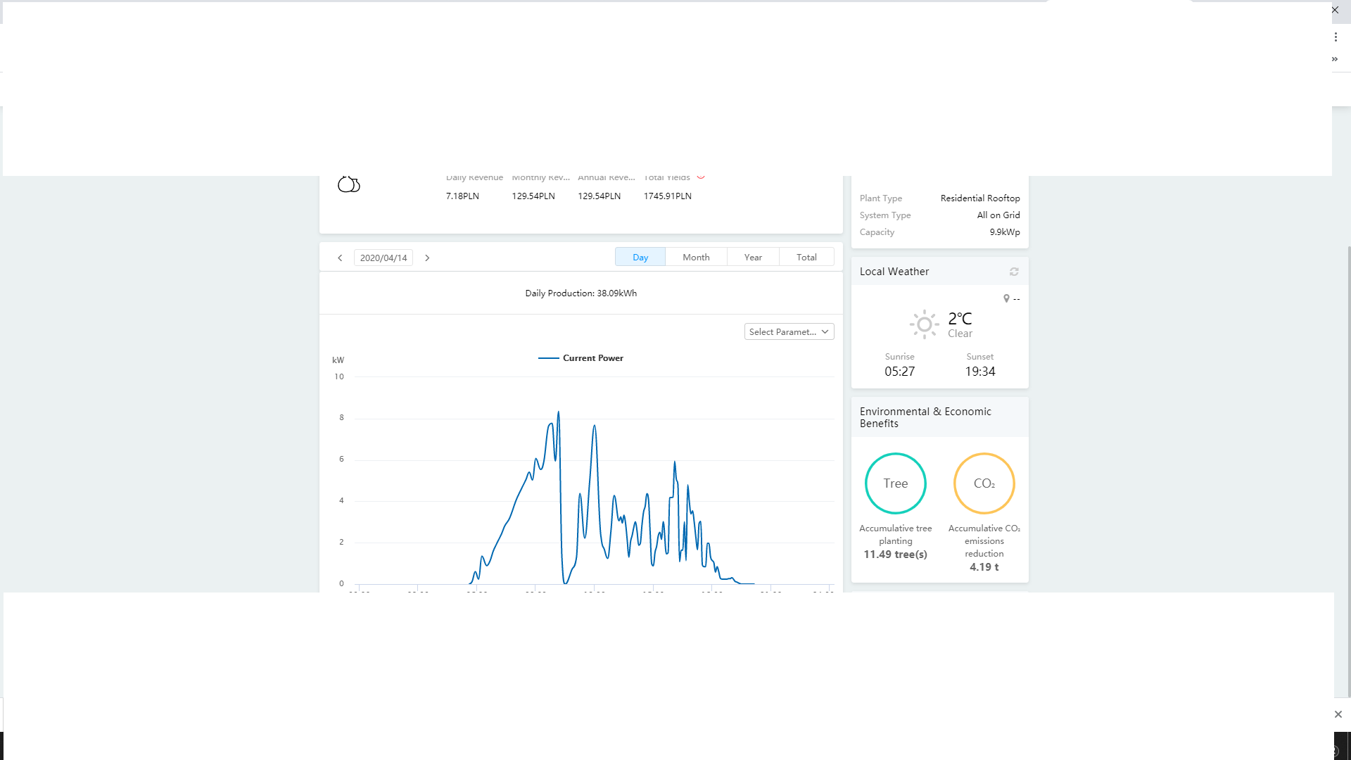

  • #131 18620852
    MariuszFEG
    I have a problem with sofar 8.8. in perfect weather it turns off and no error pops up. 37 Panels 270Wp on 2 strings are connected to it, Last year everything was ok. Only recently something has happened and the daily production has weakened by about 20% due to only the inverter and start from 0. It will be hard to advertise with Sofara without error.
    In the attachment there are charts of a perfect day.
    Please give me a hint
    :bye: SOFAR 8kW PV Installation: Opinions, Durability, Failures & Experiences with Inverters

    from these reports you can see that you have at least one bit0 error, in fact, ID01 AC voltage too high, the display should be visible and saved in the memory, you had shutdowns 8:40, 9:58, 13:44, 15:13 and maybe more, so a lot and the fault here is not the inverter which reacts correctly and turns off after a few minutes at 253
    you would need an electrician with a measuring device, measure at the connector, inverter and compare with what the inverter sees and then think what to improve
    except that in the beginning it was normal and the AC voltage was normal. Why is the inverter not throwing an error and saving nothing, why is it turning off? For a week now, I have made a preview to see why. Unfortunately, the meter shows that AC and DC are normal. Should I advertise the inverter and on what basis ??
    How to read this error from writing ?? So the problem is on the side of the Energa supplier and not PV ??

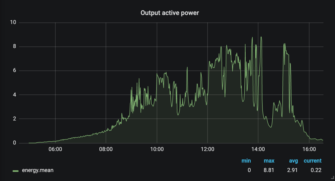

    The inverter does not turn off on cloudy days, and the AC voltage is irrelevant to the weather. Attached are photos from the last "worse" days. And on 14.04.2020 the weather was better and it turned off, SOFAR 8kW PV Installation: Opinions, Durability, Failures & Experiences with Inverters SOFAR 8kW PV Installation: Opinions, Durability, Failures & Experiences with Inverters SOFAR 8kW PV Installation: Opinions, Durability, Failures & Experiences with Inverters when he jumped on over 8kW What parameters should I give from the possible SOFAR charts ??
  • #139 18624602

    When reviewing these previous reports, the recorded voltage is 252.7 and maybe it was also higher, but check which country you have set, it should be 12 and it looks like you have 7, at least the report shows
  • #143 18625819
    MariuszFEG
    Yes, I have Netherland which is 07 set up from scratch and it was no problem. Only now/
    Will try to change.

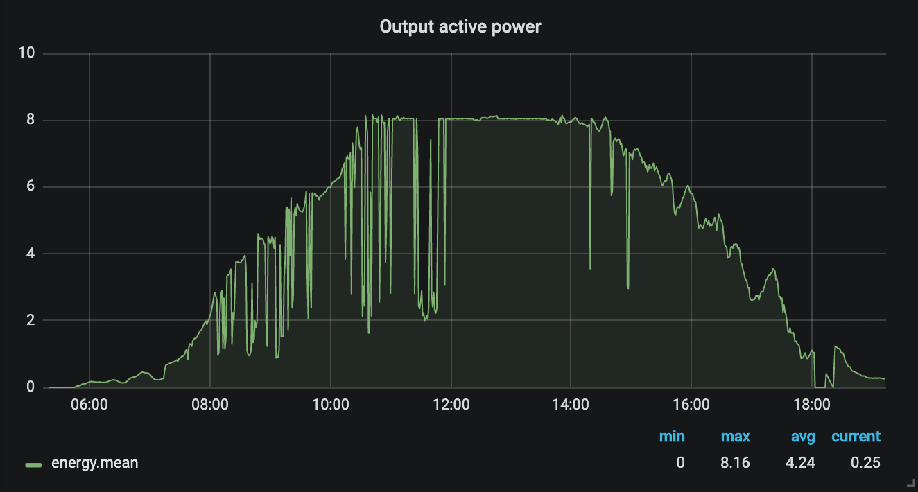

    Sure, I couldn't look at these "clippings" on the production charts every day ;-) The effect is immediate, yesterday and today the peak output broke 8.8kW:
    Before the update:

    It turned out that the customer's voltage jumped even to 280V, and the inverter turned off as standard at 253V (all right) strange that it did not save the alerts. I went to my neighbor and it was the same. The country was indeed in NL, Regards

Is the MPPT Scan function worth enabling?
Enable only when partial shading occurs; it rescans the IV curve at user-set intervals. Service says it "improves harvest under shade" but reduces output 1–2 % on clean arrays [Elektroda, 3301, post #18622124]
