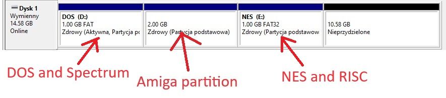

    Kickstarts:
    https://fsck.technology/software/Commodore/Amiga/Kickstart%20ROMs/
    With MD5 SUM: e40a5dfb3d017ba8779faba30cbd1c8e from post: https://www.elektroda.pl/rtvforum/topic3891155-180.html#21083506 You have: Kickstart v3.1 rev 40.63 (1993)(Commodore)(A500-A600-A2000)[!].rom

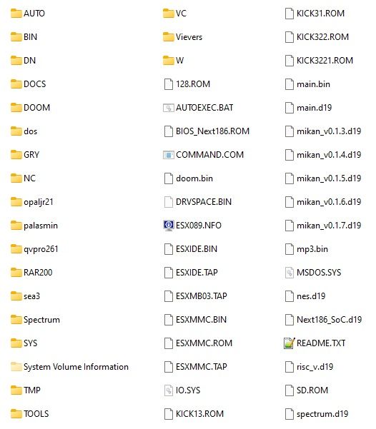

    My card is divided like this:
    Screenshot showing disk partitioning: DOS and Spectrum, Amiga, and NES and RISC.
    On first partition I have DOS stuff and Spectrum stuff and files:
    mikan_v0.1.7.d19
    Next186_SoC.d19
    spectrum.d19
    main.d19
    SD.ROM
    BIOS_Next186.ROM
    KICK13.ROM
    KICK31.ROM
    KICK322.ROM
    On third partition I have:
    DOOM folder witch all files
    doom.bin
    mp3.bin
    Contra.nes
    sample.mp3
  • Kickstart 3.2.2 and AmigaOS 3.2 are easier to set up

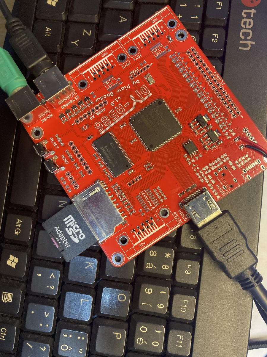

    #228 21087465
    bobricius
    Posts: 11
    missing some parts around joystick and audio
    I tame one small step forward, I can move arrow with mouse and click with WIN+ALT but still have no idea where place Workbench files.
    A printed circuit board with various connectors and electronic components on a laptop keyboard. AmigaDOS installation screen with information about a required Workbench 3.0/3.1 disk. Red PCB on a black keyboard with several connected cables. Red PCB on a black keyboard with several connected cables. .
  • #229 21087468
    piotr_go
    DIY electronics designer
    Posts: 2910
    Help: 94
    Rate: 3350
    BINGO
    Mouse buttons are constantly pressed without them.
  • #230 21087480
    bobricius
    Posts: 11
    YES. Thanks you are genius.

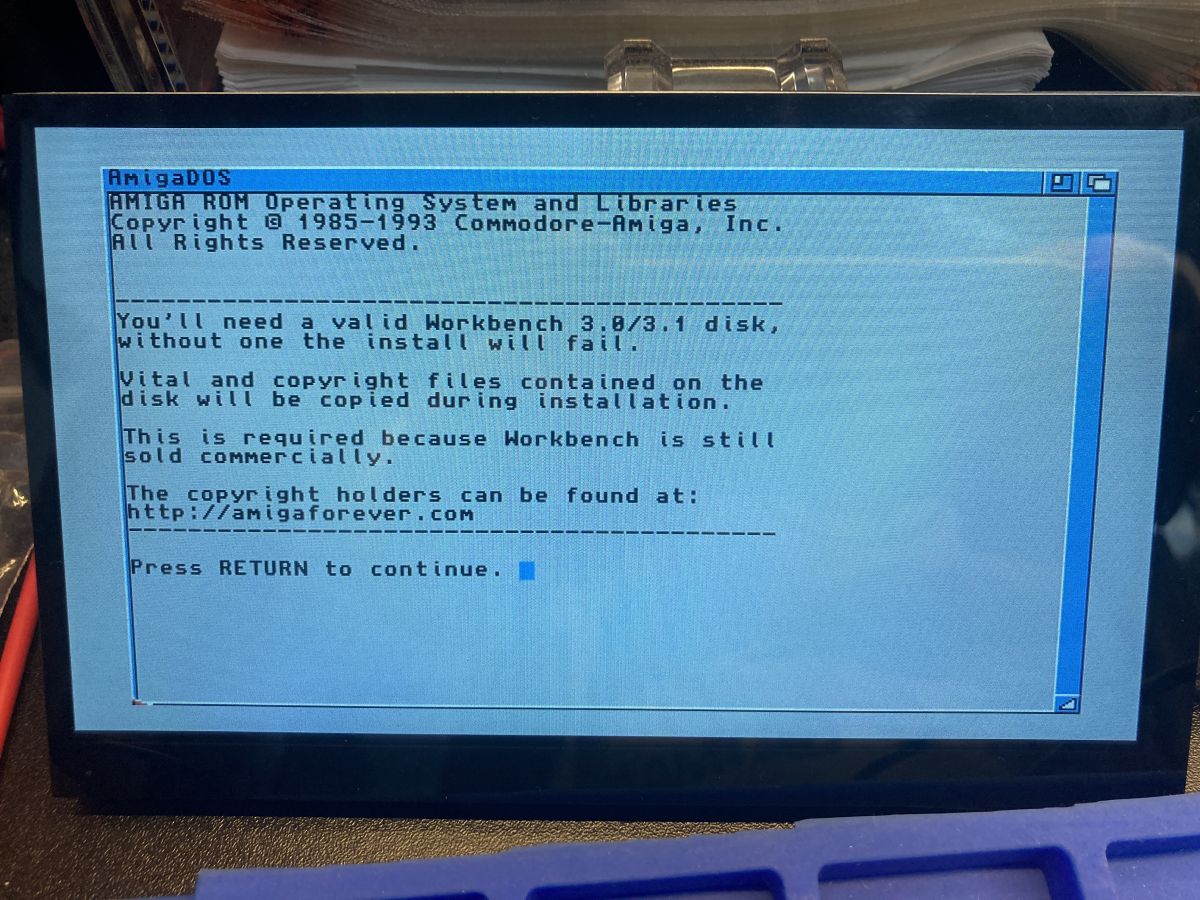

    I soldered 245 and mouse works.
    But it make new window "Please insert a workbench 3.0 disk into DF0:" and I have no idea how
    And I still do not know how to run something more on ZX spectrum except flashing K
    Well, you need a working floppy drive.

    Rate: 3350
    Floppy needed for installation (or FS-UAE).
    Sorry, we can't provide SD image with working Workbench (copyrights).

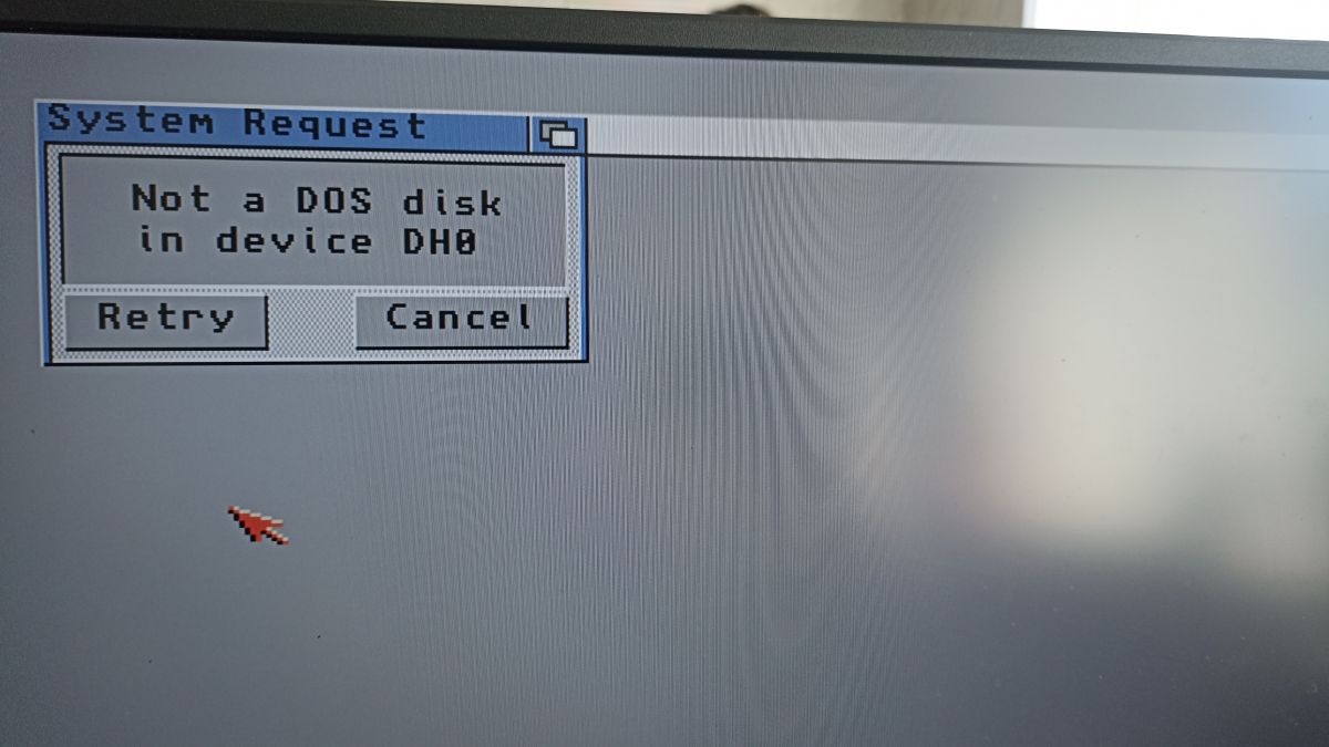

    Posts: 35
    Error message on a computer screen indicating no DOS disk in device DH0.
    Now it doesn't see the DH0 drive)))
    Generally I learned to make partitions with type F0, I record the HDF image, it loads a bit and curses to the DH0 drive
    The HDF image I have consists of two partitions, according to the instructions from Githab-System I Work, on SD it is saved as a single partition, is this correct?
