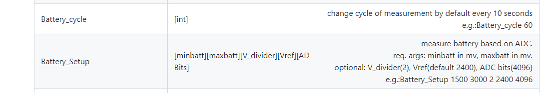

    Here is the solution for ONE type of battery powered devices I am working on right now, more of them to come.
    this is the script:
    Battery_Setup 2000 3000 2.02 2400 4096
    Battery_cycle 10
    SHT_Calibrate -4 3
    delay_s 30
    DeepSleep 300
    - Note that in my particular case 2.02 (Vdevider) is set to accurately represent the battery level, test and adjust for your use case.
    - Battery_cycle measurement is set to 10s for testing purposes, it can be adjusted as well to 12-14s (to have 2 measurements while device is awake).
    - SHT_Calibrate is for adjusting your sensor reading -2'C and +3% for humidity in my case, both values can be either + or - (confirm and adjust for your sensor)
    -Delay of 30s is there to accommodate device waking from DeepSleep and give it chance to measure the batt, get the sensor reading, connect to MQTT and publish values.
    - DeepSleep 300s is also for testing (it will eat your batteries if you left it this low, move it to 900s = 15min or more for longer battery life)
    Another thing is flags, activate flags - 7, 10, 21, 35 and 37.
    One note here after setting these notes delete your device from HA and set up new discovery for flag 35 to take effect - this will solve unavailable issue for readings after 120s in HA.
    Hope it helps - next thing on the list is to tweak the awake time for logger battery life. Stay tuned...

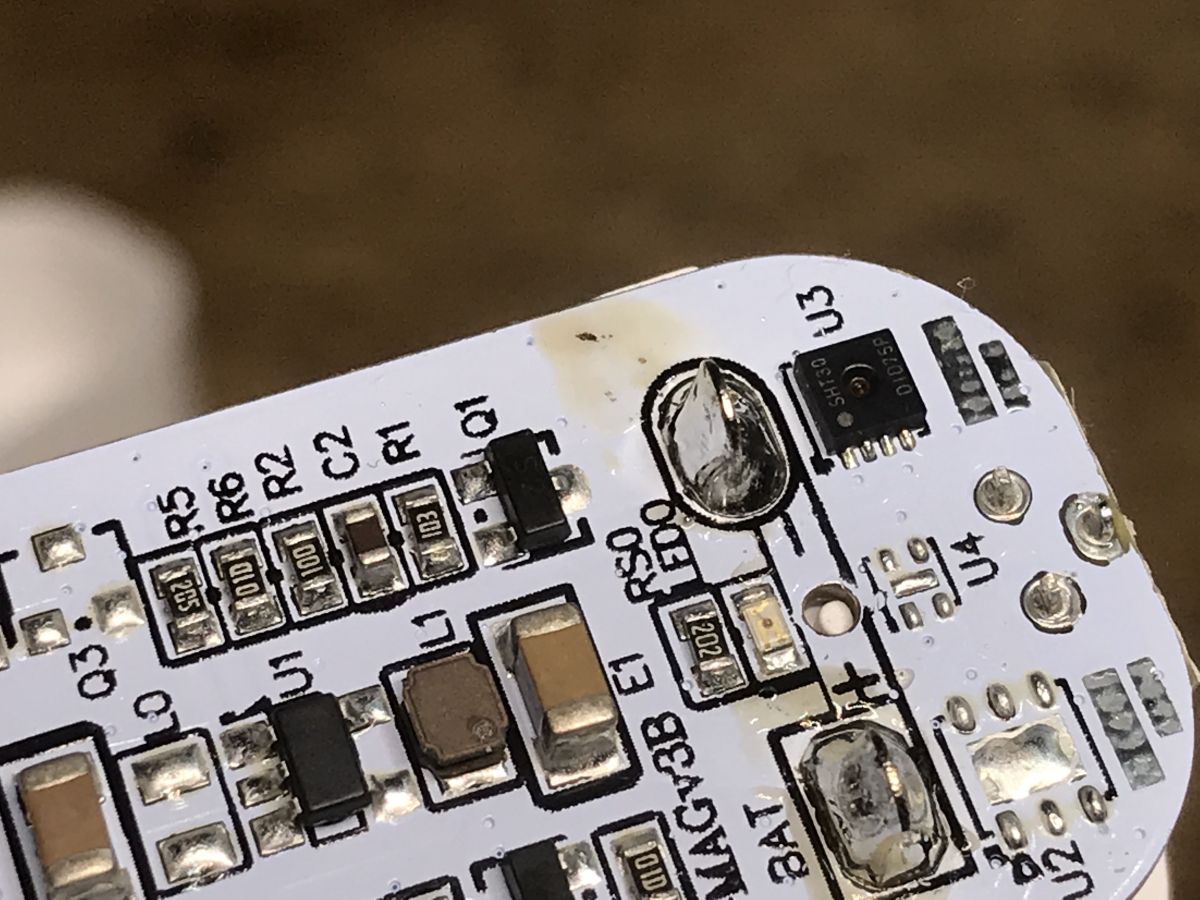

  • 120-second deep sleep reduces BK7231N sensor self-heating
    #162 20546927
    dheenhasty
    Posts: 111
    Rate: 17
    >>20544067
    In fact even if your device is on constant power source, the sensibility of the sht and the design of this sensor made the temperature reading a little bit off (that's why you need to use sht calibration ...)
    - beken heat
    - wifi led to close to sensor
    - sht on plain pcb
    - enclosure does not make air circulate
    To have not so high calibration i found that a deepsleep of 120sec is enough to permit the bk to cool down and a wifiled_n to avoid too much light on night ;)

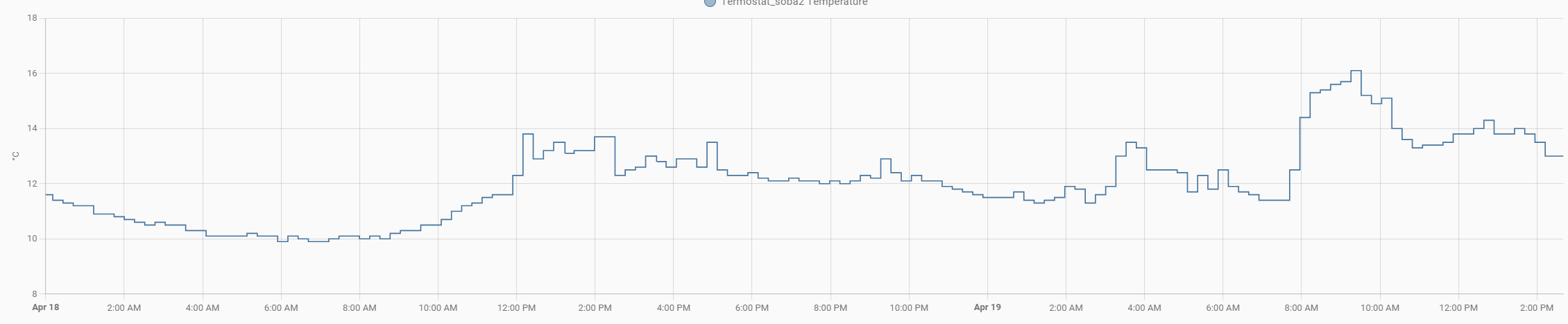

  • #163 20547031
    minchutu
    Posts: 18
    Indeed, this is what happens as soon as you dispense with DeepSleep: [BK7231N CBU] Generic Temperature and Humidity Sensor
  • DeepSleep battery log from 36-hour sensor test
    #164 20547042
    DeDaMrAz
    Posts: 621
    Help: 34
    Rate: 130
    This is my log of battery powered sensor with DeepSleep enabled for last 36 hours.
    May I disagree about DeepSleep statements and precision? :)
    Do consider the cost and the use case for this device. It is a battery powered VERY cheep device with descent precision but both of you are using it very differently than most users would. Of course that doesn't mean you can't customize it to your needs so I understand the position both of you are taking.
    My setup is generic and "user friendly" for most of the other users that may come across this project and use the device with basic, almost out of the box experience.

    I looked at the battery syntax but are there some rules to set v_divider or is it more like trial and error. I managed with a negative setup (-2.3) to get to the positive 1.34mV value but the battery % is still zero.
    thanks
  • Battery divider is device dependent and usually 2
    #176 20608109
    DeDaMrAz
    Posts: 621
    Help: 34
    Rate: 130
    Both are correct, different intervals only, I suggest the shorter one as you are aiming at very small awake time. Again familiarize with the commands you can use in autoexec.bat file and adapt them to your needs. Everybody has it's own needs and use cases and it would be impossible to fulfill them individually.
    addEventHandler OnClick can be utilized for that "test" function you would like to have.
    Maybe @p.kaczmarek2 can shine some light on this for you?
    Added after 8 [minutes]:
    minusync wrote:
    Anyway, safe mode is not truly test mode. In safe mode, I need to connect to the sensor's local network, which means I can not same time use web application,...
    Once you connect to the device in safe mode simply press exit safe mode and you will have access to web app, drivers will not load and autoexec will not be executed. You can than change the setup and autoexec and then reboot the device to get to normal/working state.
    v_divider is device dependent, usual value is 2 but it varies wildly depending on the manufacturer - so I guess it is trial and error for you.
