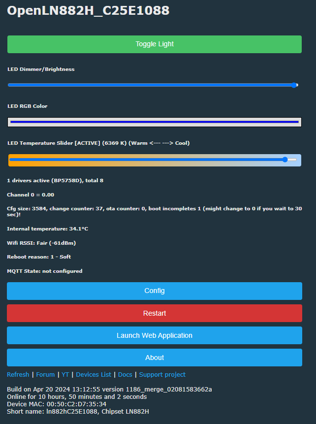

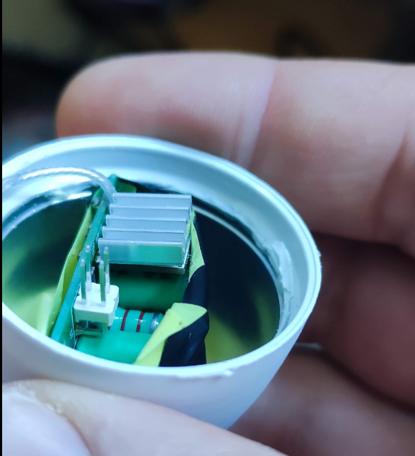

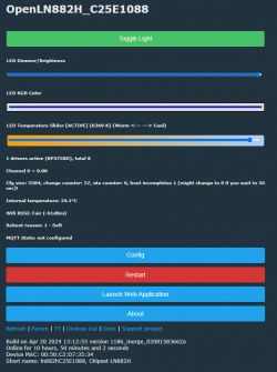

    max4elektroda wrote:
    I just opened PR#1186 as a slight extension to PR#1143:
    OK. so it's not a measurement of power use as such, but using this PR and "powersave 2" seems to be the only powersave mode so far that makes
    this bulb usable for me. Temperatures are 60+ and then it'll crash otherwise, all within a minute or two of lighting the bulb. This is with LED current limited to "BP5758D_Current 2 2".
    The longest this device has ever stayed online, with the lowest temps, with the bulb lit:
    Screenshot of the OpenLN882H_C25E1088 LED bulb management software interface.
    "powersave 2" loaded manually after boot as startup command set still means no device working and safe mode required to change back.
    I did add a small heatsink, but still it would get too hot with powersave 1. And it shouldn't need one.
    Close-up of the inside of an LED bulb with a small heat sink visible.

    Wait a moment, by "gets too hot", do you mean that you've measured the temperature externally in some reliable way, or do you base your conclusions on the internal temperature of LN882H? I don't know how well the calibration of that internal temperature may be, so I would take care with interpreting that.
    I have not measured the external temperature, no. I only have the internal to go on. The only things that are knowns are that the temperature reading is seemingly way lower with powersave 2 and the bulb stays working.

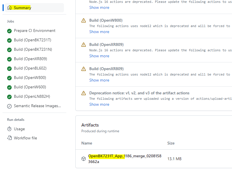

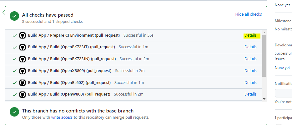

    Piorun2002 wrote:
    Where can I download it?
    Just as an additional hint to the information from divadiow:
    You need an account and need to be logged in to git in order to see and download these files.
  • #161 21055301
    Posts: 5212
    Help: 446
    Rate: 914
    or, attached
    • OpenLN882H_1186_merge_02081583662a_OTA.bin (334.46 KB) You must be logged in to download this attachment.

    I pushed an attempt to fix that, the code now sets powersave for LN882H in STA connect callback. I haven't tested it. Can anyone test?
    Full PR link:
    https://github.com/openshwprojects/OpenBK7231T_App/pull/1186
    My changes;
    https://github.com/openshwprojects/OpenBK7231...mits/68fd014f193a3e5e0ea72c203d5c74bd27a5bad8

    Quick test:
    [EDIT:]
    Sorry, first reply (doesn't work) was too fast (somehow update didn't work and I tested an other version)
    It works as expected!
    Autostart will use PowerSave 1 or 2 and Wifi is connected!!!

    Here are my results after further testing:
    PowerSave works as a startup command as expected: After connection to WiFi the measured current drawn is reduced, in my case when measureing the 3.3V current used by a single module from approx 90 mA to 50 (PowerSave 1) or 35 mA (PowerSave 2).
    When connection to Wifi is lost (router down), it will start trying to reconnect without any pause between network scans for ~ 150 seconds. During this time power is even increased to near 100mA.
    After this period it will do network scans every 10 seconds or so - current at ~ 90mA (like without PowerSave).
    When router or AP is back, it will reconnect and power drops again to the expected current.
    BUT: After the reconnect (here with PowerSave 1) I couldn't effectively change PowerSave - not to 2, even not to 0. It stayed at PowerSave 1.
    At least, that's what my multimeter showed - the logs followed the command and displayed PowerSave 2 or no PowerSave - only there was no change in current drawn.
    Trying to disconnect AP again (this time it didn't cause the "intense" try for reconnect but module used the "normal" scan every 10 to 20 seconds) and after another reconnect, it stayed in "PowerSave 0" (that was the last state I configured) even if I set PowerSave to 2.
    Testing another period with no AP (this time 150 seconds of heavy scanning) - And after another reconnect, it ended up in PowerSave 2 mode
    So there is a drawback: You can't use PowerSave as a "regular user command" any more - changes are reflected in logs, but current won't change.
    So it looks like changing this is ONLY possible during connection of WiFi.
    What we would need would be something like: only set PowerSave while Wifi is connected, not only during completion of connection ...
    Added after 1 [hours] 41 [minutes]:
    Maybe just move this code
    #if defined(PLATFORM_LN882H)
    		// LN882H hack, maybe place somewhere else?
    		// this will be applied after WiFi connect
    		if (g_ln882h_pendingPowerSaveCommand != -1) {
    			LN882H_ApplyPowerSave(g_ln882h_pendingPowerSaveCommand);
    			g_ln882h_pendingPowerSaveCommand = -1;
    #endif
    into "void Main_OnEverySecond()"
    under the case
    if (g_bHasWiFiConnected) {
    I can't promise, but I will try to code it later today ...
    Added after 1 [hours] 16 [minutes]:
    Updated the PR accordingly and installed the generated image:
    Changes see here
    During my tests everything worked now:
    - Startup command is applied after Wifi is connected
    - every change of PowerSave in the Command Tool is applied
  • Merge current powersave callback version
