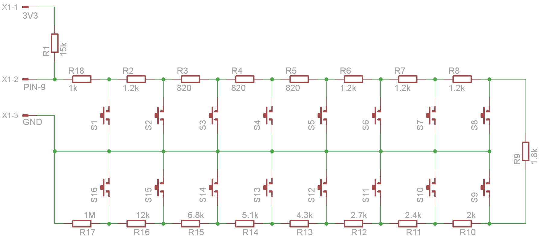

  • 1 kΩ resistor ladder wired, but keyboard debug inactive
    #1120 21513184
    DJCheester
    Level 28  
    Posts: 2089
    Help: 75
    Rate: 958
    Robgold I built the keyboard according to the scheme
    Electrical schematic of a keyboard with resistors.
    I gave the resistors 1k because that's what I had - the voltage is evenly distributed between the resistors how to now start the measurement or when I select keyboard debug in the web options it shows me ON but on the OLED or on the serial monitor nothing happens.
    Greetings ...
  • #1121 21513192
    hevet
    Posts: 347
    Rate: 47
    @DJCheester add in browser after IP address /adc

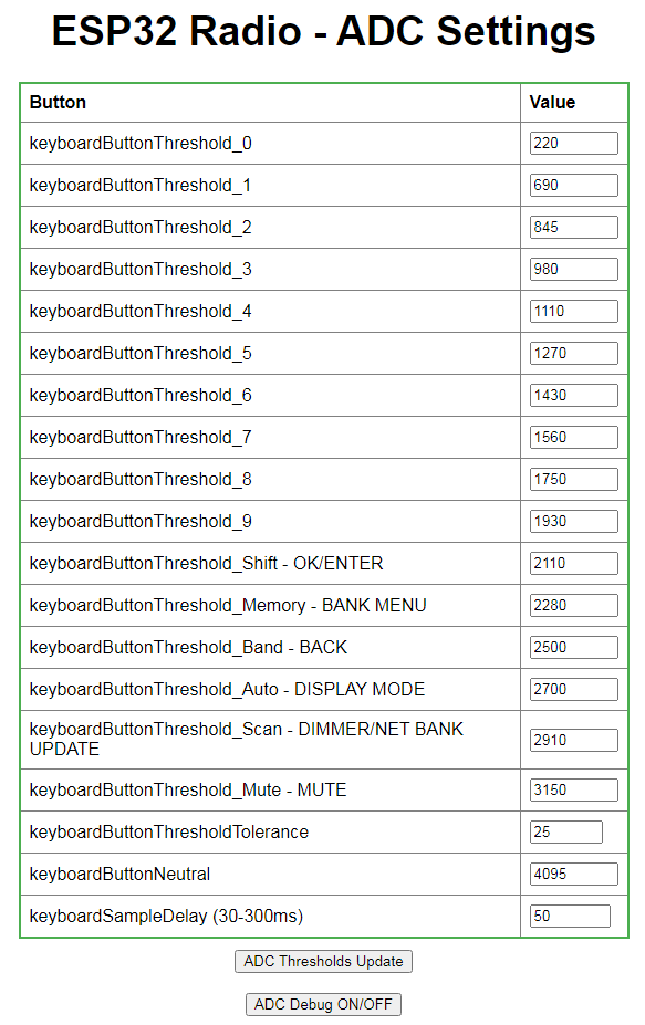

  • Adjusted ADC neutral threshold to 3850 from SD card values
    #1122 21513197
    DJCheester
    Level 28  
    Posts: 2089
    Help: 75
    Rate: 958
    Well I added and I have the thresholds I changed the neutral to 3850 because that's how much I have on the card created a file
    this is from the serial
    and after pressing (shorting) the resistors the voltage on pin 9 changes but neither in the serial monitor nor on the OLED I have a reading ???

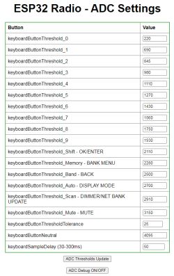

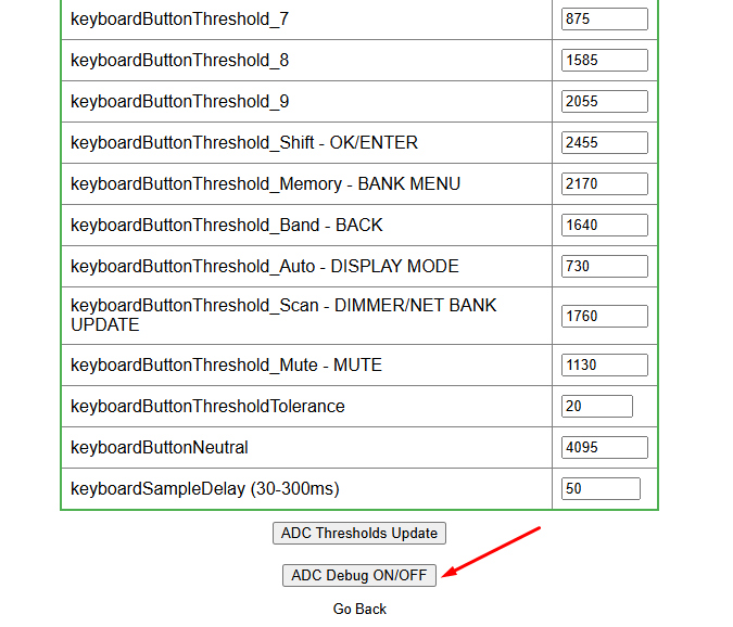

  • Added OLED ADC debug and display mode change
    #1125 21513293
    robgold
    Posts: 726
    Help: 10
    Rate: 290

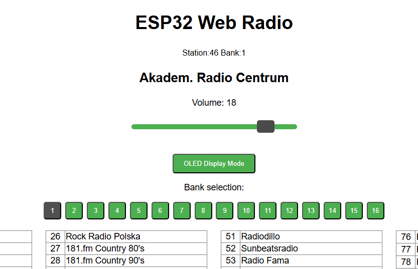

    @DJCheester please check out this mode with the option to display ADC values on the OLED. I haven't tested this at my place yet so it would be nice if you could give it a test.
    You enable this on the ADC page by clicking on the debug ADC option.
    Screenshot of ADC threshold settings for keyboard buttons with an ADC Debug ON/OFF option. .
    I have added a Display Mode change. Sometimes I too missed it and the remote control is too far away. Still will probably add a button to make the hour say. Laziness driving development to the full ;) .
    ESP32 Web Radio interface with station selection and OLED display mode options.

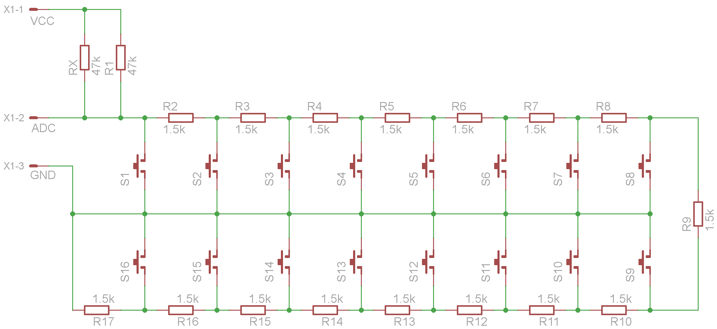

  • ADC ladder needs pull-down and fresh switches
    #1133 21513966
    DJCheester
    Level 28  
    Posts: 2089
    Help: 75
    Rate: 958
    robgold wrote:
    please check this mode with the option to display ADC values on the OLED.
    Hi I only checked this on the serial monitor where or with what to enable the reading on the OLED.
    When debugging the ADC it changes very quickly on the serial monitor.
    robgold wrote:
    I added the Display Mode change. Sometimes I also missed it and the remote is too far away.
    I also missed this ;) Thanks.
    Lechuuu wrote:
    Do you also get jerky audio on some stations? This applies to software v3.17.52 and v3.17.53
    It was jamming for me too but maybe because I was combining at the same time with the ADC
    gabar5 wrote:
    I have a reading of 4227, regardless of whether I plug in the 9 pin.
    I also get this reading when the ADC pin is hanging in the air.
    To make the ADC work properly on this pin stick a voltmeter in and the voltage should change there.
    For this to work there needs to be a resistor ladder and the switches cause the resistance to change
    I have this schematic and these resistor values, the keyboard works stably
    Circuit diagram of a resistor ladder with switches.
    The voltage spread at these values is about 0.15V for the next switch which on the ADC pretty much breaks down every 200 or so at readouts.
    With the keyboard from Sony you need to do exactly as in Robgold's photo, and be sure to replace the switches with new ones - the old ones sometimes have 200 ohms or more when pressed.
    In my case it's better because I have old disassembled switches and after wiping them they are like new.
    To keep the values stable it is worth closing the circuit with a 470k - 2.2M resistor to ground.
    The value 4227 doesn't bother me at all KeyboarButtonNeutral I have the maximum value of 4095.
    Actually, it's interesting, because a 12-bit converter should give just such a value of 4095, but I don't know where the higher value comes from.
    These are my ADC values
    Screenshot of ADC settings for ESP32 Radio with key thresholds. .
    Greetings ...

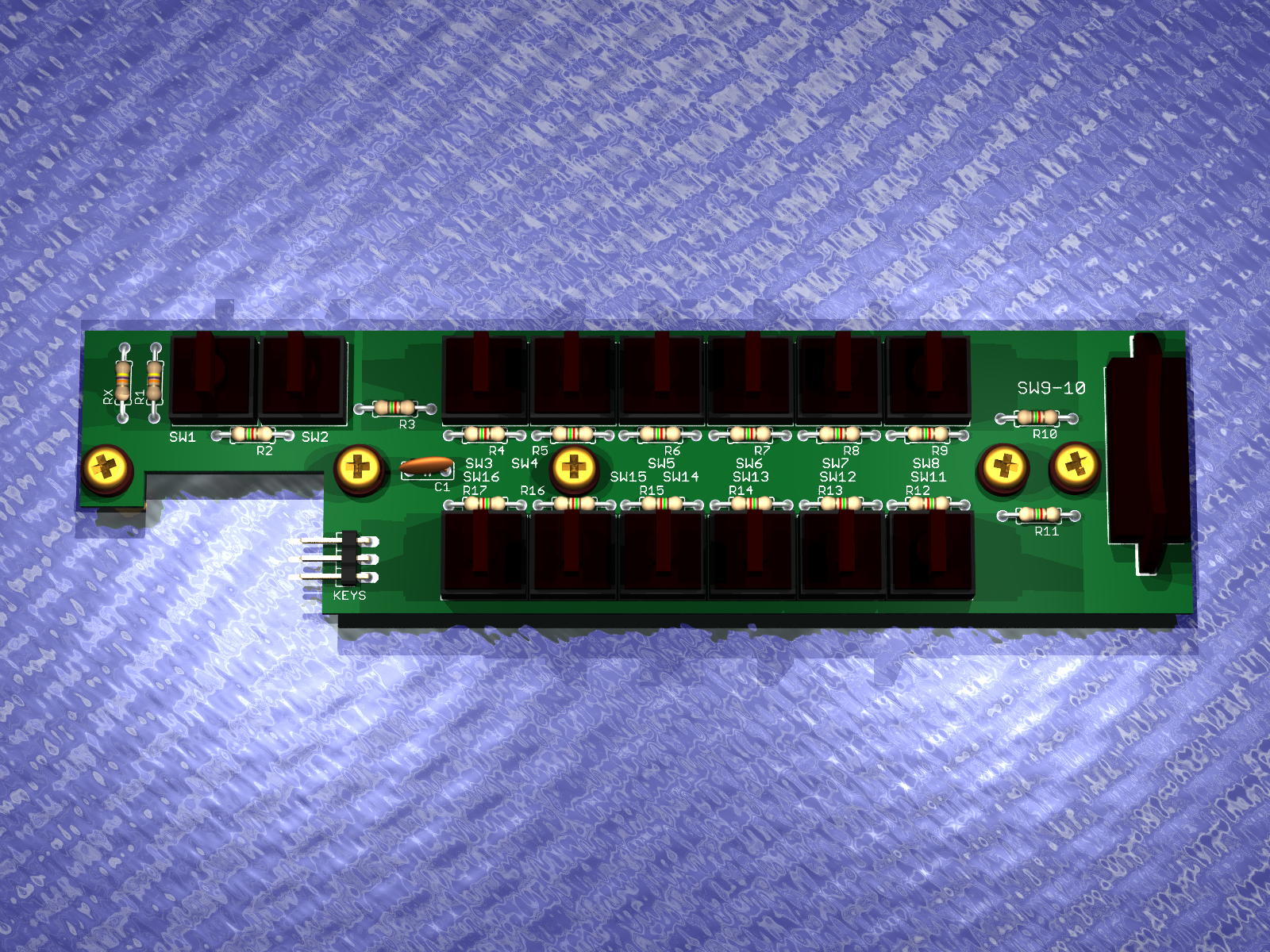

  • Web update fails to write one value
    #1135 21514102
    DJCheester
    Level 28  
    Posts: 2089
    Help: 75
    Rate: 958

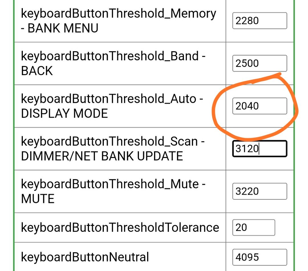

    Hello again I have a problem with updated via Web one value despite changes all update except this one.
    Table with keyboard button threshold settings, with one field marked with an orange circle showing the value 2040. .
    The value on the card remains the same despite typing and clicking update, only a manual change in a txt file and saving results in a change, i.e. reading is correct only writing to the cell does not work for me at least.
    But otherwise ok 😀 <br />
    Greetings ...
    Added after 1 [hours] 23 [minutes]:

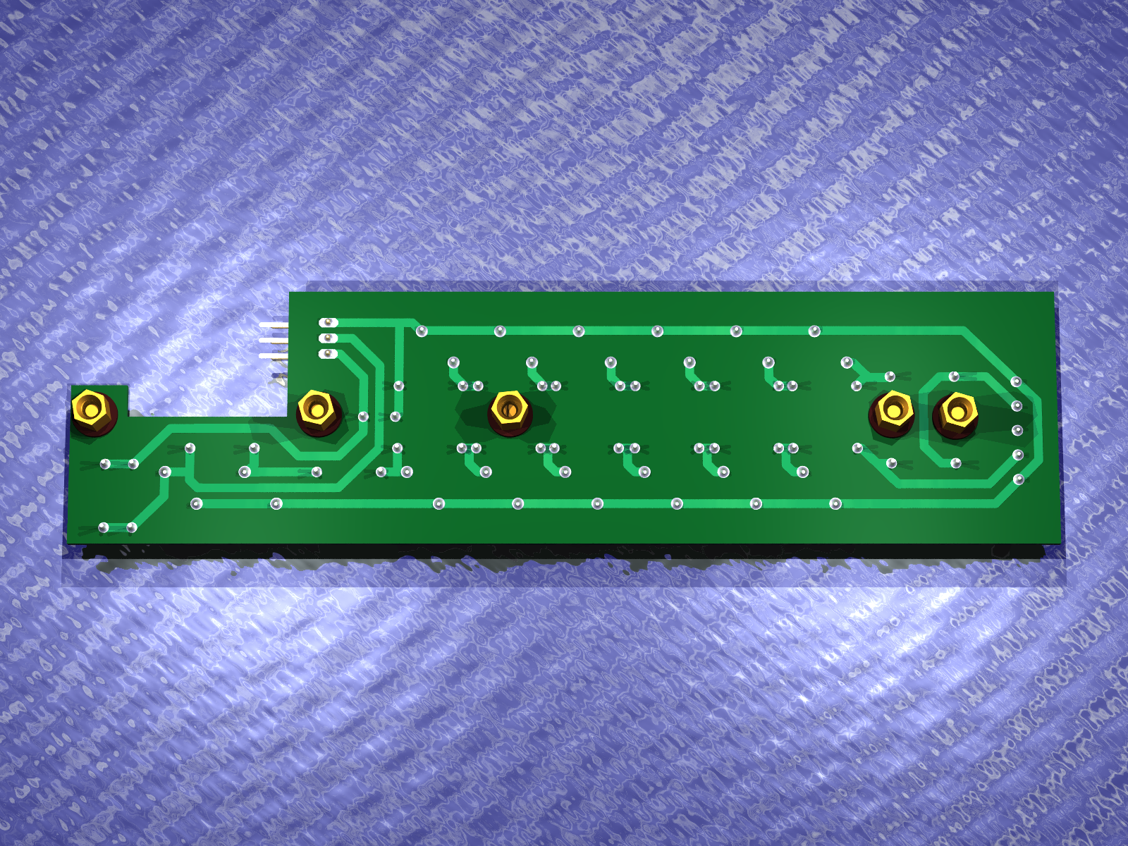

    gabar5 wrote:
    Thanks, I'll replace the switches.
    Measure with an ohm meter first when pressed it should indicate a few ohms at most.
    See if you have wired the keyboard circuit correctly as even old switches should work and generate ADC thresholds.
    It's best to make a new PCB I'm just making a new one for my hardware then everything will be securely connected.
    Image of a green printed circuit board with several buttons and electronic components. .

    @gabar5 Have you replaced the buttons ? The old keys can give you a very high resistance and then the ranges overlap. I'm not saying that this keyboard works perfectly, but it really catches very few such erroneous keys. In fact, it sometimes happened to me on the digits.
    @DJCheester The transducer has 12 bits but I read somewhere that this range is a bit wider and therefore you also get measurements above 3.3V. Regarding the value of keyboardButtonThreshold_Auto - Display Mode I actually forgot to include it when updating the variables to write. I will upload a corrected version later.
    Additionally, there will be some change. We are going back to one loop refresh of scroller and VUMeter as it was 3.17.36.
    On stations playing with autoDJ at night (RMF Classic) where Stream Title is refreshed every 2-3sec (includes a counter for the watchdog) the two loops cause the display to flash. Almost invisible, but still... VUmeter trinkets are nice, but they absolutely must not cause the radio to become breathless or have any stream problems. So there will be one adjustment setting for both Scroller and VU Meter. A setting of 50ms seems optimal.
    As for the keyboard, solder one on a universal board. Stylets are not suitable for such things. In addition, if you change the ESP module you will have to recalibrate the keyboard.
  • #1137 21514499
    gabar5
    Posts: 64
    @robgold Well I just didn't swap and that's probably the cause, I'll sit down to it in the evening, although I'm surprised that in debug mode they catch fairly constant values and work reproducibly, but after saving to file it doesn't work, I've only saved 4 buttons and it's also a moot point.
    Oh well, I'll replace the switches and the performance will probably improve.

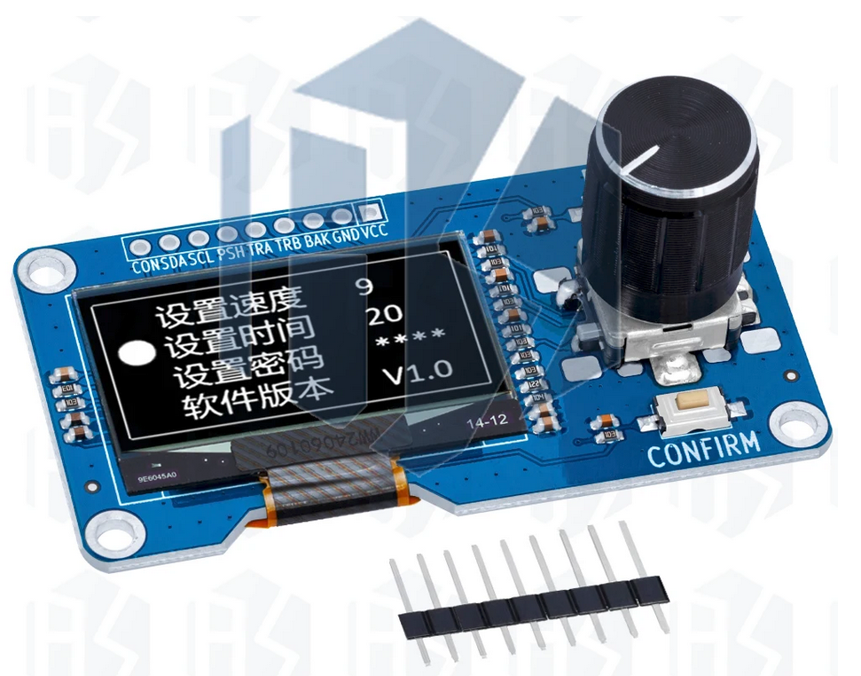

    You are so combinative with these panels, and the Chinese have produced a finished panel .
    Small electronic panel with a blue PCB, 1.3-inch display, and knob. .
    I bought it in combined offers with a 1.3'' display at a discount for PLN12.
  • Need for custom PCB to fit tuner front panels
    #1139 21515856
    DJCheester
    Level 28  
    Posts: 2089
    Help: 75
    Rate: 958
    rysin wrote:
    You are combining so much with these panels, and the Chinese have produced a finished panel .
    You see I am combining because I want to be able to decide whether I use an encoder for myself and which OLED I use. This is the essence of DIY that everyone can do as they wish, buying this once that under our code probably will not approach and two this Chinese cheap something unfortunately I do not like because too small OLED and when buying such toys practically less and less is your work in these projects.
    We (some of us) are planning to mount the radio in old tuner housings, which involves individual layout and adding keyboard circuits, and unfortunately this Chinese module is useless for this.
    Apropos of that, many of you are planning to convert a Sony tuner, if I had such a tuner or the front panel itself, I could dimension the PCB and design the circuits for the keyboard to be compatible with our radio. At the end one would create Gerber files and the Chinese would make such a PCB as needed.
    Greetings...

    @rysin
    The display module you found is nice but not suitable for this project without a lot of interference with the program code. Firstly it has less resolution secondly control over i2c. All graphic functions to be rebuilt. Obviously doable but it's long hours of writing and "debugging" the code.
    @gabar5
    I connected a Sony keyboard to my radio for a moment. It works brilliantly. Two values were to be calibrated but the rest works fine. The display of the values on the OLED from the ADC also works fine.
    @DJCheester
    The board on the Sony is quite complex in shape, lots of milling for the mounts and on top of that it is very large. So I did a quick count about it about $65. Quite a lot, the one that is after desoldering does its job quite well. I think for 1-2pc it's not worth redrawing it.
    I uploaded version 3.17.58 to GitHub Link .
    This version runs on a single millis loop, by adjusting its refresh we also affect the VUmeter. As it solves the problem of stations transmitting the autoDJ counter we will return to a separate adjustment. ADC recording is corrected. Now all variables should save correctly. There is a button to change the OLED mode on the web page. New way to control brightness using SetContrast instead of setting registers. This should work for displays supported by the u8g2 library and not just the SSD1322.
