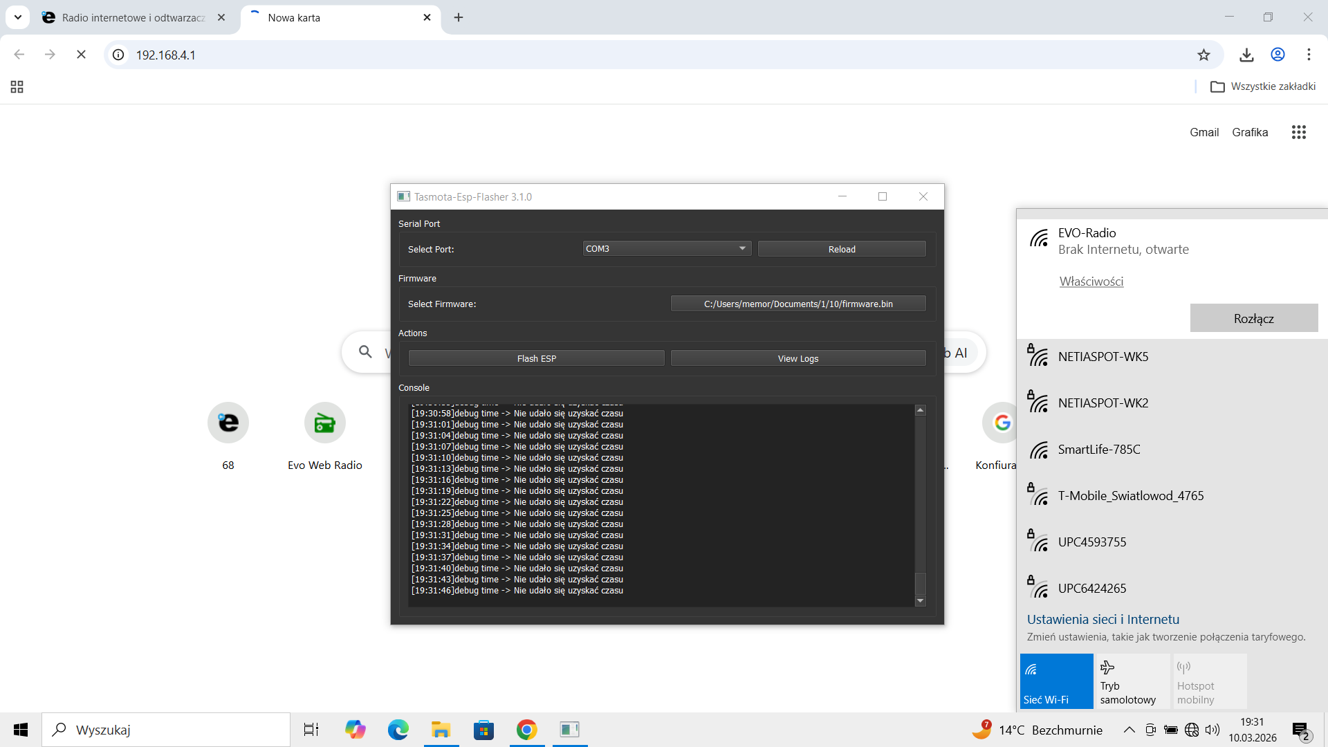

    wieslaw6504
    Posts: 10
    >>21859048
    ESP-Flasher
    I've already uploaded so many times and different ones never had any problems.
    I will upload immediately and write what came out of it.
    Added after 13 [minutes]:
    >>21859239
    Not working.
    • Internet radio and audio file player on ESP32-S3 Zrzut ekranu (10).png (145.97 KB) You must be logged in to download this attachment.

    Ejcon probably specified a bin to be uploaded via OTA.
    Win Robgold's soft as you write that it laughs and through the site via ota win ejcon's bin.
    Also, start using ESP Flash Download Tool to upload to ESP.
    Regards...

    >>21859261
    This is the Wifi manager page and for it to work you need another device (phone/computer) to connect to the Radio-evo hotspot which the radio puts out as it cannot find the configured router.
    Greetings...

    If you have had anything on ESP before, he suggests cleaning SPIFFS.
  • #2470 21859272

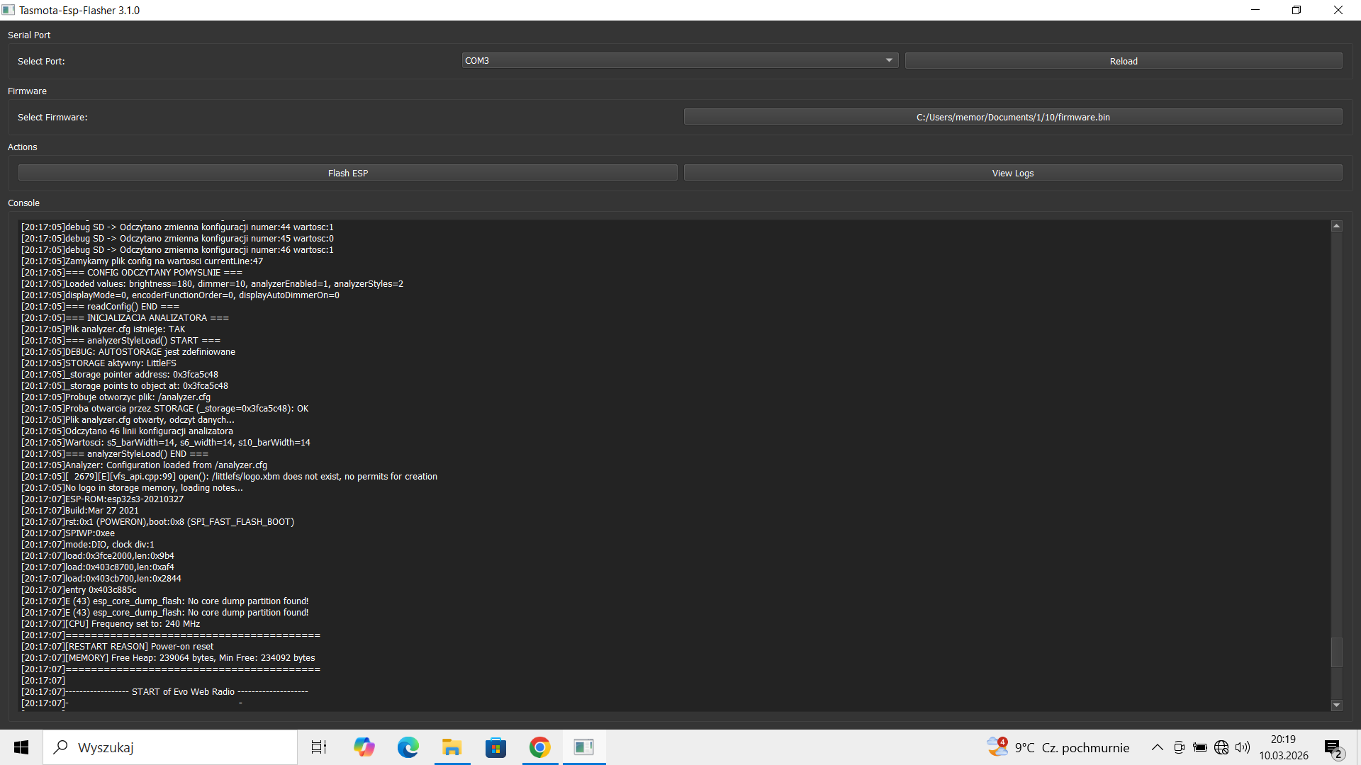

    It's which bin doesn't work for you because I don't know now you've stated that it doesn't work and pointed to a post with ejcon content and now you're writing that it works.
    Describe exactly the problem, what are you winning like whether it compiles are or not and not one sentence answer it will be easier to guess.
    Regards...

    >>21859276
    ESP32_radio_evo3.20.04. works loads the page through the browser and on the other hand this EVO 3.20.04MOD CAL does not work.

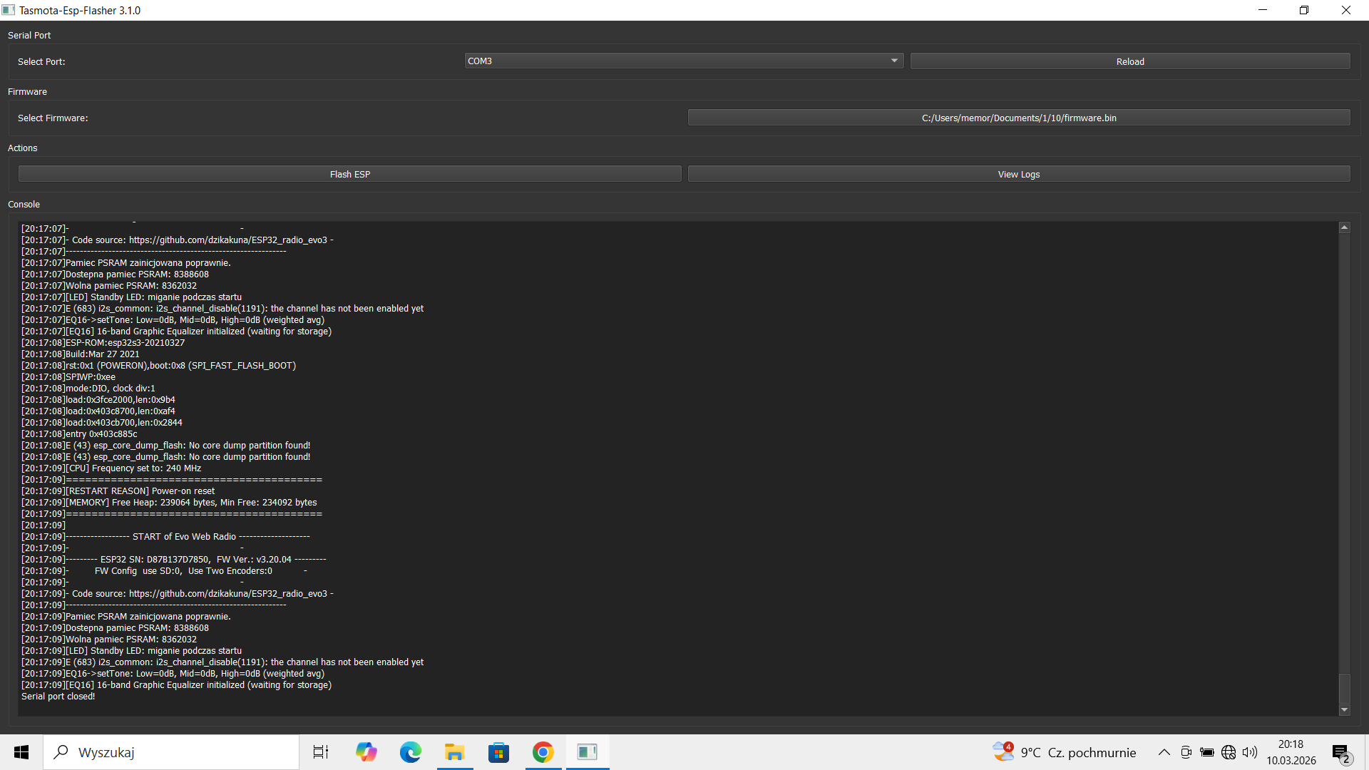

  • #2476 21859308
    wieslaw6504
    Posts: 10
    >>21859299
    I think I'll leave it alone for now
    this is what it looks like after uploading
    Added after 49 [seconds]:
    >>21859308
    • Internet radio and audio file player on ESP32-S3 Zrzut ekranu (11).png (114.84 KB) You must be logged in to download this attachment.
    • Internet radio and audio file player on ESP32-S3 Zrzut ekranu (12).png (120.81 KB) You must be logged in to download this attachment.

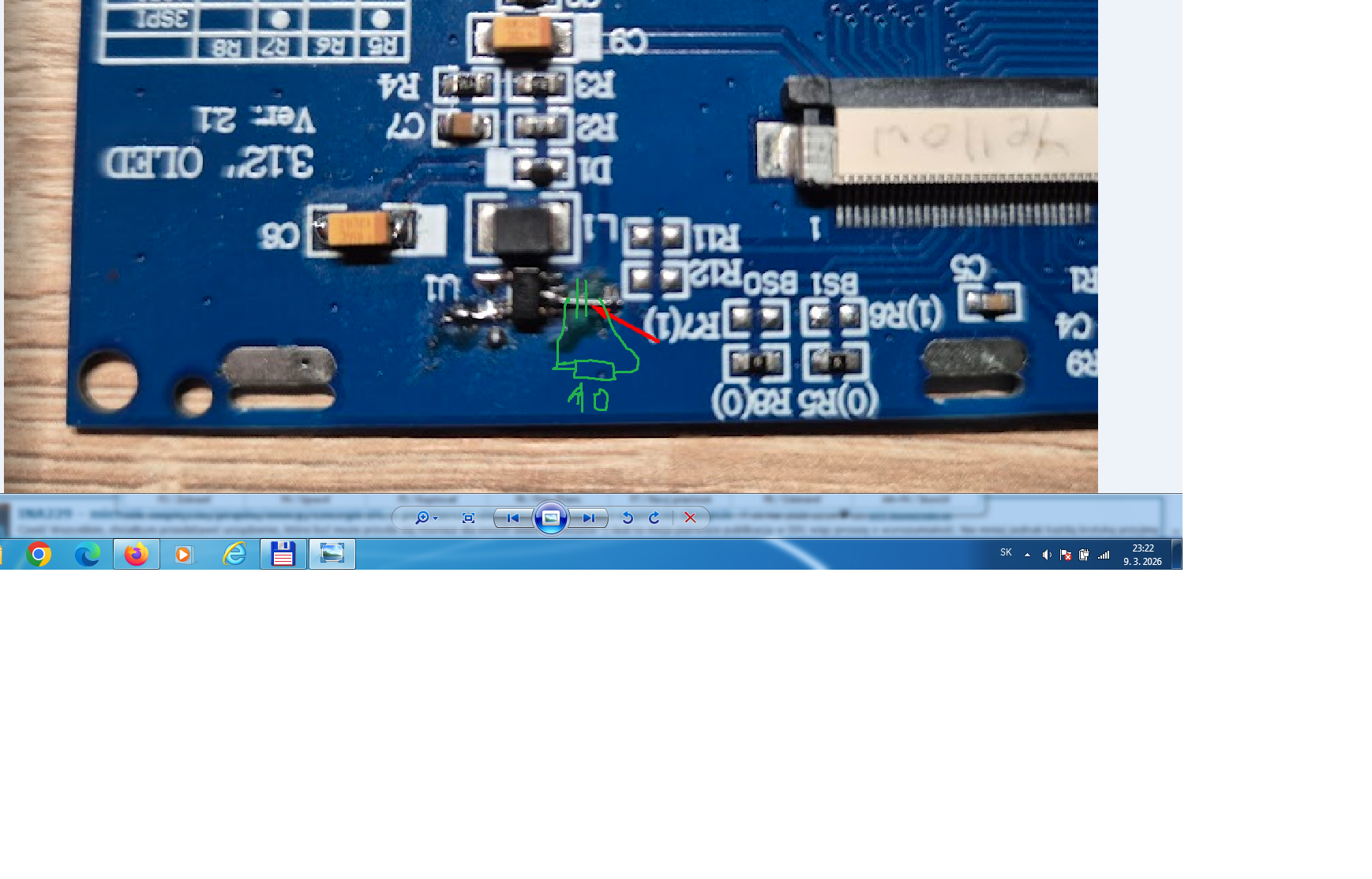

    Hi, I am not sure, but on GPI0 18 v verzija Robgold 3.20.04 there is no control, there is fixed 0,3V.
    Added after 8 [minutes]:
    >>21855332
    Hi.
    Myslalesz tu do vyswjetlaca dp massy vstavicz 10 ohm rezistor a to brzecenje, brucanje przestane slychacz?
    Close-up of a blue PCB with SMD parts and handwritten markings indicating a 10-ohm resistor

    >>21858802 @DJCheester I'm not convinced that you can't use for compiling Majster libraries to FLAC. Especially as I now compile them myself and I know that it agrees correctly the core number with the number from which the library was recompiled. I will download the Majster soft and check it out then this library swap seems unjustified.
    @supsak
    There is no control on GPIO18 in Evo as of today. Perhaps colleague Ejcon added something in his version I will only add it.
    In OLED a resistor MAXIMUM of 2.2 Ohms and 1-1.5 Ohms is recommended.
    Start by adding 10 Ohm in the DAC power supply ground. Raising the converter ground will always have a negative effect on the converter voltage.

    Hi.
    I have now a 10 ohm resistor to ground on the OLED-display, I think it is too much... I have to change the VU meter is no longer visible, it flashes, switching on the banks is not correct.
