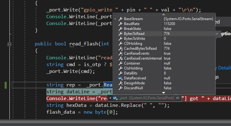

    Strange, looks like it gets stuck in flash_program, but maybe I need to give it bigger timeout. Hm, I used 200ms and original code has 1s

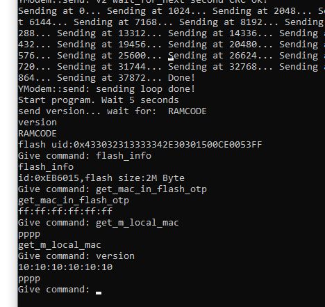

    I've found my dev board.
    https://www.elektroda.com/news/news4062695.html
    It breaks after first flash read send, it timeouts, but only when it comes to sending reply, not when sending...
    [Youtube] LN882H module pinout and setup for flashing - step by step video guide
    Hmmm... could it be that internal UART buffer is too small? no... or wait... there are bytes to read?

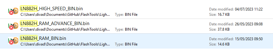

    hmm. are these 5s delays really necessary too? LN882Loader had them originally at 10s but then the author changed it down. 5s for baud change ack??
    ALSO. Not that this helps probably because it should work with the same ramcode file, but if you change to the 17k LN882H_HIGH_SPEED_BIN.bin one
    it does flash and OBK booted
    dump no change with diff ramcode

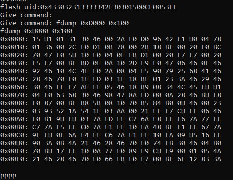

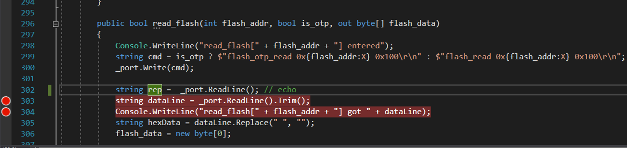

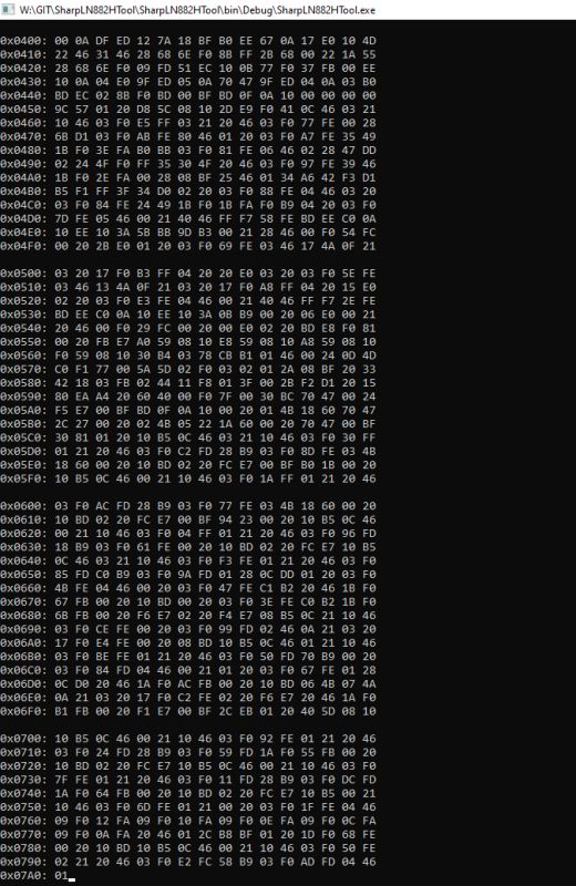

    I added custom read function on c# side and it goes futher
    Added after 8 [minutes]:
    very interesting findings @divadiow , I wasn't aware about that. I'm not sure about the delays, maybe it could retry communication quicker and just allow for it to fail silently.
    By the way, it currently reads flash in 0x100 chunks, futhermore, the read is done via text - ASCII. So two chars per byte. So already twice as slow as it could be.

    It literally sends this string via uart:
    flash_otp_read 0x0 0x100\r\n
    for each offset, step 0x100 bytes, and reads reply in format:
    AE BE 4F 2D 5A
    etc etc, with spaces, so 3 chars per single byte.

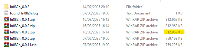

    cmd_mode.c from your attachment has some commands used in flasher but not all of them?
    Code: C / C++
  • #102 21607218
    Posts: 5039
    Help: 438
    Rate: 891

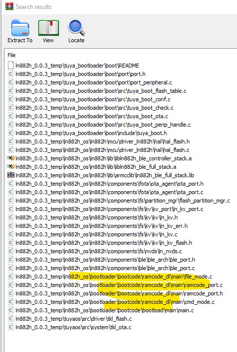

    oh. 🤷🏼‍♂
    it's taken from v0.0.3 which seems to be the latest Tuya zip that has that in. File dates are Jan 2023.
  • #103 21607240
    Posts: 14591
    Help: 654
    Rate: 12612

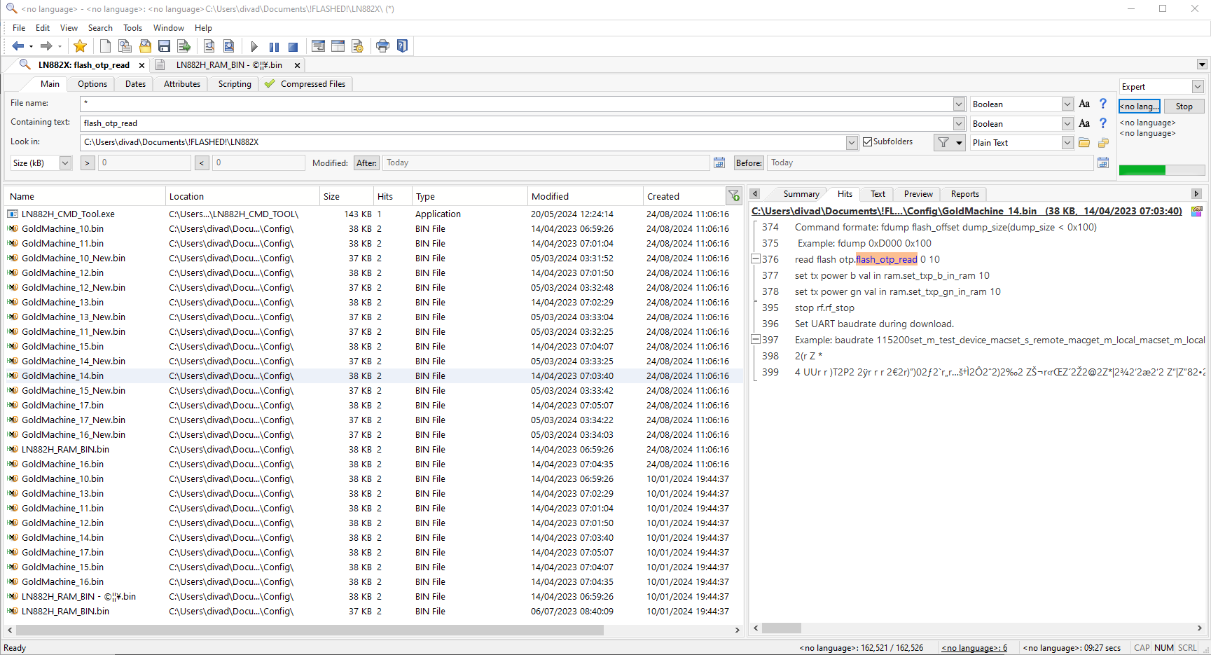

    Maybe it's in other file, search for flash_otp_read and flash_read

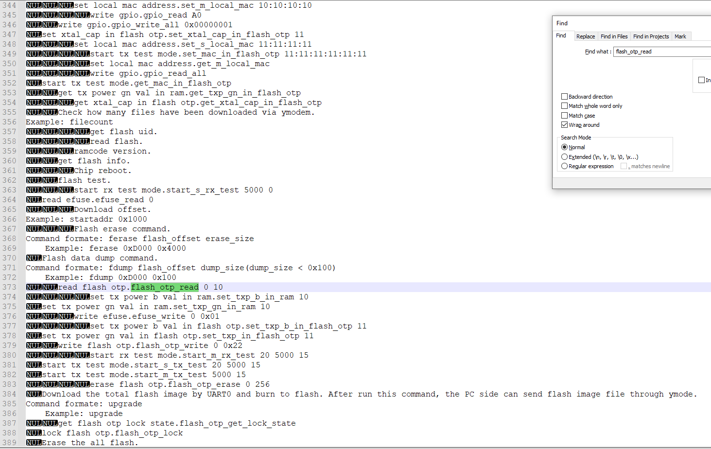

    >>21607240
    plenty for "flash_read"
    fdump
    nothing for flash_otp_read

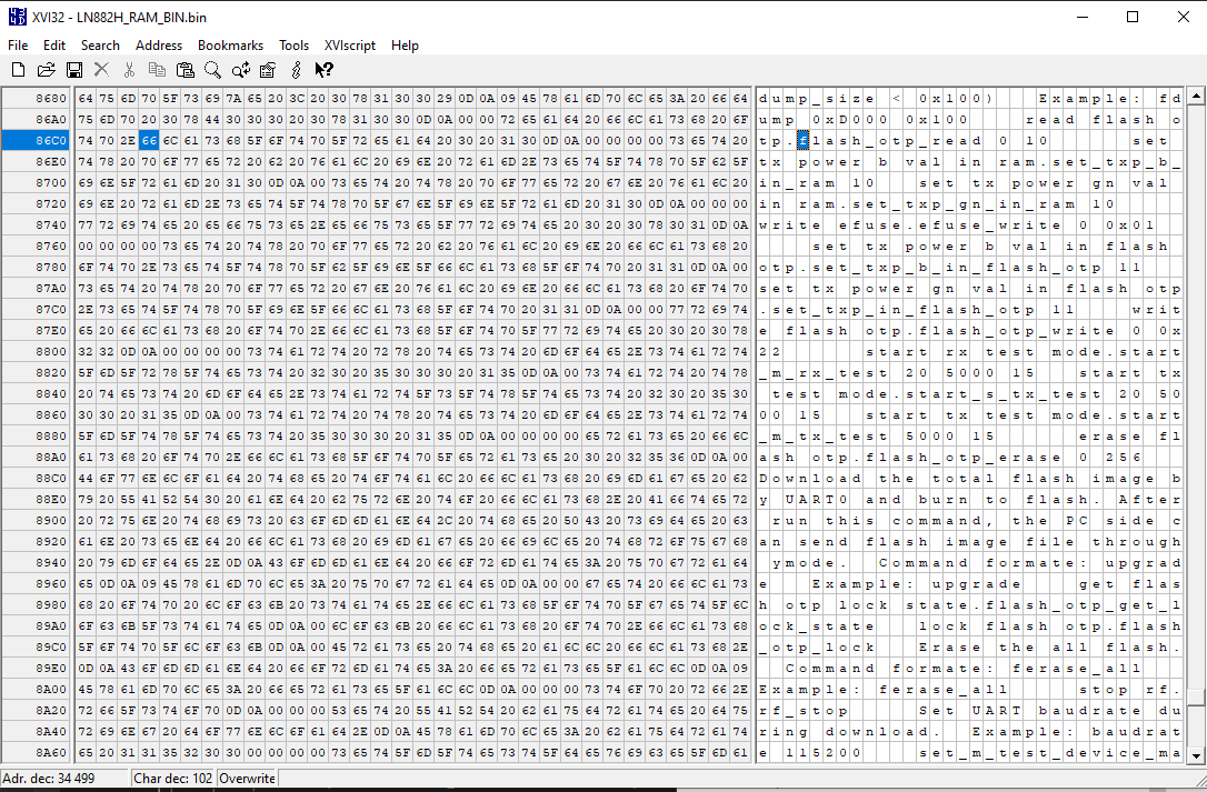

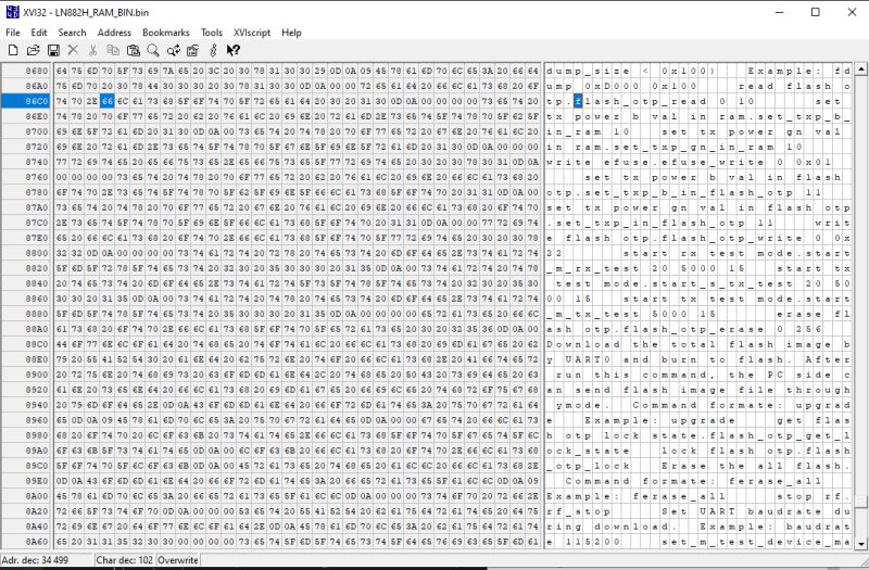

    https://github.com/search?q=flash_otp_read+ln882h&type=code
    https://github.com/search?q=flash_otp_read&type=code
    The function flash_otp_read exists in the RAM binary as ASCII string as well, or, should I say, it's obviously an ASCII string because it's send over UART as ASCII, so if your package does not have flash_otp_read, then it's most likely not the correct source code of the LN882H_RAM_BIN.bin we have...
    Btw this bin comes with help text:
    I probably could add a "terminal" mode to Sharp LN882H flasher where you can type any command to play around with it

    just doing a big search. anything catch your eye? as before, nothing in all Tuya LN zips for flash_otp_read

    Now that i looked at the code, why flash_read is used instead of fdump?
    flash_read is very limited from what i can see (0x100 in single read?), while fdump can read several sectors.
  • #109 21607286
    Posts: 14591
    Help: 654
    Rate: 12612
    I saw fdump but:
    Command formate: fdump flash_offset dump_size(dump_size < 0x100)
    	Example: fdump 0xD000 0x100
  • #111 21607297

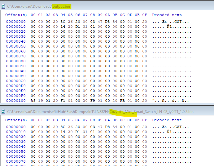

    will do proper dump then convert from hex asap, but as a quick test here is dump test with sharptool matching bytes of real Cozylife LN dump

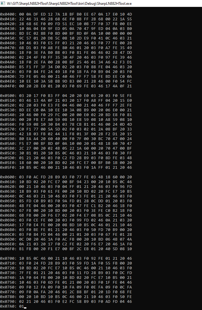

    I got it to compile (the one from SDK) with keil, but it prints this:
    version
    ERROR
    Not found <"  > command!
    Added after 3 [hours] 30 [minutes]:
    Managed to create a more or less working ramcode for flash reading only.
    Baud is 460800, if 921600 or more it always fails to pass a CRC check early into reading.
    Full flash dump in about a minute.

    Ramcode attached. Though even with 460800 baud i once encountered CRC error.
    Also attached exe, dump is always on.

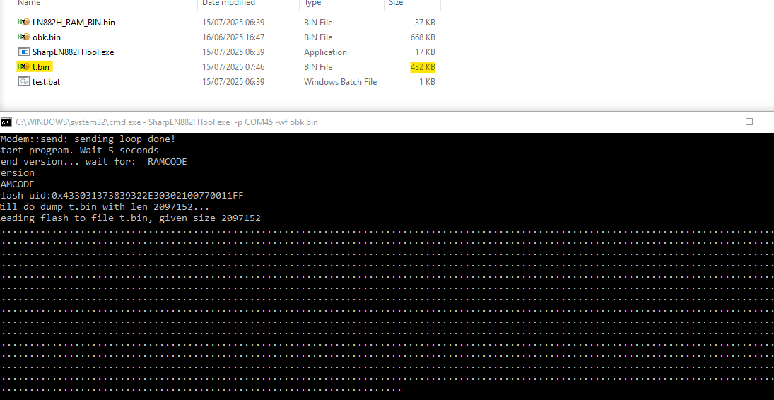

  • #118 21607732
    Posts: 5039
    Help: 438
    Rate: 891
    yes, crc every other go. took 50s/2mb

    >>21607732
    Every other go? I've had it like once in 10 tries. Wonder why...
  • #120 21607736
    Posts: 5039
    Help: 438
    Rate: 891
    my sample size was too small to be definitive. I'll do 10
