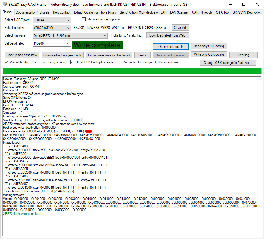

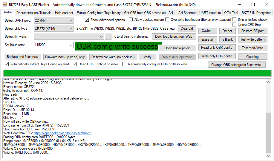

  • Shared XRadio flasher hierarchy with range erase
    #332 21926675
    Posts: 5246
    Help: 451
    Rate: 921

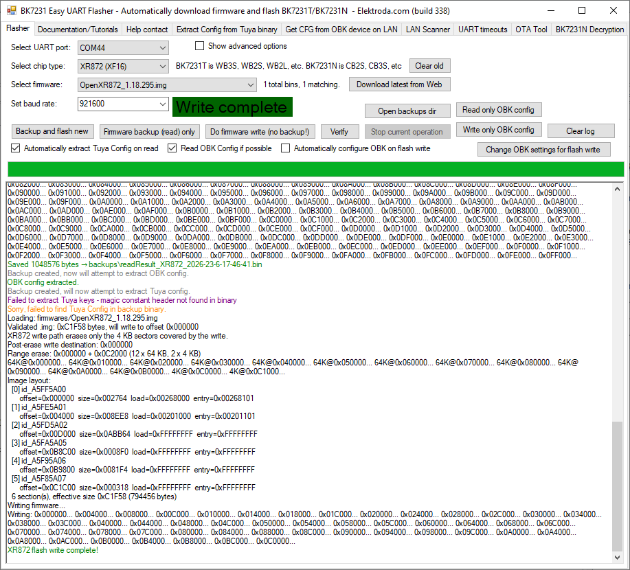

    divadiow wrote:
    XR refactor
    Refactored XRadio support into a shared flasher hierarchy for XR806, XR809, and XR872/XF16: https://github.com/openshwprojects/BK7231GUIFlashTool/pull/140
    -no longer erases whole chip before write - 64kb/4kb range erase to cover size of image to be flashed
    -full erase still does whole chip command
    -OBK config read/write
    tested XR806, XF16 and XR809.

    #337 21926795
    Posts: 5246
    Help: 451
    Rate: 921
    yes. I have done quite a few tests on XR806, XR809, XF16 at different bauds. read, write, read+write, erase. OBK and flashdumps continue to boot as expected.

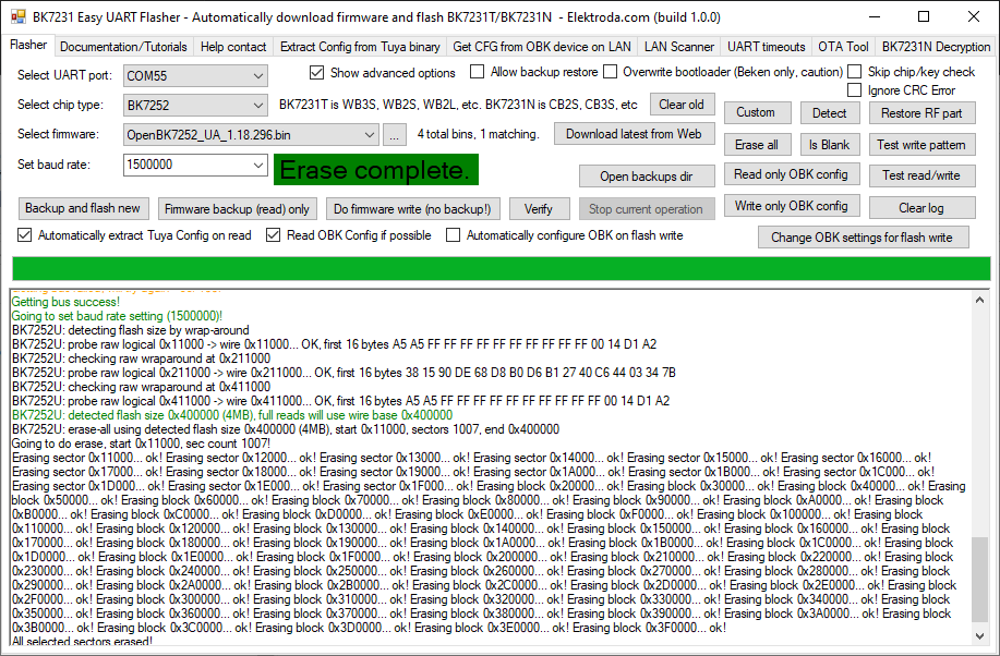

  • #344 21927473
    insmod
    Posts: 1433
    Help: 168
    Rate: 455
    I've optimized it even further, and it's now 3 times as fast as previous version.
    Overall, it's about 8-10 times faster than the latest release.
    Sber: 80ms->9ms, uascent: 21ms->2ms.
    No heap allocations at all, only preallocated arrays/spans and stack allocations.
    However, i've made it execute synchronously to make use of spans and used a lot of unsafe code.

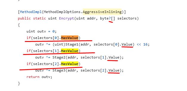

  • #345 21927507
    Posts: 14814
    Rate: 12986
    I wonder if those methods marked with AggressiveInlining are really inlined? Second question: is NULLability used there?
    Screenshot of C# code showing Encrypt method with HasValue and Value checks highlighted
  • Miniz integration needs 300k heap and overclocking
    #347 21928038
    insmod
    Posts: 1433
    Help: 168
    Rate: 455
    I did manage to integrate miniz into DA stub.
    But it requires a lot of heap (about 300k), and compresses rather slow (either on Z_BEST_SPEED or Z_BEST_COMPRESSION).
    I even tried overclocking, but it didn't help much. Especially since it fails to read at bauds higher than 921600 for me.
    Currently at 625mhz clock speed at 1.0v, BW20 default - 262mhz at 0.9v. Stated maximum - 345mhz at 1.0v.
    Pity there's no way to increase voltage further.
    Without re-clocking, watchdog eventually resets, because compression takes too long at ROM clocks.
    Added after 2 [hours] 52 [minutes]:
    At 921600 baud 4MB RTL8721DA
    Normal read - 59048 ms, full 4MB
    Compressed read - 40532 ms, about 2MB (0x1F9000 in log)
    1500000
    Normal read - 42413 ms
    Compressed read - 34585 ms (when it managed to succeed)
    16M DA
    1500000
    Normal read - 168096 ms
    Compressed read - 95709 ms, about 4MB (0x412000 in log)
    Reduced CPU clock to 262mhz/0.9v to be in spec, since there's not much profit to be had. And while my dev board can handle 600mhz, gateway can't. It can't even handle 500mhz.
    Strangely enough, there were no errors on 16M gateway, connected via half a meter wires, but constant errors on a dev board with direct chip-to-chip connection.
    Added after 49 [minutes]:
    DA at 921600
    262mhz - 45364 ms
    600mhz - 38569 ms
    While a rather significant decrease, not every chip can handle it.

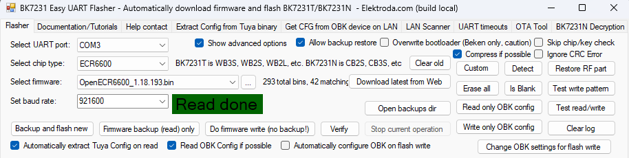

  • GD32VW553 port runs faster at 1.5 Mbaud
    #349 21928160
    insmod
    Posts: 1433
    Help: 168
    Rate: 455
    https://github.com/NonPIayerCharacter/BK7231GUIFlashTool/actions/runs/28231686315
    Added after 2 [hours] 23 [minutes]:
    I ported it to the GD32VW553 as well, and even though it has less RAM (forcing me to use a specific optimization flag for miniz), it runs significantly faster than the RTL8721DA at 600 MHz, while it is running at 160 MHz. All because of faster flash?
    At 1500000 baud
    Normal - 0x400000 38838 ms
    Compressed - 0x18D000 23374 ms
    Added after 3 [hours] 11 [minutes]:
    ECR6600
    1500000:
    Normal - 20621 ms
    Compressed - 0x113000 22081 ms
    921600:
    Normal - 28672 ms
    Compressed - 26571 ms
    115200:
    Normal - 189090 ms
    Compressed - 112898 ms

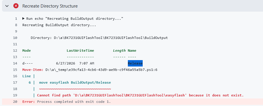

  • #354 21928589
    Posts: 5246
    Help: 451
    Rate: 921
    Well so I guess I can merge
    Screenshot of a PowerShell error: path not found while moving the Release folder in a directory structure script.
  • #355 21928950
    Posts: 14814
    Rate: 12986
    ah, I see there is a fix already, I'll merge both it and optmization.

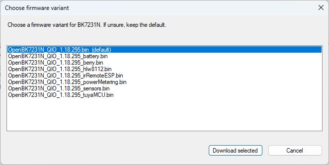

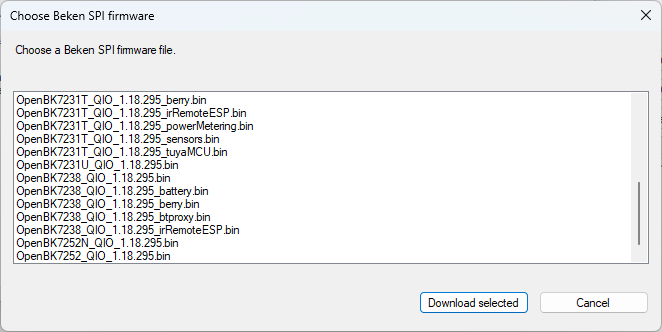

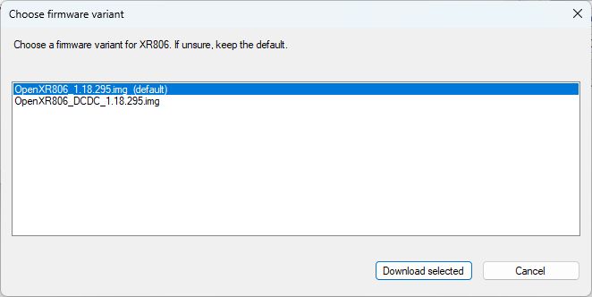

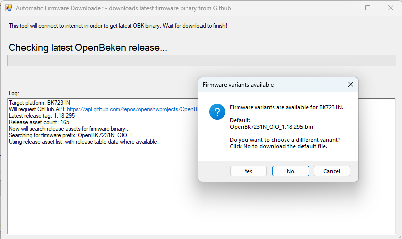

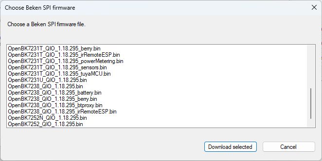

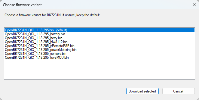

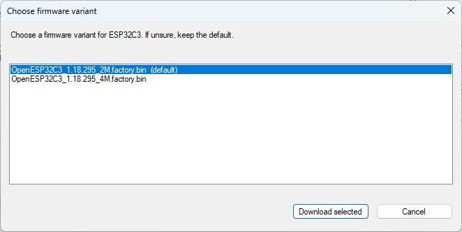

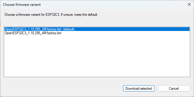

  • EasyGUIFlashTool update adds variant selection and BK SPI CH341 QIO support
    #356 21929078

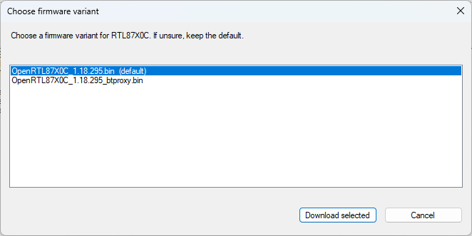

    Posts: 5246
    Help: 451
    Rate: 921
    I've got PTSD just trying to get RtlZ2 to work on EF2. Maybe codex 5.5 would do a better job now though
    Added after 1 [hours] 30 [minutes]:
    how about this. Do users really know about the variants and this would be useful? useful for testers anyway...
    -change 'download latest from web' to use GH API instead of scraping the http
    -detect if variant exists for selected platform and offers option to review
    -choosing to decline variant review continues to download default build like it does now
    -choosing to review variants gives nice list of choices
    -BK SPI CH341 now offers all Beken QIO instead of failing download
    Beken BK7231/BK7252 SPI flashing and recovery - new flasher tool and protocol specs Beken BK7231/BK7252 SPI flashing and recovery - new flasher tool and protocol specs Beken BK7231/BK7252 SPI flashing and recovery - new flasher tool and protocol specs Beken BK7231/BK7252 SPI flashing and recovery - new flasher tool and protocol specs Beken BK7231/BK7252 SPI flashing and recovery - new flasher tool and protocol specs Beken BK7231/BK7252 SPI flashing and recovery - new flasher tool and protocol specs
    Added after 1 [hours] 44 [minutes]:
    https://github.com/openshwprojects/BK7231GUIFlashTool/pull/145
  • #357 21929375
    Posts: 14814
    Rate: 12986
    Looks like great idea but really needs some kind of description of each variant

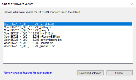

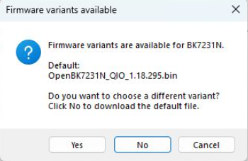

  • Linking variant options to enabled drivers list
    #358 21929378
    Posts: 5246
    Help: 451
    Rate: 921
    yes, true. I was thinking a link in the variant option box to a new thread that listed what was enabled in each
    in here
    Screenshot of “Firmware variants available” showing OpenBK7231N_QIO_1.18.295.bin and Yes/No/Cancel buttons
    Added after 1 [hours] 24 [minutes]:
    and/or have some kind of enableddrivers.md or something that's generated by build. didn't @max4elektroda already do something like this to add info to the About page?
    I'll find PR
    https://github.com/openshwprojects/OpenBK7231T_App/pull/1841
    Added after 17 [minutes]:
    something like https://github.com/openshwprojects/OpenBK7231...ain...divadiow:OpenBK7231T_App:enableddrivers
    https://github.com/divadiow/OpenBK7231T_App/b...29e03e01f00fa683ea4b5/docs/enabledFeatures.md
    Added after 1 [hours] 19 [minutes]:
    better https://github.com/divadiow/OpenBK7231T_App/blob/enableddrivers/docs/enabledFeatures.md
    https://github.com/openshwprojects/OpenBK7231T_App/pull/2147
    Added after 22 [minutes]:
    tweaked
    “Firmware variants available” dialog with buttons: Choose variant, Download default, Cancel.
    “Choose firmware variant” dialog with a list of OpenBK7231N files and Download selected/Cancel buttons
    links to enabledFeatures.md

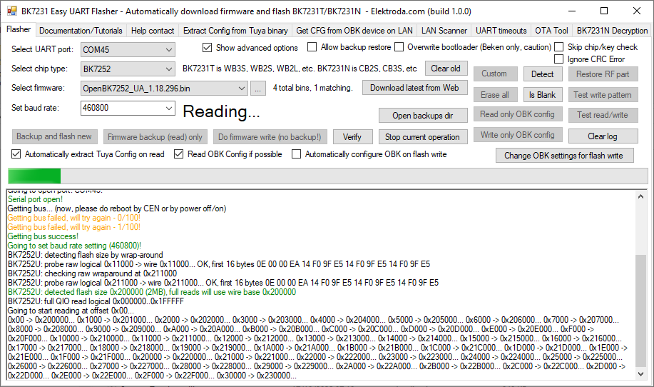

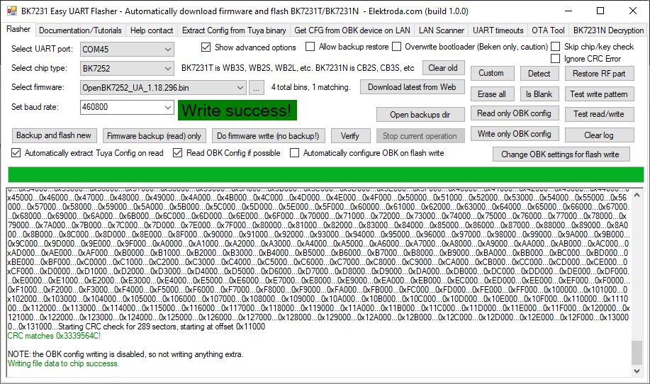

  • BK7252U 2/4 MB flash read/write/erase fixed
    #359 21930179
    Posts: 5246
    Help: 451
    Rate: 921

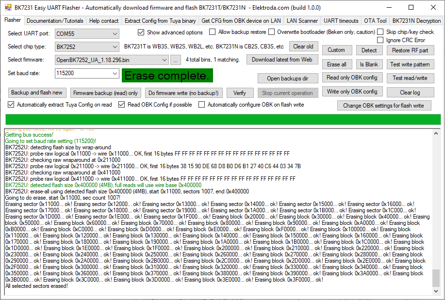

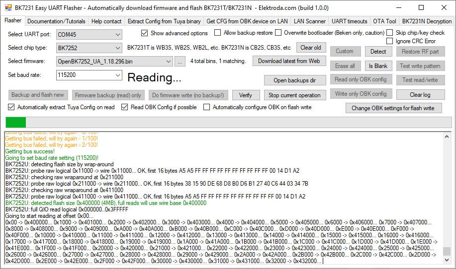

    >>21778541
    BK7252U 2/4mb read/write/erase fixed https://github.com/openshwprojects/BK7231GUIFlashTool/pull/146
    - combined read/write OK
    - 2MB and 4MB flash size detection via wrap-around/mirror probing OK
    - full flash read now includes bootloader via mapped reads
    - CRC verification OK for reads and writes

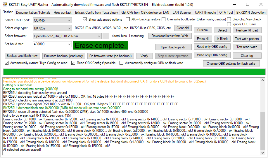

    - erase-all preserves bootloader and erases from 0x11000 to detected flash end on 2MB/4MB chips
    - writing 2MB/4MB full backup images skips the first 0x11000 bytes in the file, preserving the existing bootloader
    - guarded against writing a 4MB image to a detected 2MB chip before erase/write begins
    - custom read/write paths tested
    - BK7231T regression-checked: wrap-around read, erase, write, custom read/write, and combined read/write still behave as before
    Beken BK7231/BK7252 SPI flashing and recovery - new flasher tool and protocol specs Beken BK7231/BK7252 SPI flashing and recovery - new flasher tool and protocol specs Beken BK7231/BK7252 SPI flashing and recovery - new flasher tool and protocol specs Beken BK7231/BK7252 SPI flashing and recovery - new flasher tool and protocol specs Beken BK7231/BK7252 SPI flashing and recovery - new flasher tool and protocol specs Screenshot of BK7231 Easy UART Flasher showing a memory read log. Screenshot of BK7231 Easy UART Flasher showing “Erase complete” and an operation log
    tested on 2mb BK7252UQN48 and 4mb BK7252UQN68 doorbells
    Added after 10 [hours] 38 [minutes]:
    add LN8825+LN882H full chip erase. tested
    https://github.com/openshwprojects/BK7231GUIFlashTool/pull/147
