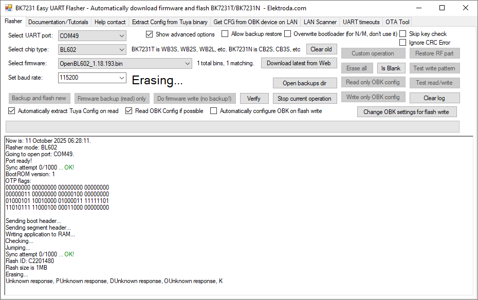

  • BK7231GUIFlashTool v98+ adds CH341-based SPI flashing and recovery for Beken BK7231/BK7252 chips, including bricked devices with overwritten bootloaders.
  • The tool uses CH341 DLL C# bindings to toggle CEN via D2, reset the chip, send 0xD2, then flash Beken chips like generic SPI memory.
  • Connections use P20, P21, P22, and P23 for SCK, CSN, SI, and SO, with CEN wired to D2 and the CH341 jumper set to I2C mode.
  • A sample read identifies JEDEC ID FF-EF-40-16 and a 4096 KB flash, and the same tool can Read, Write, Verify, and Erase firmware.
  • If CH341 is not detected or CEN toggle fails, check driver configuration, jumper position, SPI wiring, and power before trying Beken SPI mode again.

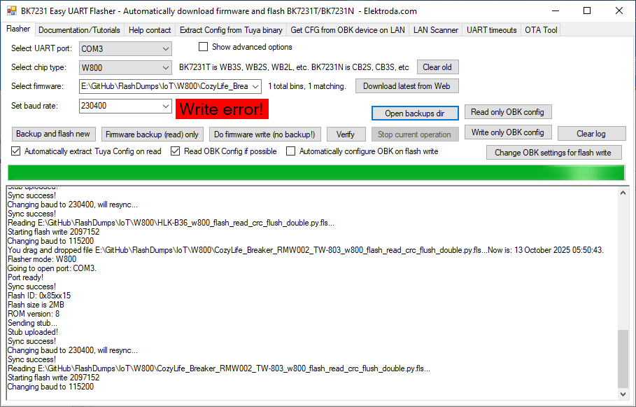

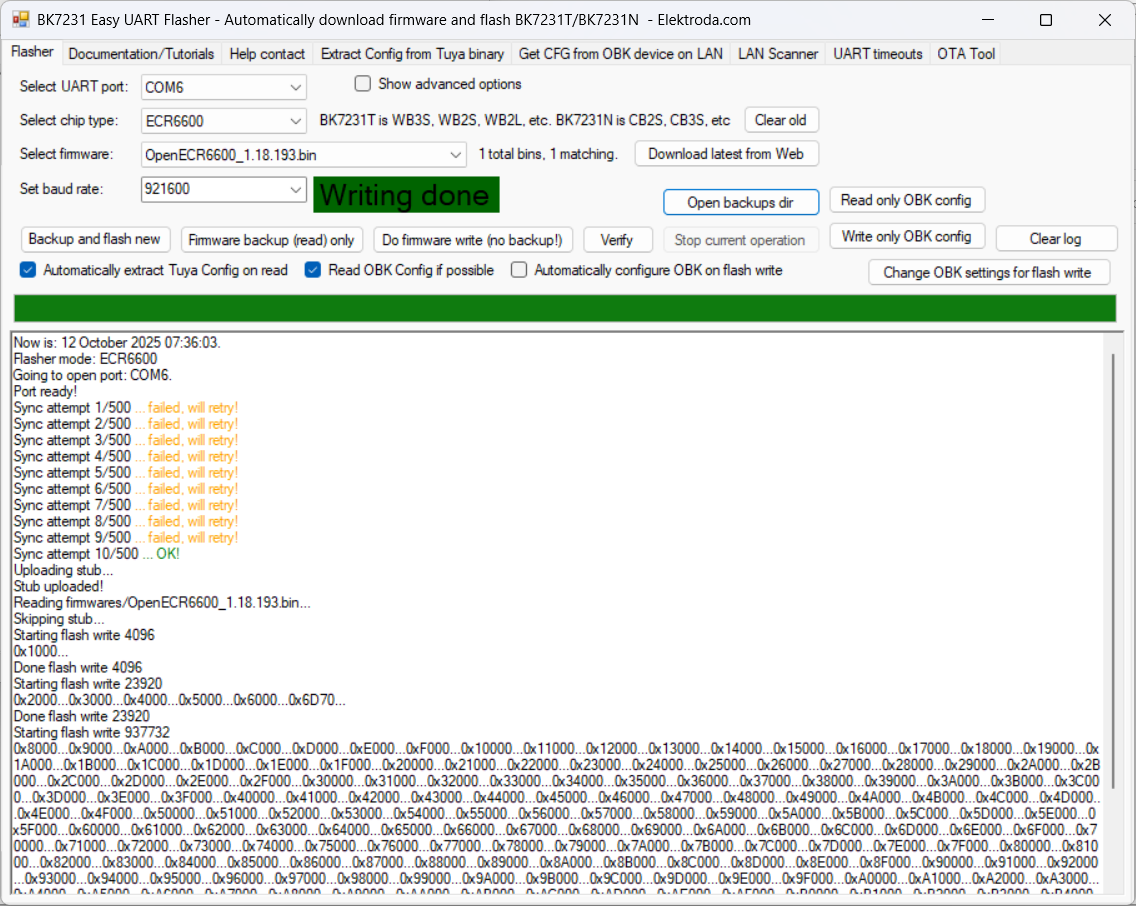

    >>21716563

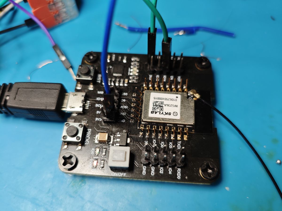

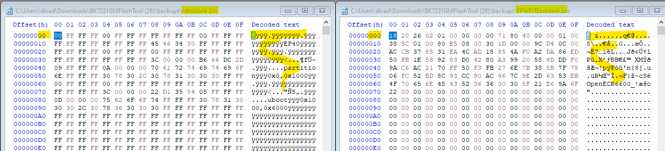

    im not having much luck today it seems. ECR6600 seems to read and write with success but never boots for me.
    Screenshot of BK7231 Easy UART Flasher showing Writing done message
    Booting OK with AIO RDTool flashing. erases in between. Here's the comparison of EF write vs RDTool write (confirmed blank in between each write) - both dumps taken with RDTool.
    Comparison of two binary files in a hex editor with highlighted differences

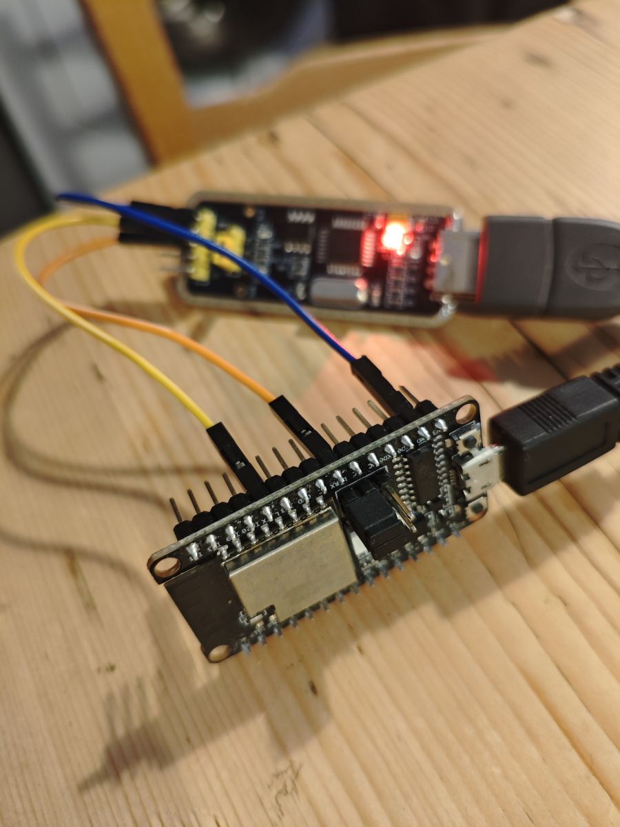

    but my setup can't be that much different to yours? the usual WG236 in ESP adaptor, flashing through on-board CH9102, other USB-TTL rigged up for log out from IO13/TX2
    Development board with SkyLab GPS module connected via jumper wires and USB.

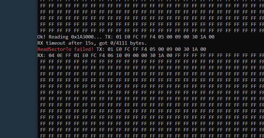

    I've did futher tests of UART flash over the TCP. It seems that we can use higher baud rates, but a retry mechanism for page read is needed.
    Screenshot showing data transmission errors and hexadecimal memory readout
    Where did you get ECR6600 protocol specs? Is it also XModem?
    We need a supported features matrix...

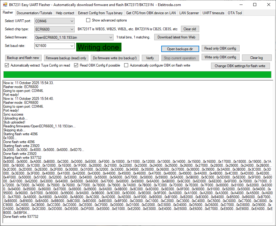

    #66 21717005
    insmod
    Posts: 1432
    Help: 168
    Rate: 455
    >>21716583
    Fixed write
    I forgot to replace startSector with flashOffset (from aio binary), and so everything was being written at 0x0.
    >>21716665
    Not xmodem, custom one.
    Some things i got from stub source (older one, i wasn't able to get write working with it, even though rdtool works fine with it).
    Things like stub upload and syncing i got by sniffing.

    #67 21717026
    Posts: 5212
    Help: 446
    Rate: 914

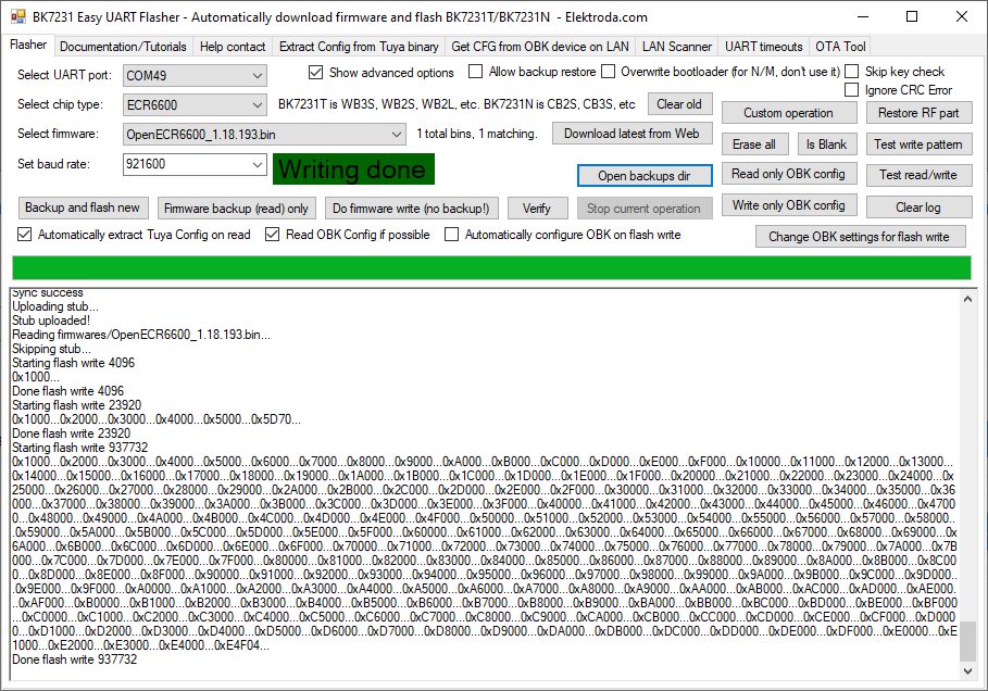

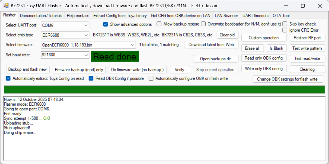

    yep. OK now. OpenECR boots
    Screenshot of BK7231 Easy UART Flasher after successful ECR6600 firmware flash
    Added after 4 [minutes]:
    generally-speaking, the ECR6600 flashing/reset window of opportunity is a pain. it's not too bad though

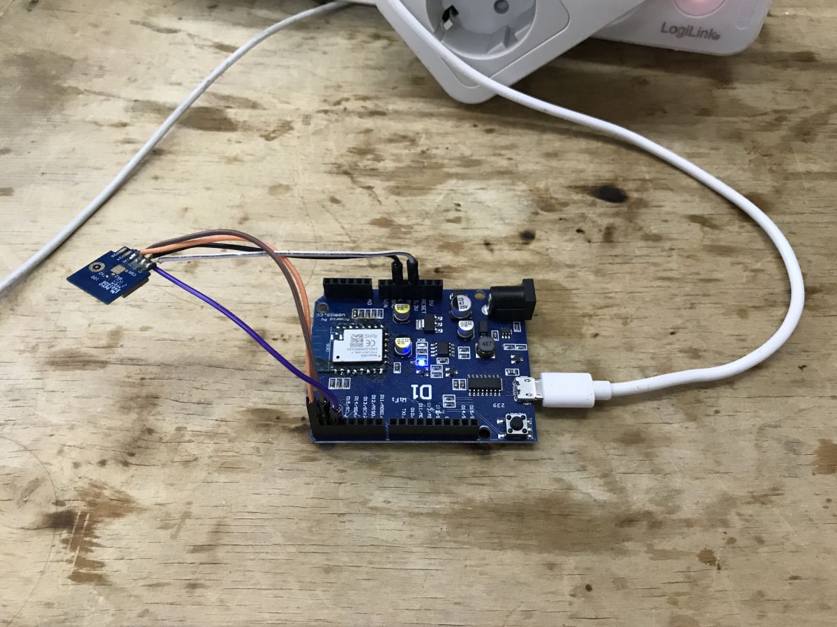

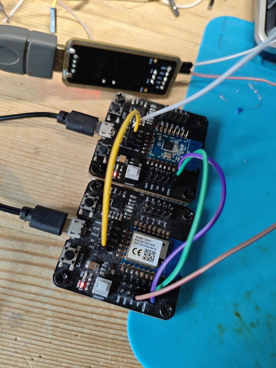

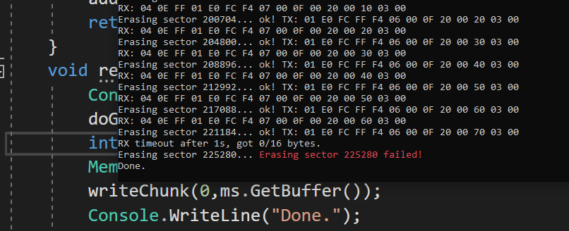

    @divadiow would you be able to prepare "OBK self replication" setup? Like that:
    Development board with connected module via jumper wires on a wooden table
    It is almost ready - I am adding retry mechanisms.
    Sector erase failure in console output with C# code below

  • C# remote Beken read erase write tool

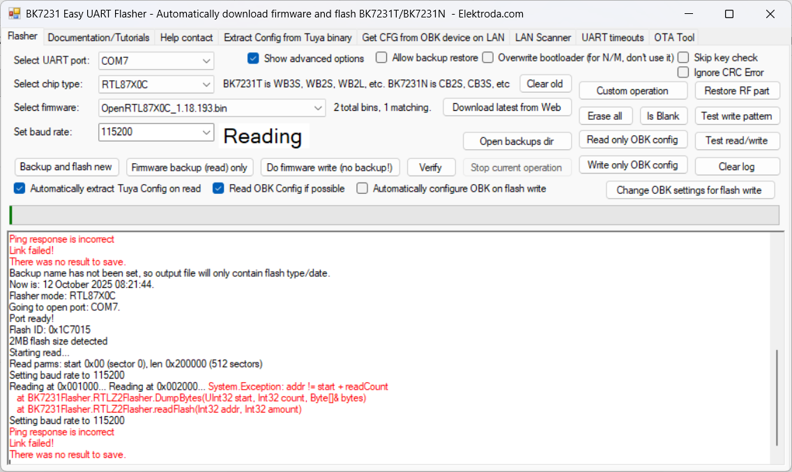

    Added after 14 [minutes]:

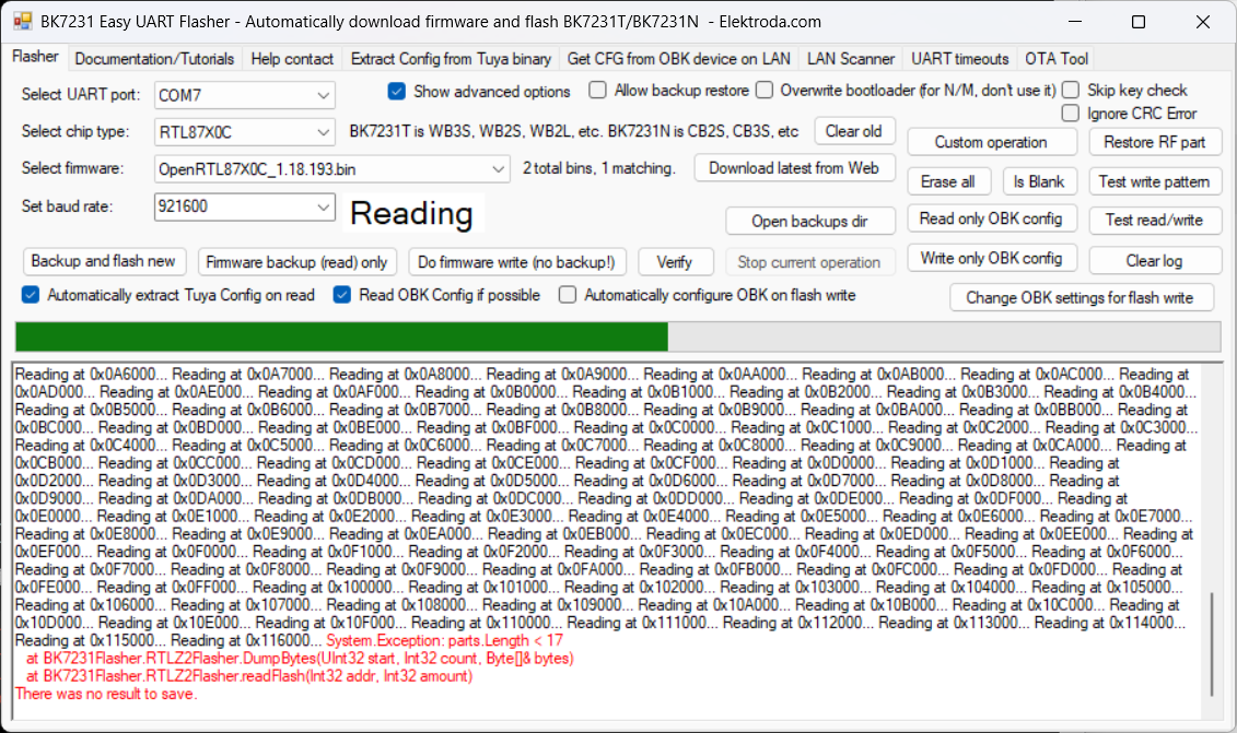

    why we don't actually have a retry in Beken sector erase/read/write code?
    Realtek Z2 would benefit from this too. I struggle to get a complete read often still, even with prime conditions - short new cables, BW15
    ESP32 module connected to USB-UART converter with jumper wires on a wooden surface
    BK7231 Easy UART Flasher interface with memory reading in progress
    Added after 9 [minutes]:
    BK7231 Easy UART Flasher interface showing connection error message during read

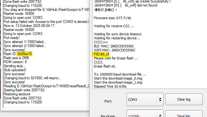

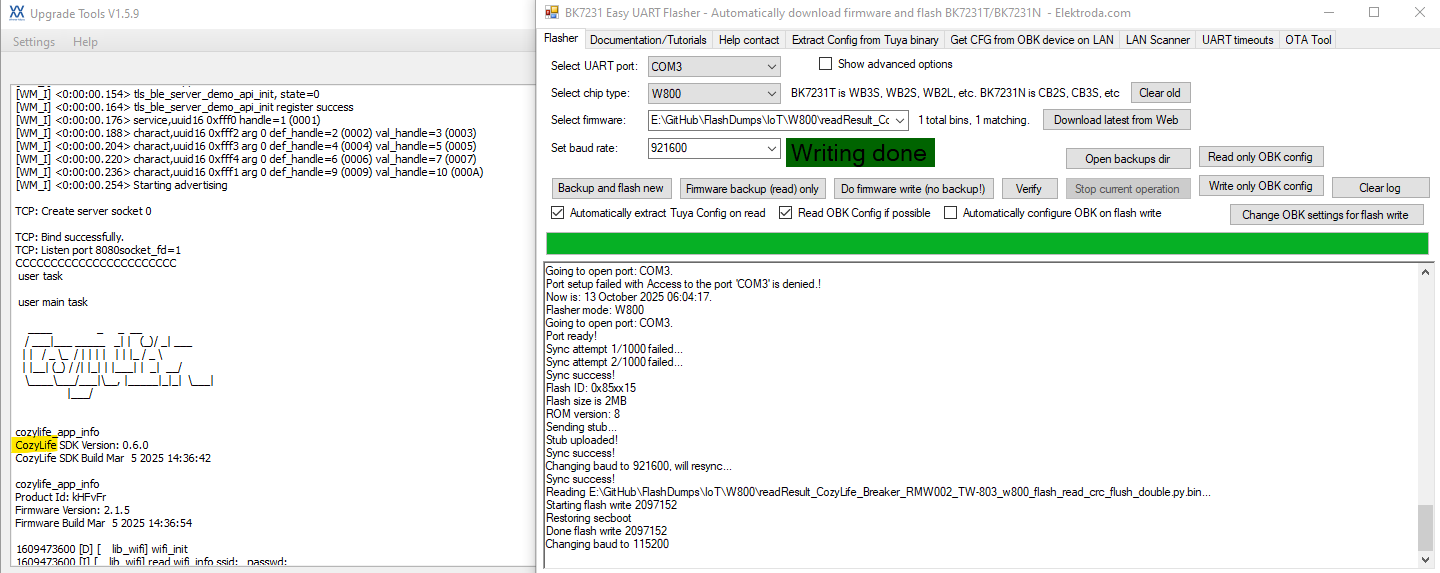

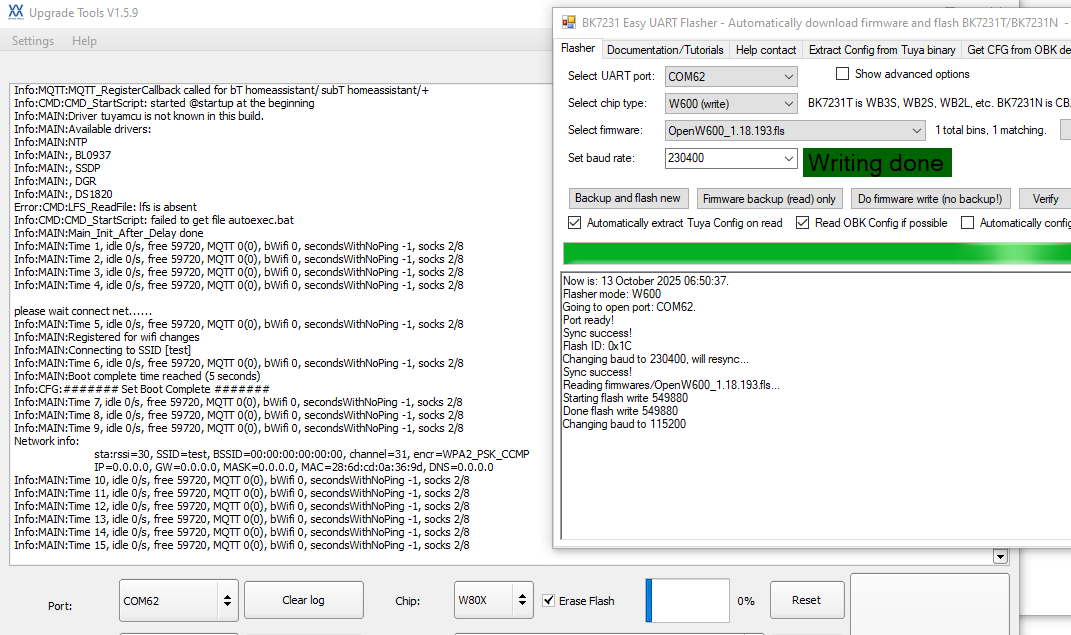

    W800 flasher: https://github.com/openshwprojects/BK7231GUIFlashTool/pull/74
    Backup restore is only possible if it's a full image, with secboot header at 0x2000.
    If not, then program's behaviour is undefined.
    Considering how it handles writes, i didn't even try to add config write. Read is working fine though, even if config is a 2016 bytes version.
    Full xmodem implementation included. I don't remember where i got it though, just found it in my downloads.
  • OBK flashes and boots on W800; backups may be bad

    nice. I have flashed OBK OK to W800.
    base64 of that stub looks identical to w800_fls_erase.img pulled from Upgrade Tools https://www.elektroda.com/rtvforum/topic4120455.html#21542722
    I took a couple of backups of real devices previously with the Upgrade Tools inspired read scripts and was never sure if they were any good.
    https://github.com/openshwprojects/FlashDumps/tree/main/IoT/W800
    Attempts to write them back (CozyLife_Breaker_RMW002_TW-803_w800_flash_read_crc_flush_double.py.bin and HLK-B36_w800_flash_read_crc_flush_double.py.bin)
    Screenshot of BK7231 Easy UART Flasher showing Write error! during firmware flashing
    I'll fiddle. I have another untouched CozyLife with TW-803 so it'll be interesting to do an EF read of that to see how the backups compare.
    HLK-W801-KIT_(uni_app.fls)_HLK-CB103-V2.0.0.fls and YourCee_Tuya_w800_light_5_rgbcw_v2_1.0.8_release.fls do write and boot.
  • #82 21718630
    insmod
    Posts: 1432
    Help: 168
    Rate: 455
    >>21718629
    Do not change backups extension to fls
    And rename them to start with "readResult_"
  • #83 21718634
    Posts: 5212
    Help: 446
    Rate: 914
    woohoo! they boot. that pleases me a lot knowing they are OK. cheers
    Screenshot of BK7231 Easy UART Flasher tool showing Writing done message
    Added after 6 [minutes]:
    curious about the flash ID read. Do you know why full ID isn't reported? Not that it's that important I guess?
    Application interface with programming logs and PID: 0x85x15 highlighted
    and what's your take on the gain toggling?
  • #84 21718639
    insmod
    Posts: 1432
    Help: 168
    Rate: 455
    >>21718634
    Gain doesn't matter.
    And on W600 flash id command outputs either 1 or 2 bytes, i'm not sure which, because i get 1C, and C can be just a part xmodem crc spam.
    Anyway, last 2 bytes are enough to get flash size. And W600 doesn't support flash read.

  • #87 21718658
    Posts: 5212
    Help: 446
    Rate: 914
    OK sure.
    trying W600. seems OK.
    BK7231 Easy UART Flasher interface showing successful W600 firmware flash
    I see it picked up previous config on device (startdriver tuyamcu)
    Added after 5 [minutes]:
    Thought I'd give the W600 HC-25_AT.bin JLink backup a go
    that's with file named as readResult_HC-25_AT.bin
