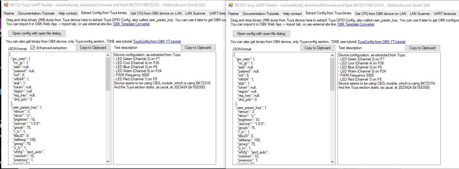

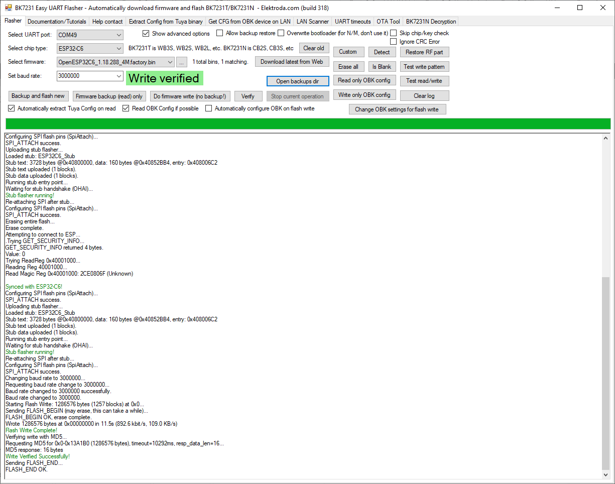

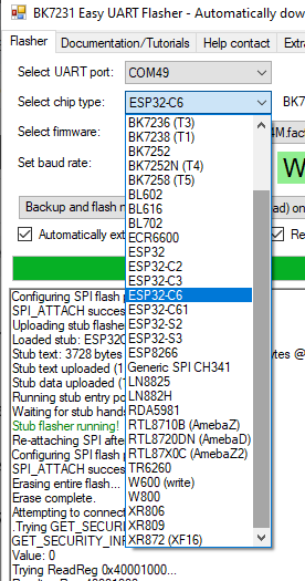

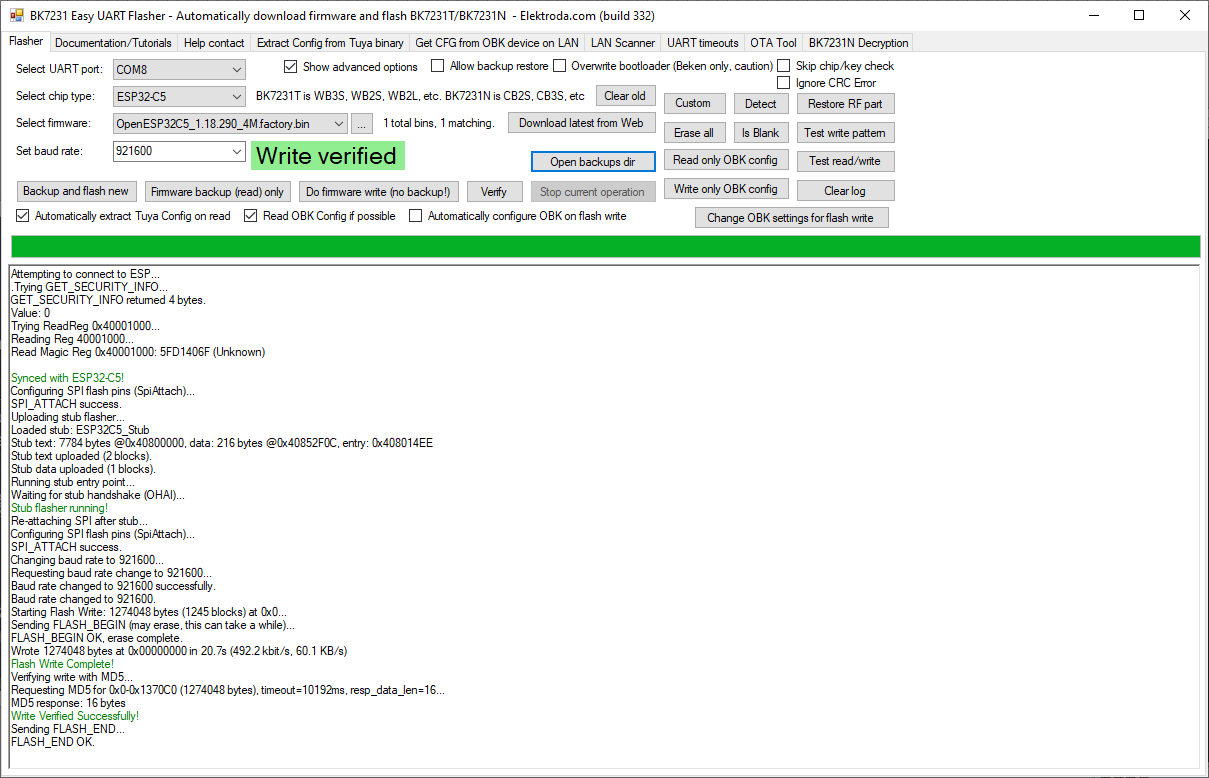

✨ The discussion centers on BK7231/BK7252 SPI flashing and recovery using BK7231GUIFlashTool v98+, which adds a new SPI-based flashing method requiring only a CH341 SPI programmer. The method is intended for recovering bricked Beken devices with overwritten bootloaders and also works as a general SPI flasher for external flash chips. Participants test and debug the new SPI mode, including COM-port handling, CH341 DLL loading, verify behavior, and Linux/Mono compatibility. The thread then expands into broader flasher development: UART and SPI improvements, flash-size detection, unprotect logic, retry mechanisms, baud-rate limits, and support for additional platforms such as RTL8720D, RTLZ/RTLZ2, BL602, LN882H, W600/W800, ECR6600, and remote flashing over TCP-to-UART. Several fixes are merged, including backup restore, erase/write handling, config read/write, and improved detection and logging.

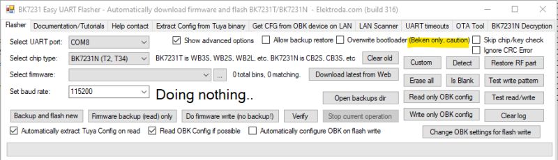

Do I need to select a COM port for SPI flashing?
No. As of v99, SPI mode does not require a COM port. This was confirmed after fixes; previous v98 prompts were removed. Ensure CH341A is connected; SPI operations run without a serial port. [Elektroda, divadiow, post #21712310]

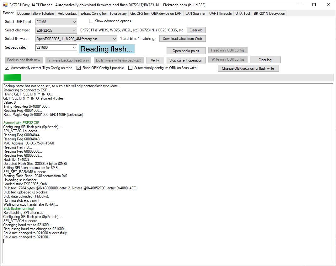

Linux support: what baud rates are stable under mono?
Mono 6.12 worked for testers. They reported stable operation at 921,600 baud; 1,500,000 worked on Windows, but they lowered to 921,600 on Linux. LAN Scanner and release downloader also worked. [Elektroda, insmod, post #21712663]

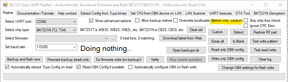

How do I just switch a BK device into SPI mode without reading or writing?
Use the new “Detect” button. It performs a zero‑length custom operation to toggle CEN and send the 0xD2 sync, placing the chip in SPI mode for use with other SPI tools. [Elektroda, p.kaczmarek2, post #21731041]

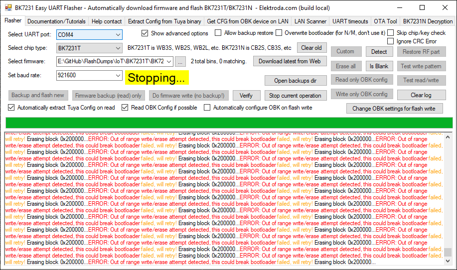

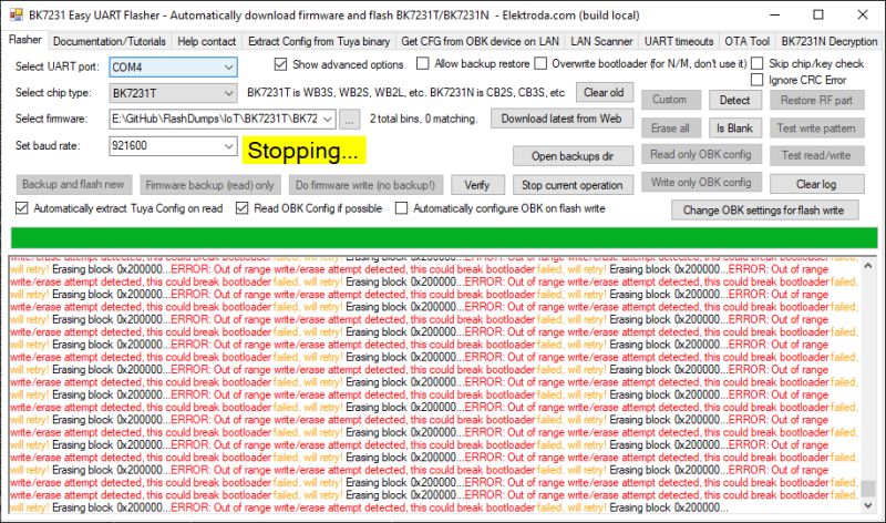

I flashed many times and now erase fails. What should I try?
Expand Unprotect logic before erase, similar to AsProgrammer. A contributor noted needing stronger Unprotect after many BK7252 cycles. Add an Unprotect/Status-Register release step, then retry the erase/write. [Elektroda, p.kaczmarek2, post #21714737]
