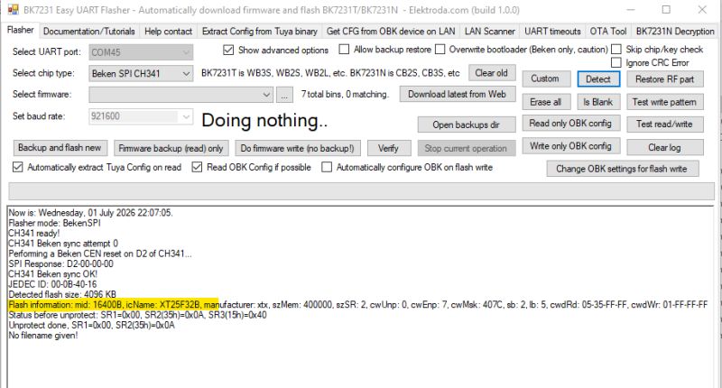

  • BK7231GUIFlashTool v98+ adds CH341-based SPI flashing and recovery for Beken BK7231/BK7252 chips, including bricked devices with overwritten bootloaders.
  • The tool uses CH341 DLL C# bindings to toggle CEN via D2, reset the chip, send 0xD2, then flash Beken chips like generic SPI memory.
  • Connections use P20, P21, P22, and P23 for SCK, CSN, SI, and SO, with CEN wired to D2 and the CH341 jumper set to I2C mode.
  • A sample read identifies JEDEC ID FF-EF-40-16 and a 4096 KB flash, and the same tool can Read, Write, Verify, and Erase firmware.
  • If CH341 is not detected or CEN toggle fails, check driver configuration, jumper position, SPI wiring, and power before trying Beken SPI mode again.

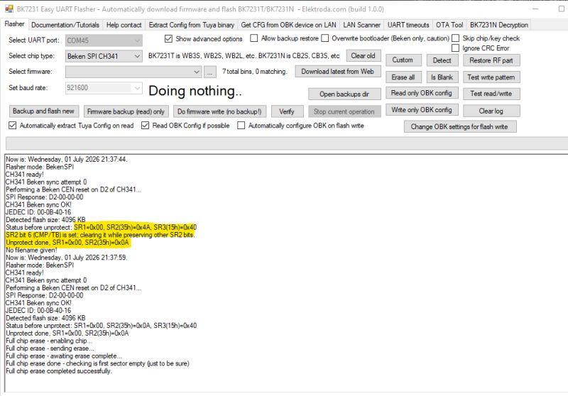

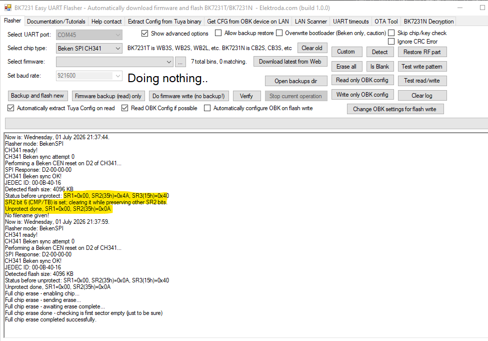

  • CMP/TB bit clearing added to flash tool
    #362 21931235
    Posts: 5153
    Help: 442
    Rate: 906
    divadiow wrote:
    14: CMP/TB seems to be the one
    Pivoting to ASProgrammer just to clear this bit to be able to erase/write to flash is a pain. So here's added bit checks, clearance of CMP and recheck.

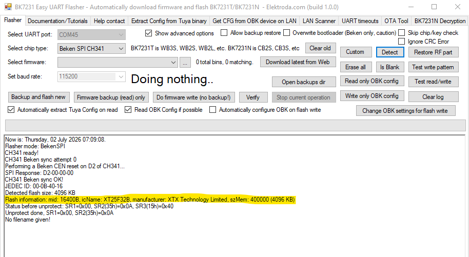

  • BKFIL requires usable JEDEC ID in SPI mode
    #364 21931382

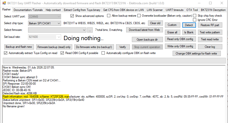

    as far as I can tell EF in SPI modes MUST get a usable JEDEC ID first
    Added after 6 [minutes]:
    back to the BKFlashList, BKFIL has these differences compared to EF when anchoring on MID

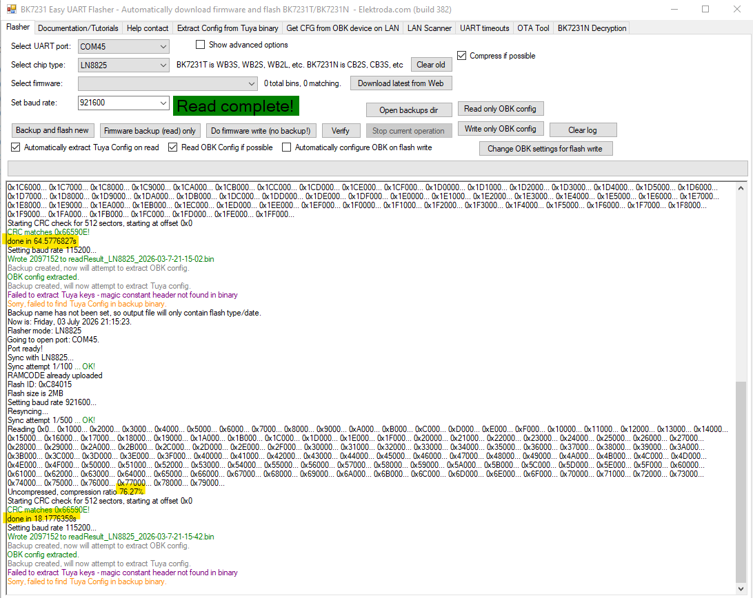

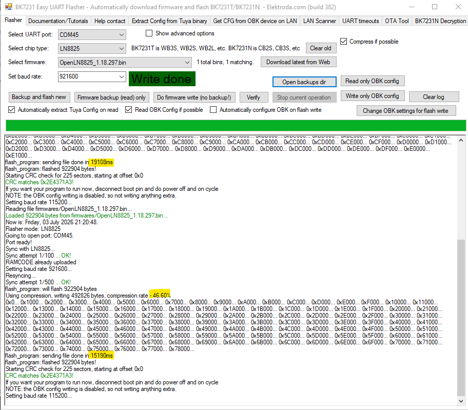

    Screenshot of BK7231 Easy UART Flasher showing the message “Doing nothing..”
    Added after 3 [hours] 44 [minutes]:
    speedy. no progress bar with compression box checked though
    Beken BK7231/BK7252 SPI flashing and recovery - new flasher tool and protocol specs

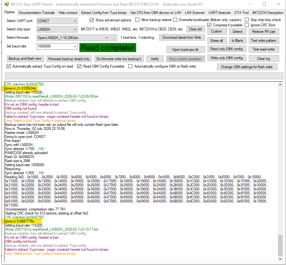

    insmod wrote:
    RF restore/reloc should be BK/ECR only. Not applicable otherwise
    ta. changed. and a couple more
    For Beken I think erase needs changing to erase whole flash on all but the obvious ones - T/U/7252U.
    Added after 7 [minutes]:
    insmod wrote:
    5
    Screenshot of BK7231 Easy UART Flasher showing “Read complete!” and a read operation logScreenshot of BK7231 Easy UART Flasher showing “Write done” and flashing log output.

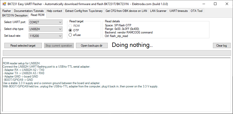

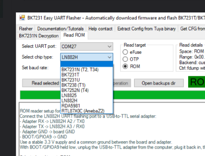

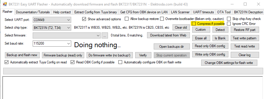

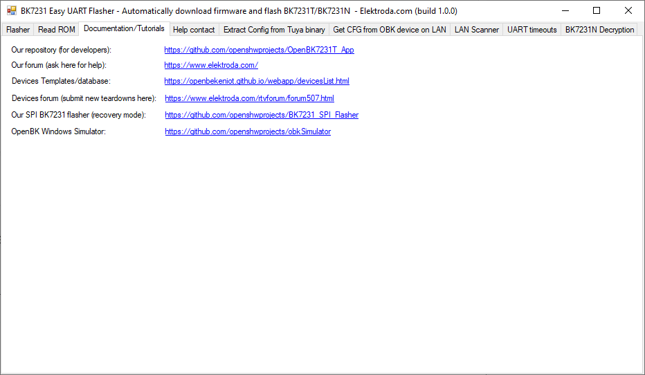

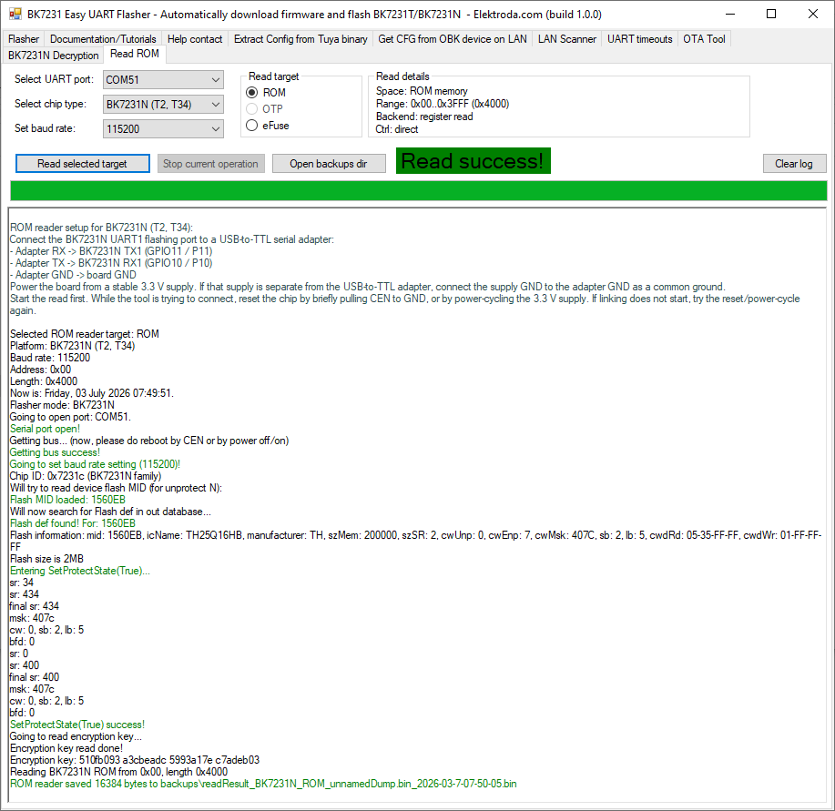

    Seems very nice, can you explain what's this? Also... is this form section to choose UART settings DRY? With no code duplication?
    Screenshot of BK7231 Easy UART Flasher showing chip type dropdown and COM port settings

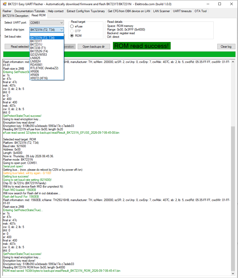

  • ROM/OTP/eFuse reader with UART download instructions
    #371 21933130
    Posts: 5153
    Help: 442
    Rate: 906
    I've taken as DRY as an approach as possible I believe. WIP https://github.com/divadiow/BK7231GUIFlashTool/tree/rom
    it's just a ROM/OTP/eFuse reader for different platforms. Requires some updated ramcode/stubs which @insmod has been working on.
    Added after 4 [minutes]:
    includes basic uart download mode instructions which could be re-used for main flasher https://github.com/openshwprojects/BK7231GUIF...1b24e728254b9faa6ba2e4030b11ef4bb9b157e292186

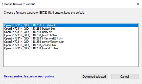

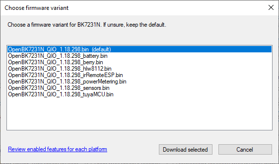

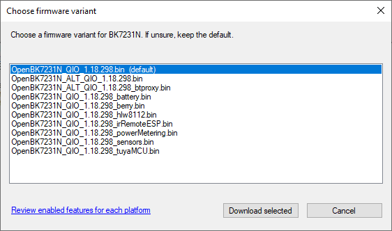

  • Asset filename matching needs ALT variants for btproxy
    #380 21934588
    Posts: 5153
    Help: 442
    Rate: 906
    I was just looking into the asset filename matching in EF does not offer the ALT variants, which excludes btproxy for BK
    with a little tweak we can add
    https://github.com/openshwprojects/BK7231GUIFlashTool/pull/154
    'review enabled features..' link needs this merging, if it's any good though. https://github.com/openshwprojects/OpenBK7231T_App/pull/2147
    https://github.com/divadiow/OpenBK7231T_App/b...95944c4f3fc3a768a5a2a/docs/enabledFeatures.md
    Still, a proper variant explanation is needed.

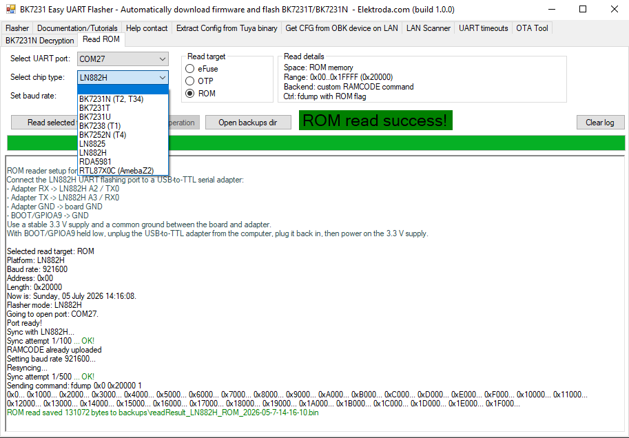

  • PR review concerns for ROM/eFuse tab refactor
    #381 21935190
    Posts: 5153
    Help: 442
    Rate: 906
    I'm a little worried the ROM/eFuse tab work might look a bit daunting for a PR review and it doesn't look attractive for merging. Also, if changes need to be made, better now rather than further down the line perhaps.
    Screenshot of BK7231 Easy UART Flasher on the Read ROM tab showing the message “ROM read success!”
    https://github.com/openshwprojects/BK7231GUIFlashTool/pull/156
    I've also prepared a list of possible questions and some answers that may be raised by a review
    I've tried to make it DRY :)

    What i currently don't like there, is that it introduces a second tab row. Since OTA tool isn't used, remove it. And move ROM page so that it's after flasher page.
    COM port/baud aren't selectable until chip type is selected.
    Read details are unnecessary. Why would user want to know how it's done?
  • Remove OTA tab and reorder ROM page after flasher
    ok. can change.
    guide creation was more for the main flasher eventually, but it's useful?

    Good point with tabs, I think you can Enabled = false on OTA tab. The details can stay as long as we have enough space on this tab, otherwise remove.
  • COM port options disabled until chip type selected

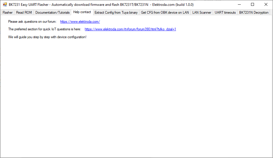

    combine these two and move to the far right tab?
    Added after 56 [seconds]:
    tab title simply "Help"?
    Added after 3 [minutes]:

The app says “missing ch341dll.dll” or quits in SPI mode—how do I fix that?
Place CH341DLL.DLL alongside the GitHub build, or build from source in Visual Studio. Earlier builds could exit if CH341A wasn’t present; recent fixes improved handling, but adding the DLL resolved missing‑library errors during testing. [Elektroda, divadiow, post #21712310]
Do I need to select a COM port for SPI flashing?
No. As of v99, SPI mode does not require a COM port. This was confirmed after fixes; previous v98 prompts were removed. Ensure CH341A is connected; SPI operations run without a serial port. [Elektroda, divadiow, post #21712310]
What does the Verify button do?
Verify compares flash contents against the firmware file currently selected in the tool. Use it after Write or Erase to confirm success. “Verify verifies against selected firmware.” [Elektroda, p.kaczmarek2, post #21712551]
Can this recover a bricked BK7252 camera?
Yes. After wiring CEN and SPI lines, use Beken SPI mode to read/erase/write. The author provides a BK7252 camera recovery example using this exact method with CH341A and the new flasher. [Elektroda, p.kaczmarek2, post #21711721]
Can I use CH341 Programmer or NeoProgrammer once SPI mode is active?
Yes. After the 0xD2 hand‑off, the BK behaves like a generic SPI flash. You can then operate with common SPI flash tools (CH341 Programmer or NeoProgrammer) if you prefer. [Elektroda, p.kaczmarek2, post #21711721]
Linux support: what baud rates are stable under mono?
Mono 6.12 worked for testers. They reported stable operation at 921,600 baud; 1,500,000 worked on Windows, but they lowered to 921,600 on Linux. LAN Scanner and release downloader also worked. [Elektroda, insmod, post #21712663]
The tool shows a 4,096 KB device. Is that normal for these chips?
Yes. A sample JEDEC ID FF‑EF‑40‑16 decoded to 4,096 KB and printed by the tool. That confirms JEDEC read and size decoding in SPI mode. Actual sizes vary by module; always check the tool’s detected flash size. [Elektroda, p.kaczmarek2, post #21711721]
How do I just switch a BK device into SPI mode without reading or writing?
Use the new “Detect” button. It performs a zero‑length custom operation to toggle CEN and send the 0xD2 sync, placing the chip in SPI mode for use with other SPI tools. [Elektroda, p.kaczmarek2, post #21731041]
I flashed many times and now erase fails. What should I try?
Expand Unprotect logic before erase, similar to AsProgrammer. A contributor noted needing stronger Unprotect after many BK7252 cycles. Add an Unprotect/Status-Register release step, then retry the erase/write. [Elektroda, p.kaczmarek2, post #21714737]
