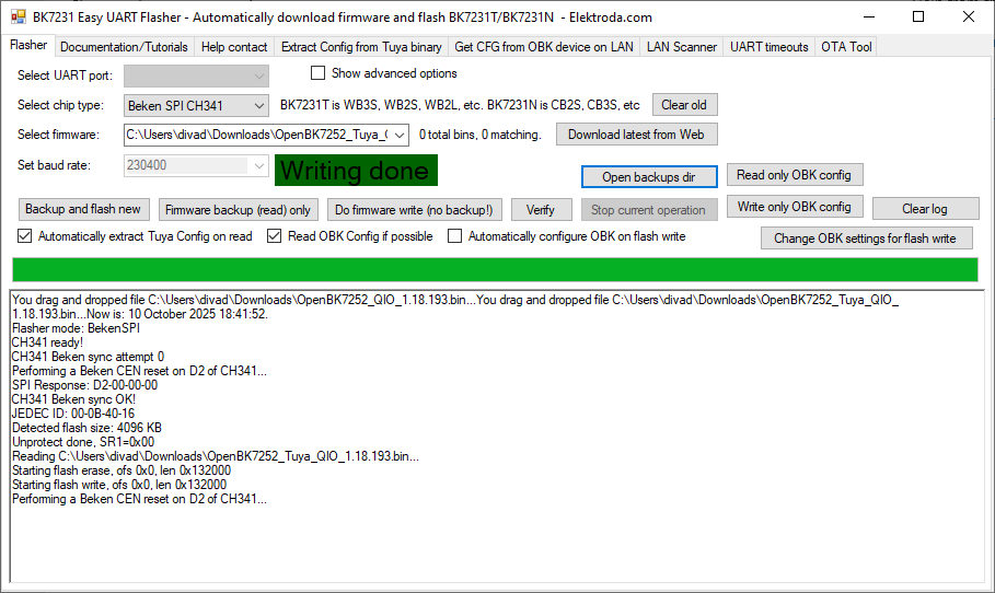

  • BK7231GUIFlashTool v98+ adds CH341-based SPI flashing and recovery for Beken BK7231/BK7252 chips, including bricked devices with overwritten bootloaders.
  • The tool uses CH341 DLL C# bindings to toggle CEN via D2, reset the chip, send 0xD2, then flash Beken chips like generic SPI memory.
  • Connections use P20, P21, P22, and P23 for SCK, CSN, SI, and SO, with CEN wired to D2 and the CH341 jumper set to I2C mode.
  • A sample read identifies JEDEC ID FF-EF-40-16 and a 4096 KB flash, and the same tool can Read, Write, Verify, and Erase firmware.
  • If CH341 is not detected or CEN toggle fails, check driver configuration, jumper position, SPI wiring, and power before trying Beken SPI mode again.

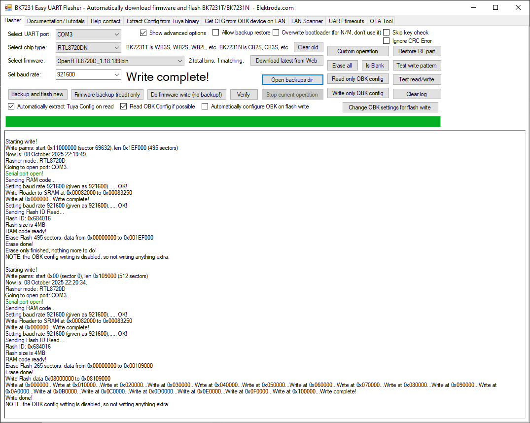

    New fix uploaded - backup saving on RTLZ/RTLD and RTLZ2 when using "Backup and flash new". LN was fixed earlier.

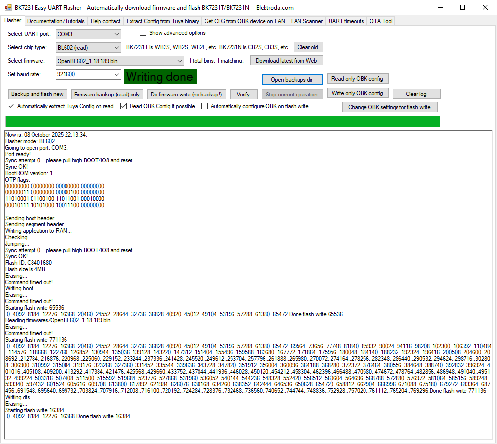

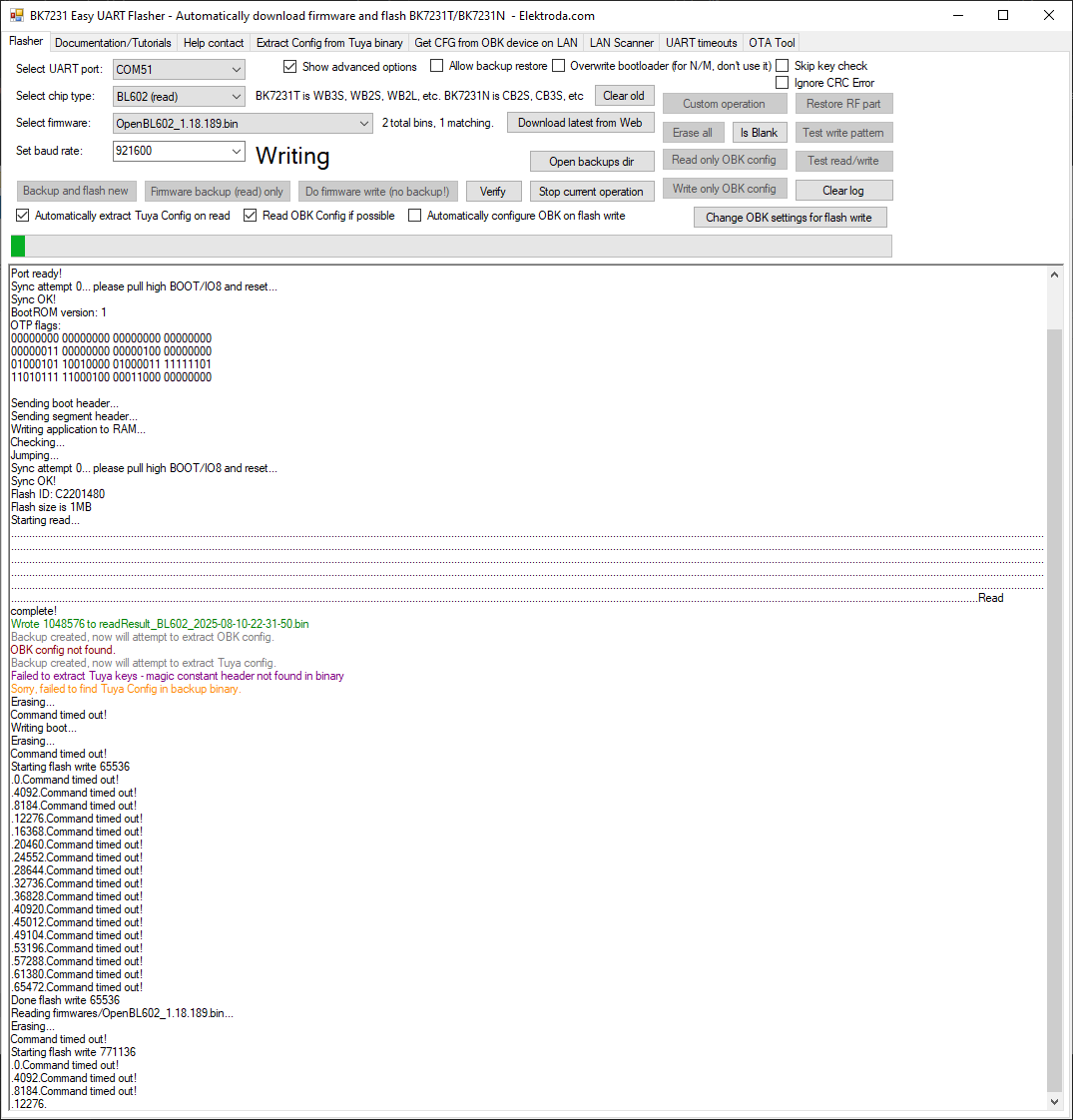

  • BL602 flash restore and erase support added
    #36 21714143
    insmod
    Posts: 1432
    Help: 168
    Rate: 455
    >>21714087
    Fixed Z2 error.
    Updated BL602:
    Flash size detection.
    Backups can now be restored.
    Loader converted to base64 string.
    Full flash erase and partial erase. (it prints "Command timed out!" on erase, but that's because erase doesn't return "OK", but something else).
    Can write dts and partitions, but not boot and firmware (because no header generation).
    Merge ready, i believe. BK, RTLD and RTLZ2 works with mono (6.12, not 6.14) on a real pc. RTLB doesn't because bauds higher than 921600 aren't working for me, and RTLB rom default baud rate is 1500000.

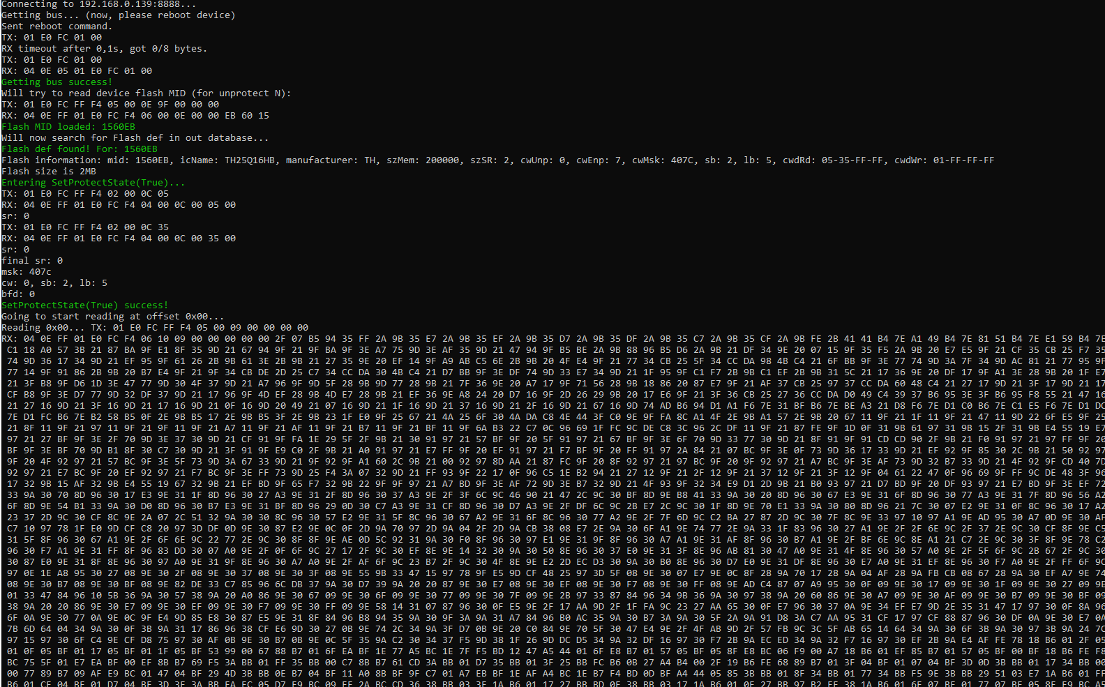

    I just got another BK7252 camera and tried to read flash with UART custom read, it seems that we need to add doUnprotect, or, more precisely, get flash ID call for non-N devices. Currently FLASH_SIZE is only set there, so it's not present on BK7231T and BK7252. Futhermore, for full read, the value is hardcoded.
  • #38 21714178
    insmod
    Posts: 1432
    Help: 168
    Rate: 455
    >>21714176
    It won't work, i've tried.
    Even just flash id without unprotect
  • #39 21714186

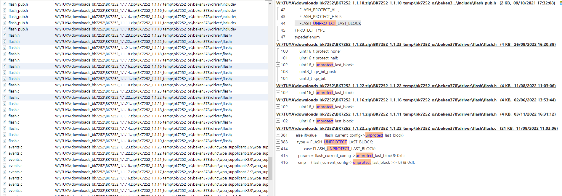

    Posts: 5212
    Help: 446
    Rate: 914
    anything in these of assistance or not really?
    Screenshot of code explorer showing files and instances of “unprotect_last_block” phrase
  • UART read succeeds after allowing custom flash size

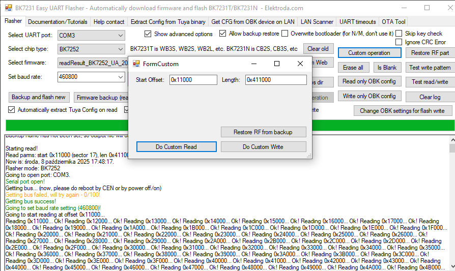

    #40 21714187
    Posts: 14755
    Rate: 12881

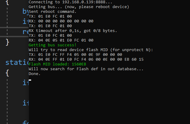

    Oh no, but still, thanks, at least you saved me some effort. So we need... a field for flash size, I guess?
    I tried that via UART on Doorbell:
    BK7231 Easy UART Flasher UI reading flash data starting at offset 0x11000
    I allowed custom read to get past max size.
    Starting read!
    Read parms: start 0x11000 (sector 17), len 0x411000 (69632 sectors)
    Now is: środa, 8 października 2025 17:48:17.
    Flasher mode: BK7252
    Going to open port: COM3.
    Serial port open!
    Getting bus failed, will try again - 0/100!
    Getting bus success!
    Going to set baud rate setting (460800)!
    Going to start reading at offset 0x11000...
    Reading 0x11000... Ok! Reading 0x12000... Ok! Reading 0x13000... Ok! Reading 0x14000... Ok! Reading 0x15000... Ok! Reading 0x16000... Ok! Reading 0x17000... Ok! Reading 0x18000... Ok! Reading 0x19000... Ok! Reading 0x1A000... Ok! Reading 0x1B000... Ok! Reading 0x1C000... Ok! Reading 0x1D000... Ok! Reading 0x1E000... Ok! Reading 0x1F000... Ok! Reading 0x20000... Ok! Reading 0x21000... Ok! Reading 0x22000... Ok! Reading 0x23000... Ok! Reading 0x24000... Ok! Reading 0x25000... Ok! Reading 0x26000... Ok! Reading 0x27000... Ok! Reading 0x28000... Ok! Reading 0x29000... Ok! Reading 0x2A000... Ok! Reading 0x2B000... Ok! Reading 0x2C000... Ok! Reading 0x2D000... Ok! Reading 0x2E000... Ok! Reading 0x2F000... Ok! Reading 0x30000... Ok! Reading 0x31000... Ok! Reading 0x32000... Ok! Reading 0x33000... Ok! Reading 0x34000... Ok! Reading 0x35000... Ok! Reading 0x36000... Ok! Reading 0x37000... Ok! Reading 0x38000... Ok! Reading 0x39000... Ok! Reading 0x3A000... Ok! Reading 0x3B000... Ok! Reading 0x3C000... Ok! Reading 0x3D000... Ok! Reading 0x3E000... Ok! Reading 0x3F000... Ok! Reading 0x40000... Ok! Reading 0x41000... Ok! Reading 0x42000... Ok! Reading 0x43000... Ok! Reading 0x44000... Ok! Reading 0x45000... Ok! Reading 0x46000... Ok! Reading 0x47000... Ok! Reading 0x48000... Ok! Reading 0x49000... Ok! Reading 0x4A000... Ok! Reading 0x4B000... Ok! Reading 0x4C000... Ok! Reading 0x4D000... Ok! Reading 0x4E000... Ok! Reading 0x4F000... Ok! Reading 0x50000... Ok! Reading 0x51000... Ok! Reading 0x52000... Ok! Reading 0x53000... Ok! Reading 0x54000... Ok! Reading 0x55000... Ok! Reading 0x56000... Ok! Reading 0x57000... Ok! Reading 0x58000... Ok! Reading 0x59000... Ok! Reading 0x5A000... Ok! Reading 0x5B000... Ok! Reading 0x5C000... Ok! Reading 0x5D000... Ok! Reading 0x5E000... Ok! Reading 0x5F000... Ok! Reading 0x60000... Ok! Reading 0x61000... Ok! Reading 0x62000... Ok! Reading 0x63000... Ok! Reading 0x64000... Ok! Reading 0x65000... Ok! Reading 0x66000... Ok! Reading 0x67000... Ok! Reading 0x68000... Ok! Reading 0x69000... Ok! Reading 0x6A000... Ok! Reading 0x6B000... Ok! Reading 0x6C000... Ok! Reading 0x6D000... Ok! Reading 0x6E000... Ok! Reading 0x6F000... Ok! Reading 0x70000... Ok! Reading 0x71000... Ok! Reading 0x72000... Ok! Reading 0x73000... Ok! Reading 0x74000... Ok! Reading 0x75000... Ok! Reading 0x76000... Ok! Reading 0x77000... Ok! Reading 0x78000... Ok! Reading 0x79000... Ok! Reading 0x7A000... Ok! Reading 0x7B000... Ok! Reading 0x7C000... Ok! Reading 0x7D000... Ok! Reading 0x7E000... Ok! Reading 0x7F000... Ok! Reading 0x80000... Ok! Reading 0x81000... Ok! Reading 0x82000... Ok! Reading 0x83000... Ok! Reading 0x84000... Ok! Reading 0x85000... Ok! Reading 0x86000... Ok! Reading 0x87000... Ok! Reading 0x88000... Ok! Reading 0x89000... Ok! Reading 0x8A000... Ok! Reading 0x8B000... Ok! Reading 0x8C000... Ok! Reading 0x8D000... Ok! Reading 0x8E000... Ok! Reading 0x8F000... Ok! Reading 0x90000... Ok! Reading 0x91000... Ok! Reading 0x92000... Ok! Reading 0x93000... Ok! Reading 0x94000... Ok! Reading 0x95000... Ok! Reading 0x96000... Ok! Reading 0x97000... Ok! Reading 0x98000... Ok! Reading 0x99000... Ok! Reading 0x9A000... Ok! Reading 0x9B000... Ok! Reading 0x9C000... Ok! Reading 0x9D000... Ok! Reading 0x9E000... Ok! Reading 0x9F000... Ok! Reading 0xA0000... Ok! Reading 0xA1000... Ok! Reading 0xA2000... Ok! Reading 0xA3000... Ok! Reading 0xA4000... Ok! Reading 0xA5000... Ok! Reading 0xA6000... Ok! Reading 0xA7000... Ok! Reading 0xA8000... Ok! Reading 0xA9000... Ok! Reading 0xAA000... Ok! Reading 0xAB000... Ok! Reading 0xAC000... Ok! Reading 0xAD000... Ok! Reading 0xAE000... Ok! Reading 0xAF000... Ok! Reading 0xB0000... Ok! Reading 0xB1000... Ok! Reading 0xB2000... Ok! Reading 0xB3000... Ok! Reading 0xB4000... Ok! Reading 0xB5000... Ok! Reading 0xB6000... Ok! Reading 0xB7000... Ok! Reading 0xB8000... Ok! Reading 0xB9000... Ok! Reading 0xBA000... Ok! Reading 0xBB000... Ok! Reading 0xBC000... Ok! Reading 0xBD000... Ok! Reading 0xBE000... Ok! Reading 0xBF000... Ok! Reading 0xC0000... Ok! Reading 0xC1000... Ok! Reading 0xC2000... Ok! Reading 0xC3000... Ok! Reading 0xC4000... Ok! Reading 0xC5000... Ok! Reading 0xC6000... Ok! Reading 0xC7000... Ok! Reading 0xC8000... Ok! Reading 0xC9000... Ok! Reading 0xCA000... Ok! Reading 0xCB000... Ok! Reading 0xCC000... Ok! Reading 0xCD000... Ok! Reading 0xCE000... Ok! Reading 0xCF000... Ok! Reading 0xD0000... Ok! Reading 0xD1000... Ok! Reading 0xD2000... Ok! Reading 0xD3000... Ok! Reading 0xD4000... Ok! Reading 0xD5000... Ok! Reading 0xD6000... Ok! Reading 0xD7000... Ok! Reading 0xD8000... Ok! Reading 0xD9000... Ok! Reading 0xDA000... Ok! Reading 0xDB000... Ok! Reading 0xDC000... Ok! Reading 0xDD000... Ok! Reading 0xDE000... Ok! Reading 0xDF000... Ok! Reading 0xE0000... Ok! Reading 0xE1000... Ok! Reading 0xE2000... Ok! Reading 0xE3000... Ok! Reading 0xE4000... Ok! Reading 0xE5000... Ok! Reading 0xE6000... Ok! Reading 0xE7000... Ok! Reading 0xE8000... Ok! Reading 0xE9000... Ok! Reading 0xEA000... Ok! Reading 0xEB000... Ok! Reading 0xEC000... Ok! Reading 0xED000... Ok! Reading 0xEE000... Ok! Reading 0xEF000... Ok! Reading 0xF0000... Ok! Reading 0xF1000... Ok! Reading 0xF2000... Ok! Reading 0xF3000... Ok! Reading 0xF4000... Ok! Reading 0xF5000... Ok! Reading 0xF6000... Ok! Reading 0xF7000... Ok! Reading 0xF8000... Ok! Reading 0xF9000... Ok! Reading 0xFA000... Ok! Reading 0xFB000... Ok! Reading 0xFC000... Ok! Reading 0xFD000... Ok! Reading 0xFE000... Ok! Reading 0xFF000... Ok! Reading 0x100000... Ok! Reading 0x101000... Ok! Reading 0x102000... Ok! Reading 0x103000... Ok! Reading 0x104000... Ok! Reading 0x105000... Ok! Reading 0x106000... Ok! Reading 0x107000... Ok! Reading 0x108000... Ok! Reading 0x109000... Ok! Reading 0x10A000... Ok! Reading 0x10B000... Ok! Reading 0x10C000... Ok! Reading 0x10D000... Ok! Reading 0x10E000... Ok! Reading 0x10F000... Ok! Reading 0x110000... Ok! Reading 0x111000... Ok! Reading 0x112000... Ok! Reading 0x113000... Ok! Reading 0x114000... Ok! Reading 0x115000... Ok! Reading 0x116000... Ok! Reading 0x117000... Ok! Reading 0x118000... Ok! Reading 0x119000... Ok! Reading 0x11A000... Ok! Reading 0x11B000... Ok! Reading 0x11C000... Ok! Reading 0x11D000... Ok! Reading 0x11E000... Ok! Reading 0x11F000... Ok! Reading 0x120000... Ok! Reading 0x121000... Ok! Reading 0x122000... Ok! Reading 0x123000... Ok! Reading 0x124000... Ok! Reading 0x125000... Ok! Reading 0x126000... Ok! Reading 0x127000... Ok! Reading 0x128000... Ok! Reading 0x129000... Ok! Reading 0x12A000... Ok! Reading 0x12B000... Ok! Reading 0x12C000... Ok! Reading 0x12D000... Ok! Reading 0x12E000... Ok! Reading 0x12F000... Ok! Reading 0x130000... Ok! Reading 0x131000... Ok! Reading 0x132000... Ok! Reading 0x133000... Ok! Reading 0x134000... Ok! Reading 0x135000... Ok! Reading 0x136000... Ok! Reading 0x137000... Ok! Reading 0x138000... Ok! Reading 0x139000... Ok! Reading 0x13A000... Ok! Reading 0x13B000... Ok! Reading 0x13C000... Ok! Reading 0x13D000... Ok! Reading 0x13E000... Ok! Reading 0x13F000... Ok! Reading 0x140000... Ok! Reading 0x141000... Ok! Reading 0x142000... Ok! Reading 0x143000... Ok! Reading 0x144000... Ok! Reading 0x145000... Ok! Reading 0x146000... Ok! Reading 0x147000... Ok! Reading 0x148000... Ok! Reading 0x149000... Ok! Reading 0x14A000... Ok! Reading 0x14B000... Ok! Reading 0x14C000... Ok! Reading 0x14D000... Ok! Reading 0x14E000... Ok! Reading 0x14F000... Ok! Reading 0x150000... Ok! Reading 0x151000... Ok! Reading 0x152000... Ok! Reading 0x153000... Ok! Reading 0x154000... Ok! Reading 0x155000... Ok! Reading 0x156000... Ok! Reading 0x157000... Ok! Reading 0x158000... Ok! Reading 0x159000... Ok! Reading 0x15A000... Ok! Reading 0x15B000... Ok! Reading 0x15C000... Ok! Reading 0x15D000... Ok! Reading 0x15E000... Ok! Reading 0x15F000... Ok! Reading 0x160000... Ok! Reading 0x161000... Ok! Reading 0x162000... Ok! Reading 0x163000... Ok! Reading 0x164000... Ok! Reading 0x165000... Ok! Reading 0x166000... Ok! Reading 0x167000... Ok! Reading 0x168000... Ok! Reading 0x169000... Ok! Reading 0x16A000... Ok! Reading 0x16B000... Ok! Reading 0x16C000... Ok! Reading 0x16D000... Ok! Reading 0x16E000... Ok! Reading 0x16F000... Ok! Reading 0x170000... Ok! Reading 0x171000... Ok! Reading 0x172000... Ok! Reading 0x173000... Ok! Reading 0x174000... Ok! Reading 0x175000... Ok! Reading 0x176000... Ok! Reading 0x177000... Ok! Reading 0x178000... Ok! Reading 0x179000... Ok! Reading 0x17A000... Ok! Reading 0x17B000... Ok! Reading 0x17C000... Ok! Reading 0x17D000... Ok! Reading 0x17E000... Ok! Reading 0x17F000... Ok! Reading 0x180000... Ok! Reading 0x181000... Ok! Reading 0x182000... Ok! Reading 0x183000... Ok! Reading 0x184000... Ok! Reading 0x185000... Ok! Reading 0x186000... Ok! Reading 0x187000... Ok! Reading 0x188000... Ok! Reading 0x189000... Ok! Reading 0x18A000... Ok! Reading 0x18B000... Ok! Reading 0x18C000... Ok! Reading 0x18D000... Ok! Reading 0x18E000... Ok! Reading 0x18F000... Ok! Reading 0x190000... Ok! Reading 0x191000... Ok! Reading 0x192000... Ok! Reading 0x193000... Ok! Reading 0x194000... Ok! Reading 0x195000... Ok! Reading 0x196000... Ok! Reading 0x197000... Ok! Reading 0x198000... Ok! Reading 0x199000... Ok! Reading 0x19A000... Ok! Reading 0x19B000... Ok! Reading 0x19C000... Ok! Reading 0x19D000... Ok! Reading 0x19E000... Ok! Reading 0x19F000... Ok! Reading 0x1A0000... Ok! Reading 0x1A1000... Ok! Reading 0x1A2000... Ok! Reading 0x1A3000... Ok! Reading 0x1A4000... Ok! Reading 0x1A5000... Ok! Reading 0x1A6000... Ok! Reading 0x1A7000... Ok! Reading 0x1A8000... Ok! Reading 0x1A9000... Ok! Reading 0x1AA000... Ok! Reading 0x1AB000... Ok! Reading 0x1AC000... Ok! Reading 0x1AD000... Ok! Reading 0x1AE000... Ok! Reading 0x1AF000... Ok! Reading 0x1B0000... Ok! Reading 0x1B1000... Ok! Reading 0x1B2000... Ok! Reading 0x1B3000... Ok! Reading 0x1B4000... Ok! Reading 0x1B5000... Ok! Reading 0x1B6000... Ok! Reading 0x1B7000... Ok! Reading 0x1B8000... Ok! Reading 0x1B9000... Ok! Reading 0x1BA000... Ok! Reading 0x1BB000... Ok! Reading 0x1BC000... Ok! Reading 0x1BD000... Ok! Reading 0x1BE000... Ok! Reading 0x1BF000... Ok! Reading 0x1C0000... Ok! Reading 0x1C1000... Ok! Reading 0x1C2000... Ok! Reading 0x1C3000... Ok! Reading 0x1C4000... Ok! Reading 0x1C5000... Ok! Reading 0x1C6000... Ok! Reading 0x1C7000... Ok! Reading 0x1C8000... Ok! Reading 0x1C9000... Ok! Reading 0x1CA000... Ok! Reading 0x1CB000... Ok! Reading 0x1CC000... Ok! Reading 0x1CD000... Ok! Reading 0x1CE000... Ok! Reading 0x1CF000... Ok! Reading 0x1D0000... Ok! Reading 0x1D1000... Ok! Reading 0x1D2000... Ok! Reading 0x1D3000... Ok! Reading 0x1D4000... Ok! Reading 0x1D5000... Ok! Reading 0x1D6000... Ok! Reading 0x1D7000... Ok! Reading 0x1D8000... Ok! Reading 0x1D9000... Ok! Reading 0x1DA000... Ok! Reading 0x1DB000... Ok! Reading 0x1DC000... Ok! Reading 0x1DD000... Ok! Reading 0x1DE000... Ok! Reading 0x1DF000... Ok! Reading 0x1E0000... Ok! Reading 0x1E1000... Ok! Reading 0x1E2000... Ok! Reading 0x1E3000... Ok! Reading 0x1E4000... Ok! Reading 0x1E5000... Ok! Reading 0x1E6000... Ok! Reading 0x1E7000... Ok! Reading 0x1E8000... Ok! Reading 0x1E9000... Ok! Reading 0x1EA000... Ok! Reading 0x1EB000... Ok! Reading 0x1EC000... Ok! Reading 0x1ED000... Ok! Reading 0x1EE000... Ok! Reading 0x1EF000... Ok! Reading 0x1F0000... Ok! Reading 0x1F1000... Ok! Reading 0x1F2000... Ok! Reading 0x1F3000... Ok! Reading 0x1F4000... Ok! Reading 0x1F5000... Ok! Reading 0x1F6000... Ok! Reading 0x1F7000... Ok! Reading 0x1F8000... Ok! Reading 0x1F9000... Ok! Reading 0x1FA000... Ok! Reading 0x1FB000... Ok! Reading 0x1FC000... Ok! Reading 0x1FD000... Ok! Reading 0x1FE000... Ok! Reading 0x1FF000... Ok! Reading 0x200000... Ok! Reading 0x201000... Ok! Reading 0x202000... Ok! Reading 0x203000... Ok! Reading 0x204000... Ok! Reading 0x205000... Ok! Reading 0x206000... Ok! Reading 0x207000... Ok! Reading 0x208000... Ok! Reading 0x209000... Ok! Reading 0x20A000... Ok! Reading 0x20B000... Ok! Reading 0x20C000... Ok! Reading 0x20D000... Ok! Reading 0x20E000... Ok! Reading 0x20F000... Ok! Reading 0x210000... Ok! Reading 0x211000... Ok! Reading 0x212000... Ok! Reading 0x213000... Ok! Reading 0x214000... Ok! Reading 0x215000... Ok! Reading 0x216000... Ok! Reading 0x217000... Ok! Reading 0x218000... Ok! Reading 0x219000... Ok! Reading 0x21A000... Ok! Reading 0x21B000... Ok! Reading 0x21C000... Ok! Reading 0x21D000... Ok! Reading 0x21E000... Ok! Reading 0x21F000... Ok! Reading 0x220000... Ok! Reading 0x221000... Ok! Reading 0x222000... Ok! Reading 0x223000... Ok! Reading 0x224000... Ok! Reading 0x225000... Ok! Reading 0x226000... Ok! Reading 0x227000... Ok! Reading 0x228000... Ok! Reading 0x229000... Ok! Reading 0x22A000... Ok! Reading 0x22B000... Ok! Reading 0x22C000... Ok! Reading 0x22D000... Ok! Reading 0x22E000... Ok! Reading 0x22F000... Ok! Reading 0x230000... Ok! Reading 0x231000... Ok! Reading 0x232000... Ok! Reading 0x233000... Ok! Reading 0x234000... Ok! Reading 0x235000... Ok! Reading 0x236000... Ok! Reading 0x237000... Ok! Reading 0x238000... Ok! Reading 0x239000... Ok! Reading 0x23A000... Ok! Reading 0x23B000... Ok! Reading 0x23C000... Ok! Reading 0x23D000... Ok! Reading 0x23E000... Ok! Reading 0x23F000... Ok! Reading 0x240000... Ok! Reading 0x241000... Ok! Reading 0x242000... Ok! Reading 0x243000... Ok! Reading 0x244000... Ok! Reading 0x245000... Ok! Reading 0x246000... Ok! Reading 0x247000... Ok! Reading 0x248000... Ok! Reading 0x249000... Ok! Reading 0x24A000... Ok! Reading 0x24B000... Ok! Reading 0x24C000... Ok! Reading 0x24D000... Ok! Reading 0x24E000... Ok! Reading 0x24F000... Ok! Reading 0x250000... Ok! Reading 0x251000... Ok! Reading 0x252000... Ok! Reading 0x253000... Ok! Reading 0x254000... Ok! Reading 0x255000... Ok! Reading 0x256000... Ok! Reading 0x257000... Ok! Reading 0x258000... Ok! Reading 0x259000... Ok! Reading 0x25A000... Ok! Reading 0x25B000... Ok! Reading 0x25C000... Ok! Reading 0x25D000... Ok! Reading 0x25E000... Ok! Reading 0x25F000... Ok! Reading 0x260000... Ok! Reading 0x261000... Ok! Reading 0x262000... Ok! Reading 0x263000... Ok! Reading 0x264000... Ok! Reading 0x265000... Ok! Reading 0x266000... Ok! Reading 0x267000... Ok! Reading 0x268000... Ok! Reading 0x269000... Ok! Reading 0x26A000... Ok! Reading 0x26B000... Ok! Reading 0x26C000... Ok! Reading 0x26D000... Ok! Reading 0x26E000... Ok! Reading 0x26F000... Ok! Reading 0x270000... Ok! Reading 0x271000... Ok! Reading 0x272000... Ok! Reading 0x273000... Ok! Reading 0x274000... Ok! Reading 0x275000... Ok! Reading 0x276000... Ok! Reading 0x277000... Ok! Reading 0x278000... Ok! Reading 0x279000... Ok! Reading 0x27A000... Ok! Reading 0x27B000... Ok! Reading 0x27C000... Ok! Reading 0x27D000... Ok! Reading 0x27E000... Ok! Reading 0x27F000... Ok! Reading 0x280000... Ok! Reading 0x281000... Ok! Reading 0x282000... Ok! Reading 0x283000... Ok! Reading 0x284000... Ok! Reading 0x285000... Ok! Reading 0x286000... Ok! Reading 0x287000... Ok! Reading 0x288000... Ok! Reading 0x289000... Ok! Reading 0x28A000... Ok! Reading 0x28B000... Ok! Reading 0x28C000... Ok! Reading 0x28D000... Ok! Reading 0x28E000... Ok! Reading 0x28F000... Ok! Reading 0x290000... Ok! Reading 0x291000... Ok! Reading 0x292000... Ok! Reading 0x293000... Ok! Reading 0x294000... Ok! Reading 0x295000... Ok! Reading 0x296000... Ok! Reading 0x297000... Ok! Reading 0x298000... Ok! Reading 0x299000... Ok! Reading 0x29A000... Ok! Reading 0x29B000... Ok! Reading 0x29C000... Ok! Reading 0x29D000... Ok! Reading 0x29E000... Ok! Reading 0x29F000... Ok! Reading 0x2A0000... Ok! Reading 0x2A1000... Ok! Reading 0x2A2000... Ok! Reading 0x2A3000... Ok! Reading 0x2A4000... Ok! Reading 0x2A5000... Ok! Reading 0x2A6000... Ok! Reading 0x2A7000... Ok! Reading 0x2A8000... Ok! Reading 0x2A9000... Ok! Reading 0x2AA000... Ok! Reading 0x2AB000... Ok! Reading 0x2AC000... Ok! Reading 0x2AD000... Ok! Reading 0x2AE000... Ok! Reading 0x2AF000... Ok! Reading 0x2B0000... Ok! Reading 0x2B1000... Ok! Reading 0x2B2000... Ok! Reading 0x2B3000... Ok! Reading 0x2B4000... Ok! Reading 0x2B5000... Ok! Reading 0x2B6000... Ok! Reading 0x2B7000... Ok! Reading 0x2B8000... Ok! Reading 0x2B9000... Ok! Reading 0x2BA000... Ok! Reading 0x2BB000... Ok! Reading 0x2BC000... Ok! Reading 0x2BD000... Ok! Reading 0x2BE000... Ok! Reading 0x2BF000... Ok! Reading 0x2C0000... Ok! Reading 0x2C1000... Ok! Reading 0x2C2000... Ok! Reading 0x2C3000... Ok! Reading 0x2C4000... Ok! Reading 0x2C5000... Ok! Reading 0x2C6000... Ok! Reading 0x2C7000... Ok! Reading 0x2C8000... Ok! Reading 0x2C9000... Ok! Reading 0x2CA000... Ok! Reading 0x2CB000... Ok! Reading 0x2CC000... Ok! Reading 0x2CD000... Ok! Reading 0x2CE000... Ok! Reading 0x2CF000... Ok! Reading 0x2D0000... Ok! Reading 0x2D1000... Ok! Reading 0x2D2000... Ok! Reading 0x2D3000... Ok! Reading 0x2D4000... Ok! Reading 0x2D5000... Ok! Reading 0x2D6000... Ok! Reading 0x2D7000... Ok! Reading 0x2D8000... Ok! Reading 0x2D9000... Ok! Reading 0x2DA000... Ok! Reading 0x2DB000... Ok! Reading 0x2DC000... Ok! Reading 0x2DD000... Ok! Reading 0x2DE000... Ok! Reading 0x2DF000... Ok! Reading 0x2E0000... Ok! Reading 0x2E1000... Ok! Reading 0x2E2000... Ok! Reading 0x2E3000... Ok! Reading 0x2E4000... Ok! Reading 0x2E5000... Ok! Reading 0x2E6000... Ok! Reading 0x2E7000... Ok! Reading 0x2E8000... Ok! Reading 0x2E9000... Ok! Reading 0x2EA000... Ok! Reading 0x2EB000... Ok! Reading 0x2EC000... Ok! Reading 0x2ED000... Ok! Reading 0x2EE000... Ok! Reading 0x2EF000... Ok! Reading 0x2F0000... Ok! Reading 0x2F1000... Ok! Reading 0x2F2000... Ok! Reading 0x2F3000... Ok! Reading 0x2F4000... Ok! Reading 0x2F5000... Ok! Reading 0x2F6000... Ok! Reading 0x2F7000... Ok! Reading 0x2F8000... Ok! Reading 0x2F9000... Ok! Reading 0x2FA000... Ok! Reading 0x2FB000... Ok! Reading 0x2FC000... Ok! Reading 0x2FD000... Ok! Reading 0x2FE000... Ok! Reading 0x2FF000... Ok! Reading 0x300000... Ok! Reading 0x301000... Ok! Reading 0x302000... Ok! Reading 0x303000... Ok! Reading 0x304000... Ok! Reading 0x305000... Ok! Reading 0x306000... Ok! Reading 0x307000... Ok! Reading 0x308000... Ok! Reading 0x309000... Ok! Reading 0x30A000... Ok! Reading 0x30B000... Ok! Reading 0x30C000... Ok! Reading 0x30D000... Ok! Reading 0x30E000... Ok! Reading 0x30F000... Ok! Reading 0x310000... Ok! Reading 0x311000... Ok! Reading 0x312000... Ok! Reading 0x313000... Ok! Reading 0x314000... Ok! Reading 0x315000... Ok! Reading 0x316000... Ok! Reading 0x317000... Ok! Reading 0x318000... Ok! Reading 0x319000... Ok! Reading 0x31A000... Ok! Reading 0x31B000... Ok! Reading 0x31C000... Ok! Reading 0x31D000... Ok! Reading 0x31E000... Ok! Reading 0x31F000... Ok! Reading 0x320000... Ok! Reading 0x321000... Ok! Reading 0x322000... Ok! Reading 0x323000... Ok! Reading 0x324000... Ok! Reading 0x325000... Ok! Reading 0x326000... Ok! Reading 0x327000... Ok! Reading 0x328000... Ok! Reading 0x329000... Ok! Reading 0x32A000... Ok! Reading 0x32B000... Ok! Reading 0x32C000... Ok! Reading 0x32D000... Ok! Reading 0x32E000... Ok! Reading 0x32F000... Ok! Reading 0x330000... Ok! Reading 0x331000... Ok! Reading 0x332000... Ok! Reading 0x333000... Ok! Reading 0x334000... Ok! Reading 0x335000... Ok! Reading 0x336000... Ok! Reading 0x337000... Ok! Reading 0x338000... Ok! Reading 0x339000... Ok! Reading 0x33A000... Ok! Reading 0x33B000... Ok! Reading 0x33C000... Ok! Reading 0x33D000... Ok! Reading 0x33E000... Ok! Reading 0x33F000... Ok! Reading 0x340000... Ok! Reading 0x341000... Ok! Reading 0x342000... Ok! Reading 0x343000... Ok! Reading 0x344000... Ok! Reading 0x345000... Ok! Reading 0x346000... Ok! Reading 0x347000... Ok! Reading 0x348000... Ok! Reading 0x349000... Ok! Reading 0x34A000... Ok! Reading 0x34B000... Ok! Reading 0x34C000... Ok! Reading 0x34D000... Ok! Reading 0x34E000... Ok! Reading 0x34F000... Ok! Reading 0x350000... Ok! Reading 0x351000... Ok! Reading 0x352000... Ok! Reading 0x353000... Ok! Reading 0x354000... Ok! Reading 0x355000... Ok! Reading 0x356000... Ok! Reading 0x357000... Ok! Reading 0x358000... Ok! Reading 0x359000... Ok! Reading 0x35A000... Ok! Reading 0x35B000... Ok! Reading 0x35C000... Ok! Reading 0x35D000... Ok! Reading 0x35E000... Ok! Reading 0x35F000... Ok! Reading 0x360000... Ok! Reading 0x361000... Ok! Reading 0x362000... Ok! Reading 0x363000... Ok! Reading 0x364000... Ok! Reading 0x365000... Ok! Reading 0x366000... Ok! Reading 0x367000... Ok! Reading 0x368000... Ok! Reading 0x369000... Ok! Reading 0x36A000... Ok! Reading 0x36B000... Ok! Reading 0x36C000... Ok! Reading 0x36D000... Ok! Reading 0x36E000... Ok! Reading 0x36F000... Ok! Reading 0x370000... Ok! Reading 0x371000... Ok! Reading 0x372000... Ok! Reading 0x373000... Ok! Reading 0x374000... Ok! Reading 0x375000... Ok! Reading 0x376000... Ok! Reading 0x377000... Ok! Reading 0x378000... Ok! Reading 0x379000... Ok! Reading 0x37A000... Ok! Reading 0x37B000... Ok! Reading 0x37C000... Ok! Reading 0x37D000... Ok! Reading 0x37E000... Ok! Reading 0x37F000... Ok! Reading 0x380000... Ok! Reading 0x381000... Ok! Reading 0x382000... Ok! Reading 0x383000... Ok! Reading 0x384000... Ok! Reading 0x385000... Ok! Reading 0x386000... Ok! Reading 0x387000... Ok! Reading 0x388000... Ok! Reading 0x389000... Ok! Reading 0x38A000... Ok! Reading 0x38B000... Ok! Reading 0x38C000... Ok! Reading 0x38D000... Ok! Reading 0x38E000... Ok! Reading 0x38F000... Ok! Reading 0x390000... Ok! Reading 0x391000... Ok! Reading 0x392000... Ok! Reading 0x393000... Ok! Reading 0x394000... Ok! Reading 0x395000... Ok! Reading 0x396000... Ok! Reading 0x397000... Ok! Reading 0x398000... Ok! Reading 0x399000... Ok! Reading 0x39A000... Ok! Reading 0x39B000... Ok! Reading 0x39C000... Ok! Reading 0x39D000... Ok! Reading 0x39E000... Ok! Reading 0x39F000... Ok! Reading 0x3A0000... Ok! Reading 0x3A1000... Ok! Reading 0x3A2000... Ok! Reading 0x3A3000... Ok! Reading 0x3A4000... Ok! Reading 0x3A5000... Ok! Reading 0x3A6000... Ok! Reading 0x3A7000... Ok! Reading 0x3A8000... Ok! Reading 0x3A9000... Ok! Reading 0x3AA000... Ok! Reading 0x3AB000... Ok! Reading 0x3AC000... Ok! Reading 0x3AD000... Ok! Reading 0x3AE000... Ok! Reading 0x3AF000... Ok! Reading 0x3B0000... Ok! Reading 0x3B1000... Ok! Reading 0x3B2000... Ok! Reading 0x3B3000... Ok! Reading 0x3B4000... Ok! Reading 0x3B5000... Ok! Reading 0x3B6000... Ok! Reading 0x3B7000... Ok! Reading 0x3B8000... Ok! Reading 0x3B9000... Ok! Reading 0x3BA000... Ok! Reading 0x3BB000... Ok! Reading 0x3BC000... Ok! Reading 0x3BD000... Ok! Reading 0x3BE000... Ok! Reading 0x3BF000... Ok! Reading 0x3C0000... Ok! Reading 0x3C1000... Ok! Reading 0x3C2000... Ok! Reading 0x3C3000... Ok! Reading 0x3C4000... Ok! Reading 0x3C5000... Ok! Reading 0x3C6000... Ok! Reading 0x3C7000... Ok! Reading 0x3C8000... Ok! Reading 0x3C9000... Ok! Reading 0x3CA000... Ok! Reading 0x3CB000... Ok! Reading 0x3CC000... Ok! Reading 0x3CD000... Ok! Reading 0x3CE000... Ok! Reading 0x3CF000... Ok! Reading 0x3D0000... Ok! Reading 0x3D1000... Ok! Reading 0x3D2000... Ok! Reading 0x3D3000... Ok! Reading 0x3D4000... Ok! Reading 0x3D5000... Ok! Reading 0x3D6000... Ok! Reading 0x3D7000... Ok! Reading 0x3D8000... Ok! Reading 0x3D9000... Ok! Reading 0x3DA000... Ok! Reading 0x3DB000... Ok! Reading 0x3DC000... Ok! Reading 0x3DD000... Ok! Reading 0x3DE000... Ok! Reading 0x3DF000... Ok! Reading 0x3E0000... Ok! Reading 0x3E1000... Ok! Reading 0x3E2000... Ok! Reading 0x3E3000... Ok! Reading 0x3E4000... Ok! Reading 0x3E5000... Ok! Reading 0x3E6000... Ok! Reading 0x3E7000... Ok! Reading 0x3E8000... Ok! Reading 0x3E9000... Ok! Reading 0x3EA000... Ok! Reading 0x3EB000... Ok! Reading 0x3EC000... Ok! Reading 0x3ED000... Ok! Reading 0x3EE000... Ok! Reading 0x3EF000... Ok! Reading 0x3F0000... Ok! Reading 0x3F1000... Ok! Reading 0x3F2000... Ok! Reading 0x3F3000... Ok! Reading 0x3F4000... Ok! Reading 0x3F5000... Ok! Reading 0x3F6000... Ok! Reading 0x3F7000... Ok! Reading 0x3F8000... Ok! Reading 0x3F9000... Ok! Reading 0x3FA000... Ok! Reading 0x3FB000... Ok! Reading 0x3FC000... Ok! Reading 0x3FD000... Ok! Reading 0x3FE000... Ok! Reading 0x3FF000... Ok! Reading 0x400000... Ok! Reading 0x401000... Ok! Reading 0x402000... Ok! Reading 0x403000... Ok! Reading 0x404000... Ok! Reading 0x405000... Ok! Reading 0x406000... Ok! Reading 0x407000... Ok! Reading 0x408000... Ok! Reading 0x409000... Ok! Reading 0x40A000... Ok! Reading 0x40B000... Ok! Reading 0x40C000... Ok! Reading 0x40D000... Ok! Reading 0x40E000... Ok! Reading 0x40F000... Ok! Reading 0x410000... Ok! Reading 0x411000... Ok! Reading 0x412000... Ok! Reading 0x413000... Ok! Reading 0x414000... Ok! Reading 0x415000... Ok! Reading 0x416000... Ok! Reading 0x417000... Ok! Reading 0x418000... Ok! Reading 0x419000... Ok! Reading 0x41A000... Ok! Reading 0x41B000... Ok! Reading 0x41C000... Ok! Reading 0x41D000... Ok! Reading 0x41E000... Ok! Reading 0x41F000... Ok! Reading 0x420000... Ok! Reading 0x421000... Ok!
    Basic read operation finished, but now it's time to verify...
    Starting CRC check for 1041 sectors, starting at offset 0x11000
    CRC matches 0x9B43A2DA!
    All read!
    Loaded total 0x411000 bytes
    Wrote 4263936 to readResult_BK7252_UA_2025-08-10-17-50-06.bin
    Backup created, now will attempt to extract OBK config.
    It's not an OBK config, header is bad
    OBK config not found.
    Backup created, now will attempt to extract Tuya config.
    Tuya config extractor - magic is at 3694592
    WARNING - strange nextblock header 3538A983
    WARNING - bad nextblock CRC
    WARNING - strange nextblock header 62D24236
    WARNING - strange nextblock header A31ED44C
    WARNING - strange nextblock header FEA94790

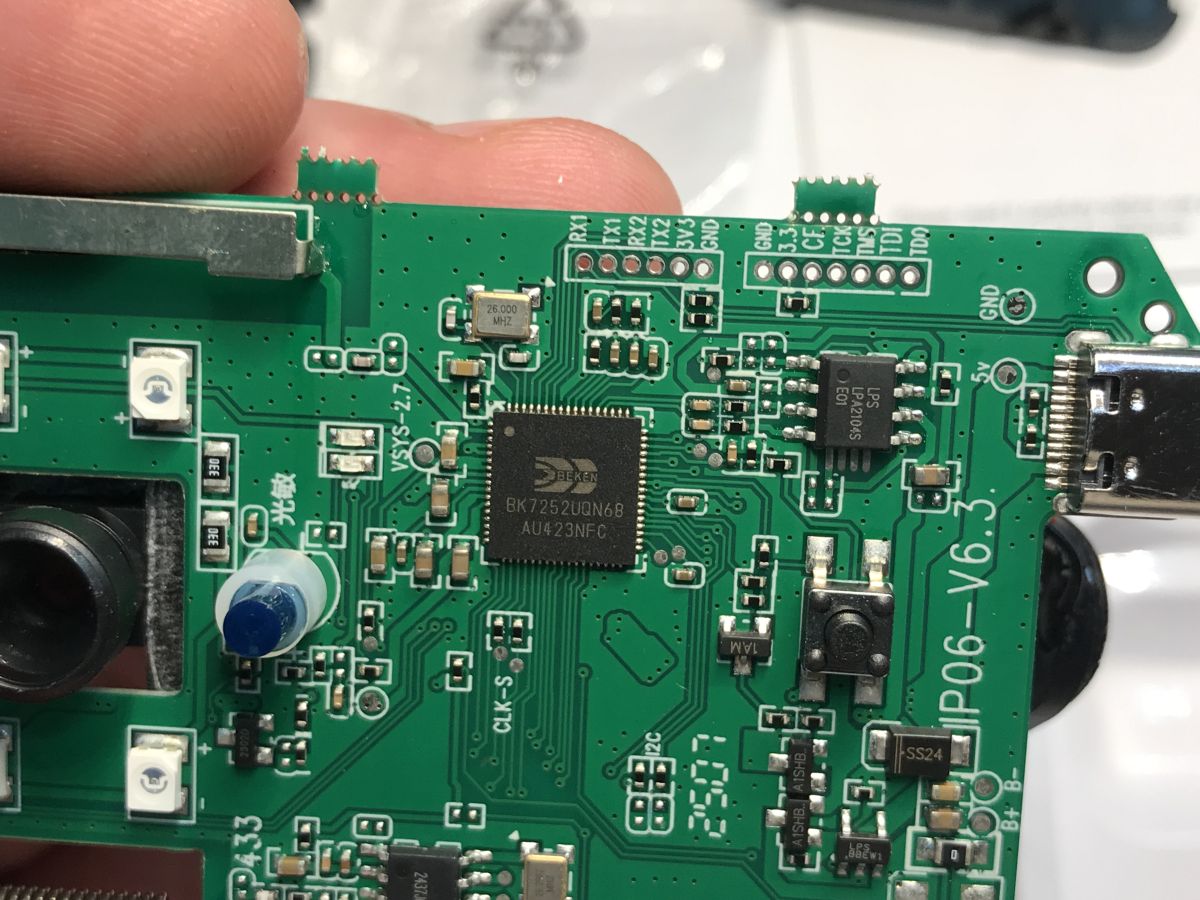

    Added after 30 [seconds]:
    Close-up of a PCB with BK7252UQN68 chip and micro USB port

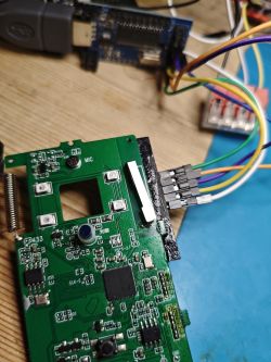

    Added after 5 [minutes]:
    https://github.com/openshwprojects/FlashDumps/commit/b1ca8fa8f9bd579c55d094e290e40abb42099654
    This doorbell arrived today. It's probably like the one @divadiow has. It has routed out SPI, but I wanted to try UART. I am unable to read it directly at 0x0 offset, but it seems I managed to read it with wrap-around hack. So , now my binary starts at 0x11000 offset.

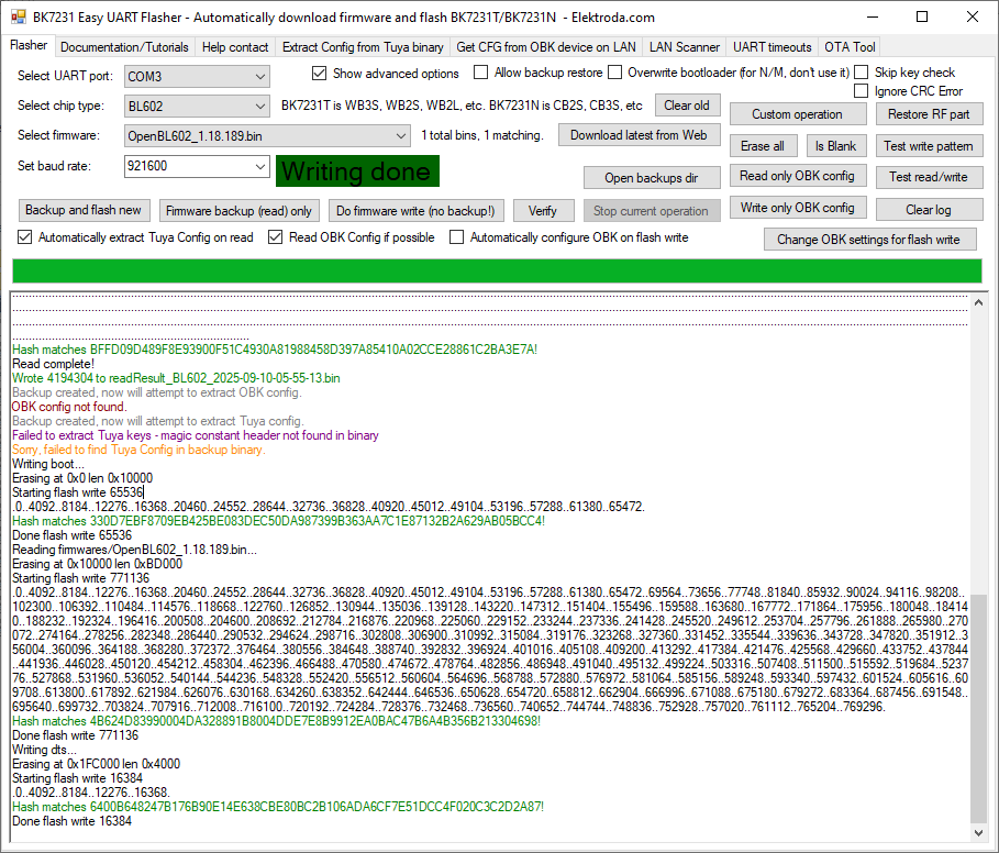

    Added VERY hacky BL602 write.
    Everything from 0 to 0x10000 is just copied from dump to base64.
    Then app header manipulation (app size, app hash and header crc). Again, originally copied from dump to base64.
    And finally dts - once again just copied from dump to base64.
    Plus i've had to add erase from 0 to 0x1A2000 (lfs addr) before writing just so that it would pass hash check.

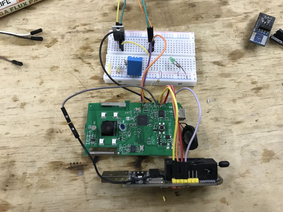

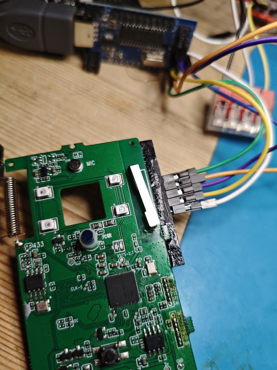

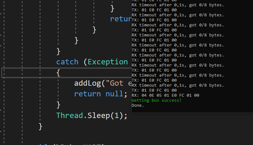

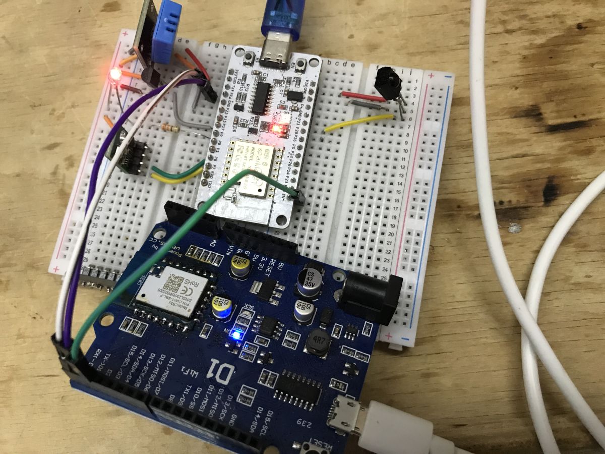

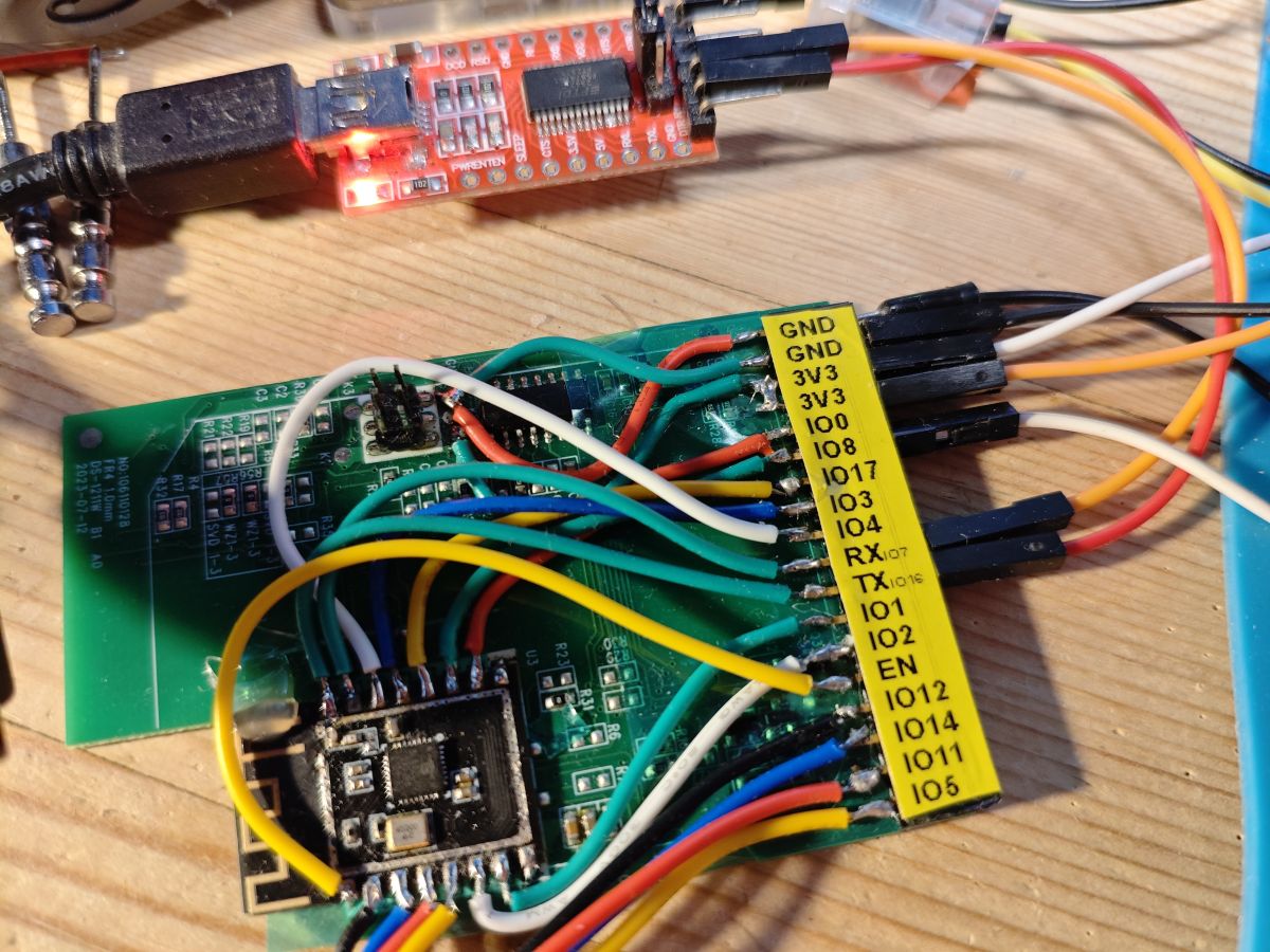

    Ok, I tried method from the first post with my new camera and it worked with first try.
    Breadboard with DHT sensor and microcontroller connected to a camera module
    https://github.com/openshwprojects/FlashDumps/commit/45a8ecd96d50d4a370edfc7744672095ea7d4c21

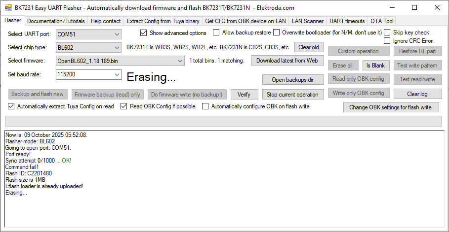

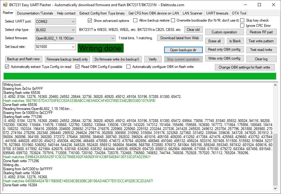

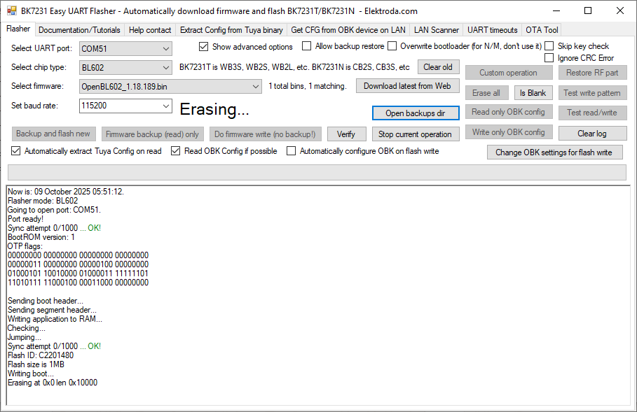

  • BL602 write works; 1 MB flash is slow
    #47 21714477
    Posts: 5212
    Help: 446
    Rate: 914
    hmm. dunno. I assume you've got the Tuya OBK running on it OK? There's daniel-dona and Apache02's opencam efforts I guess.
    Here I used unadulterated test pad for some DS18B20 tests to get timings right https://www.elektroda.com/rtvforum/topic4127230-60.html#21620710
    Added after 40 [seconds]:
    I am certainly going to create I2C pin-wide scanner
    this could very useful, for any platform tbh

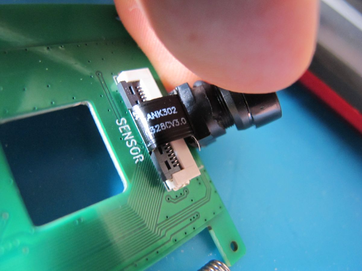

    You'll have probably noticed that the cam connector isn't the same 18-pin job seen on mini cams.
    Camera module being installed onto a PCB labeled SENSOR
    Added after 55 [minutes]:

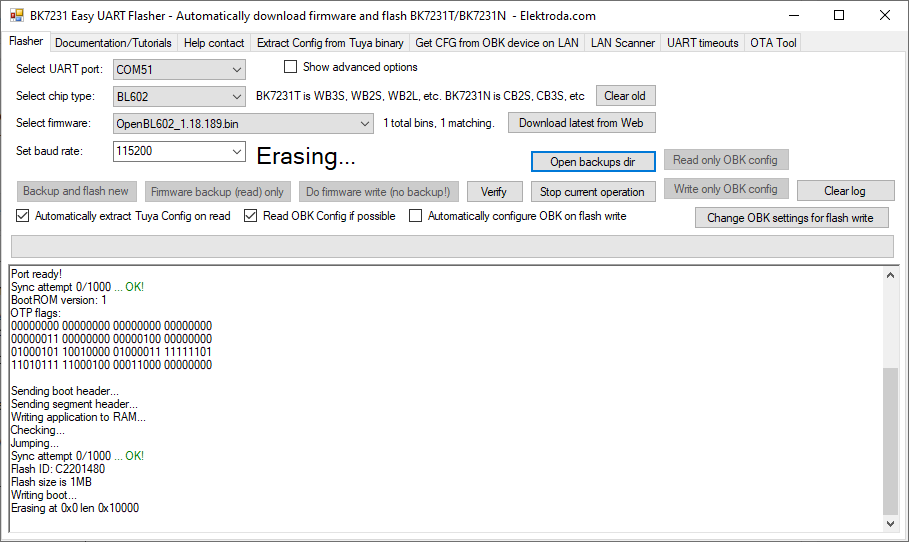

    flashed OK to 4mb BL. boots and broadcasts
    Easy UART Flasher interface with completed firmware flashing process
    Added after 6 [minutes]:
    erase DN and flash. boots
    BK7231 Easy UART Flasher window with Write complete! message

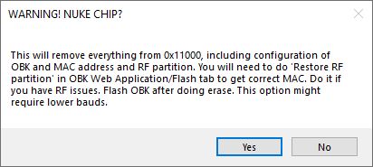

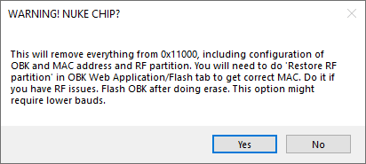

    that erase all text could do with changing depending on platform. erase all from 0 except for S/T/U/7252?
    Warning dialog about full chip erase including RF and MAC configuration

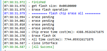

    Added after 13 [minutes]:
    1MB BL602 "backup and flash new" 1mb read seems OK but erase/write is slow with pauses with "command timed out!". It's still writing but I'm assuming it won't work, partitions catering for 2mb flash anyway?
    BK7231 Easy UART Flasher interface with flash process error messages

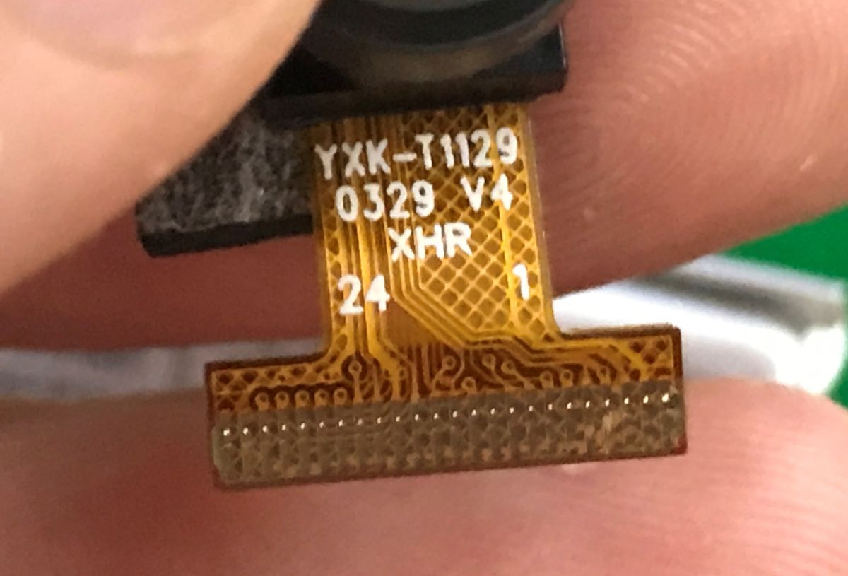

    This is my camera sensor:
    Close-up of FPC ribbon cable with label YXK-T1129 and electrical connector
    This is my boot log:

    Important, I guess? Is yours the same?
    [01-01 18:12:20 TUYA N][gc0329c.c:547] GC0329_chip recognite
    [01-01 18:12:20 TUYA N][gc0329c.c:574] GC0329_chip address: 49 ,chipid:192
    [01-01 18:12:20 TUYA N][soc_camera.c:178] sensor_auto_recognite gc0329c
    [01-01 18:12:20 TUYA N][soc_camera.c:815] gc0329c device_register success
  • #49 21714547
    Posts: 5212
    Help: 446
    Rate: 914
    mine seems to be GC0328C
  • #50 21714554
    insmod
    Posts: 1432
    Help: 168
    Rate: 455
    >>21714541
    Since it's a 24pin camera, would it work in ESP32-CAM?
    BL602 update.
    SHA256 verify on both read and write.
    Erase hack
    Added after 9 [minutes]:
    Plus added 1mb partitions
    >>21714477
    If command timed out - then flashloader died. Reset is needed.
  • BL602 erase fails above 921600 baud
    #51 21714622
    Posts: 5212
    Help: 446
    Rate: 914
    I'll have to get one now to find out 😌
    insmod wrote:
    BL602 update.
    Erase hack
    i'm not getting past erase step at any baud with 1mb
    BK7231 Easy UART Flasher interface during memory erasing process
    erase all attempt in same session
    BK7231 Easy UART Flasher interface showing flash memory erasing process
    4mb backup/flash new seems ok still
    BK7231 Easy UART Flasher window showing Writing done after flashing process
    921600 baud is max for any BL602 operation it seems - sync fail anything higher
    Added after 10 [minutes]:
    EF quits if COM port open when trying BL operations

    Ai-WB2-12f module works fine for me with 1500000 baud.
    On 1mb, for how long have you tried to wait?

    It seems we still can improve SPI flash operation a bit. I've described a problem there:
    https://www.elektroda.com/rtvforum/topic4073760.html#21714732
    Long story short, it seems UnprotectFlash has to be expanded to follow logic from AsProgrammer. I couldn't reflash my BK7252 doorbell without it. Interestingly enough, the problem occured for the first time after many flash cycles...
    I think we also need a checkbox for reset state so I can easily enter SPI mode (and exit it ) from gui.

    Rate: 914
    15mins:
    BK7231 Easy UART Flasher interface with memory erasing in progress.
  • BL602 sync retries before successful flash write

    >>21714772
    Flasher mode: BL602
    Going to open port: COM6.
    Port ready!
    Sync attempt 0/1000 ... failed, will retry!
    Sync attempt 1/1000 ... failed, will retry!
    If doing something immediately after another operation, it might not sync for about half a minute
    Otherwise, please pull high BOOT/IO8 and reset.
    Sync attempt 2/1000 ... failed, will retry!
    Sync attempt 3/1000 ... failed, will retry!
    Sync attempt 4/1000 ... failed, will retry!
    Sync attempt 5/1000 ... failed, will retry!
    Sync attempt 6/1000 ... failed, will retry!
    Sync attempt 7/1000 ... failed, will retry!
    Sync attempt 8/1000 ... failed, will retry!
    Sync attempt 9/1000 ... failed, will retry!
    Sync attempt 10/1000 ... OK!
    Command fail!
    Flash ID: C2201480
    Flash size is 1MB
    Eflash loader is already uploaded!
    Writing boot...
    Erasing at 0x0 len 0x10000
    Starting flash write 65536
    .0..4092..8184..12276..16368..20460..24552..28644..32736..36828..40920..45012..49104..53196..57288..61380..65472.
    Hash matches 1B8790157DA37D8FECCE0A333BABCCAB3A6DCAF4DCF89D334E2B0338D107A3FB!
    Done flash write 65536
    Reading firmwares/OpenBL602_1.18.189.bin...
    Erasing at 0x10000 len 0xBD000
    Starting flash write 771136
    .0..4092..8184..12276..16368..20460..24552..28644..32736..36828..40920..45012..49104..53196..57288..61380..65472..69564..73656..77748..81840..85932..90024..94116..98208..102300..106392..110484..114576..118668..122760..126852..130944..135036..139128..143220..147312..151404..155496..159588..163680..167772..171864..175956..180048..184140..188232..192324..196416..200508..204600..208692..212784..216876..220968..225060..229152..233244..237336..241428..245520..249612..253704..257796..261888..265980..270072..274164..278256..282348..286440..290532..294624..298716..302808..306900..310992..315084..319176..323268..327360..331452..335544..339636..343728..347820..351912..356004..360096..364188..368280..372372..376464..380556..384648..388740..392832..396924..401016..405108..409200..413292..417384..421476..425568..429660..433752..437844..441936..446028..450120..454212..458304..462396..466488..470580..474672..478764..482856..486948..491040..495132..499224..503316..507408..511500..515592..519684..523776..527868..531960..536052..540144..544236..548328..552420..556512..560604..564696..568788..572880..576972..581064..585156..589248..593340..597432..601524..605616..609708..613800..617892..621984..626076..630168..634260..638352..642444..646536..650628..654720..658812..662904..666996..671088..675180..679272..683364..687456..691548..695640..699732..703824..707916..712008..716100..720192..724284..728376..732468..736560..740652..744744..748836..752928..757020..761112..765204..769296.
    Hash matches 4B624D83990004DA328891B8004DDE7E8B9912EA0BAC47B6A4B356B213304698!
    Done flash write 771136
    Writing dts...
    Erasing at 0xFC000 len 0x4000
    Starting flash write 16384
    Hash matches 6400B648247B176B90E14E638CBE80BC2B106ADA6CF7E51DCC4F020C3C2D2A87!
    Done flash write 16384
    I don't get any output after flashing though
    Disabled dts, and it booted.

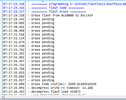

    damn. ok. trusty USB-TTL taken offline for refurb or something. can't get above 921600 with another CH340 still but it does erase/write 1mb. Will try other adaptors too.
    BK7231 Easy UART Flasher interface with Writing done status message
    BLDC is OK at 2000000 erase/write with both CH340 but maybe it's more forgiving/does retries - not that there's obvious sign of correction/retry in log I don't think.
    Log of flash memory programming with multiple erase pending status messages.
    anyway, good work.
    Added after 20 [minutes]:
    ESP module connected to USB-TTL adapter with multicolored jumper wires
    'FTDI' also doesn't erase (for me).
    no matter perhaps. everyone's setups differ, so many variables etc. I could probably find other 1mb module and it may be different.
    I'm using BLDC as a benchmark and it does continue to erase/write 1mb with these adaptors and at 2m baud.
    This full erase with fake FTDI also has fewer 'erase pending' for whole chip, so maybe they are retries. lower the baud to 1mb and 'erase pending' is listed only once.
    System log showing flash memory erase process with successful completion
    Hash matches 330D7EBF8709EB425BE083DEC50DA987399B363AA7C1E87132B2A629AB05BCC4!
    Erasing from 0x10000 to 0xCD000
    Erase pending...
    Erase pending...
    Erase pending...
    Erase pending...
    Erase pending...
    Erase pending...
    Erase pending...
    Erase pending...
    Erase pending...
    Erase pending...
    Erase pending...
    Erase pending...
    Erase pending...
    Erase pending...
    Erase pending...
    Erase pending...
    Erase pending...
    Writing dts...
    Erasing from 0x1FC000 to 0x200000
    Erase pending...
    Erase pending...
    Erase pending...
    Erase pending...
    And suddenly read/write with 2000000 br works for me on CH340 esp adapter board.

    cool. will do more BL602 flashing. Just checking Beken SPI is OK with WIP BK7252U doorbell dev board
    Close-up of a green PCB with multicolored jumper wires connected.
    it'd be cool if you could download QIO for BK7252, BK7231U/T :)
    BK7231 Easy UART Flasher window with “Writing done” message

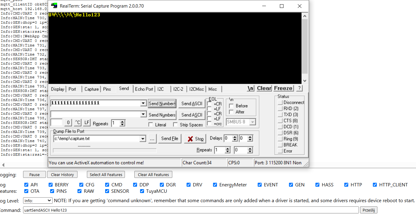

    #60 21716364
    Posts: 14755
    Rate: 12881
    I've decided to play a bit with possibility to flash from another Beken. NiceMCU, UART test.
    uartInit 115200
    uartSendASCII Hello123
    RealTerm window with serial data transmission and Hello123 shown in output

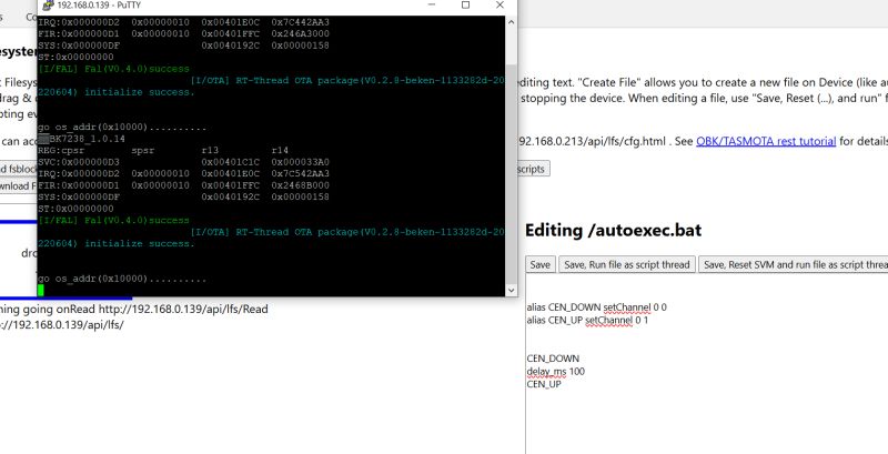

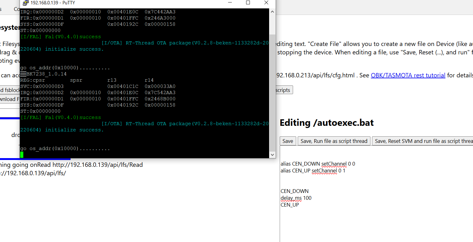

    Well, I can send from BK7238 to PC, but can't BK7238 can't see what I send from PC. I'm investigating.
    Ahh, UART debug tool has a buffer overrun. Probably from XJ PR? Not sure...
    I am planning to check if I can connect one NiceMCU to my Arduino-Wemos-CB3S via UART1 and GPIO for CEN and try to remotely CEN it and do some bootloader operation.
    Ok step 1:

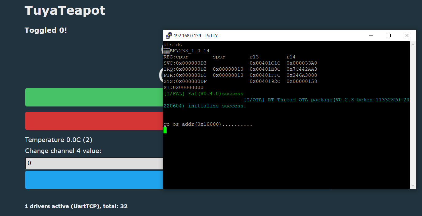

    TuyaTeapot interface with PuTTY terminal showing logs from BK7238
    Added after 3 [minutes]:
    Prototype boards with connected NiceMCU and Arduino-Wemos modules
    PuTTY terminal showing UART debug logs and web editor with /autoexec.bat script
    Added after 28 [minutes]:
    Code in editor and log window with RX/TX messages and “Getting bus success!” message
    It can get bus:

    Terminal window with messages about device connection and Flash memory read
    It's reading, it seems:
    Terminal showing UART debug messages and FLASH memory hex dump
    I guess I need to merge your PR today @insmod , so I can split serial backend into "hardware" serial and "TCP TO UART" serial

I flashed many times and now erase fails. What should I try?
Expand Unprotect logic before erase, similar to AsProgrammer. A contributor noted needing stronger Unprotect after many BK7252 cycles. Add an Unprotect/Status-Register release step, then retry the erase/write. [Elektroda, p.kaczmarek2, post #21714737]
