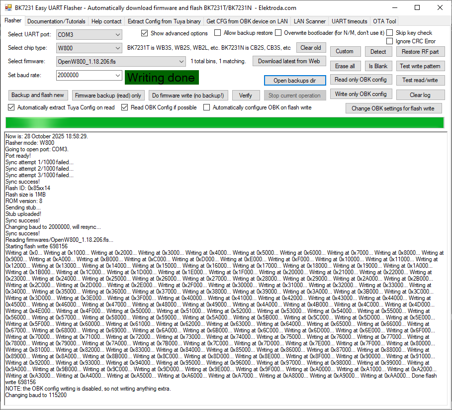

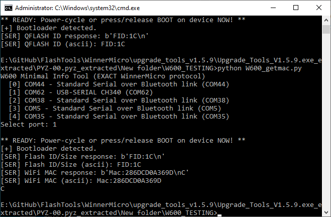

    insmod wrote:
    And on W600 flash id command outputs either 1 or 2 bytes, i'm not sure which, because i get 1C
    ah yes. remember now. weird.
    CMD window showing W600 bootloader detection and device information
    what I have played with
    • W600_TESTING_SCRIPTS.zip (3.4 KB) You must be logged in to download this attachment.
  • W800 read works; BK7231T UART retry fails

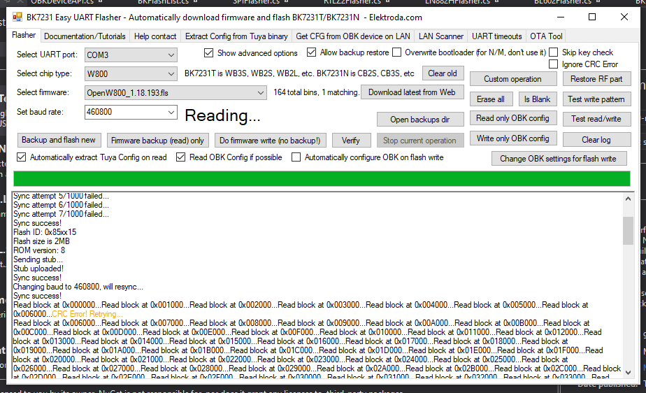

    Nice, W800 read seem to work.
    BK7231 Easy UART Flasher interface reading firmware from device via COM3

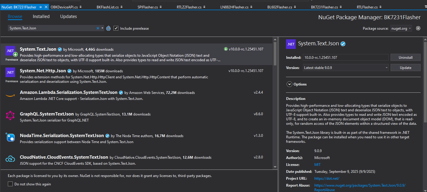

    @insmod by msvc didn't see System.Text.Json and I had to install it via NuGet , is it intended, or is my MSVC old?
    Screenshot of NuGet Package Manager showing System.Text.Json package

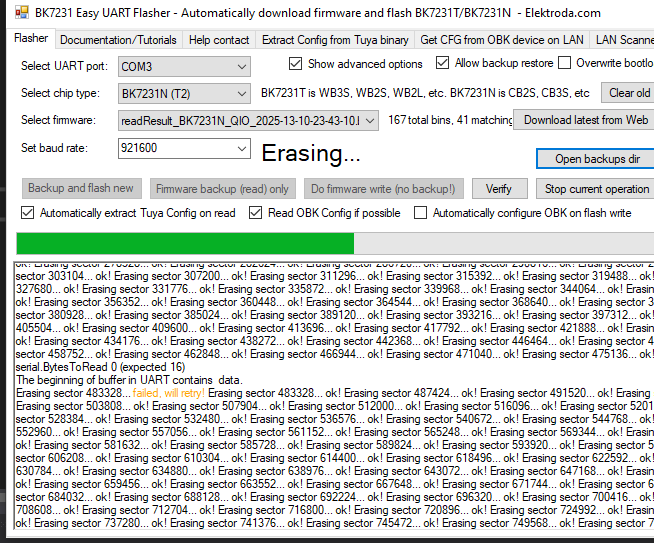

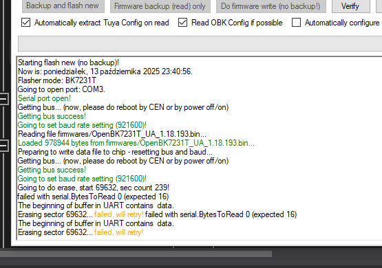

    PS: I tried to add retry for BK7231T on UART in EF:
    Flashing tool UI with UART errors and flash process log failing at sector 69362
    It fails to retry everytime.
    On the other hand... on N:
    Screenshot of BK7231 Easy UART Flasher erasing firmware from BK7231N chip
    I cause interference by shorting RX and TX together.

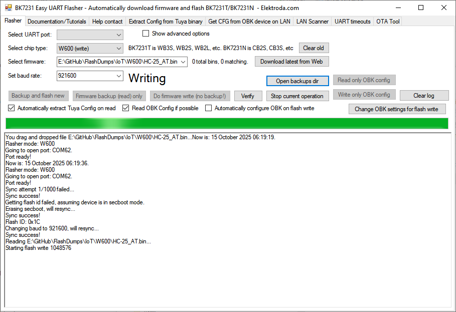

    #97 21720718
    Posts: 5212
    Help: 446
    Rate: 914
    >>21720700
    amazing! in that case I might have to have another stab at backing up the ELM327 W600 I still have on stock fw, though the pins are quite small and IC placement particularly awkward. PB6 is right next to VDD33 too. xtal could be removed I guess
    Added after 40 [minutes]:
    very good. does EF acknowledge flash completion for you?

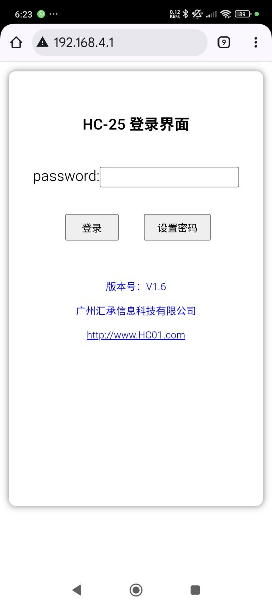

    BK7231 Easy UART Flasher program writing firmware to W600 chip.
    boots, AP, HC-25 web
    Visible Wi-Fi network named HC-25-286dcd0b8d1 with a signal iconHC-25 login page with password field and two buttons on a white background
    Added after 13 [minutes]:

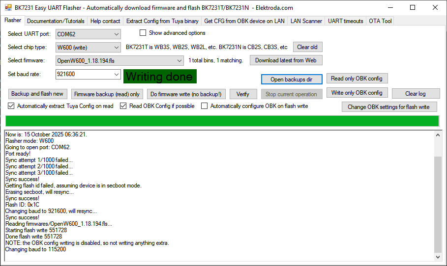

    if writing custom bin*
    OpenW600 written OK and boots. Air602
    BK7231N Easy UART Flasher interface with “Writing done” message
    insmod wrote:
    there was no log on any UART
    same.

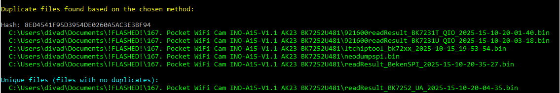

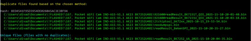

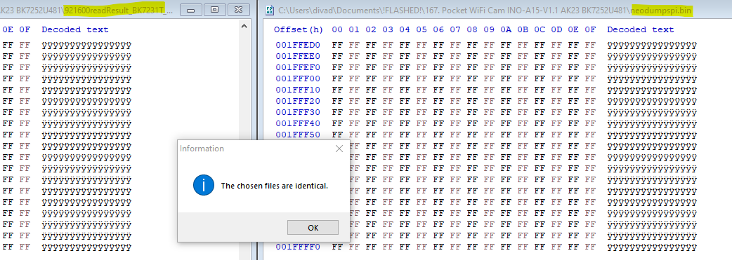

    I'm curious about the current state of BK7252U backup in EF. I've got a new 2MB BK7252UQN48 and I took an SPI backup with Neo and Beken SPI. Easy Flasher BK7231T and BK7231U uart mode takes identical backup to both SPI - so 4 identical backups. But if you take a BK7252U backup it will get it wrong, creating a different backup to the rest.
    Comparison of two binary files showing identical hex code and confirmation message
    EF says it is starting at 0x11000:
    and at the end:
    but then makes a 2,097,152 bytes file with UA in the name.
    If you do a custom read from 0x0 for 0x200000 length you get this, which has been seen in posts before:
    I gather there's an ongoing issue with 4mb BK7252U and wrap-around but a 2mb backup should just be the same as T/U but with different names?
    Terminal window showing list of duplicate and unique binary files by hash
    I attach all backups for reference.

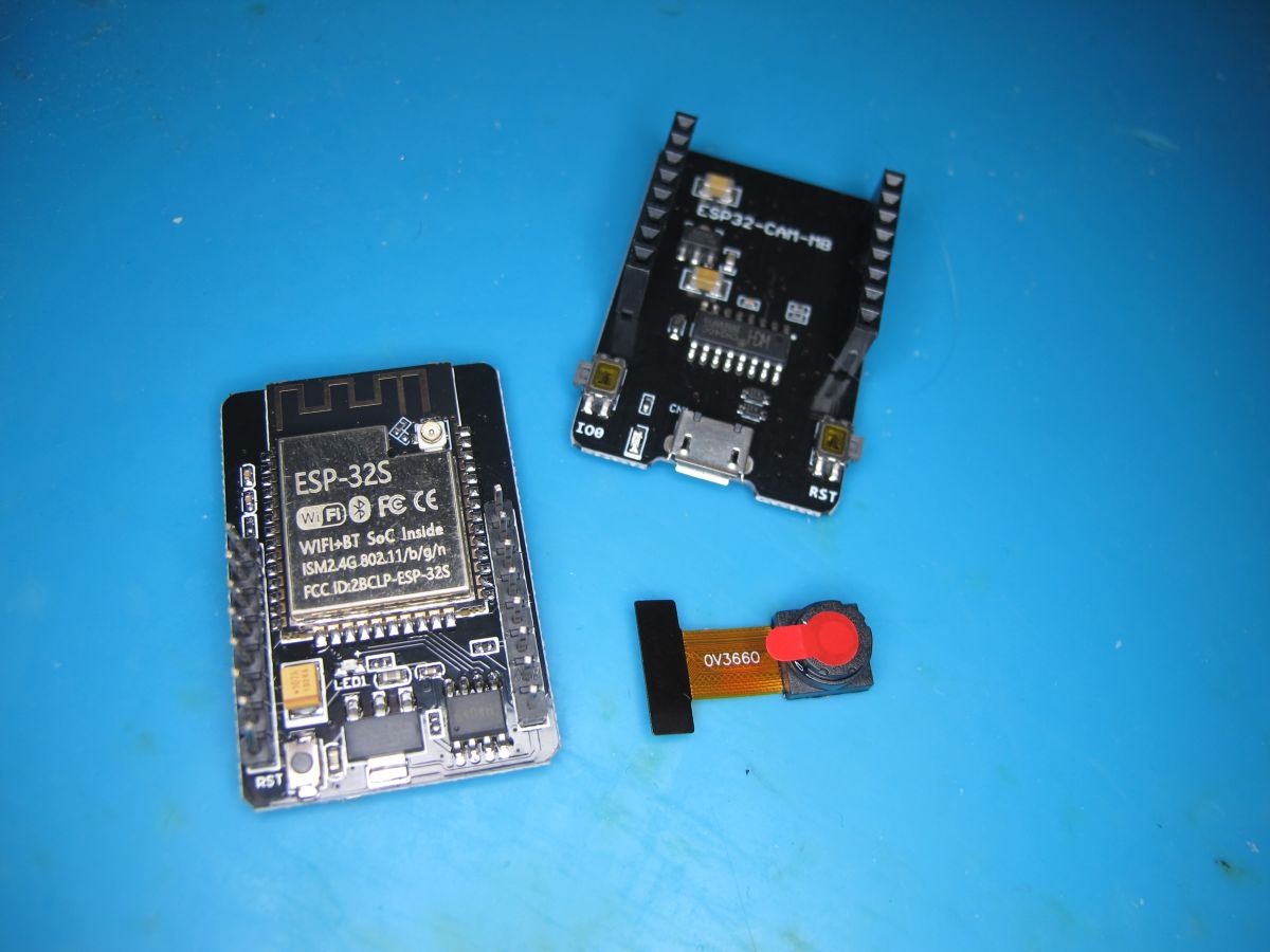

    Rate: 914
    insmod wrote:
    Since it's a 24pin camera, would it work in ESP32-CAM?
    ESP32 modules and OV3660 camera on a blue background
    GPT sketch. it got OmniVision OV3660 right
    Detects some stuff if 24-pin doorbell GC0328C inserted

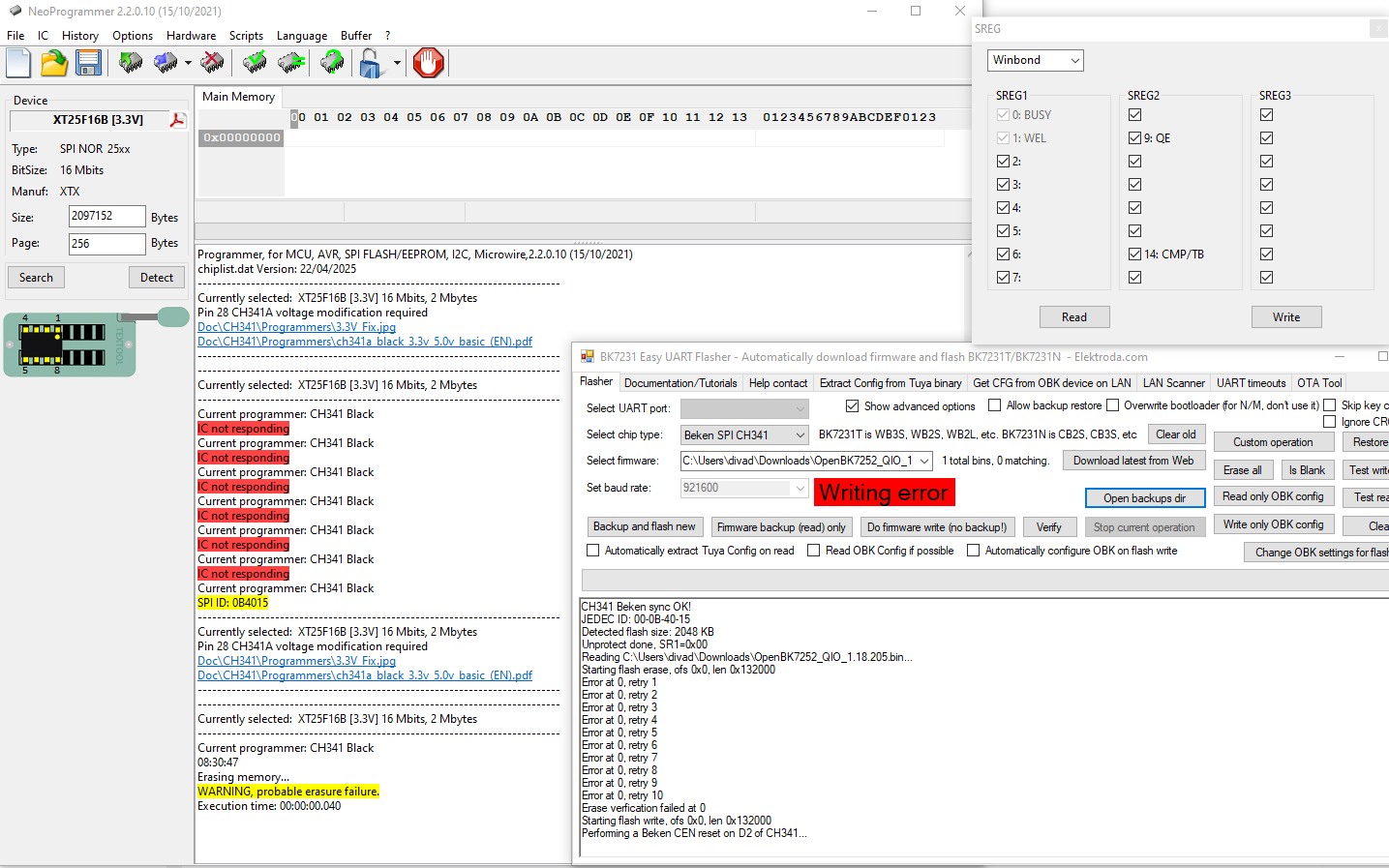

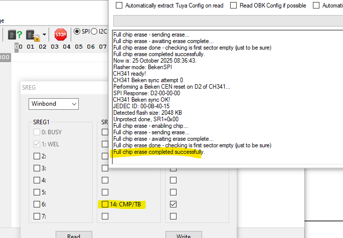

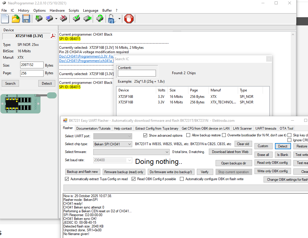

  • Request for SPI-entry D2 mode without erase/write
    #100 21730989
    Posts: 5212
    Help: 446
    Rate: 914
    ah yes, this old chestnut.
    Screenshot showing BK7231 flasher writing error and IC not responding in programmer log
    fiddling with https://www.elektroda.com/rtvforum/topic4150112.html
    Screenshot of flash programming tool with successful full chip erase in BekenSPI mode.
    it's weird because unchecking SREG2:14 then allows erase/write but subsequent reads of values in AS shows it checked still BUT you can continue to erase/write. hmm
    Also, could we have an SPI-entry/D2 mode only for Beken SPI? At the moment you have to do an operation (erase/write/read) to get into SPI mode, but sometimes you my just want to get into SPI mode to then use other apps.
  • #101 21731041
    Posts: 14755
    Rate: 12881
    Good idea, I added "Detect" button, it currently works by doing custom operation with 0 read and 0 write size. Can you check if it works?
  • #102 21731062
    Posts: 5212
    Help: 446
    Rate: 914
    excellent. seems OK. thanks
    Screen showing NeoProgrammer and BK7231 Flasher software for SPI chip programming

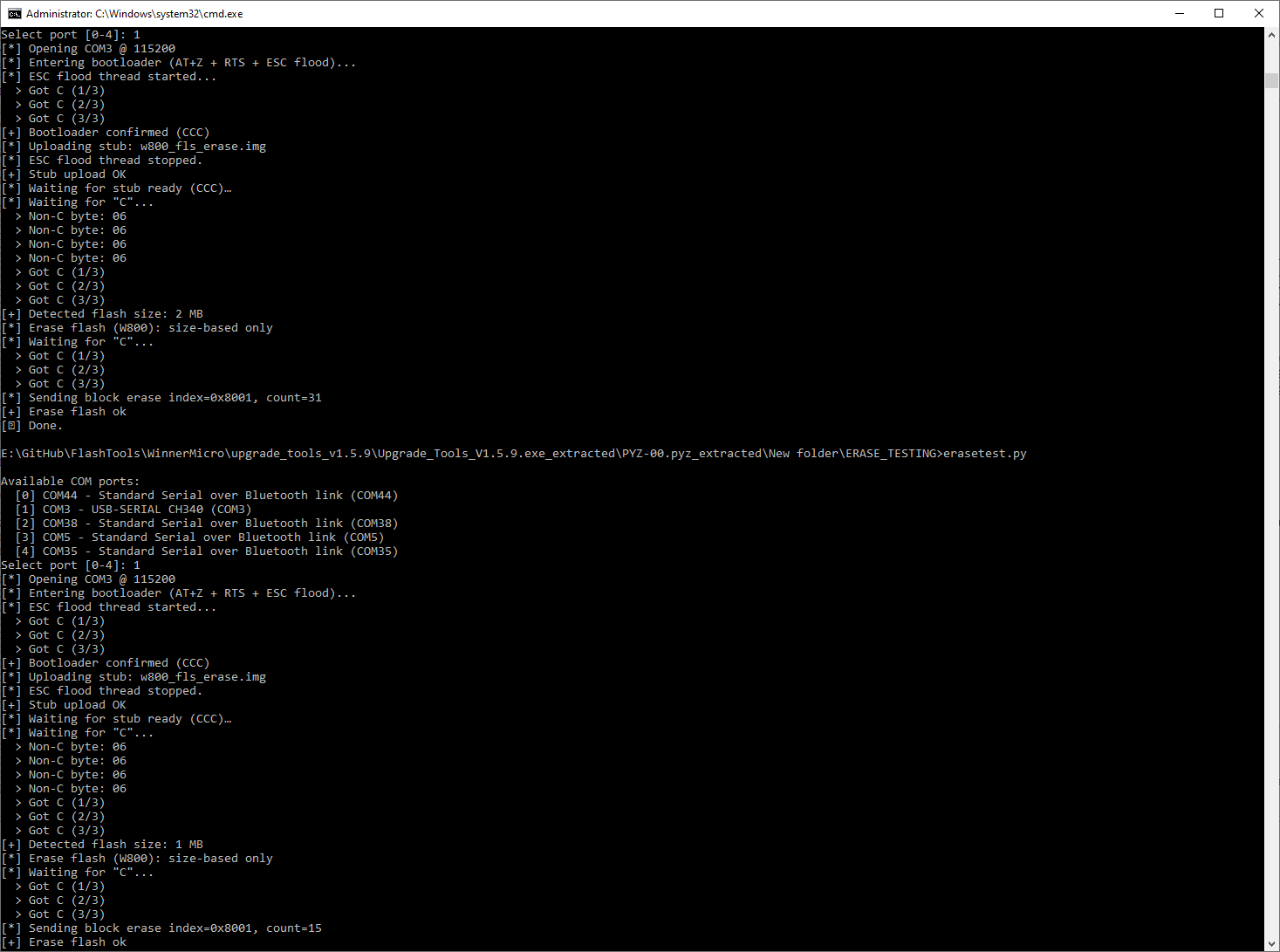

    #103 21734531
    Posts: 5212
    Help: 446
    Rate: 914

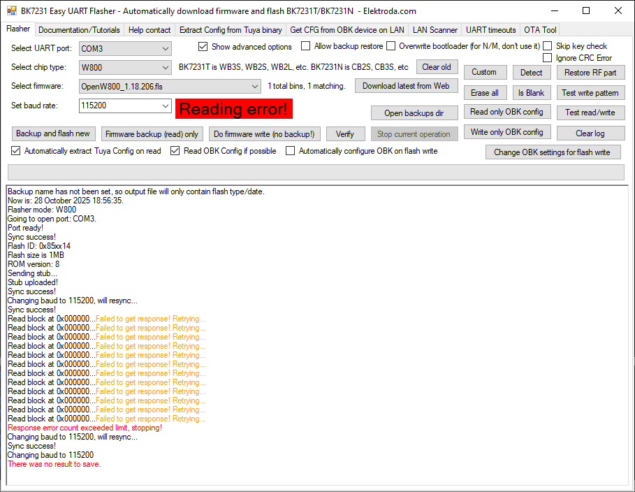

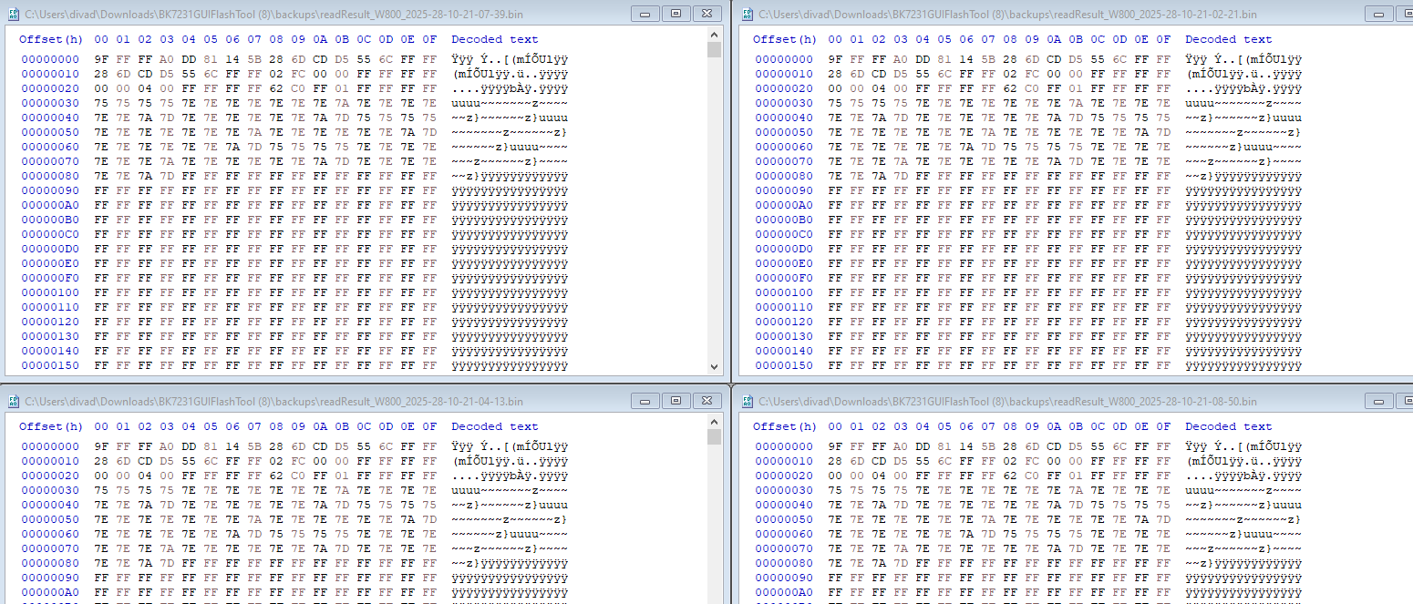

    forgot I'd tried W806 too. pretty sure this is the same as when tried with Python thing. detect flash size but nothing more
    BK7231 Easy UART Flasher interface with a flash memory reading error.
    Write works OK though. Or says it does. Doesn't boot.
    BK7231 Easy UART Flasher interface with Writing done message
    Added after 2 [hours] 17 [minutes]:

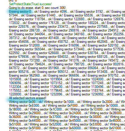

    here's what seems to be a working full erase inspired by Upgrade Tool's serialthread.py
    Code: Python
    CMD window showing flash erase process for W806 microcontroller
    Erase success for 1mb W806 too but I can't confirm it.

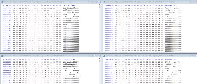

    on 2mb W800 read-backs appear blank apart from the first few bytes. Read-back content is the same after stopping Upgrade Tool's own erase function just before it starts to write new image (erase selection requires flash image selection too to start).
    Four flash memory dump windows in hex editor view with decoded text

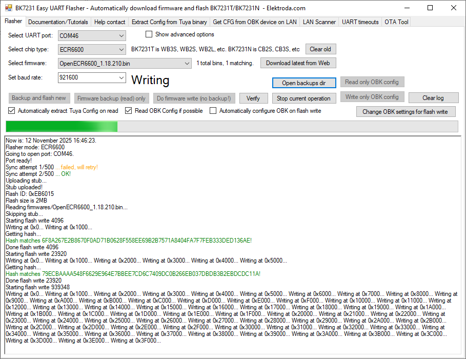

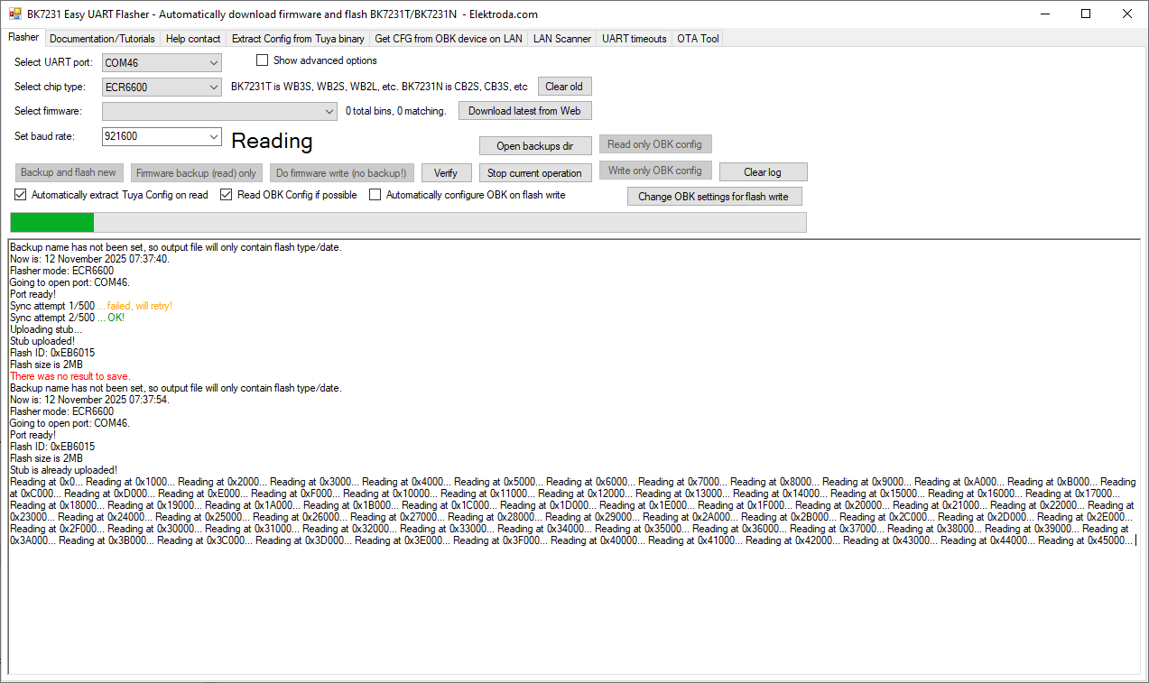

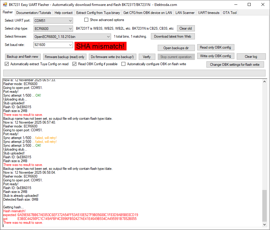

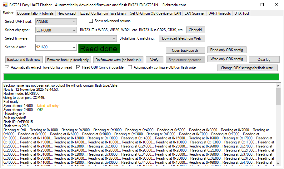

    does ECR6600 stub pr read OK for you @insmod ?
    I get this
    Screenshot of BK7231 Flasher tool showing SHA mismatch error in red text
    but v148 reads ok
    BK7231 Easy UART Flasher interface with firmware read completed
    #108 21748861
    insmod
    Posts: 1432
    Help: 168
    Rate: 455
    >>21748843
    Fixed
  • #109 21748866
    Posts: 5212
    Help: 446
    Rate: 914
    cool. initial read fails but then click read again and it will start
    BK7231 Easy UART Flasher interface reading flash memory via COM46.
    same pattern with a few tries. device resets in between
    460800 baud fails during EF read and flashing

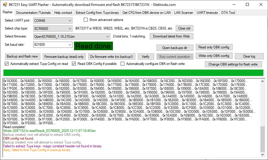

    #111 21748882
    Posts: 5212
    Help: 446
    Rate: 914
    Ta. Now afk until this evening
    Added after 8 [hours] 50 [minutes]:
    Screenshot of BK7231 Easy UART Flasher showing memory read completed
    Firmware flashing process for ECR6600 using file OpenECR6600_1.18.210.bin
    Added after 21 [minutes]:
    bit more.
    every baud in EF read first time apart from 460800 which errors with
    Added after 2 [hours] 7 [minutes]:
    writing worked first time for all but 460800. I never flash at 460800 to be honest.

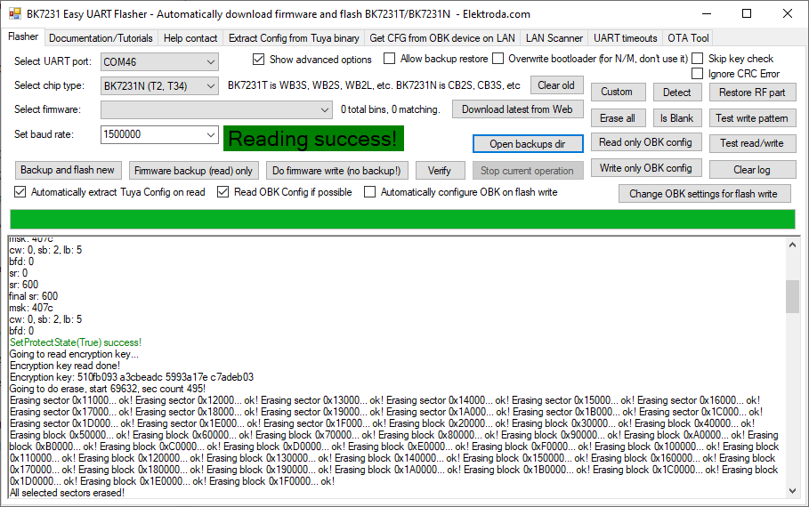

    Erase-all now leaves flash empty from 0x11000 onward
    #120 21777296
    Posts: 5212
    Help: 446
    Rate: 914
    https://github.com/openshwprojects/BK7231GUIFlashTool/pull/86
    erase all of N just now showed empty flash from 11000 on read-back. it's very quick.
    Screenshot of BK7231 Easy UART Flasher showing Reading success! and flash erase logs
    success when erase is part of firmware write too
