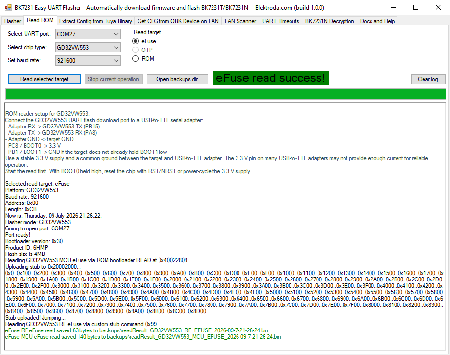

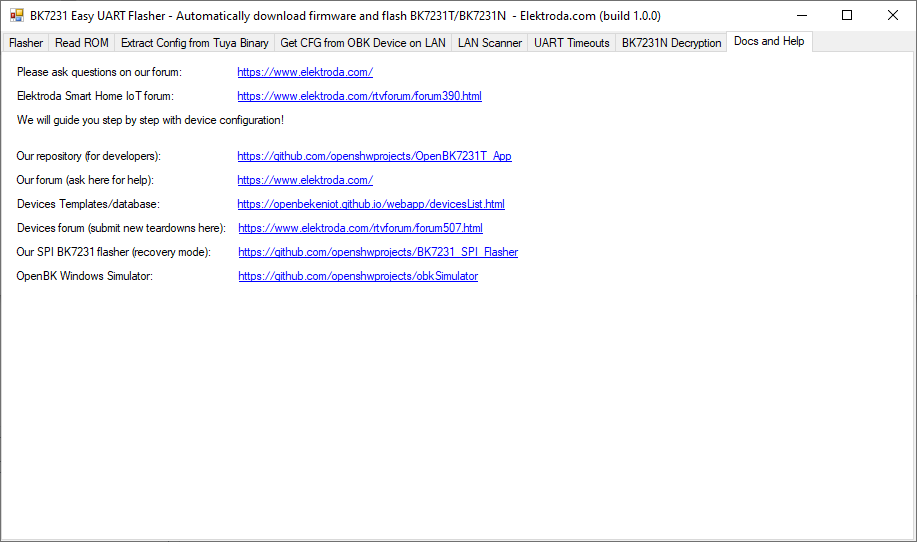

    thanks all :)
    Beken BK7231/BK7252 SPI flashing and recovery - new flasher tool and protocol specs Beken BK7231/BK7252 SPI flashing and recovery - new flasher tool and protocol specsScreenshot of BK7231 Easy UART Flasher showing a list of help links to forums and GitHub.
    Added after 13 [minutes]:
    but now I want to revise the links and wording on the Docs tab more 😈

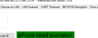

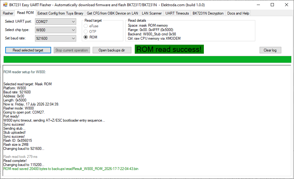

    Can we merge what we have first?
    This empty place looked indeed better with more info, haha:
    Screenshot showing the message “eFuse read success!” on a green background.
  • #393 21935750
    Posts: 5153
    Help: 442
    Rate: 906
    <sigh> OK. It is back
