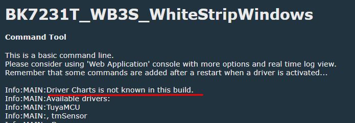

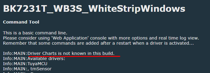

Let's start with checking if your build has "charts" driver:
Screenshot of the BK7231T_WB3S command tool indicating missing charts driver.
If it's not present, set the ENABLE_DRIVER_CHARTS to 1 in obk_config.h for the platform of your choice by following paragraphs "Per-Pull Request Builds" and "Customizing your own build" in this guide to get your custom build made online (no toolchain required):
https://www.elektroda.com/rtvforum/topic4033833.html#20946719

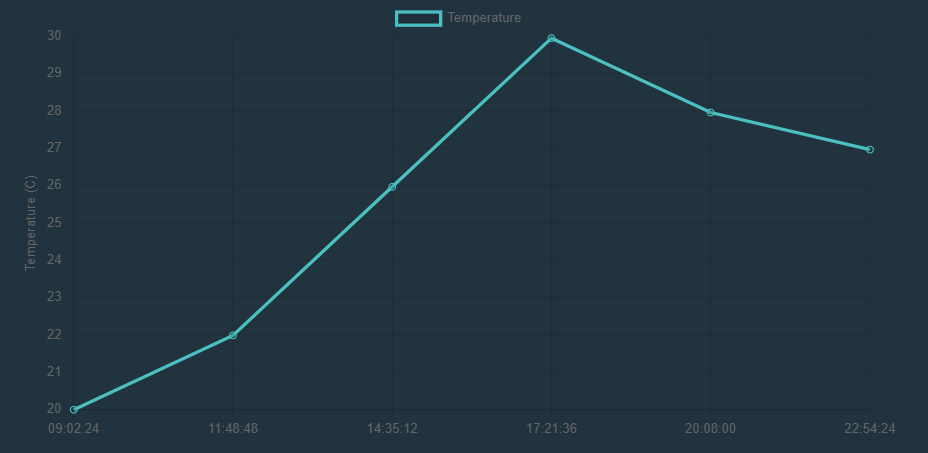

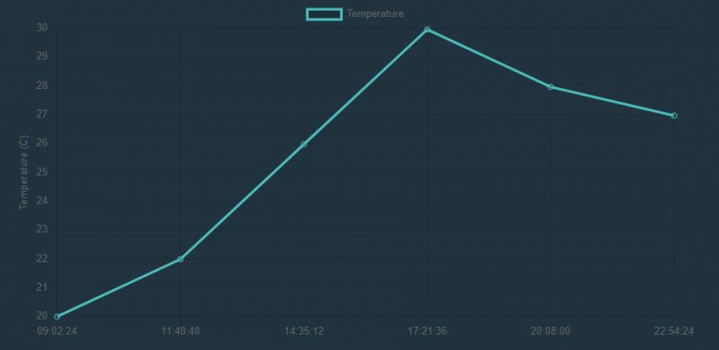

Sample chart 1 - simplest temperature chart
This is an example of a basic chart displaying temperature data over time, however, for a demonstration purposes, the data is hardcoded. The chart holds 16 data samples and focuses on a single variable, "Temperature", plotted on one axis.
// Sample 1
// single variable chart
startDriver charts
// chart with max 16 samples, 1 variable and single axis
chart_create 16 1 1
// set the temperature variable with axis
chart_setVar 0 "Temperature" "axtemp"
// setup axis
// axis_index, name, flags, label
chart_setAxis 0 "axtemp" 0 "Temperature (C)"
// for demonstration purposes, add some data at fixed times
// First argument is NTP time value
chart_add 1725606094 20
chart_add 1725616094 22
chart_add 1725626094 26
chart_add 1725636094 30
chart_add 1725646094 28
chart_add 1725656094 27
Result:
Line chart showing temperature changes throughout the day.

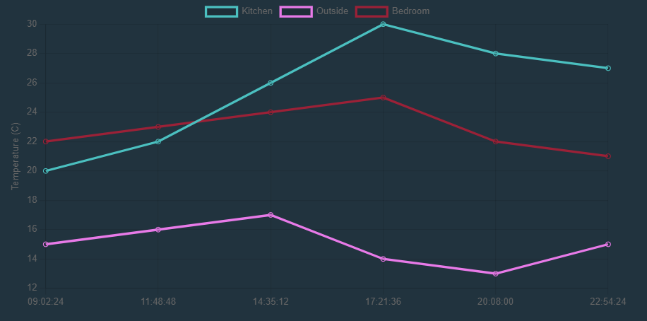

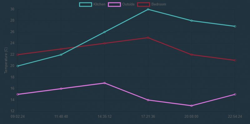

Sample chart 2 - multiple variables of single type
The same approach can be used to display multiple measurements of the same type. Here, for example, we display 3 different temperature values:
// Sample 2
// Three temperature variables chart
startDriver charts
// chart with max 16 samples, 3 variables and single axis
chart_create 16 3 1
// set variables along with their axis
chart_setVar 0 "Kitchen" "axtemp"
chart_setVar 1 "Outside" "axtemp"
chart_setVar 2 "Bedroom" "axtemp"
// setup axis
chart_add 1725606094 20 15 22
chart_add 1725616094 22 16 23
chart_add 1725626094 26 17 24
chart_add 1725636094 30 14 25
chart_add 1725646094 28 13 22
chart_add 1725656094 27 15 21
Result:
A chart showing three temperature variables for different locations over time.

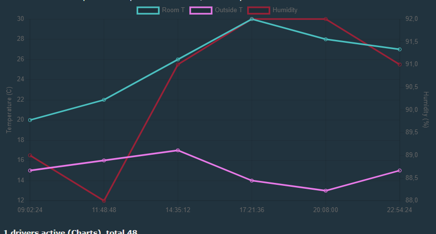

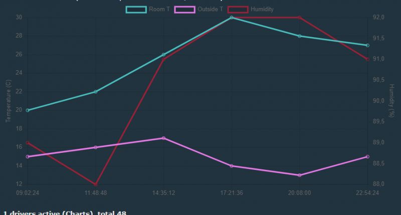

Sample chart 3 - two y axes
Charts driver can also offer you multiple y axes. This way you can display, for example, both temperature and humidity data:
// Sample 3
// Two temperatures and one humidity with separate Temperature/Humidity axes
startDriver charts
// chart with max 16 samples, 3 variables and two separate vertical axes
chart_create 16 3 2
// set variables along with their axes
chart_setVar 0 "Room T" "axtemp"
chart_setVar 1 "Outside T" "axtemp"
chart_setVar 2 "Humidity" "axhum"
// setup axes
// flags 1 means this axis is on the right
chart_setAxis 1 "axhum" 1 "Humidity (%)"
chart_add 1725606094 20 15 89
chart_add 1725616094 22 16 88
chart_add 1725626094 26 17 91
chart_add 1725636094 30 14 92
chart_add 1725646094 28 13 92
chart_add 1725656094 27 15 91
Result:
Chart showing room temperature, outside temperature, and humidity.

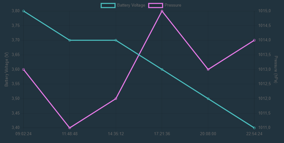

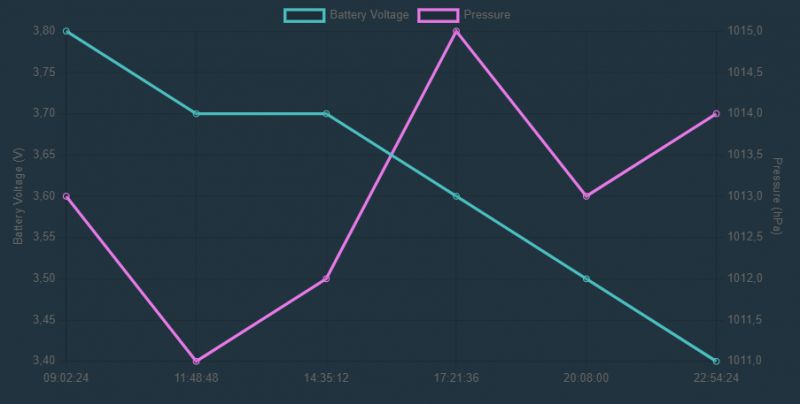

Sample chart 4 - battery and pressure
Of course, you can display any kind of data you want. Here is for example a voltage and the pressure chart:
// Sample 4
// Battery voltage + pressure
startDriver charts
// chart with max 16 samples, 2 variables and 2 axes
chart_create 16 2 2
chart_setVar 0 "Battery Voltage" "axvolt"
chart_setVar 1 "Pressure" "axpress"
// setup axis
chart_setAxis 0 "axvolt" 0 "Battery Voltage (V)"
chart_setAxis 1 "axpress" 1 "Pressure (hPa)"
chart_add 1725606094 3.8 1013
chart_add 1725616094 3.7 1011
chart_add 1725626094 3.7 1012
chart_add 1725636094 3.6 1015
chart_add 1725646094 3.5 1013
chart_add 1725656094 3.4 1014
Result:
Graph showing battery voltage and pressure over time

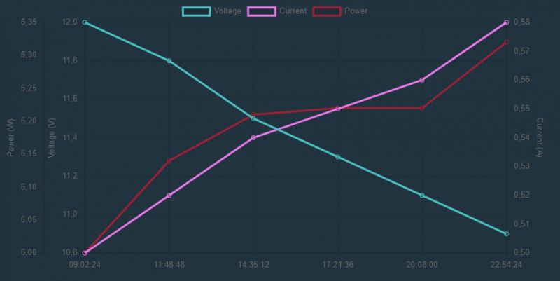

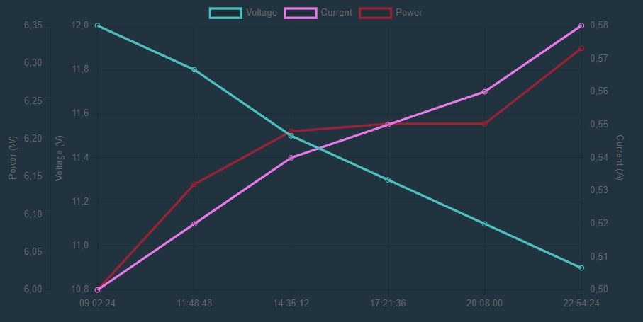

Sample chart 5 - third y axis
While not recommended, it's still possible to add a third unit axis. Here is a VCP (Voltage/Current/Power) graph:
// Sample 5 - try 3 axes
startDriver charts
// chart with max 16 samples, 3 variables and 3 separate vertical axes
chart_create 16 3 3
chart_setVar 0 "Voltage" "axvolt"
chart_setVar 1 "Current" "axcurr"
chart_setVar 2 "Power" "axpower"
// setup axes
chart_setAxis 0 "axvolt" 0 "Voltage (V)"
chart_setAxis 1 "axcurr" 1 "Current (A)"
chart_setAxis 2 "axpower" 2 "Power (W)"
chart_add 1725606094 12 0.5 6
chart_add 1725616094 11.8 0.52 6.14
chart_add 1725626094 11.5 0.54 6.21
chart_add 1725636094 11.3 0.55 6.22
chart_add 1725646094 11.1 0.56 6.22
chart_add 1725656094 10.9 0.58 6.32
Result:
Chart with three y-axes showing voltage, current, and power.

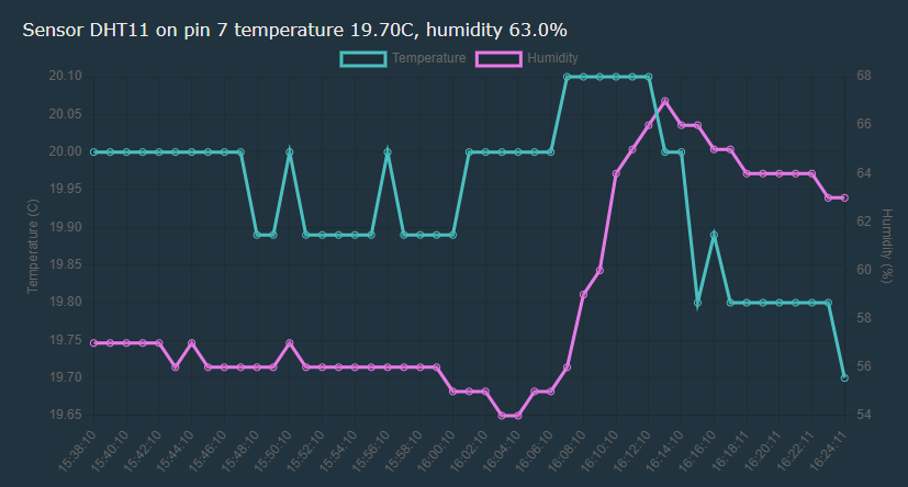

And then we can build upon that. Here is a full code for DHT11 demo:
// DHT11 setup
IndexRefreshInterval 100000
startDriver charts
startDriver NTP
waitFor NTPState 1
chart_create 48 2 2
chart_setVar 1 "Humidity" "axhum"
// setup axes
// every 60 seconds, -1 means infinite repeats
// assumes that $CH1 is temperature div10 and $CH2 is humidity
addRepeatingEvent 60 -1 chart_addNow $CH1*0.1 $CH2
And here is sample output (from @divadiow , thank you for testing):
Temperature and humidity chart from DHT11 sensor
As you can see, our charts driver can work well with DHT11.

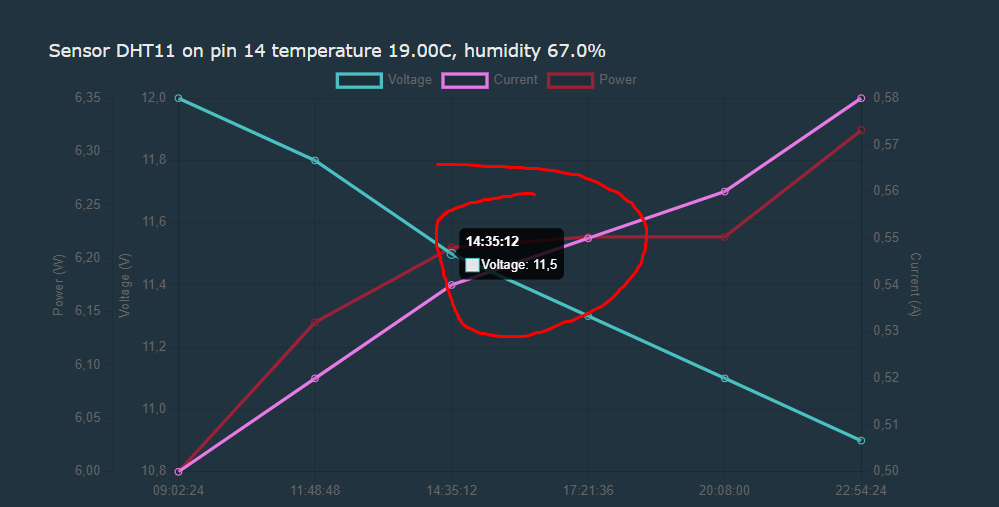

Remember that you can hover mouse over datapoint
If you are not sure what is the value of given datapoint, you can always hover mouse about it to get more details:
Chart of variables for DHT11 sensor with voltage, current, and power

  • A working DHT11 demo used 48 samples, 2 variables, 2 axes, and logged values every 60 seconds with chart_addNow. [#21223630]
  • The driver can plot mixed units on separate axes, including examples such as temperature (°C), humidity (%), battery voltage (V), pressure (hPa), current (A), and power (W). [#21223630]

What causes waitFor NTPState 1 to return 'command not found' on some platforms like W600, and how can I work around missing waitFor support?
That error means the platform build does not include the waitFor command parser. A W600 test printed waitFor NOT found, then still created a chart, but expression handling also looked incomplete. The practical workaround is to skip waitFor and either use fixed timestamps with chart_add, or delay charting until time becomes available by another mechanism. One helper command used chart_add 1727438906+$uptime ... to emulate running time without NTP. [#21241366]

What should I check when charts are missing from the OpenBeken web UI even though startDriver charts appears to run?
First verify that the build actually contains the charts driver, then confirm chart_create really ran. Missing UI output can happen when the driver is running but no g_chart object exists, so the HTML canvas and script never get generated. The thread also suggested checking whether autoexec.bat executed correctly, whether whitespace broke parsing, and whether free memory was still healthy; one example showed about 60 kB free. [#21224054]
