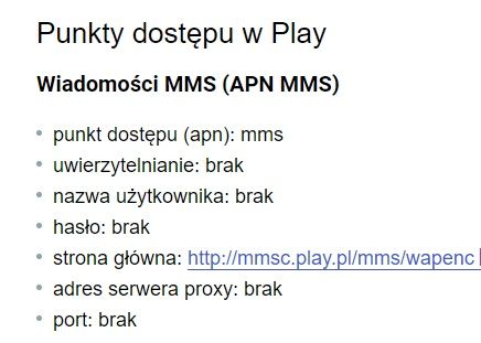

How do I configure a Denver WCM-8010 camera trap to send MMS/email when SMS activation commands fail?
Send the SMS commands to the phone number of the SIM card inserted in the camera, not to *530*; for example, if the camera’s number is 500600700, send *505* to 500600700 [#17729731] To make MMS/email work at all, users reported that the SIM must be activated by a real call, the PIN must be disabled, and the APN/operator settings often have to be entered manually rather than relying on automatic setup [#17999085 #17967375]. Several people also found that the configuration file must be saved directly to the root of the microSD card (not in a subfolder and often not via USB), and that a class 4 card works much more reliably than faster cards [#17967375 #20967189 #18048312]. For some operators, MMS and SMTP cannot be enabled at the same time, so you need to choose one method and configure it accordingly [#19951251] If the camera still misbehaves, the thread repeatedly points to firmware bugs and recommends checking the camera’s logged MMS errors, updating firmware only for the correct PO/batch, and verifying the internal 3V battery and network registration [#17999085 #18048312 #19876753].

    The number should be deleted.
    In the attachment you can test the program I use.
    In the photo trap, if you set ENGLISH, in this program, as Dutch (German), there is such an error when you load Parameter.dat
    • MMSCONFIG.zip (199.29 KB) You must be logged in to download this attachment.

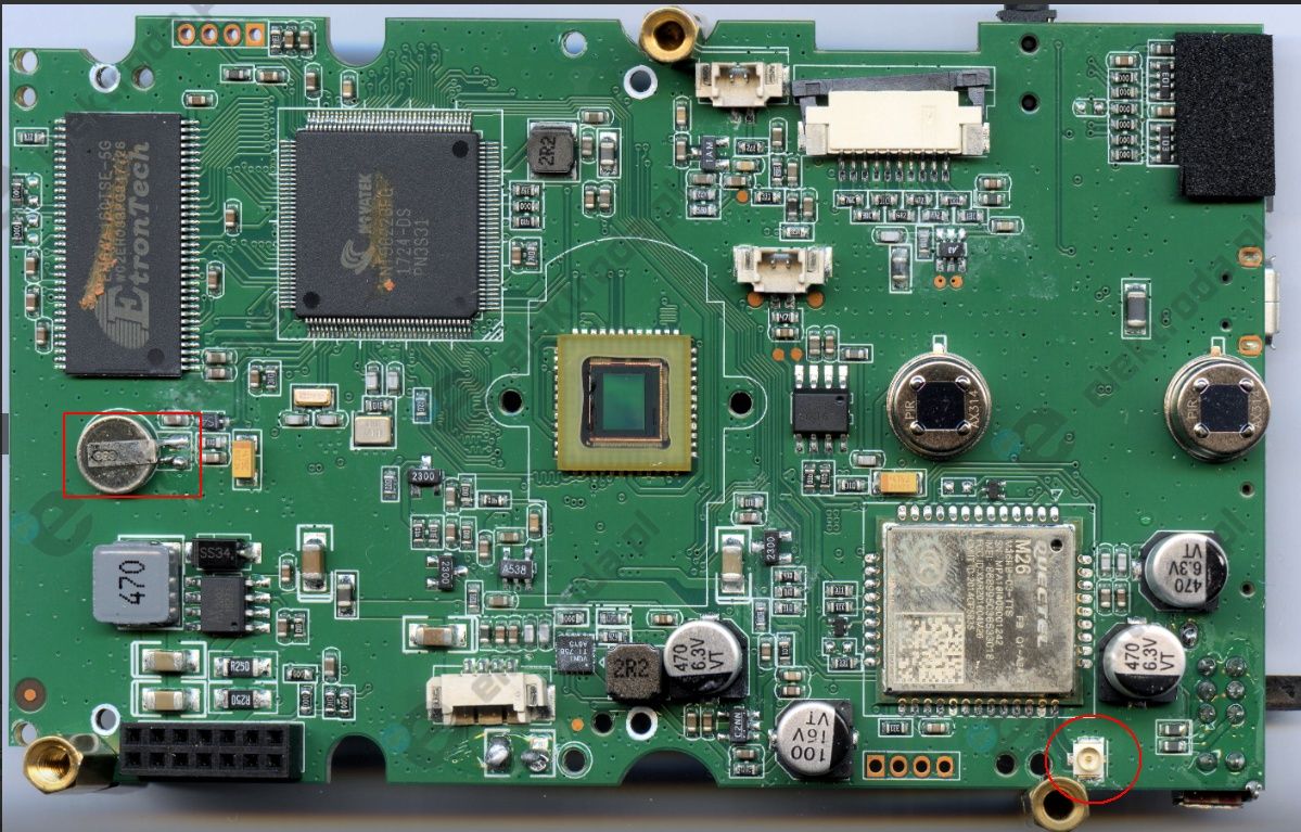

    Do you power it with batteries from the basket or some external power supply? Batteries charged? Send MMS LOG.
    Does it have a screw-in GSM antenna or a built-in one?

    Unscrew it and check from the inside the antenna connection and voltage on the 3V battery

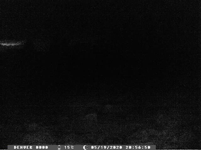

  • #138 18705015
    piotr1krol
    Posts: 19
    My camera takes such photos at night. Will somebody help Denver WCM-8010 Camera Trap: Troubleshooting MMS & Email Issues, Activation Codes & Setup
    • Denver WCM-8010 Camera Trap: Troubleshooting MMS & Email Issues, Activation Codes & Setup PTDC61464(1).jpg (24.38 KB) You must be logged in to download this attachment.
  • #139 18705341
    gradek83
    Posts: 9104
    Help: 929
    Rate: 2093
    Check what software version you have and, if necessary, update from the manufacturer's website.
  • #140 18705628
    piotr1krol
    Posts: 19
    I tried and continued the same
  • #141 18705772
    gradek83
    Posts: 9104
    Help: 929
    Rate: 2093
    Go to a dark place in a basement bathroom with no windows and check if the IR LEDs light up red when taking photos. If not, it is possible that the IR backlight has gone out.
  • #142 18707074
    piotr1krol
    Posts: 19
    I checked the diodes and when taking photos up close you can see that they are slightly red. I have no idea what's going on
  • #143 18707121
    gradek83
    Posts: 9104
    Help: 929
    Rate: 2093
    Set ISO to 400 and check if anything will improve.
  • #144 18707155
    piotr1krol
    Posts: 19
    I have an Iso on 400 and that's how it takes a picture
  • #145 18707179
    gradek83
    Posts: 9104
    Help: 929
    Rate: 2093
    Enter the default settings and perform the test, as it will still be lime write to denver support.
  • #146 18707200
    piotr1krol
    Posts: 19
    Thanks for advice. I think only the service saves her. I talked to Denver's technical support and found that the diodes needed to be replaced
  • #147 18707223
