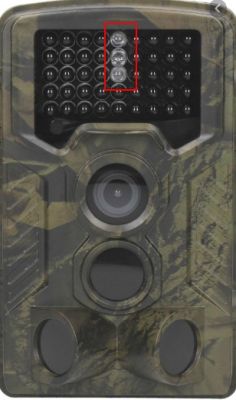

    piotr1krol wrote:
    I plug the camera with my hands and don't click anything
    In this model, you probably have sensors near the IR diodes, cover them.

    piotr1krol
    Posts: 19
    I cover nothing happens. For example, this is how a 300m HC camera does with the same number of LEDs Denver WCM-8010 Camera Trap: Troubleshooting MMS & Email Issues, Activation Codes & Setup
    The camera is in work mode when you cover it?
    Either way if you were uploading the latest software and it didn't work, at most you can look inside and check if something inside is damaged.

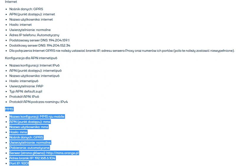

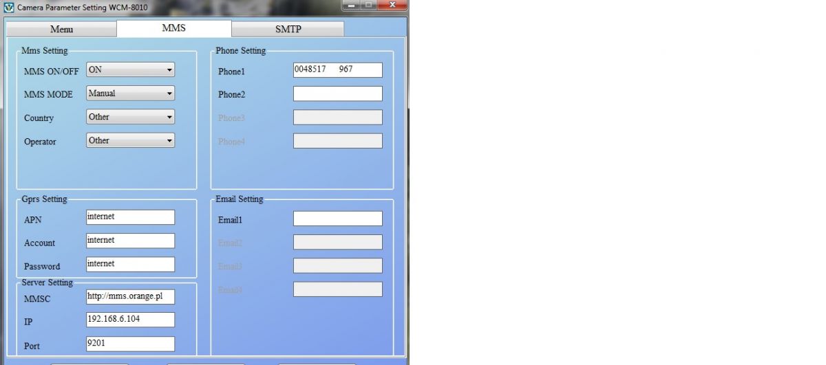

    karolos77
    Posts: 9
    Anyone have GPRS Setting (APN, Account, Password) and Server Setting (MMSC, IP, Port) for Nju mobile? With my settings the APN gets every 10th answer from the code * 530 *, while for the other codes no response from the photo trap. The account is topped up, there is no SIM PIN, mobile number entered from 0048, I downloaded the latest software from Denver, MMS Setting: MMS ON, MMS MODE Manual, Country and Operator Other, Picture No./Day 99. Of course the camera works - does not send pictures only MMS. Thanks in advance for every hint.
  • #162 18806131
    sosarek
    Posts: 83875
    Help: 9318
    Rate: 15495
    Are they on the operator's website, so hard to check it out yourself? https://www.njumobile.pl/obsluga/pomoc-techni...,konfiguracja-internetu-mms-i-sms-w-telefonie
    Z
    Pka, Poznań, 60-850
  • #163 18806248
    karolos77
    Posts: 9
    Of course I did it a long time ago. DOES NOT WORK ON THEM!
    so to those who have this camera trap with a card from Nju mobile, request a screen and their APN settings.

  • #169 18806305
    gradek83
    Posts: 9104
    Help: 929
    Rate: 2093
    Enter the same number

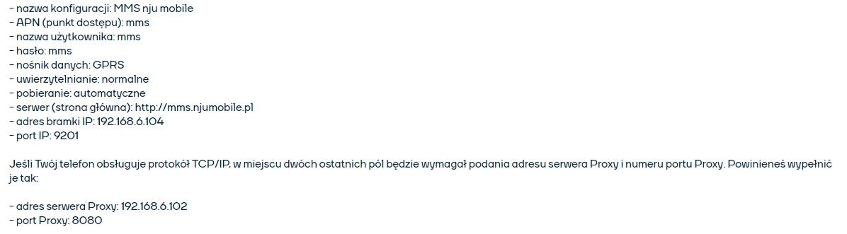

  • #171 18807740
    gradek83
    Posts: 9104
    Help: 929
    Rate: 2093
    Correct the gprs settings and phone number.

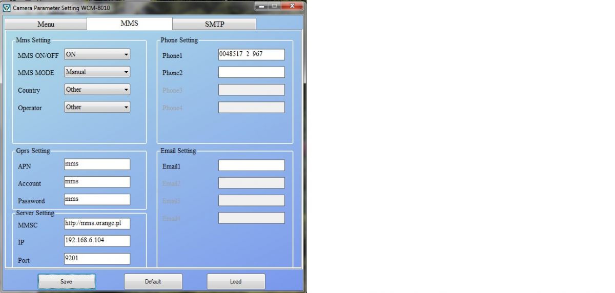

  • #172 18809057
    karolos77
    Posts: 9
    I understand that these settings are to be - it does not work anymore.
  • #173 18809065
    sosarek
    Posts: 83875
    Help: 9318
    Rate: 15495
    What do you have to choose in MMS Mode?
    Set country and operator, number without 0048.

  • #174 18809082
    karolos77
    Posts: 9
    entering the number alone doesn't help either
    Added after 4 [minutes]:
    In MMS MODE I have a choice of manual and car. only with the car I do not have a choice nju mobile. I also checked for cars -> orange, but without any positive results.

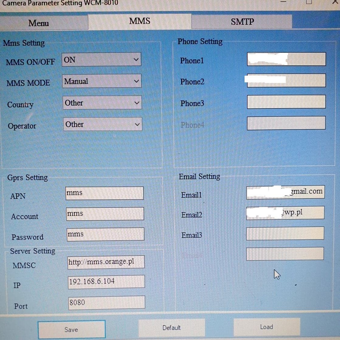

    tymon97
    For me with these settings the camera sends SMSes: Denver WCM-8010 Camera Trap: Troubleshooting MMS & Email Issues, Activation Codes & Setup
  • #180 18810150
    gradek83
    Posts: 9104
    Help: 929
    Rate: 2093
    Alternatively, enter this information.
