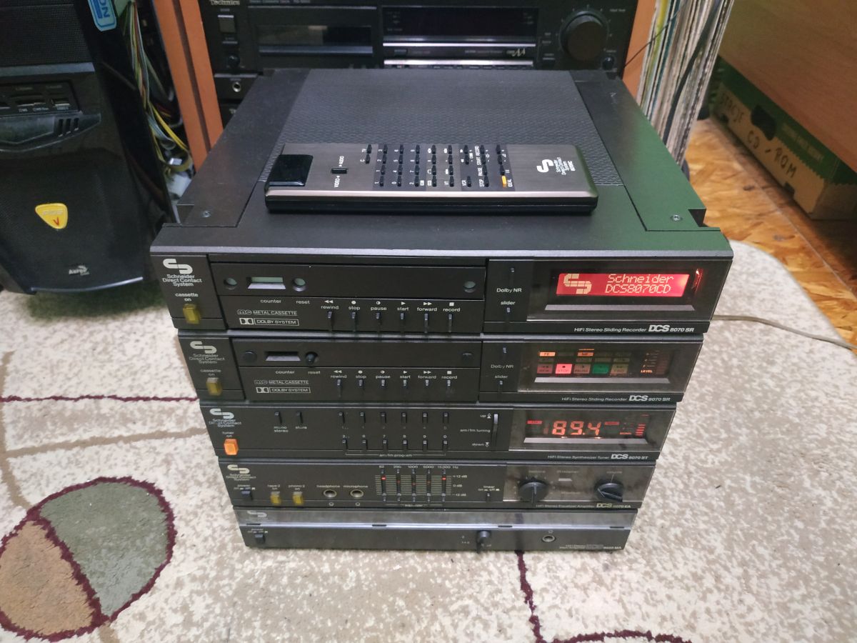

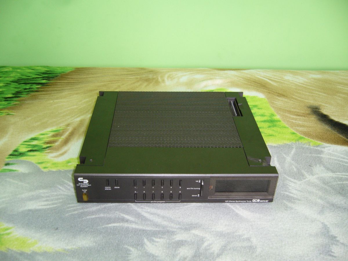

    DJCheester
    Posts: 2049
    Help: 75
    Rate: 949
    Board Language: polish
    robgold wrote:
    I have also made my own ADC keyboard switching threshold configurations via a web page. I don't know if anyone besides me still uses this.
    I will be using 😀
    Also 16 ADC buttons

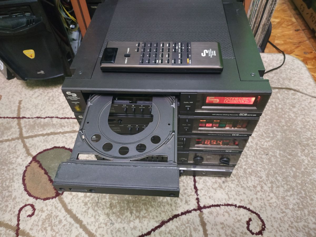

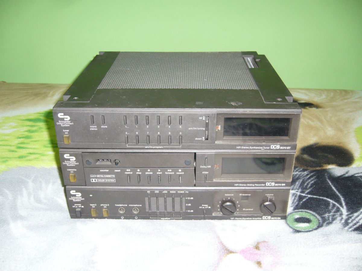

    I'll be redoing Schneider's retro tuner
    Black retro Schneider tuner lying on a carpet, with control panels in the front and a DCS connector on top.
    Overall this is part of a larger retro set from the 1980s
    Stack of retro Schneider audio equipment from the 1980s.
    For this, I reworked the amplifier from another twin model, and refurbished the equipment and retrofitted the CD player in a tape recorder case (drawer)
    The whole looks like this.
    Stack of Schneider DCS audio devices from the 1980s on a carpet, with a remote on the top unit. .
    Retro Schneider audio set with an open CD tray and a remote control on top. .
    The kit is designed in such a way that you can stack the blocks on top of each other (via the DCS connector) connecting everything without cables.
    I am now planning to continue with this, i.e. to make our internet radio in an analogue radio housing.
    The Main PCB will be redesigned.
    The keyboard PCB is in the process of being created.
    PCB with 16 ADC buttons and electronic components. .

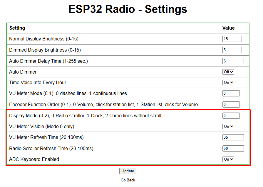

    Welcome,
    I have uploaded updates 3.17.52 Link .
    New options in the main configuration have arrived:
    Display Mode (0-2), 0-Radio scroller, 1-Clock, 2-Three lines without scroll - option in which display mode you want the radio to start up
    VU Meter Visible (Mode 0 only) - whether the VU meter should be visible in DisplayMode 0
    VU Meter Refresh Time (20-100ms) - VU meter refresh time
    Radio Scroller Refresh Time (20-100ms) - time how fast RadioScroller info should be scrolled in DisplayMode 0 mode
    ADC Keyboard Enabled - enables the ADC keyboard. Normally this is disabled unless you have a radio implementation in some tuner
    Screenshot of ESP32 radio settings with display and VU meter configuration options. .

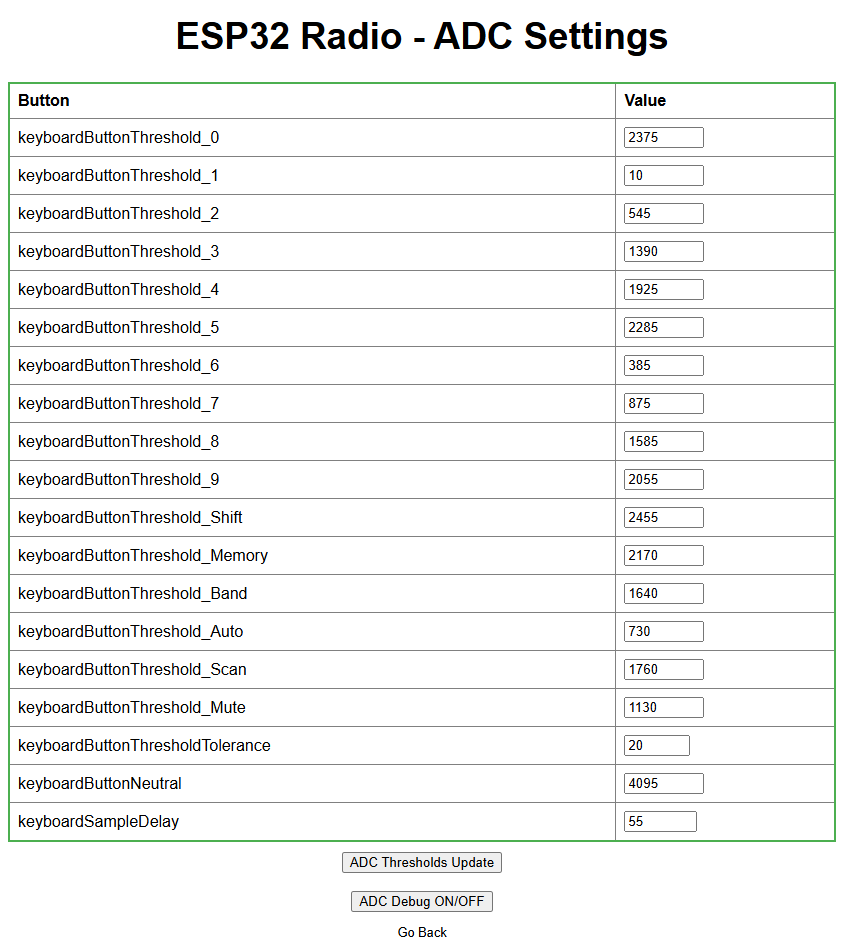

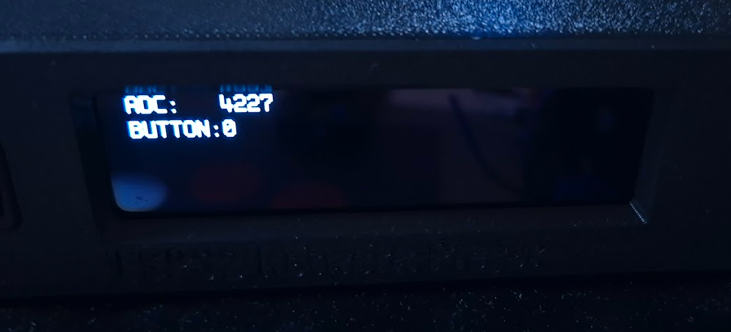

    Additionally, by going to http://NUMER IP RADIA/adc we can configure the switching thresholds for the ADC keypad. By turning the ADC debug ON. We will get the current reading from the ADC on the OLED display. By pressing individual keys on the keyboard, we get the values to be entered into the table. The data will be saved on the SD card.
    This is an experimental function, so there is no super description of it yet. The function works ONLY if the ADC keypad is enabled in the CONFIG menu. The photo of the display shows the maximum reading because I have nothing connected to the ADC input on this radio.
    OLED display showing ADC 4227 and BUTTON 0. .
    ADC threshold settings table for ESP32 Radio with a list of buttons and values. .

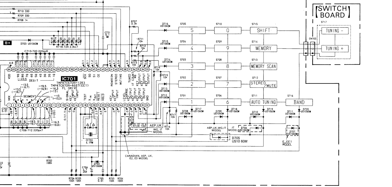

    I have a St-s120 tuner I would like to use the front panel buttons, but don't know how to go about it. I've looked through historical posts, but my lack of knowledge and experience means I don't know how to go about it. What, where and how to connect to be able to read the values on pin 9?

    @gabar5 I'm planning to start a separate project on GitHub and maybe I'll make a separate post here on Elektroda about converting such a Sony to internet radio. The keyboard on these Sony's works in the matrix, you have to unsolder quite a few components from the front panel, replace all the switches (due to their age) and solder a few resistors. I don't have it drawn up like that right now. I'll take a picture and post how it is on mine.
  • #1102 21512437
    gabar5
    Posts: 64
    @robgold That would be great, I can handle the unsoldering, I have 6x6 switches so I'll embrace the replacement.

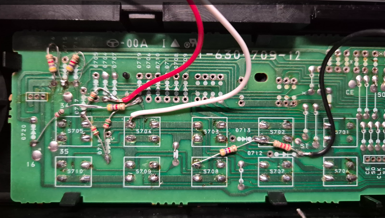

    @simw Just working in this matrix is the advantage here. Throw in a couple of resistors so that each button generates a different value and it works.
    Red wire is 3.3V, black GND, white ADC input. This is on the radio board itself pulled up by 100k to +3.3V
    Close-up of a circuit board with a red, white, and black wire, and several resistors. .

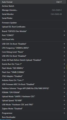

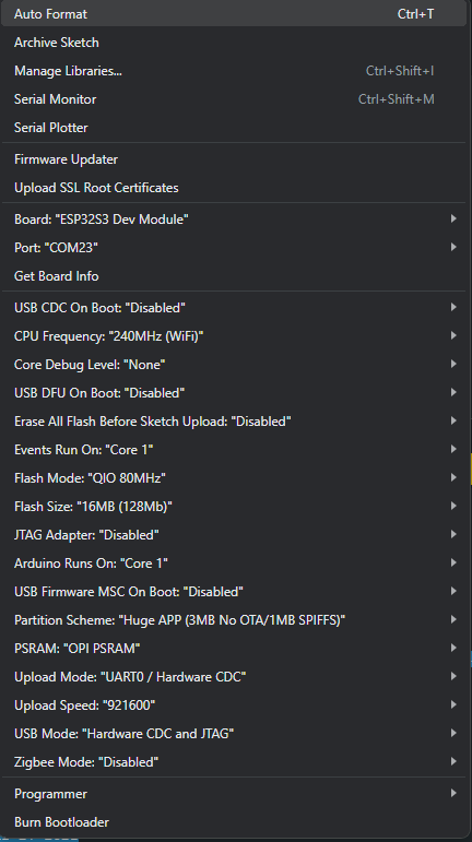

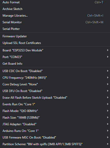

    @simw What settings do you have in Arduino ?
  • #1109 21512490
    simw
    Posts: 754
    Help: 94
    Rate: 285
    robgold wrote:
    @simw What settings do you have in the Arduino ?
    Configuration settings menu for the ESP32S3 Dev Module in the IDE. .
    Added after 11 [minutes]:
    I changed the partition scheme as it is on github and it no longer resets.
    Screenshot of the configuration menu in Arduino IDE. .
