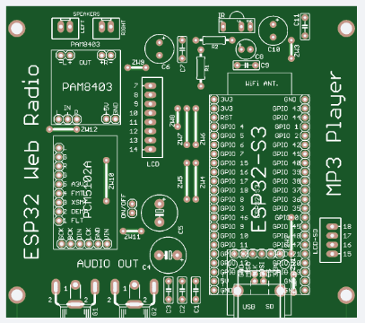

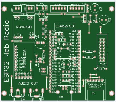

    DJCheester wrote:

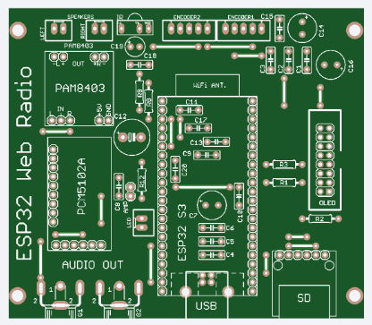

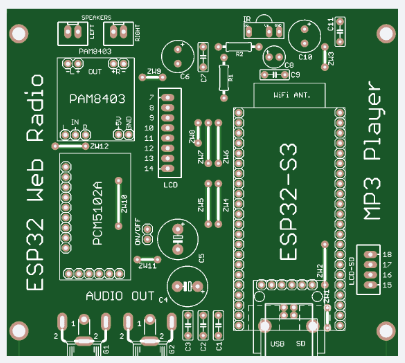

    Welcome, as a small error has crept into the gerber files, I am adding a corrected version.
    The error is in the descriptive layer (the paths are as they were before) so the thermotransfers are fine
    On the already ordered boards there will be a bit of chaos on the description mask.
    I have only now checked this on the JLCPCB website
    The Major and Robgold(2enc) boards will look like this
    ESP32 PCB board with component labeling for audio and microcontroller project Green PCB with white component labels and “ESP32 Web Radio” printed on the left
    After correction yes
    ESP32-S3 PCB with labeled audio and MP3 circuit components Green PCB labeled ESP32 Web Radio with audio and SD card component markings
    This is what happens when you have too many versions of libraries.
    For those who have already ordered, I apologise for misleading you
    The Robgold 1-enc version of the board was done before and correctly so the fix only applies to the other two.
    Corrected heat transfers attached
    Regards ...
    And could you reveal specifically where the error broke in?
  • #2073 21802786
    DJCheester
    You can see on the description layers the pin names electrically are uncorrected.
    This can be seen in the scenes before and after the change.
    Regards...

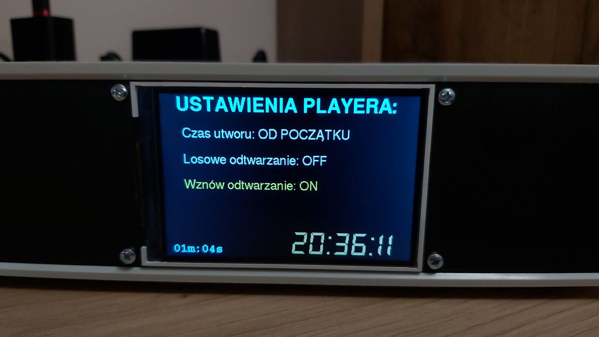

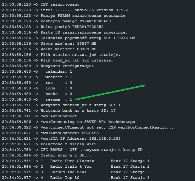

    MAJSTER XXL
    It can't be too quiet, the changes to the audio library are already annoying, when updating the ESP32-audioI2S to the latest version 3.4.4 they figured out that on the serial the audio parameters will be displayed differently again, which makes it necessary to make changes to my v3 version again, for now I'm going back to 3.4.2, because as it was jerking flac-and it's still jerking (we're only talking about the radio, audio files go normally).
    Today, a small update from me, I added another setting in the player menu, which allows you to enable or disable the option of resuming playback from the last played audio file. The file and folder index are saved every song change to the file card, and if the resume function is enabled, the player will go back to the last played file after a restart, but to the beginning of the file and not the moment of interruption during - maybe one day I'll do something about that too. For now, as usual, to test.
    You can find the changes on my github with v3.
    And this is how it looks like:
    Player display with playback settings menu showing playback options and current time
    ESP32 log output with active resume setting for the audio player

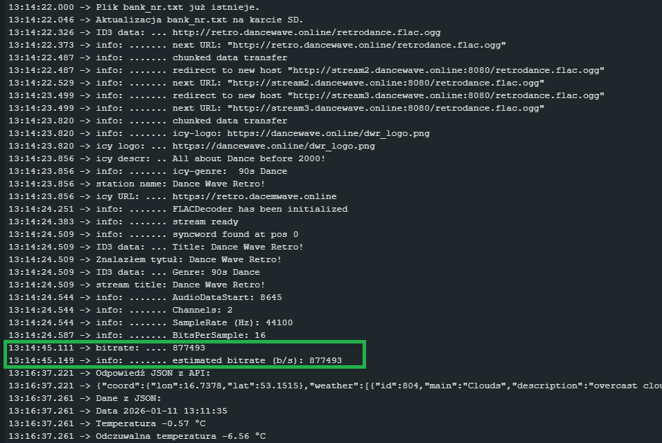

  • #2093 21805377
    MAJSTER XXL

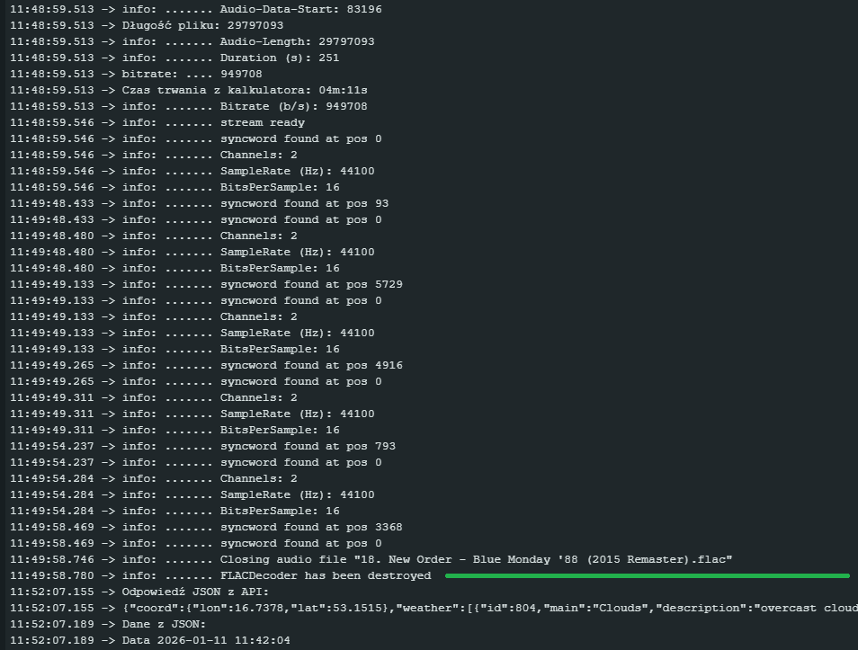

    @hevet at my place I extract the audio parameters from the data dumped to the serial terminal by void my_audio_info(Audio::msg_t m) , the author of the audio library changed himself the phrases that return the bitrate (in version 3.4.4 there is Bitrate (b/s): and SampleRate (Hz): ), i.e. the bracketed additions have appeared.
    I'm trying to adjust this, but listening to flac files from the card has already made my decoder cringe a couple of times, so I'm letting it go and going back to 3.4.2.
    On the plus side, the bitrate of the flac files has finally started to appear 6-7 digit instead of 3 digit on the same files I was comparing.
    Below is a screen shot of the decoder crash:

    robgold
    @MAJSTER XXL These changes to the library are some time ago. Now I see that they have only updated the versions correctly from 3.4.2 to 3.4.4 which is basically what I have been doing manually until now. Evo has already been running on these libraries for a while - it's stable. The change was annoying because the whole audio info block had to be rebuilt (also don't understand why or what Wolle did it for) but wanting to keep the library updated sooner or later has to be done.
    Version 3.4.4 supports 24 bit FLAC streams, in 3.4.2 you are limited to 16 bit. Download yourself from Evo my_audio_info because I think I left the structure the same, so there's a good chance that 1:1 will work for you.
    As for FLAC, the problem is not the library but WiFi and ESP. If you do a library swap from TCP or recompile your TCP libraries in ESP-IDF then FLAC streams will work.
  • #2095 21805450
    MAJSTER XXL
    OK @robgold , I rebuilt this v3 of mine to already handle this data correctly with audio file parameters from version 3.4.4 of this audio library, I also noticed that for a flac station the parameter info: ....... estimated bitrate (b/s): . I've also made a handle under this that when I change to a station that broadcasts flac, the bitrate doesn't show up on my screen until the time-averaged one comes in. I'll try swapping those indicated files again later, but previously I've had it take a very long time to establish a connection after restarting the radio - have you had this problem? @DJCheester can confirm this, it was hanging on the station connection prompt.
    Console log showing FLAC stream info and estimated bitrate of 877493 b/s

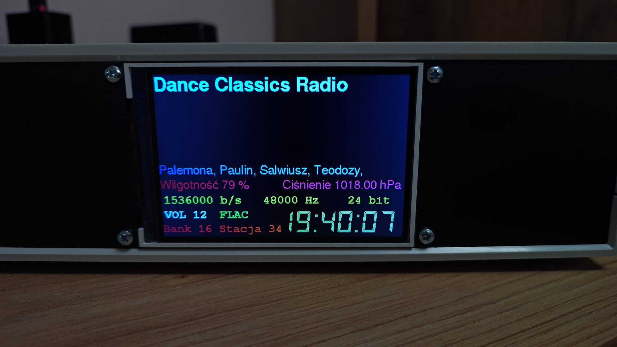

    MAJSTER XXL
    It's nice that the new libka even embraces 24bits, but I still haven't found a solution as to why after swapping the libesp_netif.a and liblwip.a files, the first connection to the station link after a power restart is several tens of seconds in my v3 - it then doesn't accept any commands, just waits....
    Color display of a device showing internet radio info and environmental data.
