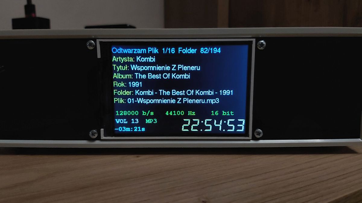

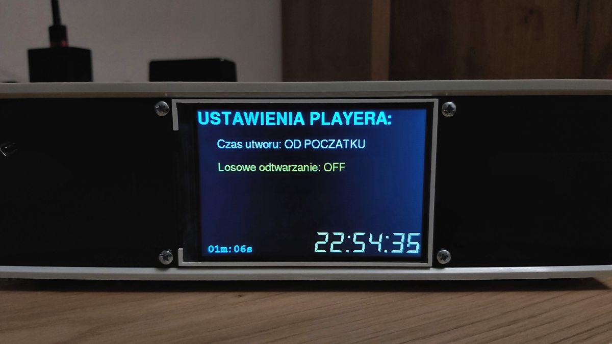

    MAJSTER XXL wrote:
    I made a second menu, this time for the audio file player. In the settings, there are options to toggle the display of the song time from the beginning or from the end (I'm currently practising on MP3 files) and to enable/disable random playback of files from the current folder. I calculate the duration of an MP3 track with a fixed bitrate based on its size in bytes and its bitrate, which is the number of bits played per second. I first convert the file size from bytes to bits (multiplying by 8) and then divide this value by the bitrate in bits per second. The result of this operation gives the total duration of the song in seconds. The time counting code still needs to be refined, as some mp3s count incorrectly, I will collect the time for flac files using a different method, as the audio library returns the number of seconds for the loaded file.
    Below are screenshots of this menu in action, the code is available at a known location.

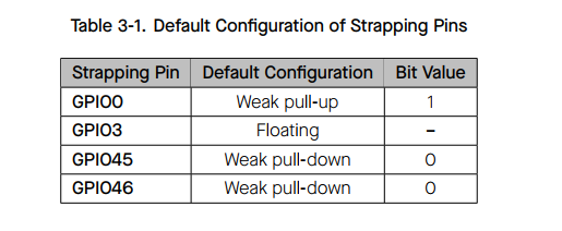

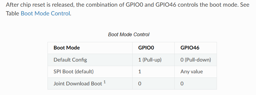

    >>21794053 Connect the GPIO0 pin via a 10K resistor to 3.3V and it will always boot up
  • GPIO0 pull-up to 3.3 V suggested for startup issue

    It's the ESP module's fault I have one too, after a long time after plugging in the power it goes dead, after pressing the reset button it gets up normally. I have tried replacing it and changing the capacitor at the reset button, but to no avail. Such modules do happen.
    Best regards...
    Added after 7 [minutes]:
    Lechuuu wrote:
    >>21794053 Connect the GPIO0 pin via a 10K resistor to 3.3V and it will always start
    Unfortunately this didn't help with me but what's the harm in trying.
    Regards...
  • #2018 21794083
    Lechuuu
    Posts: 104
    Rate: 25
    DJCheester wrote:
    Unfortunately it didn't help with me but what's the harm in trying.
    Helps 100%, a topic rolled out dozens of times on the yoradio group on fb. It's just that ESP32-S3s have it so that after disconnecting the voltage and switching it on again they sometimes enter the programming mode. No capacitors help here, but what I wrote is checked and works

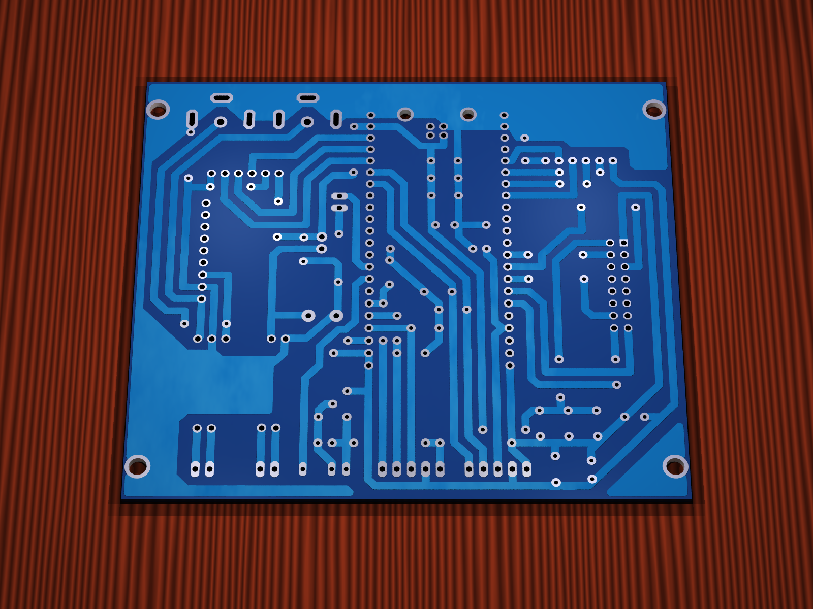

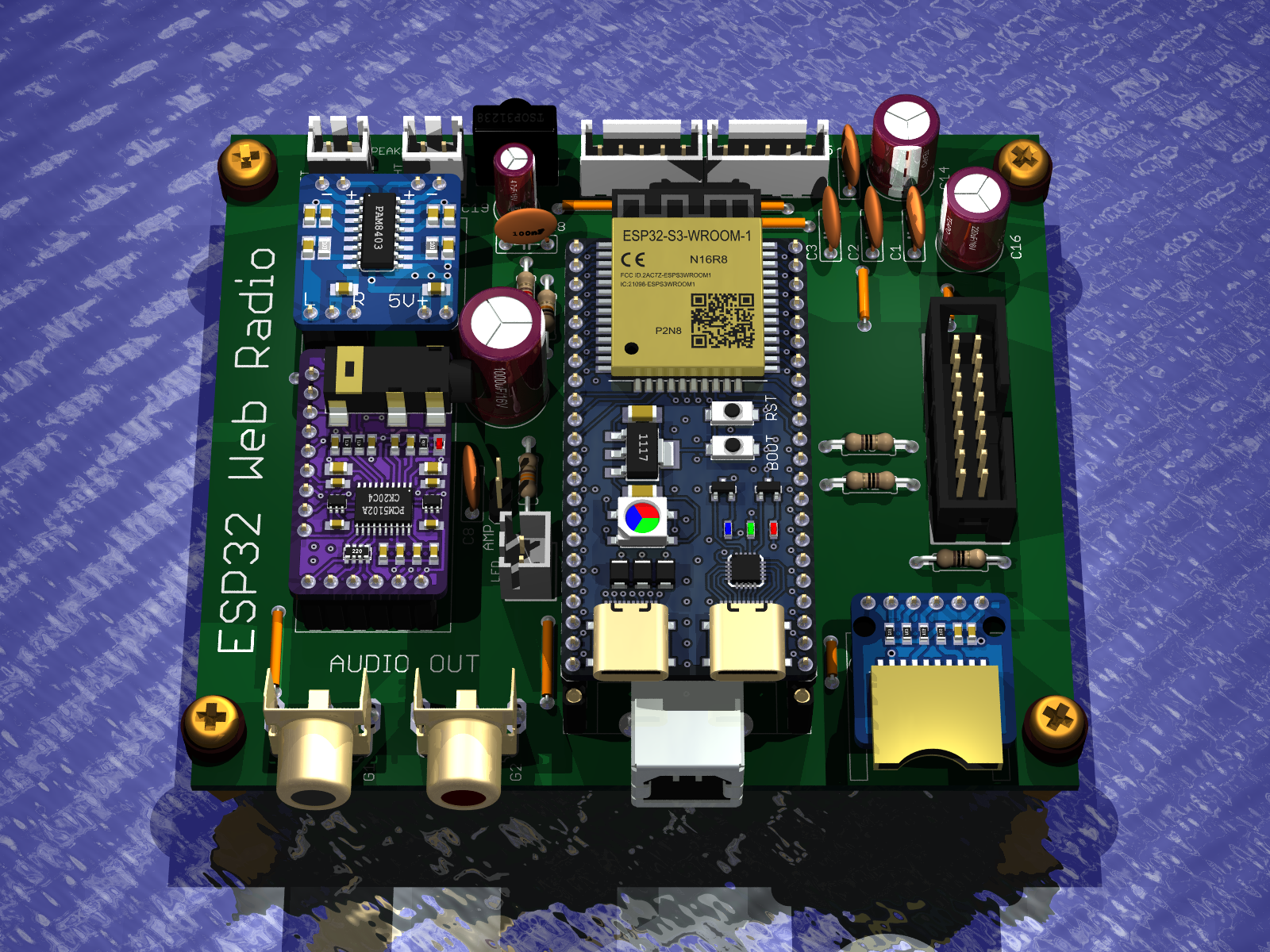

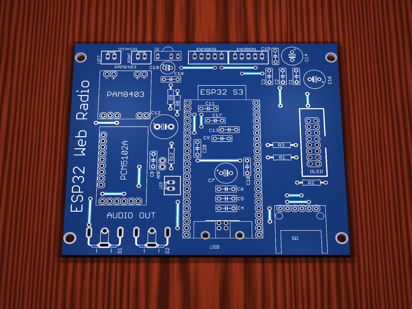

    #2025 21794951
    DJCheester
    Level 28  
    Posts: 2089
    Help: 75
    Rate: 958
    Welcome ;)
    Still in the old year, I wish everyone all the best for this New Year 2026 ;) May this New Year be better than the one currently ending.
    And now the board promised to some under the version of my colleague Robgold with two encoders.
    The board is only on through-hole components and ready-made modules.
    In addition, I used a PAM8403 amplifier module on the PCB so that small speakers can be connected to the board to make, for example, a kitchen radio.
    This is how the designed PCB looks like (it is very similar to the previous one with an input for one encoder - the dimensions and mounting holes have been retained)
    Blue ESP32 Web Radio PCB with labeled pads for modules, connectors, and components
    Blue PCB with signal traces and mounting holes, viewed from solder side
    And this is the model of the assembled radio on this board.
    For this version it is possible to upload software of friend Robgold currently 3.19.53
    Additionally added output for diode on JST connector

  • Four PCB variants and jumper notes for ESP32-S3 radio player
    #2029 21795880
    DJCheester
    Level 28  
    Posts: 2089
    Help: 75
    Rate: 958
    Hello, please find brd files (Eagle CAD) and html partlist files (BOM files) and PDF files for thermal transfer attached.
    The attachment contains four versions of the boards, i.e. under Robgold and Majster software
    1. PCB for Robgold software v3 evo (up to the latest software version 3.19.53 with one encoder)
    2. Board under Robgold software v3 evo (up to the latest software version 3.19.53 with two encoders)
    3. PCB under Majstra v3 Color LCD software - works with the latest version made available by the author
    4. Experimental board under a different ESP module (specifically ESP32 S3 Uno) - running overlay on ESP module
    All projects except the last one include a PAM8403 amplifier.
    When creating single-sided PCBs by thermal transfer, you need to remember to use the jumpers marked on the PCB.
    When ordering from china boards, the jumpers are made on the top layer of the PCB so you do not need to install them.
    Regards

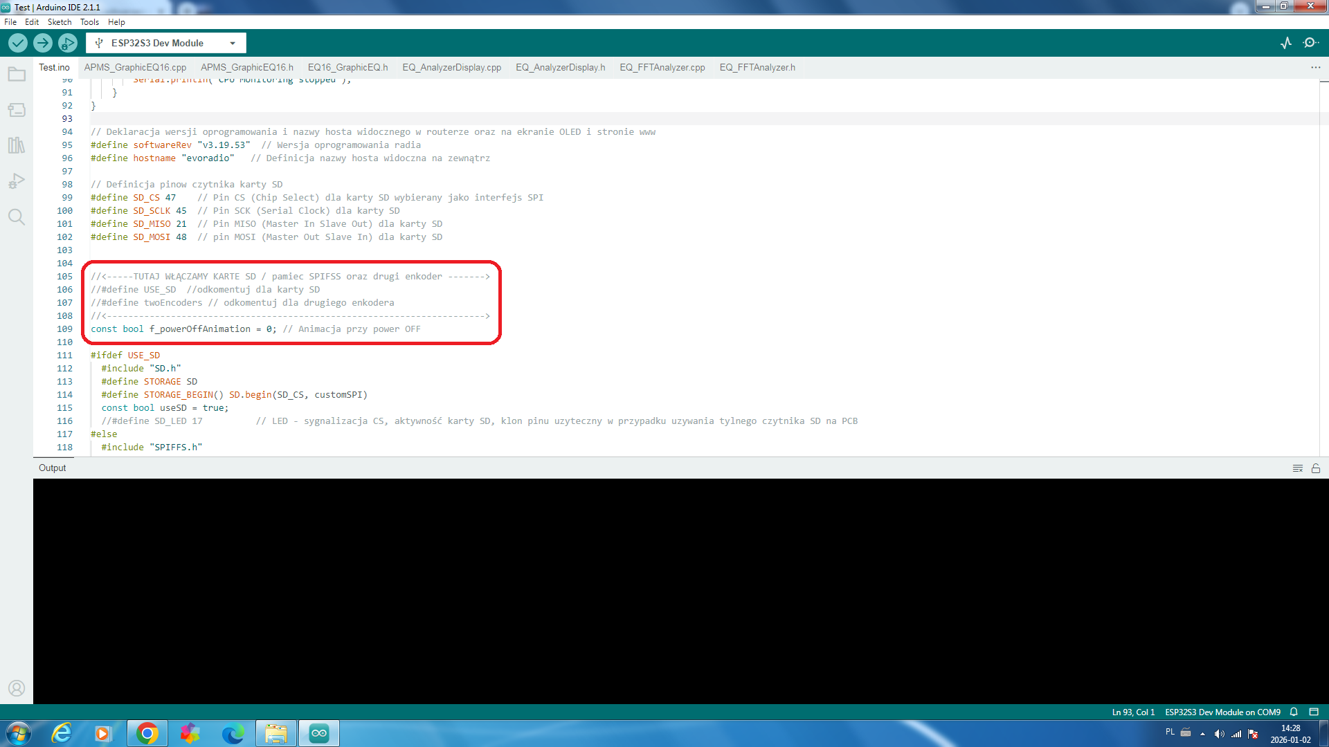

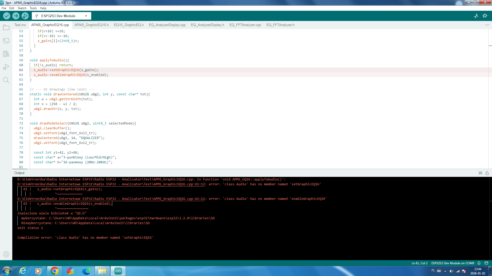

  • Missing Audio library methods setGraphicEQ16 and enableGraphicEQ16
    #2030 21796417
    DJCheester
    Level 28  
    Posts: 2089
    Help: 75
    Rate: 958
    ejcon wrote:
    Small soft modification Added new style10 flying peak.
    Runs from setting as instant style Edit style in analyzer menu
    Hello I have a compilation error with this version of the software
    What could be wrong ?
    Greetings ...
  • Platformio upgrade fixes ESP32-S3 build issue
    #2031 21796454
    ejcon
    Posts: 301
    Rate: 68
    I don't use Ardulino but VC and Platformio and after the upgrade I'm fine

    Well, that's a bummer ;(
    Can you share the binary with the SPIFFS memory option?
    Screenshot of Arduino IDE highlighting code related to SD card and SPIFFS.
    I will upload at the ready ;)

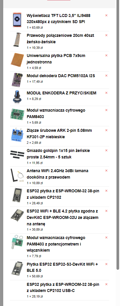

  • Request for ESP32 board and display recommendations
    #2037 21797866
    saper135
    Posts: 20
    Hello everyone. As I'm a layman, but I like to play, and after reading I see it's fun and even inexpensive, I have a big request. If someone who knows a bit about this, and I see you are quite good at it, could help me with the hardware for this game. I know that you need an ESP32, but the choice on the Polish market is large, and on the Chinese market infinite. I'd like to buy a good one, reasonably up-to-date and, most importantly, one for which there is freely available software and expert help, and it's not about the PLN30 cheaper.
    ESP32, from what I can see, there are with built-in antennas and with external antennas, newer ones on USB-C, WROOM-32U, WROOM-32, WROOM-32 38-pin with CP2102 USB-C chip, WROOM-32 30-pin with CP2102 USB-C chip. There's a whole bunch of these and I'm completely lost. Maybe also some larger LCD display, as I'm old and have poor eyesight.
    List of electronic components with ESP32 boards, LCD display, and accessories
    Shopping list with electronic components for ESP32-based project
  • #2038 21797902
    hevet
    Posts: 347
    Rate: 47
    You need an ESP32S3, not an ESP32.
  • #2039 21797921
    saper135
    Posts: 20
    So I take it you mean exactly this model ESP32 ESP32-S3-DevKit WiFi + BLE 5.0 board
