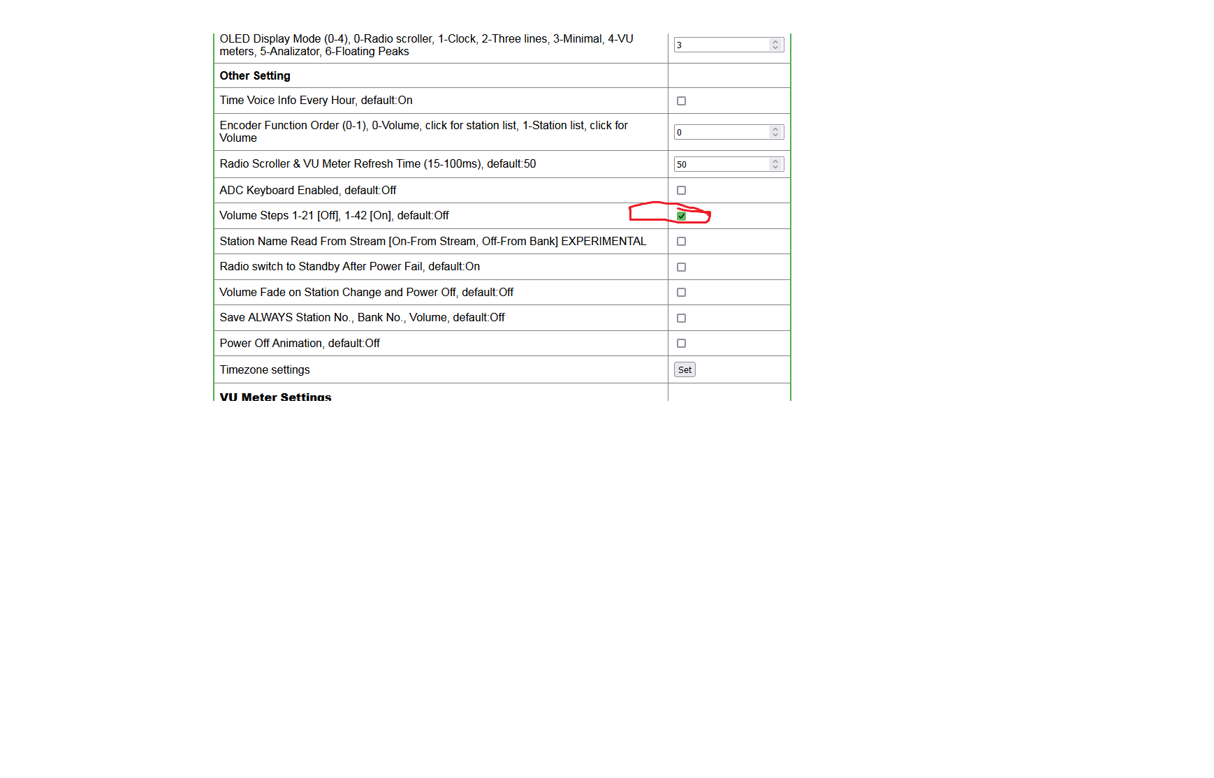

    >>21853751 And have you tried changing the volume range in the settings ? There is a special option when the radio is working with an amplifier to extend the control range from 0-42 instead of 0-21.

    Czech, yes I tried ... but with this change I have a very strong sound ..., bruczanje v gloszniki v stopnu 1-6.... potem jusz z vjeksou glosznosczou to brzecenje /probably from przetvornici vyswjetlacza / is not hearable. Also the buzzer is very audible at "mute", or at "OFF" of the radio where the clock is showing ... where the switch is connected to this section on 5 V constant.
    Settings table with the “Volume Steps 1-21 [Off]” checkbox checked and circled in red
    ustavjenje v stopni 1-21/offf/ for mne is take better....

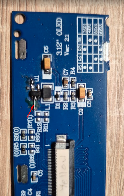

    As for the board itself, interference only occurs when the radio connects to wifi then in my case the OLED inverter is slightly audible when it is mute (because the PAM amplifier is powered all the time) with normal radio operation there is no audible hum or interference.
    To improve this situation you could try giving a 100uh choke in series and a capacitor on the power supply of the OLED itself.

    The interference occurs depending on how many and how brightly lit pixels you have on the OLED display. In the display, the inverter manages to generate 14V with great difficulty, and to make things funnier it does so with 3.3V and not 5V.
    A solution commonly used in audio equipment is to simply isolate the power supply already at the power supply stage and generate these approximately 15-18V for the OLED in the power supply itself. Therefore, it is ideal to have a 24V switching power supply and then to reduce this voltage linearly to 15-18V for the OLED, and with small converters to 5V and 3.3V. If you have the space for large heatsinks, you can also do all this with linear regulators, but losses, especially at 3.3V, will be very high.
    Here it doesn't matter whether you have a class A, AB or D amplifier. Class D is very good here, it is just a matter of correct routing of the power supply and possibly cutting off the amplifier in power OFF mode. Unfortunately, everyone has their own application for this radio, some have an amplifier, others have a line-out, others have added a digital output. Everyone has to adapt the design individually. If there is enough GPIO, I will add one #MUTE output for amplifiers.

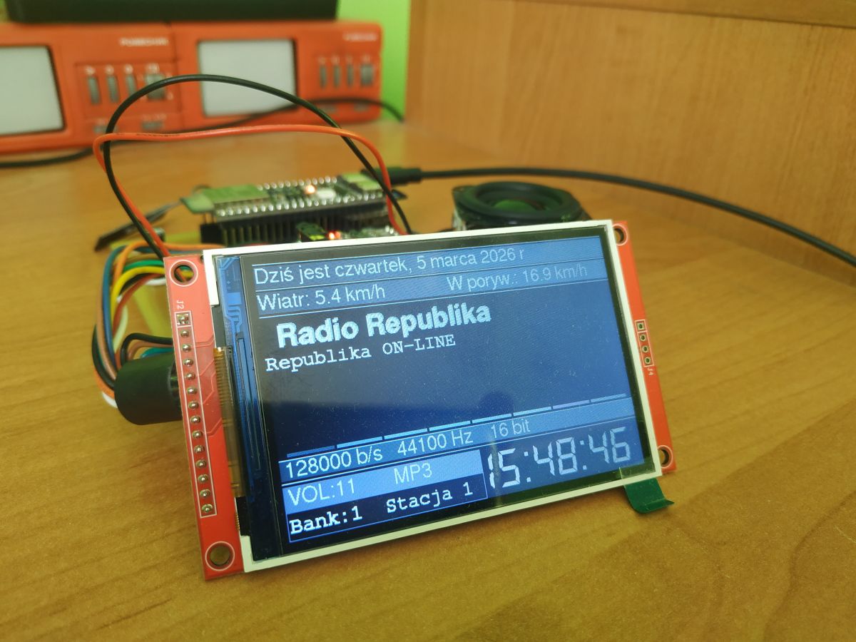

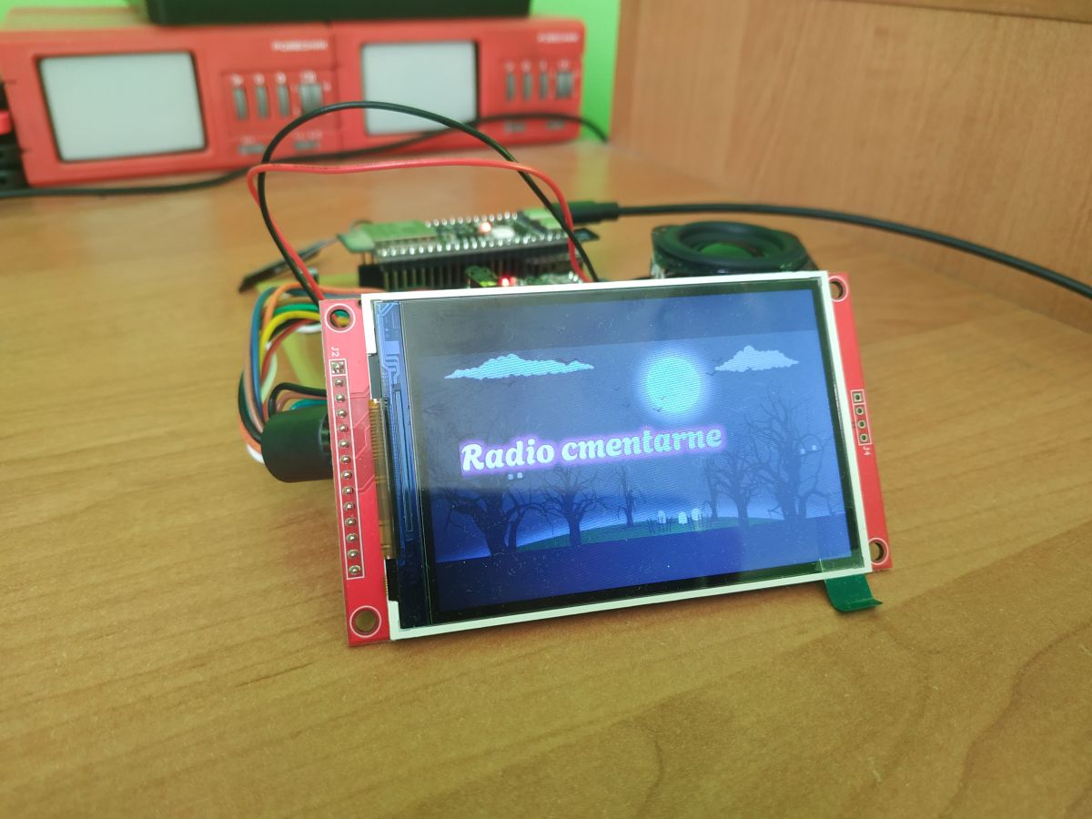

    I wanted to run and test the Kuli350 soft today as long as the compilation went through without a problem and the upload too, but unfortunately the remote control cannot be defined in a simple way - it's a pity that there are no buttons defined in one place just the codes are hard-pressed throughout the sketch.
    Code: Arduino
    This is such a downside to the software, as I am currently ill so I don't have the head to look it up and figure it out right now.
    In addition, the soft probably for the LCD IPS version because I now have a TN and here the colours are missing
    LCD module showing “Radio Republika” interface, wired to electronics on a desk
    And the logo as for me black humour but this is my opinion.
    Desk prototype: LCD module showing “Radio cmentarne” connected by wires to an electronics board
    Greetings ...

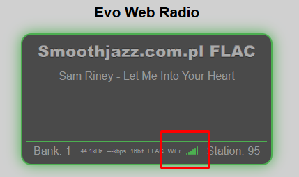

    WIFI - WEB INDICATOR
    I have added a WiFi signal indicator to the website screen (also visible in the Android app on the phone).
    It comes in handy if you can't see the radio display. Besides, from a distance of 3-4m it's hard to see anything so small on the OLED.
    Screenshot of “Evo Web Radio” showing Smoothjazz.com.pl and a Wi‑Fi signal indicator

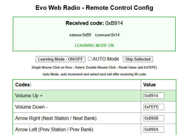

    PILOT IR
    There is a new option in the menu (Menu -> Settings -> IR remote control settings) that allows any remote control to be trained in the NEC standard.
    How does this work? We click on "Learning Mode On" and the first cell marked "Volume Up" lights up, we press the button on the remote control which is to be responsible for this function and after a while we see its code in the Value cell.
    If we activate the "AUTO Mode", after picking up the correct code, the script goes to the next button by itself.
    If you double-click a cell, the so-called out-of-range value (0xFEFE) is entered, meaning that no button will be assigned to the function.
    Screenshot of Evo Web Radio IR remote config with learning mode and a table of button codes

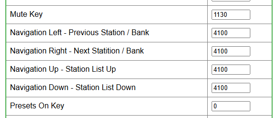

    ADC KEYBOARD
    I have extended the functionality of the keyboard with the possibility to train "arrows", i.e. we can call up a list of stations, jump by 10
    and switch to the next station. Exactly the same as what is on the IR remote control. In addition, I have changed to more "human" names of the buttons in the ADC tab
    IR remote settings table listing functions and numeric codes, including Mute and navigation keys.

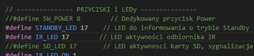

    LED Standby
    The standby LED has an additional function. As in equipment from e.g: Marantz, Denon it flashes during start-up, when the radio has already opened the preset bank and starts playing stream the LED goes out. If for some reason we do not have a WiFi connection, the LED will start flashing quickly to inform us of the problem. Apart from this, the standard function of the standby LED is that it lights up when the radio enters power OFF mode.

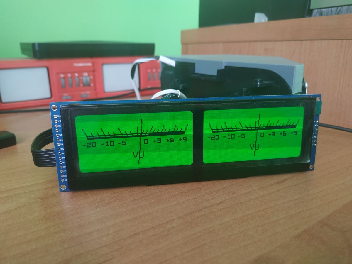

    NEW VU METER SCREENS - MODE 4 and 5
    These screens have new analogue VU indicators and a digital VU indicator (two wide lines)
    Two black-and-white analog VU meters with a scale from −20 to +9 dB and needles near center

    The interference occurs depending on how many and how brightly lit pixels you have on the OLED display. In the display the inverter manages to generate 14V with great difficulty and to make it more fun it does so with 3.3V and not 5V.
    That's right when I test ran the radio on my PCBs with the tape from the display removed and the radio only gives audible noise on the PAM8403 amplifier when the radio is already playing and there is no noise in the speakers when MUTE is selected.
    Added after 1 [minute]:
    robgold wrote:
    It doesn't matter whether you have a class A, AB or D amplifier. Class D is very good here it is simply a matter of getting the power supply right
    The tracks and ground routing on my PCB's does not cause interference or hum, if there is any I suggest you have a look at the power supply to the radio or the chassis if it is a metal chassis.

    >>21855219 If you unplugged the tape from the display (I assume you unplugged the PCB side not the OLED side - so as not to create an antenna from the SPI bus) then there should be silence at all. If you can hear something then it means that you still have the SPI bus "sowing" somewhere on the PCB.

  • Ground resistors silence OLED inverter buzzing
    #2419 21855247
    robgold
    Posts: 726
    Help: 10
    Rate: 290
    >>21855227 Resistor 1-2.2Ohm into the ground of the OLED inverters, additionally with 10 Ohm into the ground of the DAC and with such a "prosthesis" there is complete silence. Of course, this will gently lower the voltage on the inverter, but it solves the problem 100% at my place almost every Evo has such a modification because for me this "buzzing" of the inverter is unacceptable. The next PCB will have a better power supply made for this OLED.
  • #2420 21855326
    DJCheester
    Level 28  
    Posts: 2089
    Help: 75
    Rate: 958
    I will take these additional components into consideration as I modify the PCB thanks.
    Regards...
    Added after 7 [minutes]:
    Question is the resistor to ground the OLED of the whole display i.e. pin 2 unzip and insert resistor ? Did you cut a path on the OLED somewhere near the inverter ?
  • #2421 21855332
    robgold
    Posts: 726
    Help: 10
    Rate: 290
    >>21855326 This needs to be done on the OLED PCB, at the inverter itself cut the path.

    Can you upload some photos ?

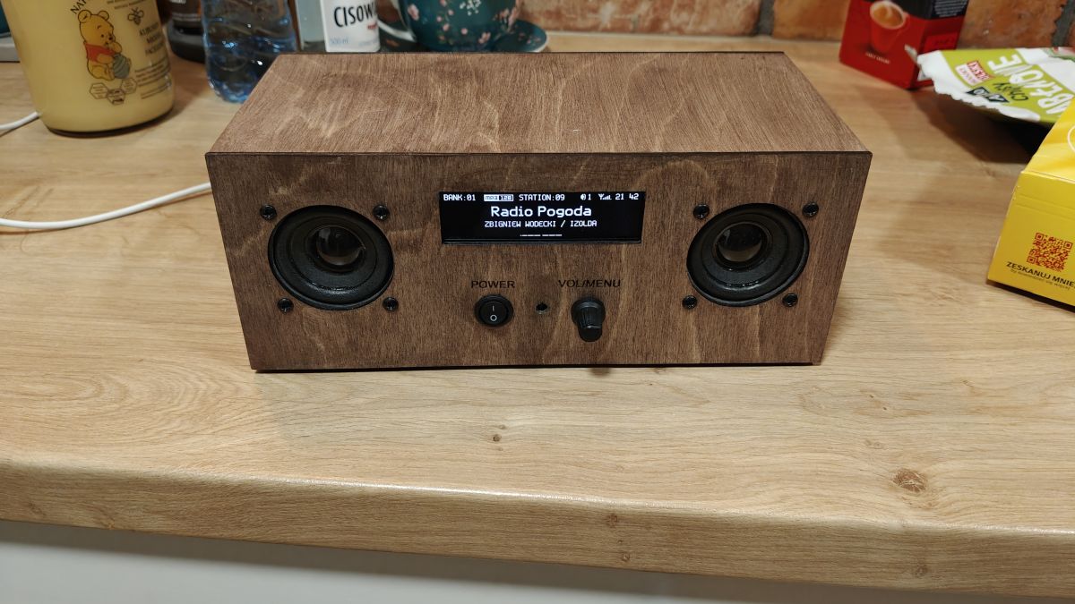

  • #2424 21855425
    dawidkosciesza
    Posts: 54
    Rate: 14
    >>21855332
    @robgold if you have any photo of where you soldered this resistor on the display it would be a super help to others ;)
    I'll take this opportunity to show off another small project :D
    Wooden radio with two speakers and a display showing “Radio Pogoda” on a kitchen countertop

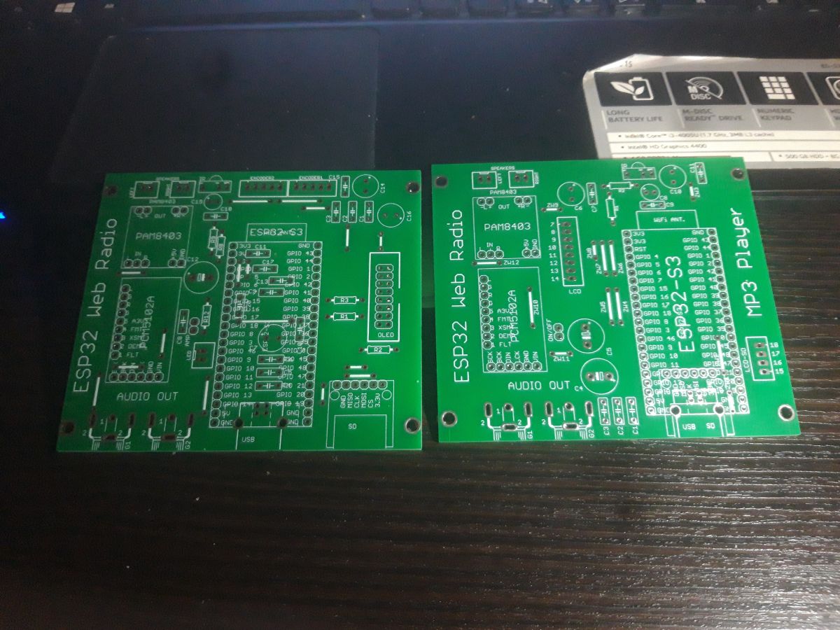

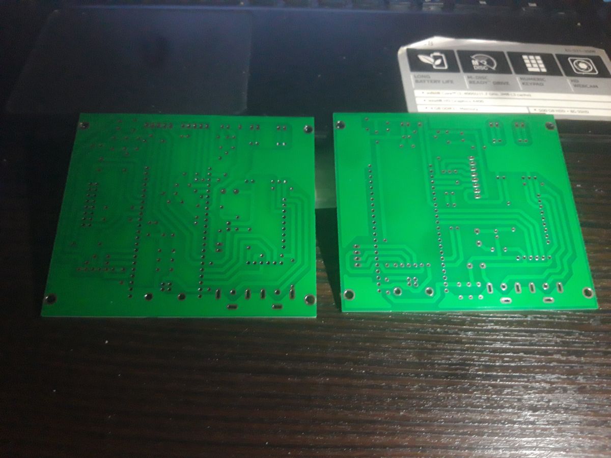

    supsak
    Posts: 81
    Hi Robgoldze, this is a plate I recognise ... it is a product of "DJChester", I do not think it is badly designed
    Two green ESP32 Web Radio PCBs with labeled connectors and component footprints on a desk
    Two green PCB boards shown from the back with traces and solder points, lying on a dark desk.
    For me and I think for other professionals it would be very useful if you would program one GPIO...to control an amplifier, or any relay..., which would control the power supply of a PAM..., or other circuit. And in case of MUTE or STASBY it would switch off the power supply..

    supsak wrote:
    Hi Robgoldze, o to plytky jake uzivam ., it is a product of "DJChester",,nemysl that it is badly designed
    Write it maybe in English because in "Polish" it sounds that it is not unambiguous.
  • Power button pin mapping changed in 3.19.70
    #2427 21855663
    pipikupi1979
    Posts: 15
    Hello hope your health is ok now. Thanks a lot for the update. The smooth jazz is laughing in FLAC really smooth. The buttons for the ADC keyboard do the job because unfortunately my Technics is quite light and pressing the encoder was moving the gear hehe and now that there are arrows it takes care of it. I'll be honest I haven't had time to go through the code but I noticed that the functionality of the power button which worked with 3.19.70 has escaped me, has anything changed in the pins ? I also noticed a positive change because in version 3.19.70 as the link nibmial streams the radio restarted o and now it just waits for your decision which seems to me a better solution. I noticed an interesting thing that some streams in FLAC return the speed immediately after linking and some only display the speed after some time. This is not a problem I'm just asking out of curiosity. Thanks again for your work the code is great. Best regards
  • Power switch disabled in BIN; use 10 ohm DAC ground resistor
    #2429 21855930
    robgold
    Posts: 726
    Help: 10
    Rate: 290
    >>21855663 The Power SW function is still there only in the finished BIN is disabled. Probably because this GPIO is shared with the i2c bus I used for the TAS amplifier and probably disabled. Switch on and recompile the soft.
    Code snippet with #define lines for buttons and LEDs, with SW_POWER commented out.
    As a quick note, I found this photo of the board I use for rework and measurements. The resistor is mounted in place of this wire jumper. I recommend to start with a 10 Ohm resistor in the DAC power supply ground circuit only in the second place messing with the OLED. Especially that here you need to be careful, because you can beat the 2.7V stabiliser (there are three power sources on the PCB: 2.7V, 3.3V and 14V)
    Close-up of a blue PCB with SMD parts and a red arrow pointing to a wire jumper.
    @DJCheester the effect of these VUs is even better if you raise the voltage on this large OLED from these 14V to 16-18V. He shines very poorly with this inverter on the PCB. The only thing it has thanks to this is a very long life because as they count in the documentation 100 000h to the loss of 50% of brightness when not exceeding 15V.
  • Raising OLED voltage improves VU brightness
    #2430 21855933
    DJCheester
    Level 28  
    Posts: 2089
    Help: 75
    Rate: 958
    robgold wrote:
    The effect of these VUs is even better when you raise the voltage on this large OLED from these 14V to 16-18V. He shines very poorly with this inverter on the PCB. The only thing it has thanks to this is a very long life, because as they count in the documentation 100 000h to the loss of 50% of brightness when not exceeding 15V.
    I don't mind, it is supposed to shine gently s not like an incandescent bulb, it is a photo in a bright room the sunlight outside the window, at night it will be just enough.
    And from a distance you can't see the pixels so the effect is cool.
    Greetings...
