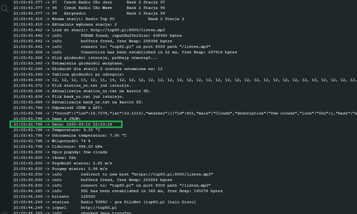

    With this time shifted forward by an hour, it was also like this last year as I remember correctly. It seems that the server has already set itself to daylight saving time and now you have to wait until the actual change or change the offset by hand.
    According to the query:
    Code: C / C++
    a one is returned, i.e. that CEST daylight saving time is in effect.
    Code: C / C++
    But this is kind of silly. The JSON data for my city from the weatherman also shows an hour ahead:
    Screenshot showing JSON results with date and time. .

    It appears as if the DST flag is set according to the US system. To be precise, from 10.03.2025, DST time applies in the US. The NTP server itself should keep UTC time.
    No surprise there. We do not set the timezone anywhere. A shift of 1h with respect to US time will produce exactly the error we have. You need to add a time zone and set it. I'll check, add and upload the fix to GitHub.
    Replacing the configTime line with the following solves the issue.
    Code: C / C++
    Daylight saving time starts:
    M3 - third month of the year - March
    5 - last ...
    0 - Sunday of the month
    /2 at 2 a.m.
    Daylight saving time ends:
    M10 - in October
    5 - last ...
    /3 at 3 a.m.

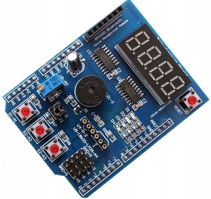

    rysin wrote:
    @DJCheester Here you have the display for it. You don't need to combine anything.
    Multifunctional board with display for Arduino with buttons and module. .
    https://allegrolokalnie.pl/oferta/wielofunkcy...ietlaczem-arduino-uno-mega-byr?rep=1081205284
    But what does that get me, I am all about designing a PCB with the components of our ESP32 radio I showed earlier and on the overlay there will be a pcm sd amp Chinch and a socket for an OLED such would be an experimental radio.
    The PCB would then be made to coincide with the esp32 and using goldpins connect to the ESP uno board.
    Regards...

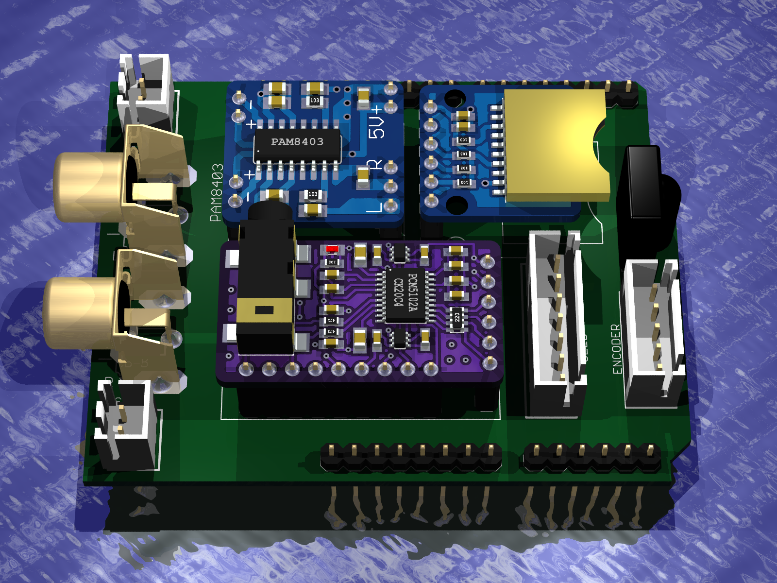

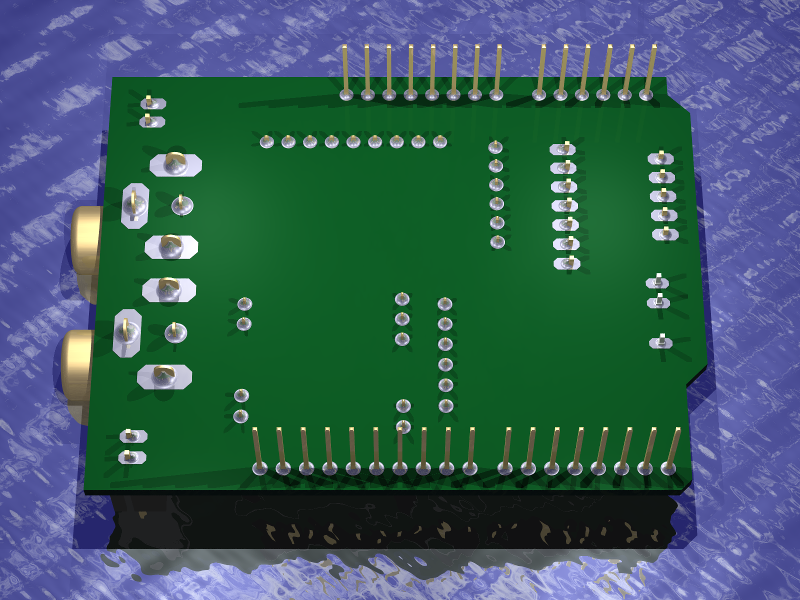

  • #906 21475806
    DJCheester
    Posts: 2049
    Help: 75
    Rate: 949
    Board Language: polish
    I need to familiarise myself with what's on this github, but SMD soldering is not my fable, not these years and eyesight, as something to gerber do as there are files and to chine but I won't solder it myself anyway.
    I was thinking more of an overlay for this ESP32-Uno something like this
    Electronic module with various components, including audio connectors and encoders. .
    View of a printed circuit board with various connectors and pins designed as a shield for ESP32-Uno. .
    Audio speaker out, encoder and oled connectors
    audio chinch out sockets
    All applied to ESP32-Uno pins
    Greetings ...

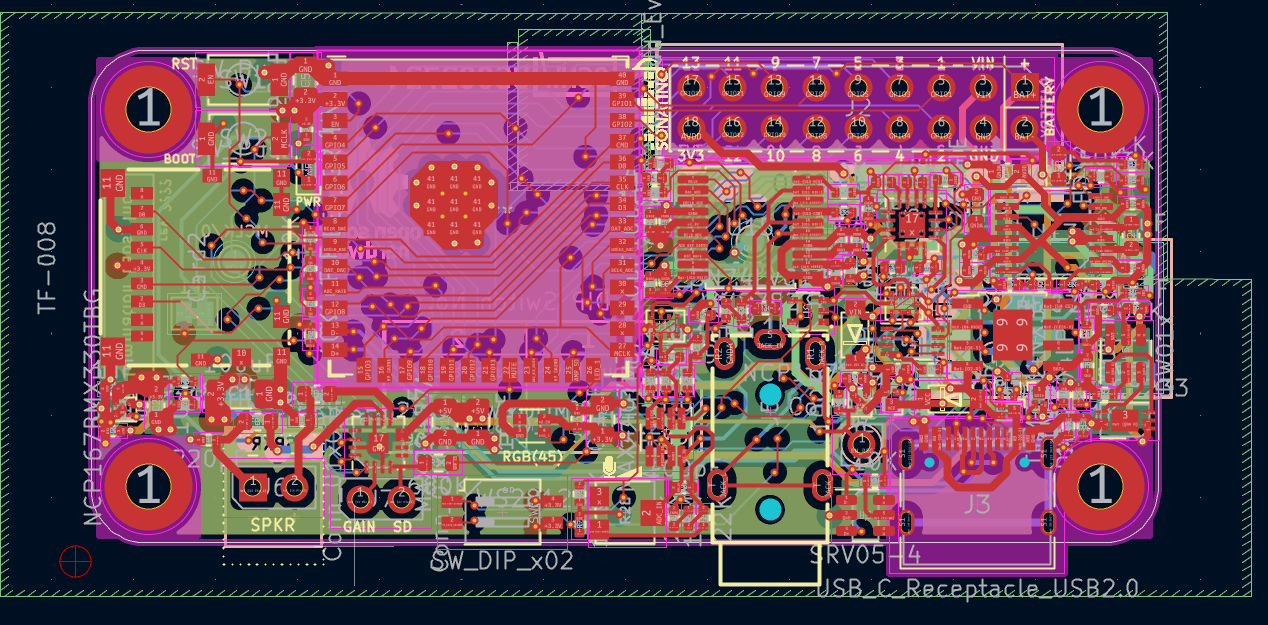

    @MAJSTER XXL I also came across this Sonatino project. Quite tightly packed with everything. The project opens normally in KiCad. I'm not proficient in that environment because I've never drawn anything there but program like program. There's a lot of unnecessary stuff in Sonatino itself for a radio. There's a microphone preamp, a headphone amp. There is also another DAC (WM8524).
    PCB only to be manufactured in China because it is a 4-layer. Price unrealistic in PL.
    If someone wants, I have created a library for ESP32-WROOM-1(U) for Eagle. Bede will draw his version of the module. Most likely in format as a "sandwich" under the OLED of this 3.12 inch.
    A snapshot from KiCad for the Sonatino:
    View of the Sonatino PCB design in KiCad software. .

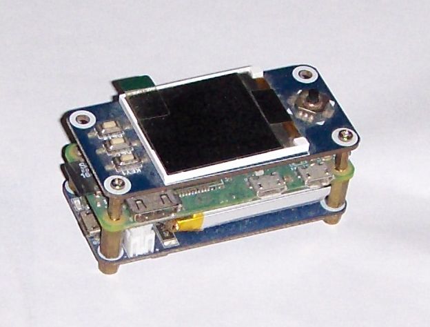

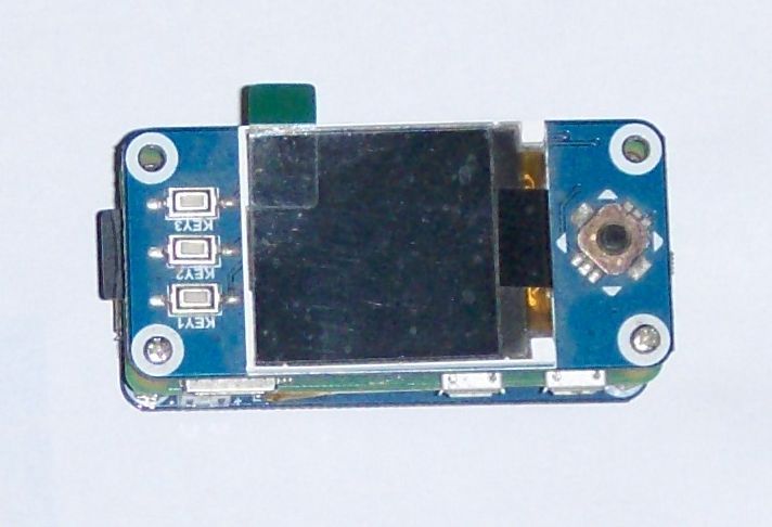

    I have an ESP32 on a UNO-like board and it works well, but I don't see the point with an ESP32S3. Unless you make all the interfaces for the internet radio on it and output the UNO connectors standard like on this board what you showed. Like if you made the output under LAN then I might be tempted to get a ready-made one.
    Added after 13 [minutes]: .
    As if anyone would like to make this SONATINO their own way, make it to the RPI zero standard. There are ready-made modules for this with displays including keypads and buttons as well as UPS batteries.
    Electronic module with display and buttons. .
    Small electronic module consisting of a display and PCB, assembled in layers. .

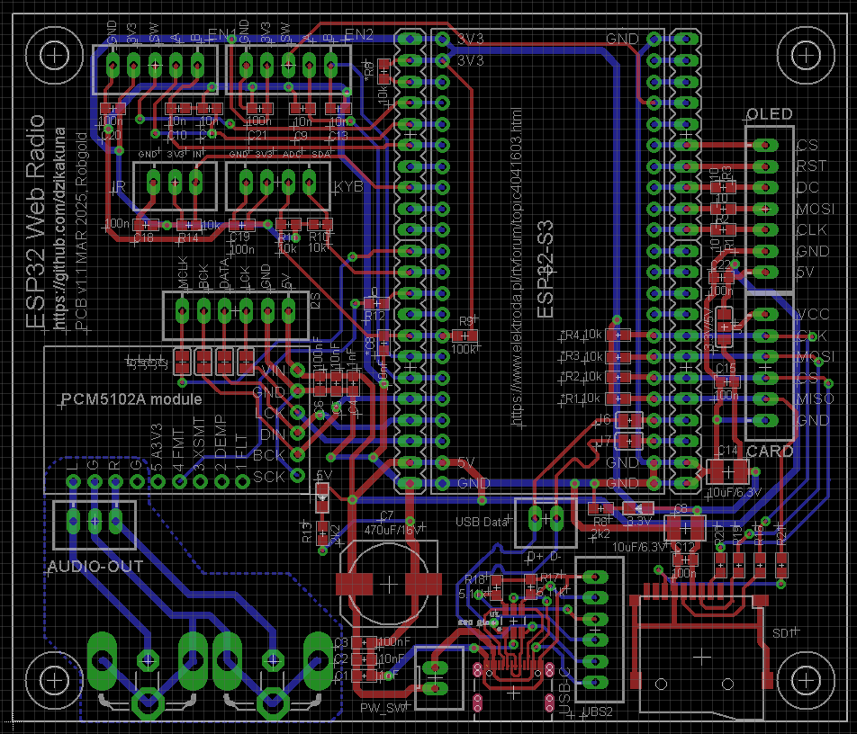

    Welcome

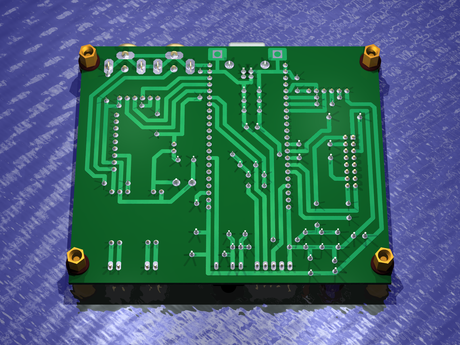

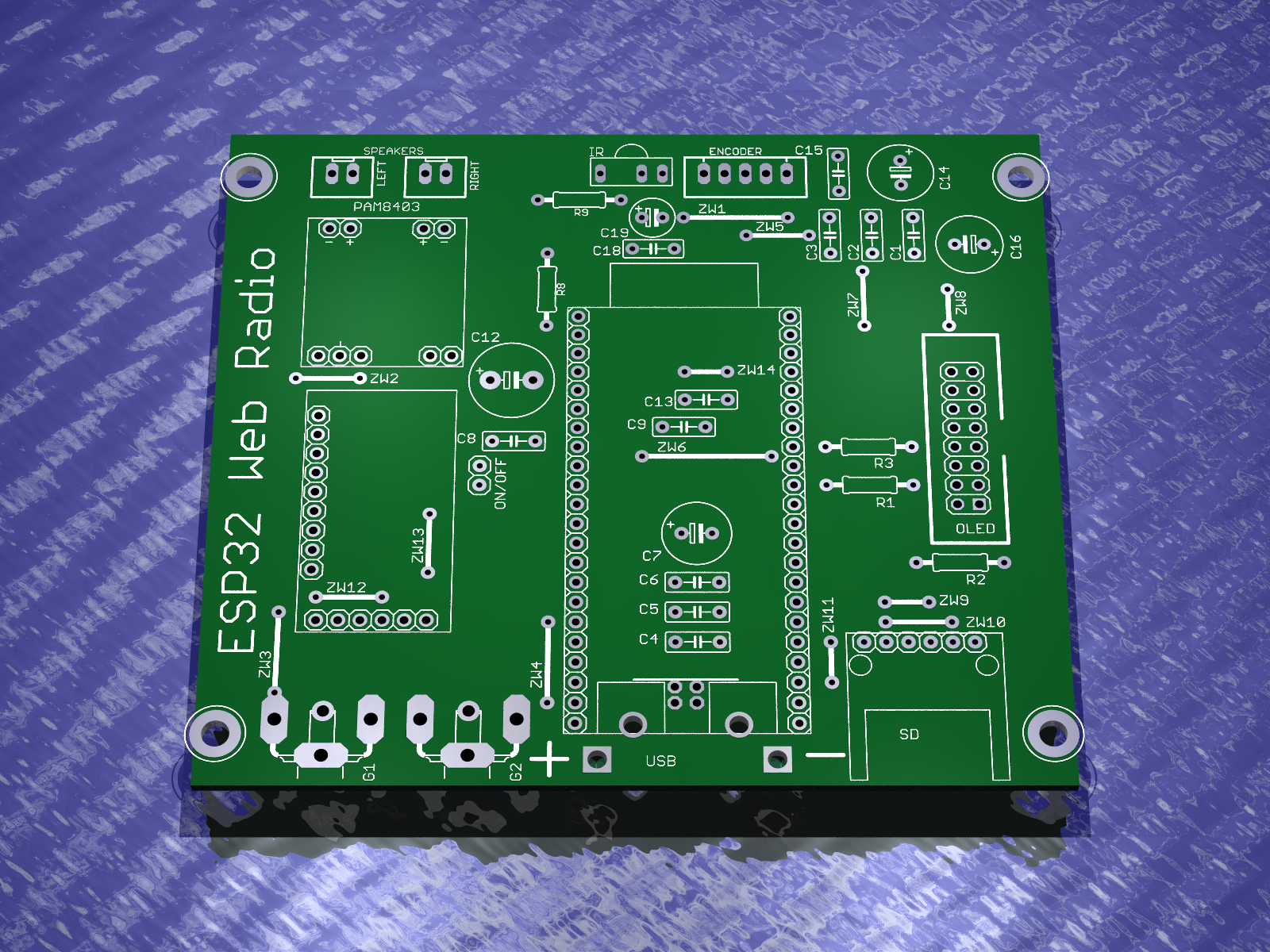

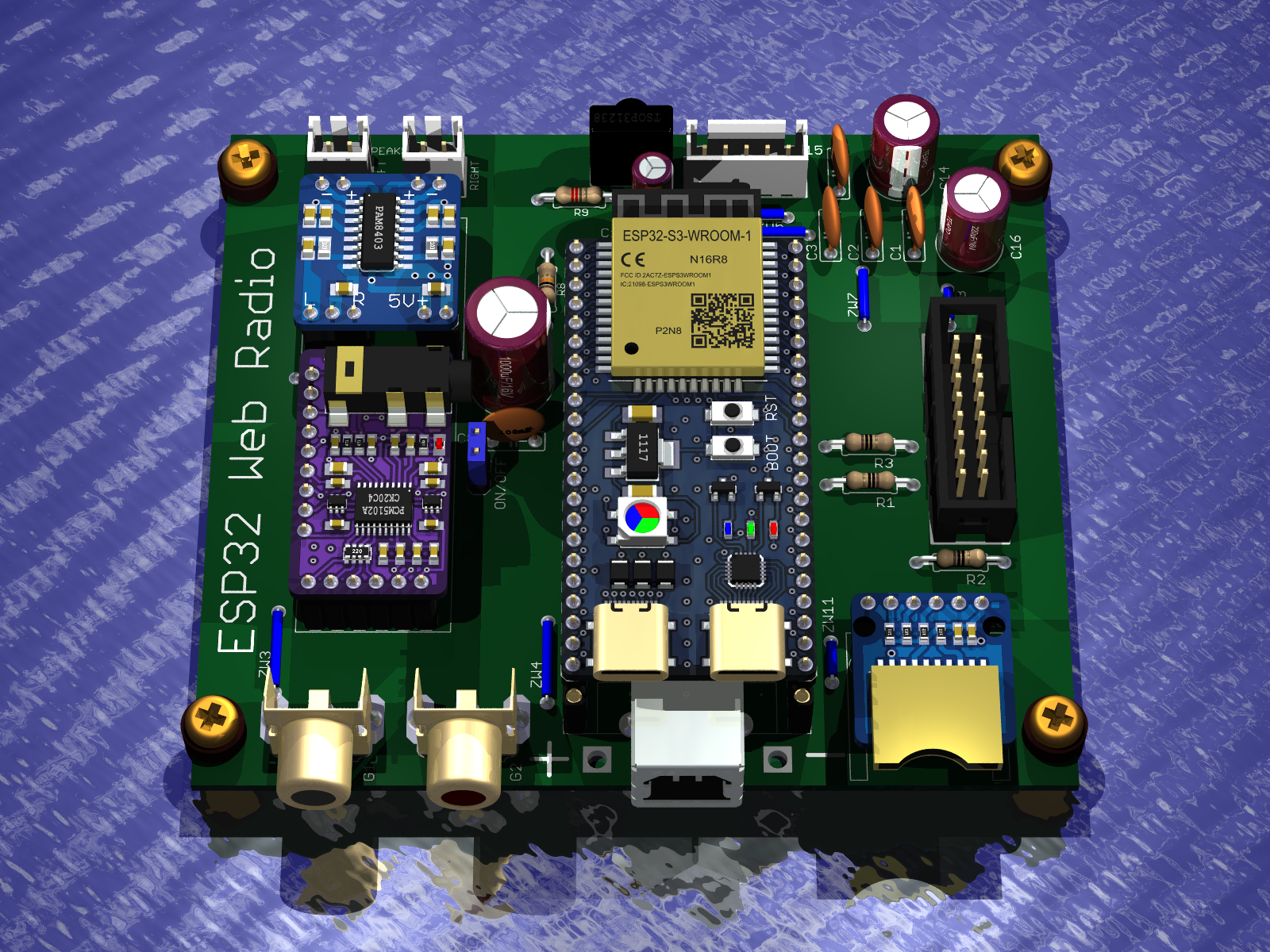

    Below I am attaching a new version of my first PCB - eagle file.
    The old version is available here
    https://www.elektroda.pl/rtvforum/topic4041603-540.html#21434558
    Single-sided ESP32 Web Radio PCB with PAM8403 amplifier and electronic components. .
    Single-sided PCB with green laminate and yellow mounts. .
    Green PCB for ESP32 Web Radio project with labeled solder points and components. .
    Single-sided PCB with visible traces and mounting holes. .
    This is a "slimmed down" version - under Robgold's colleague's soft, single-sided easy to make using the home method - thermo-transfer.
    I resigned in it from a socket for colleague Major's joystick and connector for the first encoder (used for MP3 player in colleague Major's software).
    The board is less than 10x10cm in size - it contains a PAM8403 power amplifier. The jumper is used to power the amplifier.
    As for the software declaration I use without encoders - the radio works stably on such a declaration
    Code: Arduino
    Switch is only assigned to the pin and the other two signals are declared to -1
    You can of course add 4.7-10k pull-up resistors under the CLK, DT, SW pins to 3.3V and this should also take care of the matter.
    Both the first and the second version of my PCB do not contain such resistors.
    Regards ...

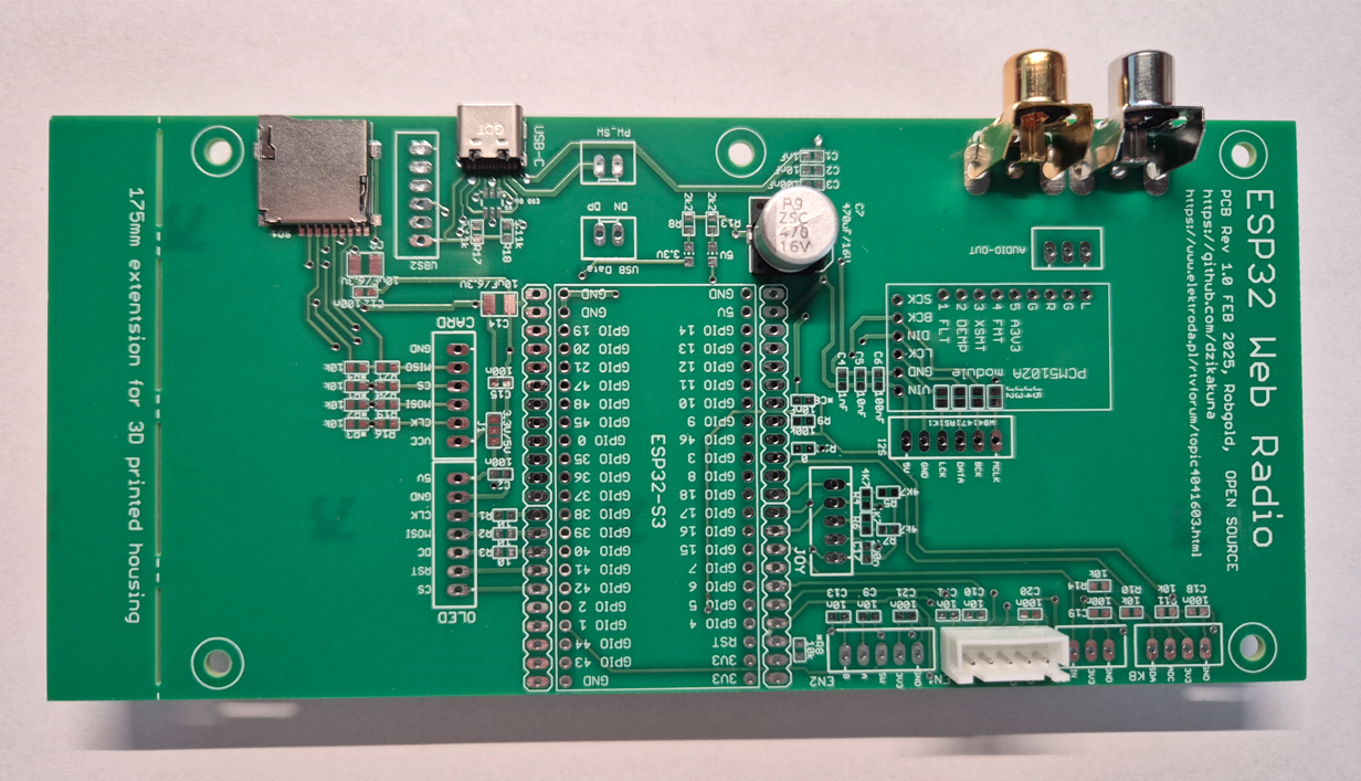

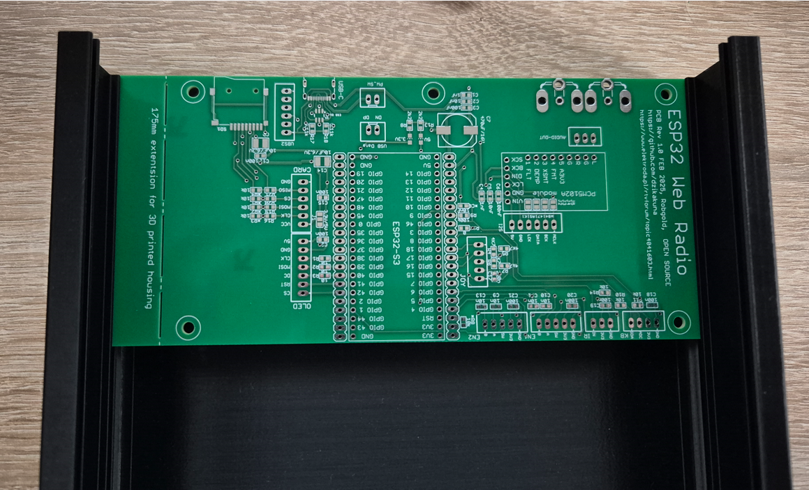

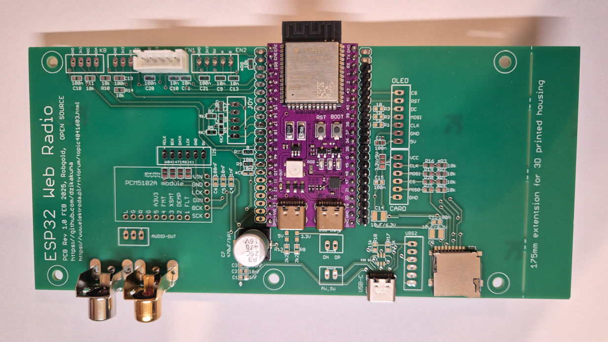

    While we are on the subject of PCBs.... they have arrived !!! :) Exactly a week ago they left the factory. Now a bit of spare time and it will have to be assembled. The most important thing is that all key components like usb-c, card reader and RCA connectors fit perfectly. PCB adapted, of course, to the printed case as well as the Hamond.
    The factory also handled the slotted pads without a problem. This is not obvious, because Eagle in older versions did not have support for pads of this type natively. You have to draw the missing holes on the milling layer accordingly.
    PCB is supposedly a prototype but something feels that if everything works it will stay for longer ;) .
    PCB with ESP32 module and USB-C connectors along with a card reader.
    Green PCB with electronic components, including USB-C port, card reader, and RCA connectors. .
    Green PCB with visible traces and component slots, placed on a wooden surface. .
    PS If someone would like I have redesigned based on the same PCB schematic as a 100x85mm module with the Joystick connector omitted. This makes it possible to have 5pcs PCBs within 50PLN. (Up to the dimension of 100x100 PCBs in China are quite cheap, then unfortunately the price starts to increase)

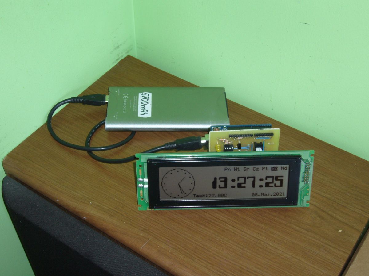

    Well I misunderstood a bit, I do this kind of overlays on the Arduino for specific projects and the idea that the "removable" Arduino is very practical. I want to do the same with this ESP32S3 Uno.
    Here an example of a clock on a graphic display and PCB as an overlay on an Arduino Uno
    LCD display with a clock connected to a powerbank on a table. .
    Now something similar I want to make a compilation like this only incorporating a radio and 7-pin lead and to this a large 5 inch OLED.
    Here in the picture is a 5 inch LCD just for comparison.
    Fellow Robgold dutifully please send the lbr for these Chinch sockets since the holes fit because in my case they are too small.
    You can also send the brd from this small version of your board then I will make a render tomorrow 😀 .
    It will be better to see.
    Greetings....

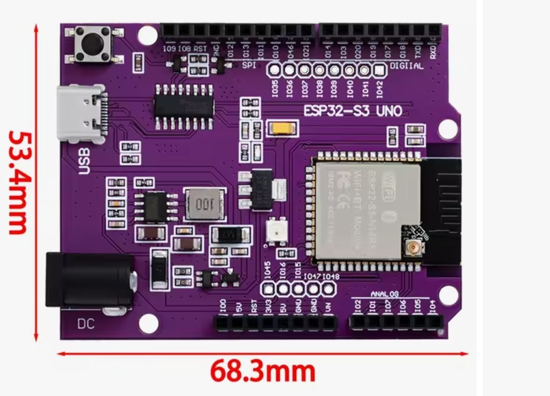

    Just remember that this version a'la Uno has fewer gpio pins than the regular one - so you don't miss ;) .
    Greetings
  • #923 21478652
    DJCheester
    Posts: 2049
    Help: 75
    Rate: 949
    There should be enough pins
    https://pl.aliexpress.com/item/1005008143867026.html
    The ones that aren't led out are on the pads I will make goldpin sockets and pins in my board so that they are all led out on my PCB.
    Purple ESP32-S3 UNO board with dimensions 53.4 mm by 68.3 mm .
    Unless some from the ESP module are not connected at all ?
    Greetings ...
