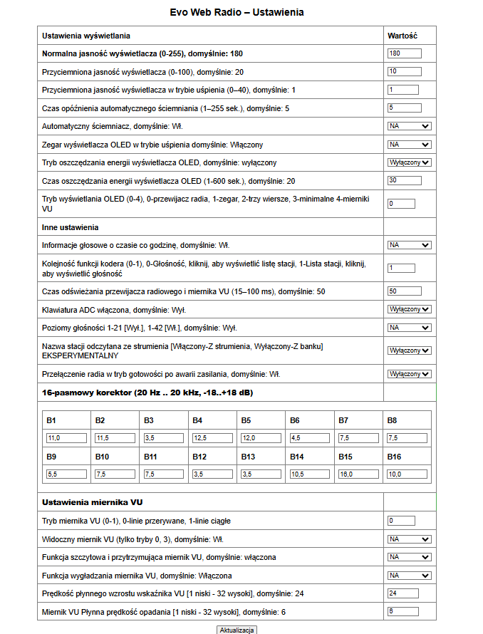

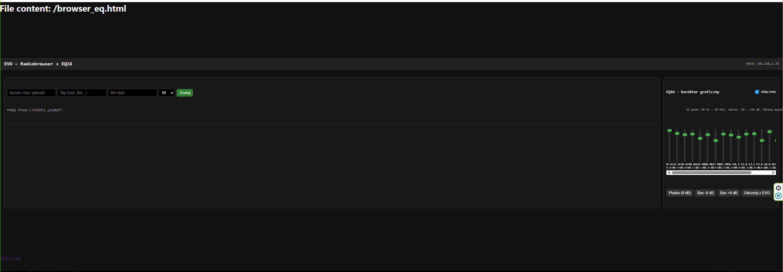

    Gentlemen, I have a question regarding the graphic equalizer and the EVO analyser, is there already a version that supports a full 16 point frequency equalizer with +-18dB gain and do you already have the analyser running for this project . If so, how is it activated, from the SD card or does it have to be placed in code? How do you have this implemented if I may know?

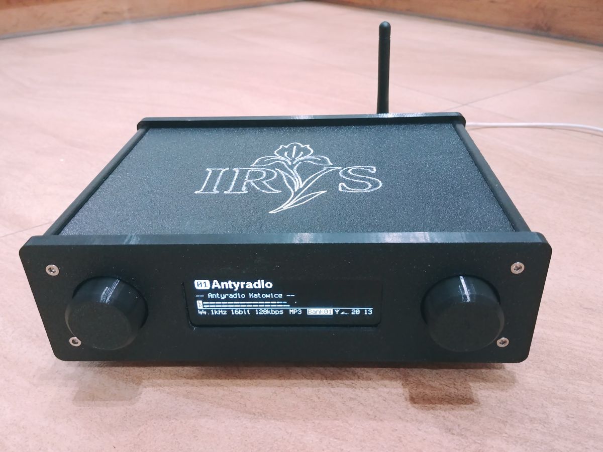

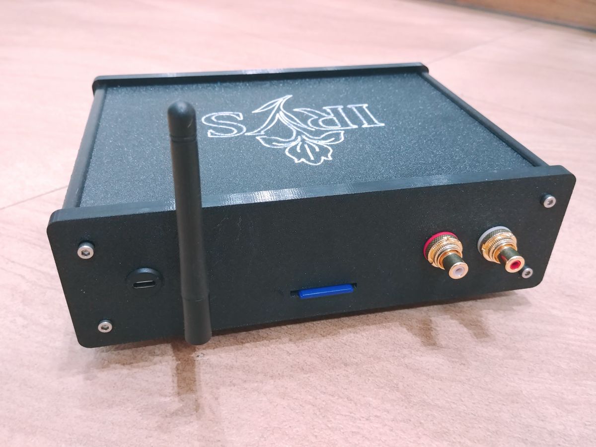

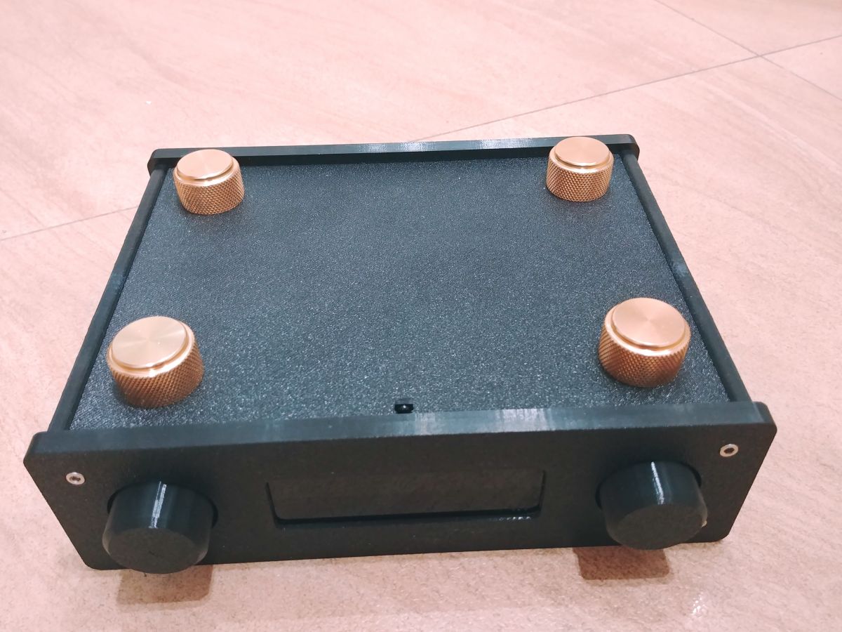

    Black IRYS audio player with two knobs and an LCD showing Antyradio Katowice info
    Black metal audio device enclosure with antenna, RCA jacks, and USB-C port
    Black electronic enclosure with copper feet and control knobs on light flooring
    this is how I came up with a few small tweaks still but almost final state :)

    @ejcon The Evo has the 3 point basic equalizer that the i2s library provides (Hi, Mid, Low). There is also no spectrum analyser. There is only a VU.
    @irysbox Very nice design. That lettering at the top is a laser engraving ? I was just wondering how an engraved case description would come out. Write something more. Oh well and brag about the contents what is inside :)

    >>21750568 I managed to get such an equalizer in YoRadio and it works with the previous audio library. Is it not possible to do this with this audio library?
    Attached is Tom's YoRadio soft with my added graphic equalizer and analyzer in the form of bars. Maybe you guys will find it useful for something.

    >>21750656 yoRadio uses a very old version of the same library. I don't know how it is implemented there. Show the code how you did it we can think about it.

    The middle is moderately beautiful because on a universal plate. There's nothing to be proud of with the usual cableology :) On the top it's a laser engraving so that it's minimally recessed and I pulled on the groove with an oil pen. If it was plexiglass it might have come out better, because because of the grooves after printing it blurs a bit on these irregularities, but don't pour too much. It is ok laser I have 24w. I was doing on a setting of 45 per cent power and 5000mm speed.
    I once tried to resuscitate a Unitra avs103, but it didn't work the first time because my panel shifted and it started to smoke wrong where it needed to :) I had to grind off the oxidation and it went black already. A matter of feeling the power so that it doesn't melt the plastic but minimally sculpts it. Then white lacquer and it comes out not bad, but the adrenaline before starting is :) Before that you have to scan or graphically recreate the letters :)

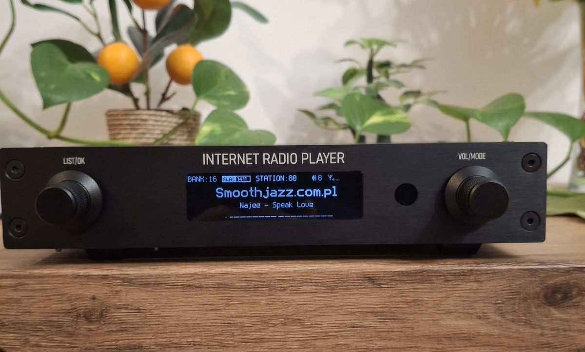

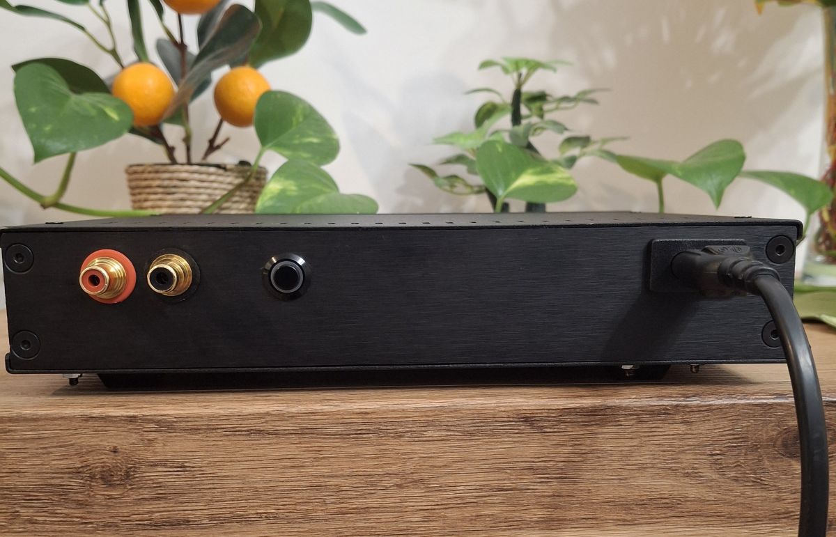

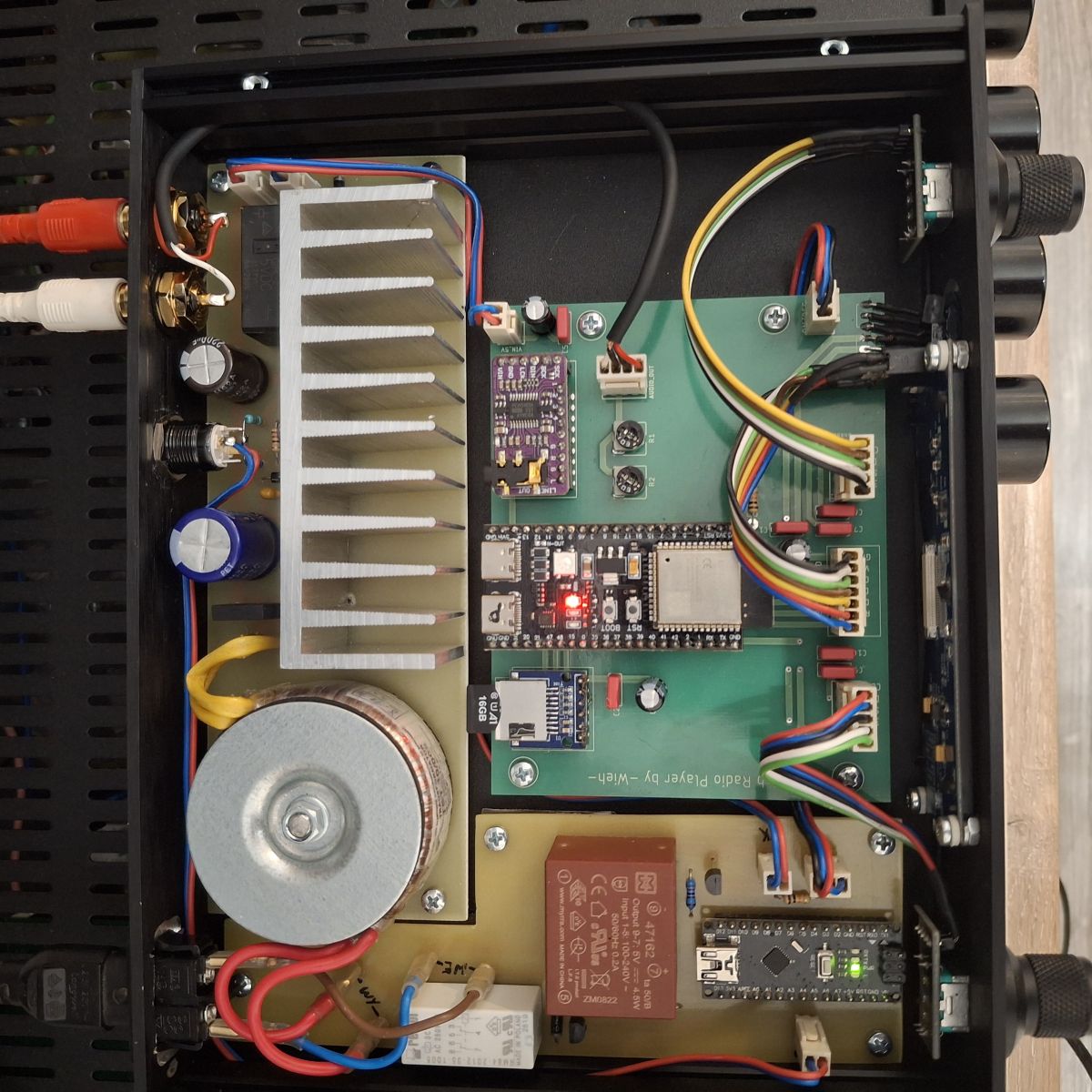

    Radio final version completed. Once again, many thanks to Majstra and Robgold for all their work and making the code available.
    Regards.
    Top-down view of DIY radio internals with ESP32 and connected electronic modules
    Back panel of DIY black radio case with audio and power connectors
    Internet radio player showing Smoothjazz.com.pl on its display

    Very nice workmanship. I am also considering a housing for the radio. Some idea is already there. Time will tell what will come out of it.... 😁
    In general, nice enclosures are a problem for all builders.
    What is the size of the front?

    @efi222 exchange is 42 x 230 mm. You can read about this enclosure a few posts earlier.

    Read, read. The case is nice, just the price is a bit high.... I'll rather hit the 3D printing direction with additional machining.

    @wieh76 Class case. Looks great, very professional.
    As for this second arduino, in the current version of the radio you already have power OFF mode. You only need to set one output depending on the mode. Eventually there will be one in the software so you can control the relay directly from EPS. Current consumption in Standby is uA.

    @robgold as for the arduino I used it because I didn't want the radio to be powered from usb only from a regular power supply via a regular mains cable😀.
    The arduino disconnects the main power supply transformer. This little inverter next to the arduino draws less like 0.3 watts so not much. I tried to do this on some attiny but failed. I think that if I had discovered this thread on the electrode earlier, I would probably have designed it differently, no knobs, just remote control operation and a front like yours, i.e. plexiglass with the width of the display over the entire height of the front panel.
    I'm waiting for you to add support for the 2nd encoder in the code and as far as I'm concerned that will be all I expect from a radio😀.

    ejcon
    Posts: 253
    Rate: 54
    Thanks for the hint
    The problem will be with the equalizer at the FLAC decoder does not work out processing and cuts very much can be done in two ways as it detects the waveform only 8 point equalizer works or turn off the eq completely.

    @wieh76 Isn't it simpler to power the ESP from a small inverter it needs only 150mA with the OLED and then control yourself in standby mode with this big relay and trafo to the amplifier ?
    You are quite rid of the little Atmel which does the same thing as the EPS in sleep mode.
    Wait, I'm looking and looking...what is on that big board with that huge heatsink ? The power supply for the ESP ? Only ?

    @robgold you guessed it😀. That transformer and heatsink only look huge in the photo. The trafo is small just compare to the nano. The heatsink fact I could have trimmed a bit. In my trial current measurements, the meter showed a current of 0.2 to 0.5A depending on how much information is shown on the display, so I was worried that this converter would not be able to handle it. Besides, at the time, this was the only way I could implement on/off, because I can program myself a flashing diode😀

    :) with this transformer and heatsink you could probably make a nice amplifier with 20W that would make sense :)

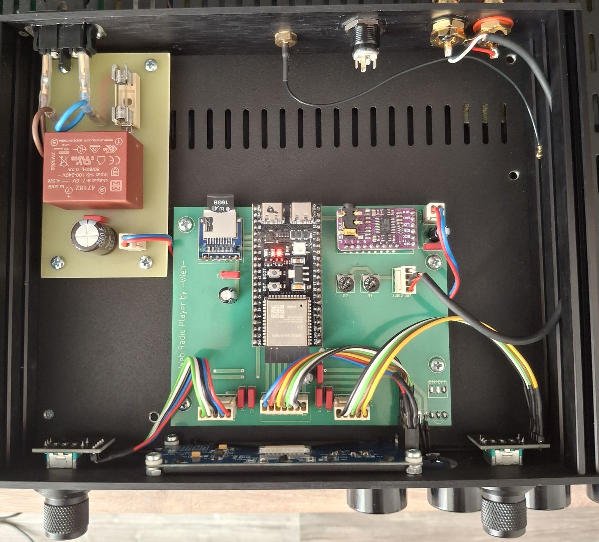

    @irysbox no exaggeration the trafo is 10W. Apart from that, the topic is already out of date😀. After a late night discussion with robgold this remains:
    Interior of a DIY internet radio with ESP32, power supply and external Wi-Fi antenna
    I have also added an external wi-fi antenna socket as the range halves when the case is closed.
    The ESP with the antenna socket is already flying from China🙂 .
