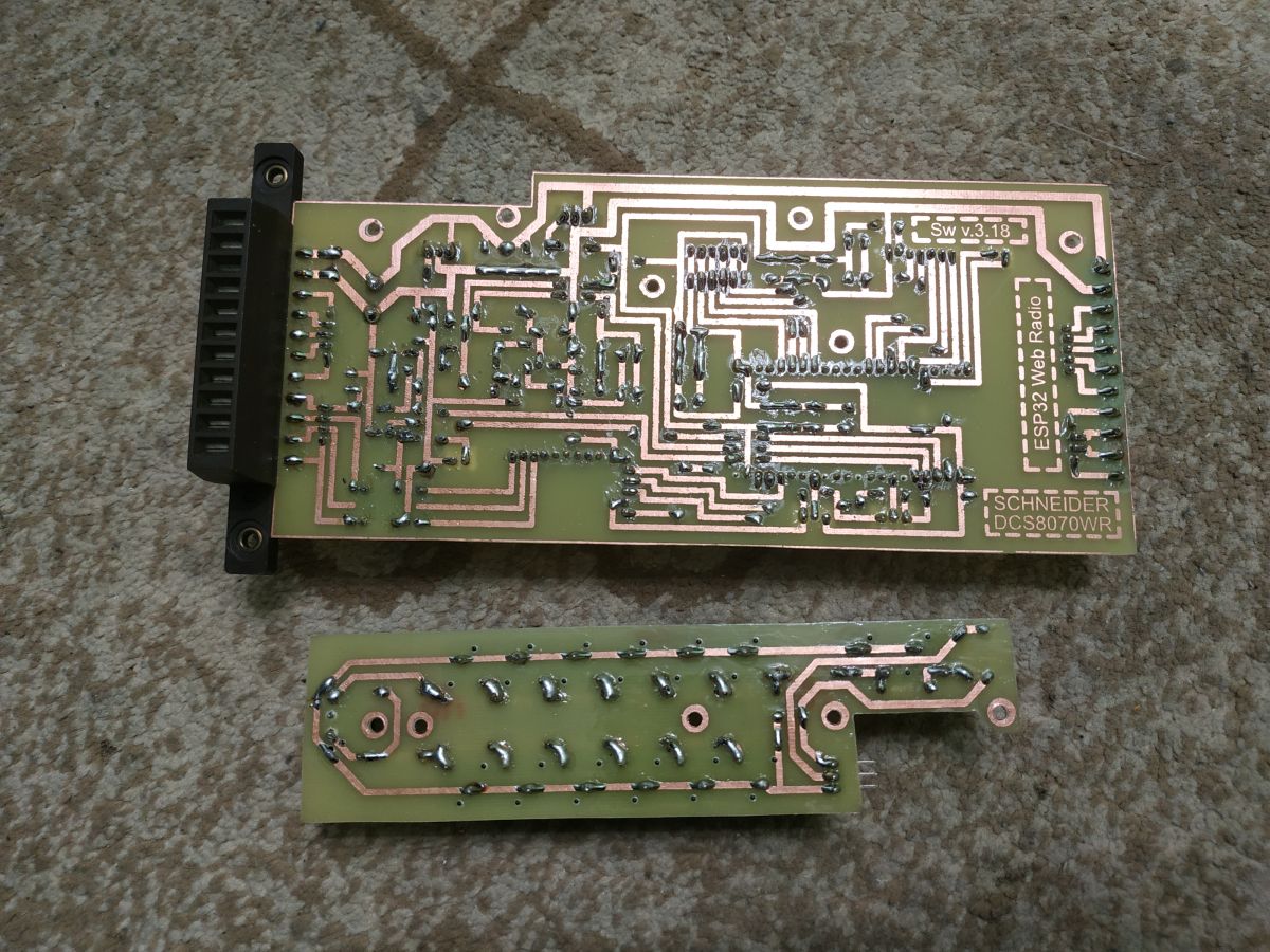

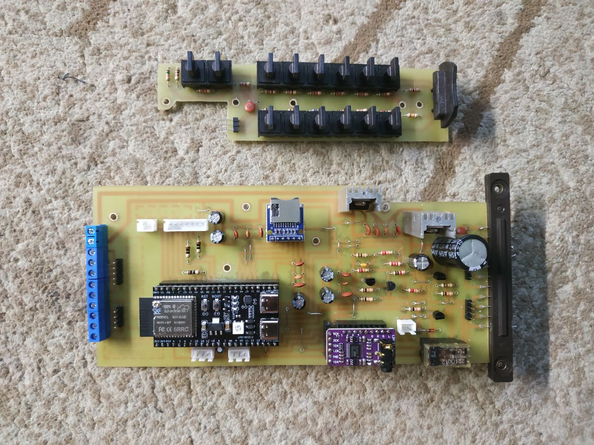

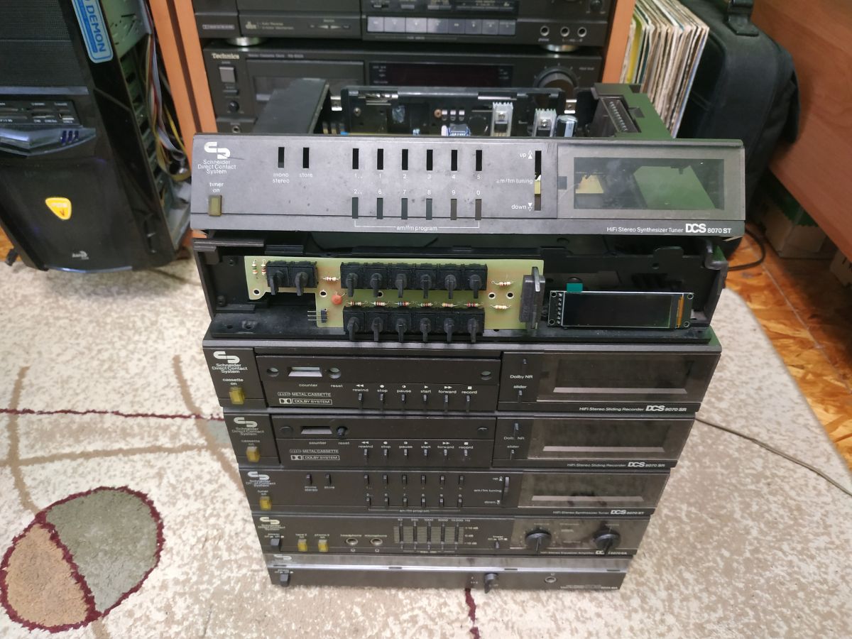

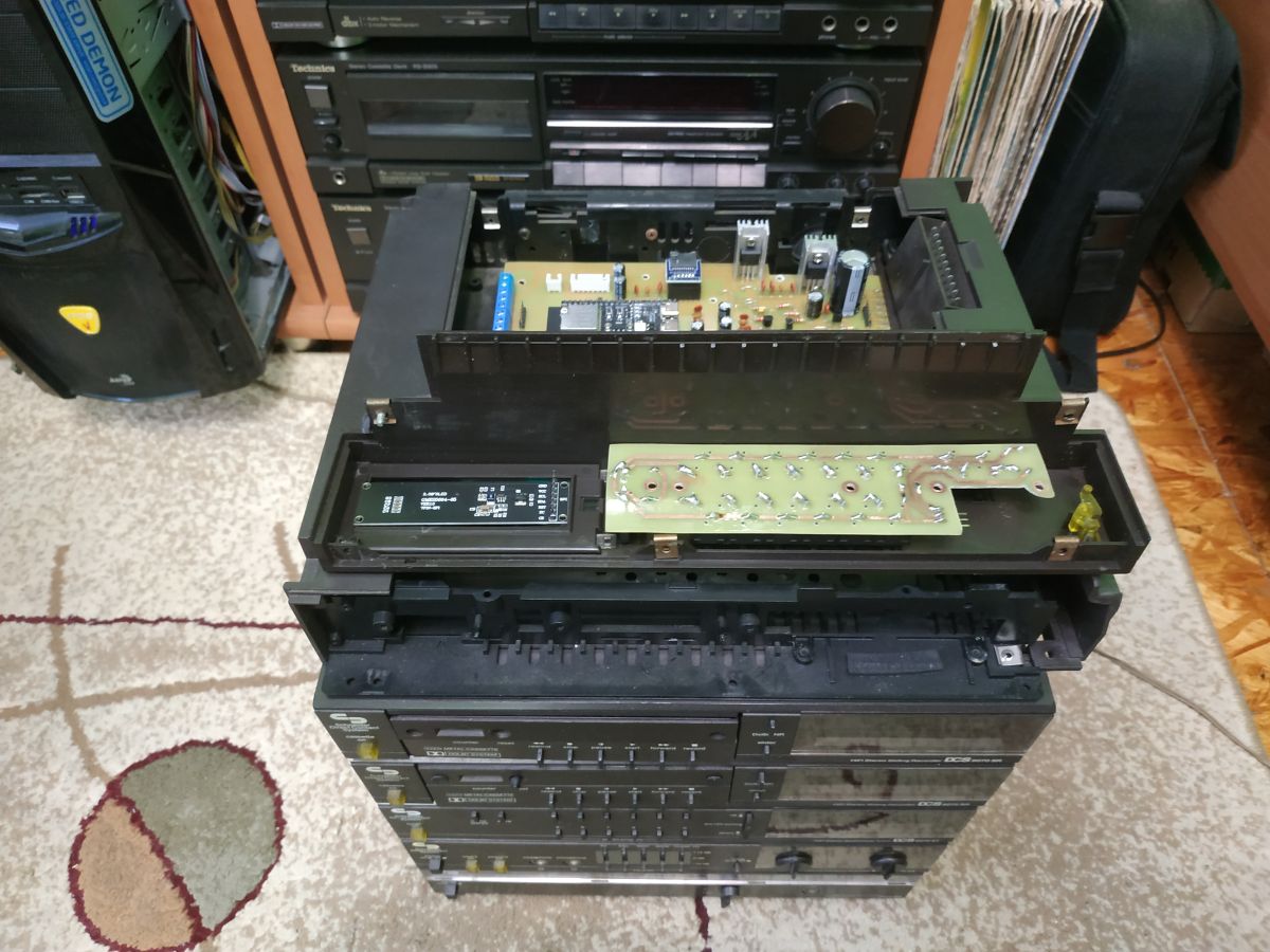

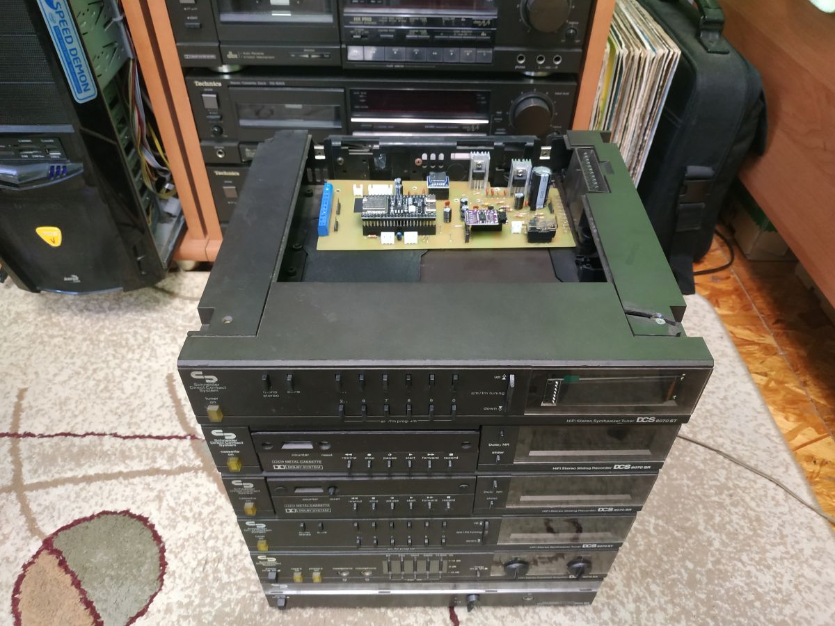

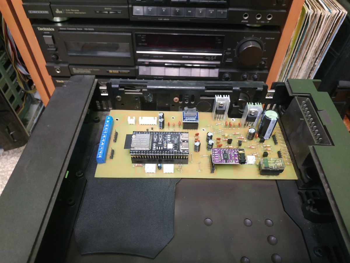

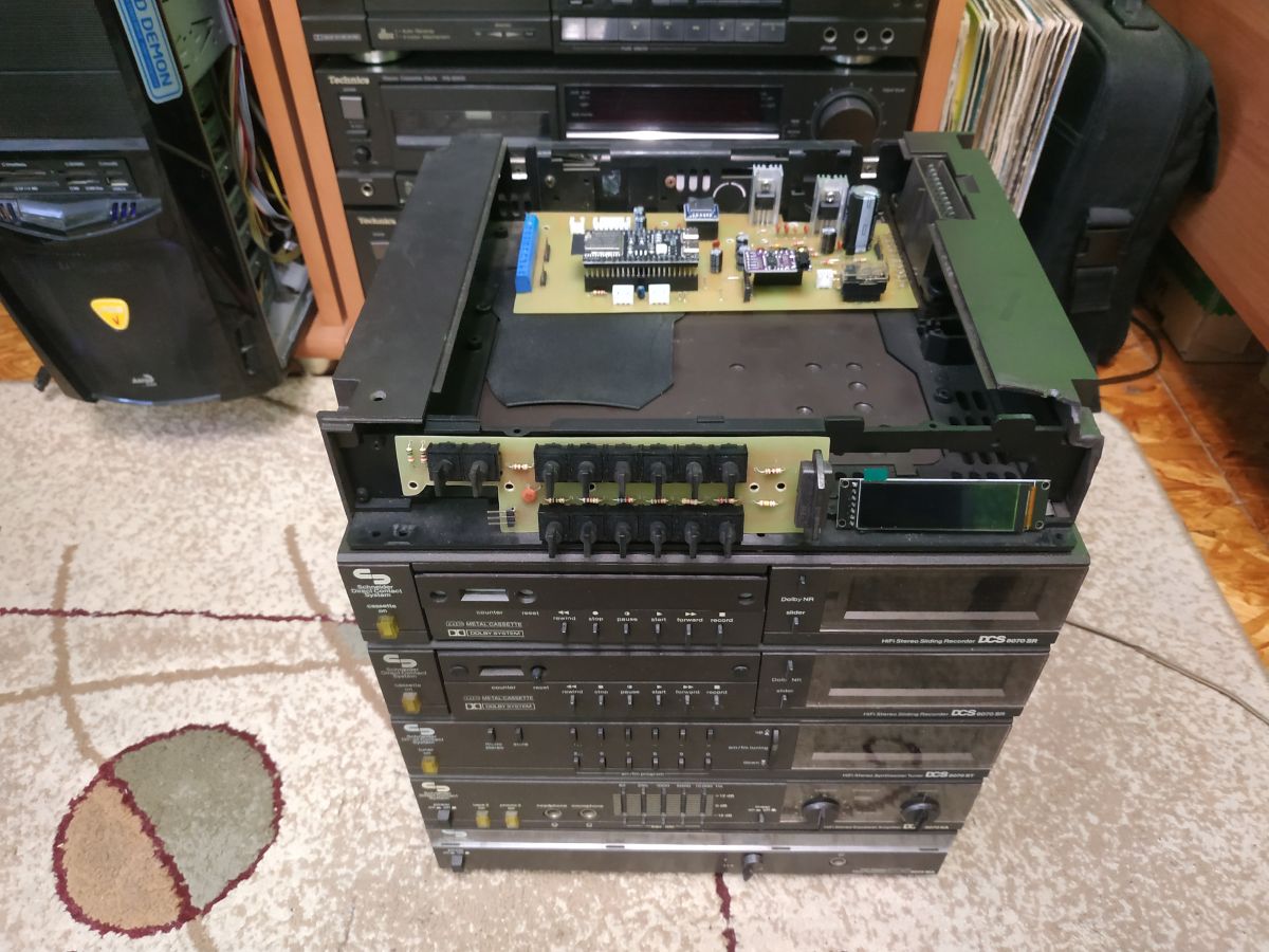

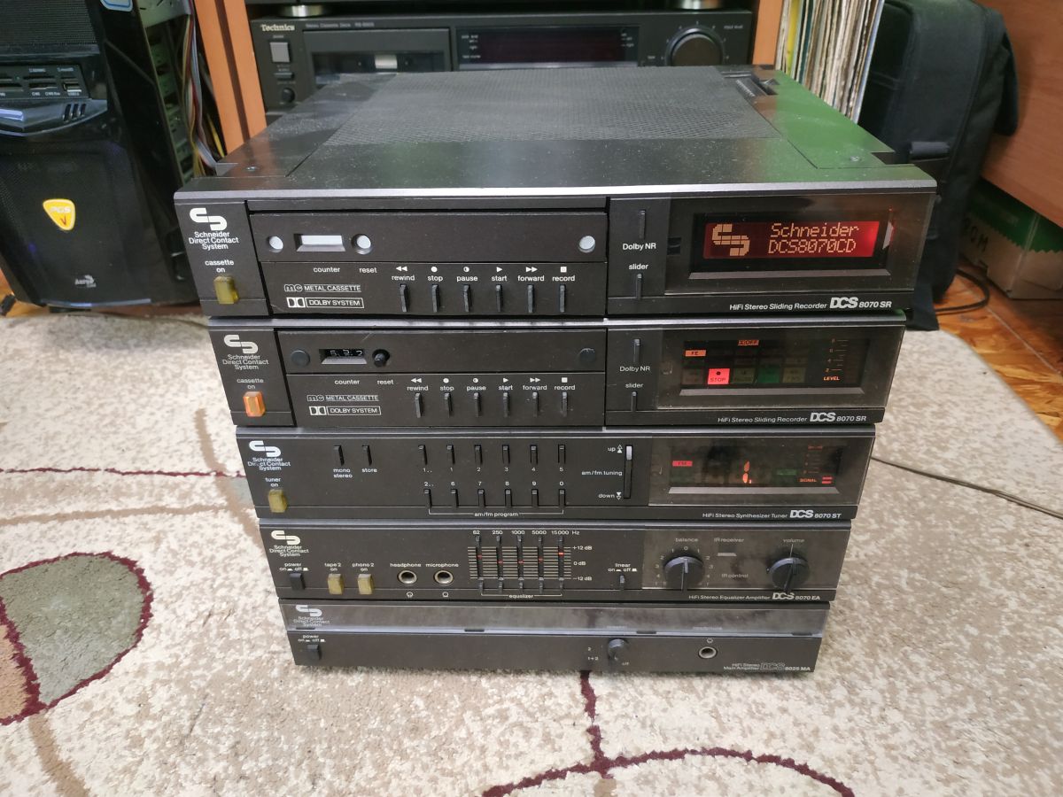

    For some time now I have been creating another "block" for my Schneider tower. The tower is now about 40 years old, I have renovated this equipment, and added a CD player integrating function and interoperability with the whole set, that is, operation of a common remote control, input selector and recording to cassette from cd.
    The equipment has full compatibility.
    Especially from here I would like to thank my colleague @gps79 for developing the software for the CD player, if it wasn't for him it wouldn't be compatible with the rest of the set, it was he who wrote the remote control reception in ITT standard and the input selector support.
    My warmest greetings to him from this place.
    Someday I will describe in detail how we have been struggling with this construction, but I would like to do it right and, as you know, you need time to do it, which is still lacking.
    1980s Schneider Hi-Fi stack with multiple black audio components on a carpet
    As the equipment is modular I intend to add another block consisting of this radio from the Robgold evo3 version of the coll.
    There is already a PCB version without encoders but with keyboard and remote control operation.
    PCB for my version of the radio.
    Two Schneider DCS8070WR PCB boards lying on a patterned carpet Two PCBs with electronic components placed on a beige carpet
    The whole thing will be mounted in the tuner like this.
    Schneider hi-fi module with a custom PCB board mounted on top of the unit Disassembled radio module on top of a Schneider Hi-Fi tower with visible PCB Modular Schneider Hi-Fi tower with open tuner and visible circuit board Radio module on open Schneider Hi-Fi unit with visible custom PCB Mounted PCB inside audio tuner case with visible electronics and connectors
    I still don't want to get on with it yet because what I feel like sitting down to make changes to the code Col. Robgold gives a new update and new features (for which I thank him)
    Someday, however, the project of a mini Hi-Fi tower from the 1980s in Germany will have to be completed
    Greetings ...

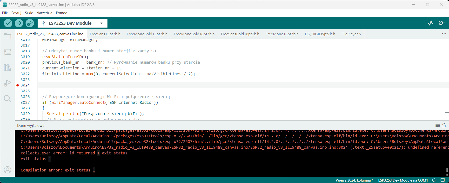

    DJCheester- Towje solution helped but now I have another error?
    C:/Users/Bolszoy/AppData/Local/Arduino15/packages/esp32/tools/esp-x32/2507/bin/../lib/gcc/xtensa-esp-elf/14.2.0/../../../../xtensa-esp-elf/bin/ld.exe: C:\Users\Bolszoy\AppData\Local\arduino\sketches\60E76002371B55718EB2E4873B120729\sketch\ESP32_radio_v3_ILI9488_canvas.ino.ino.cpp.o:( .literal._Z13processIRCodev$part$0+0x80): undefined reference to `displayFolders()'
    C:/Users/Bolshoy/AppData/Local/Arduino15/packages/esp32/tools/esp-x32/2507/bin/../lib/gcc/xtensa-esp-elf/14.2.0/../../../../xtensa-esp-elf/bin/ld.exe: C:\Users\Bolszoy\AppData\Local\arduino\sketches\60E76002371B55718EB2E4873B120729\sketch\ESP32_radio_v3_ILI9488_canvas.ino.ino.cpp.o:( .literal._Z13processIRCodev$part$0+0x84): undefined reference to `displayFiles()'
    C:/Users/Bolszoy/AppData/Local/Arduino15/packages/esp32/tools/esp-x32/2507/bin/../lib/gcc/xtensa-esp-elf/14.2.0/../../../../xtensa-esp-elf/bin/ld.exe: C:\Users\Bolszoy\AppData\Local\arduino\sketches\60E76002371B55718EB2E4873B120729\sketch\ESP32_radio_v3_ILI9488_canvas.ino.ino.cpp.o:( .literal._Z13my_audio_infoN5Audio4_msgE+0xe0): undefined reference to `displayPlayer()'
    C:/Users/Bolszoy/AppData/Local/Arduino15/packages/esp32/tools/esp-x32/2507/bin/../lib/gcc/xtensa-esp-elf/14.2.0/../../../../xtensa-esp-elf/bin/ld.exe: C:\Users\Bolszoy\AppData\Local\arduino\sketches\60E76002371B55718EB2E4873B120729\sketch\ESP32_radio_v3_ILI9488_canvas.ino.ino.cpp.o:( .literal._Z4loopv+0x44): undefined reference to `scrollDownFolders()'
    C:/Users/Bolshoy/AppData/Local/Arduino15/packages/esp32/tools/esp-x32/2507/bin/../lib/gcc/xtensa-esp-elf/14.2.0/../../../../xtensa-esp-elf/bin/ld.exe: C:\Users\Bolszoy\AppData\Local\arduino\sketches\60E76002371B55718EB2E4873B120729\sketch\ESP32_radio_v3_ILI9488_canvas.ino.ino.cpp.o:( .literal._Z4loopv+0x48): undefined reference to `scrollUpFolders()'
    C:/Users/Bolshoy/AppData/Local/Arduino15/packages/esp32/tools/esp-x32/2507/bin/../lib/gcc/xtensa-esp-elf/14.2.0/../../../../xtensa-esp-elf/bin/ld.exe: C:\Users\Bolszoy\AppData\Local\arduino\sketches\60E76002371B55718EB2E4873B120729\sketch\ESP32_radio_v3_ILI9488_canvas.ino.ino.cpp.o:( .literal._Z4loopv+0x4c): undefined reference to `playFromSelectedFolder()'
    C:/Users/Bolshoy/AppData/Local/Arduino15/packages/esp32/tools/esp-x32/2507/bin/../lib/gcc/xtensa-esp-elf/14.2.0/../../../../xtensa-esp-elf/bin/ld.exe: C:\Users\Bolszoy\AppData\Local\arduino\sketches\60E76002371B55718EB2E4873B120729\sketch\ESP32_radio_v3_ILI9488_canvas.ino.ino.cpp.o:( .literal._Z4loopv+0x50): undefined reference to `listDirectories(char const*)'
    C:/Users/Bolszoy/AppData/Local/Arduino15/packages/esp32/tools/esp-x32/2507/bin/../lib/gcc/xtensa-esp-elf/14.2.0/../../../../xtensa-esp-elf/bin/ld.exe: C:\Users\Bolszoy\AppData\Local\arduino\sketches\60E76002371B55718EB2E4873B120729\sketch\ESP32_radio_v3_ILI9488_canvas.ino.ino.cpp.o:( .literal._Z5setupv+0x94): undefined reference to `loadFileAndFolderIndexes()'
    C:\Users\Bolszoy\Documents\Arduino\ESP32_radio_v3_ILI9488_canvas\ESP32_radio_v3_ILI9488_canvas.ino/ESP32_radio_v3_ILI9488_canvas.ino:521:( .text._Z13processIRCodev$part$0+0x356): undefined reference to `displayFolders()'
    C:/Users/Bolszoy/AppData/Local/Arduino15/packages/esp32/tools/esp-x32/2507/bin/../lib/gcc/xtensa-esp-elf/14.2.0/../.../..../xtensa-esp-elf/bin/ld.exe: C:/lib/gcc/extensa-esp-elf/bin/ld.exe: C:/lib/gcc/extensa-esp-elf/bin/ld.exe: C:/lib/gcc/extensa-esp-elf/bin/ld.exe: C:/lib/gcc/extensa-esp-elf/bin/ld.exe: C:/lib/gcc/xtensa-esp-elf/bin/ld.exe: C:/lib/gcc/xtensa-esp-elf/bin/ld.exe.ino/ESP32_radio_v3_ILI9488_canvas.ino.ino:532:( .text._Z13processIRCodev$part$0+0x393): undefined reference to `displayFiles()'
    C:\Users\Bolszoy\Documents\Arduino\ESP32_radio_v3_ILI9488_canvas\ESP32_radio_v3_ILI9488_canvas.ino/ESP32_radio_v3_ILI9488_canvas.ino.ino:2570:( .text._Z13my_audio_infoN5Audio4_msgE+0xfc): undefined reference to `displayPlayer()'
    C:/Users/Bolszoy/AppData/Local/Arduino15/packages/esp32/tools/esp-x32/2507/bin/../lib/gcc/xtensa-esp-elf/14.2.0/../.../..../xtensa-esp-elf/bin/ld.exe: C:/lib/gcc/extensa-esp-elf/bin/ld.exe: C:/lib/gcc/extensa-esp-elf/bin/ld.exe: C:/lib/gcc/extensa-esp-elf/bin/ld.exe: C:/lib/gcc/extensa-esp-elf/bin/ld.exe: C:/lib/gcc/xtensa-esp-elf/bin/ld.exe: C:/lib/gcc/xtensa-esp-elf/bin/ld.exe.ino/ESP32_radio_v3_ILI9488_canvas.ino.ino:2708:( .text._Z13my_audio_infoN5Audio4_msgE+0xcf5): undefined reference to `displayPlayer()'
    C:/Users/Bolshoy/AppData/Local/Arduino15/packages/esp32/tools/esp-x32/2507/bin/../lib/gcc/xtensa-esp-elf/14.2.0/../../../../xtensa-esp-elf/bin/ld.exe: C:\Users\Bolszoy\AppData\Local\arduino\sketches\60E76002371B55718EB2E4873B120729\sketch\ESP32_radio_v3_ILI9488_canvas.ino.ino.cpp.o: in function `loop()':
    C:\Users\Bolszoy\Documents\Arduino\ESP32_radio_v3_ILI9488_canvas\ESP32_radio_v3_ILI9488_canvas.ino/ESP32_radio_v3_ILI9488_canvas.ino.ino:3280:( .text._Z4loopv+0x3f4): undefined reference to `scrollDownFolders()'
    C:/Users/Bolszoy/AppData/Local/Arduino15/packages/esp32/tools/esp-x32/2507/bin/../lib/gcc/xtensa-esp-elf/14.2.0/../../../../xtensa-esp-elf/bin/ld.exe: C:\Users\Bolszoy\Documents\Arduino\ESP32_radio_v3_ILI9488_canvas\ESP32_radio_v3_ILI9488_canvas.ino/ESP32_radio_v3_ILI9488_canvas.ino.ino:3254:( .text._Z4loopv+0x444): undefined reference to `scrollUpFolders()'
    C:/Users/Bolshoy/AppData/Local/Arduino15/packages/esp32/tools/esp-x32/2507/bin/../lib/gcc/xtensa-esp-elf/14.2.0/../../../../xtensa-esp-elf/bin/ld.exe: C:\Users\Bolszoy\Documents\Arduino\ESP32_radio_v3_ILI9488_canvas\ESP32_radio_v3_ILI9488_canvas.ino/ESP32_radio_v3_ILI9488_canvas.ino.ino:3178:( .text._Z4loopv+0x4c1): undefined reference to `playFromSelectedFolder()'
    C:/Users/Bolshoy/AppData/Local/Arduino15/packages/esp32/tools/esp-x32/2507/bin/../lib/gcc/xtensa-esp-elf/14.2.0/../.../..../xtensa-esp-elf/bin/ld.exe: C:/lib/gcc/extensa-esp-elf/bin/ld.exe: C:/lib/gcc/extensa-esp-elf/bin/ld.exe: C:/lib/gcc/extensa-esp-elf/bin/ld.exe: C:/lib/gcc/extensa-esp-elf/bin/ld.exe: C:/lib/gcc/xtensa-esp-elf/bin/ld.exe: C:/lib/gcc/xtensa-esp-elf/bin/ld.exe.ino/ESP32_radio_v3_ILI9488_canvas.ino.ino:3165:( .text._Z4loopv+0x68d): undefined reference to `listDirectories(char const*)'
    C:/Users/Bolshoy/AppData/Local/Arduino15/packages/esp32/tools/esp-x32/2507/bin/../lib/gcc/xtensa-esp-elf/14.2.0/../.../..../xtensa-esp-elf/bin/ld.exe: C:\Users\Bolszoy\AppData\Local\arduino\sketches\60E76002371B55718EB2E4873B120729\sketch\ESP32_radio_v3_ILI9488_canvas.ino.ino.cpp.o: in function `setup()':
    C:\Users\Bolszoy\Documents\Arduino\ESP32_radio_v3_ILI9488_canvas\ESP32_radio_v3_ILI9488_canvas.ino/ESP32_radio_v3_ILI9488_canvas.ino.ino:3024:( .text._Z5setupv+0x217): undefined reference to `loadFileAndFolderIndexes()'
    collect2.exe: error: ld returned 1 exit status
    exit status 1
    Compilation error: exit status 1
    I understand that the issue is:
    Screenshot of a compilation error in Arduino IDE in ESP32_radio_v3_ILI9488_canvas.ino file
    As for the attachment above /file.h/, I don't know by what miracle it attached and how to remove it.
  • #1597 21755484

    Well I was also wondering why you attached this file.
    The question is what windows do you have and is it 32 or 64 bit ?
    Greetings ...
  • #1598 21755501
    bolszoy
    Posts: 63
    Win 11 64 bit.
    There is an empty /.ino/ on line 3024, and I think this is about the link. I will try again tomorrow.
  • #1599 21755507
    DJCheester
    Posts: 2049
    Help: 75
    Rate: 949
    If it's blank then nothing is probably about the line above, but the code is good because it compiles at my place.
    Looking through the log I am concerned about esp32-x32 it looks like it wants to run on 32bit.
    And what version of core do you have ?
    Greetings ...

    I have 3.2.0 installed
    Maybe there is a problem here somewhere, because with me on 3.2.0 it compiles correctly.
    Maybe try an older core install.
    Unless other colleagues have any more insight from the league.
    Regards...

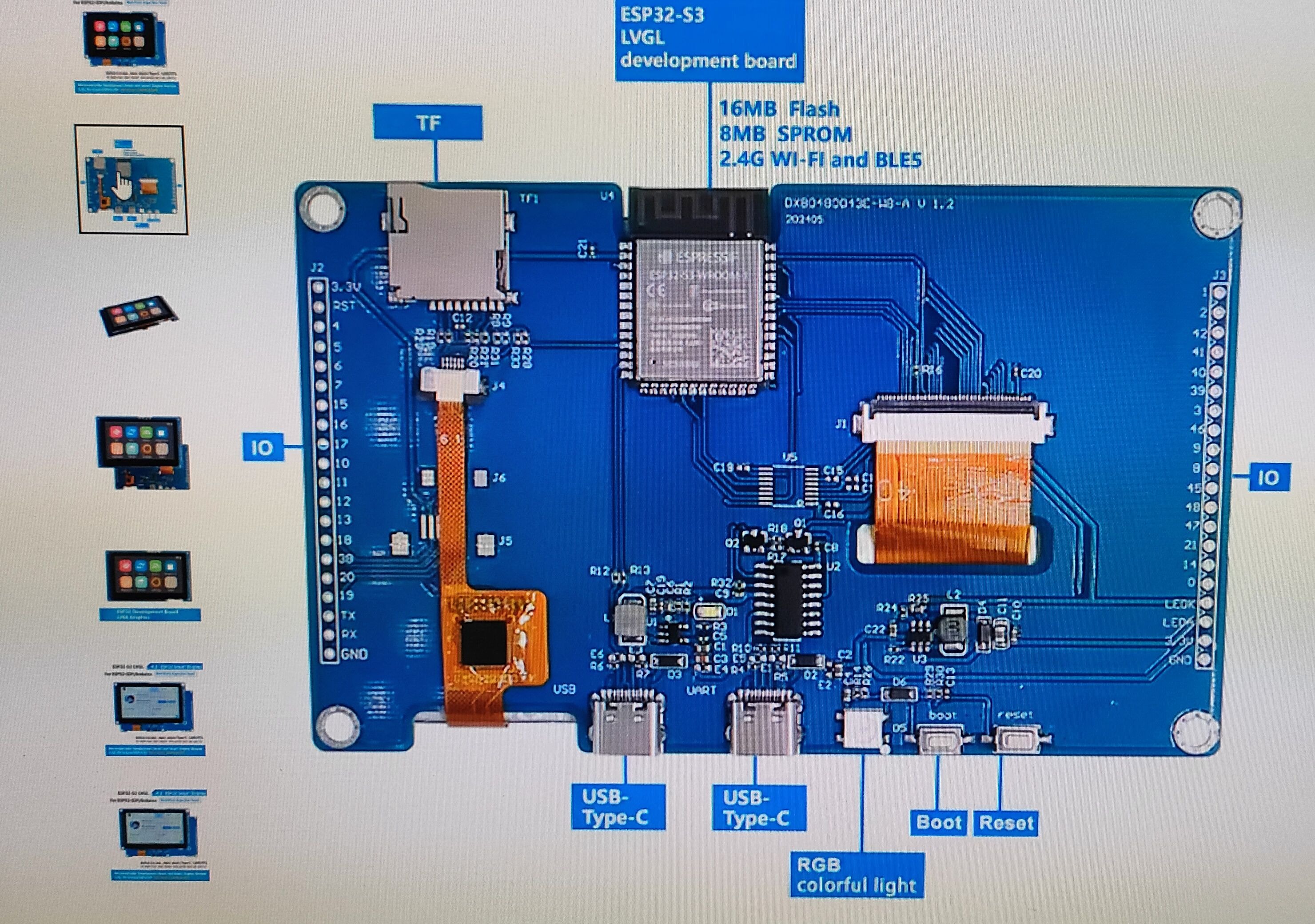

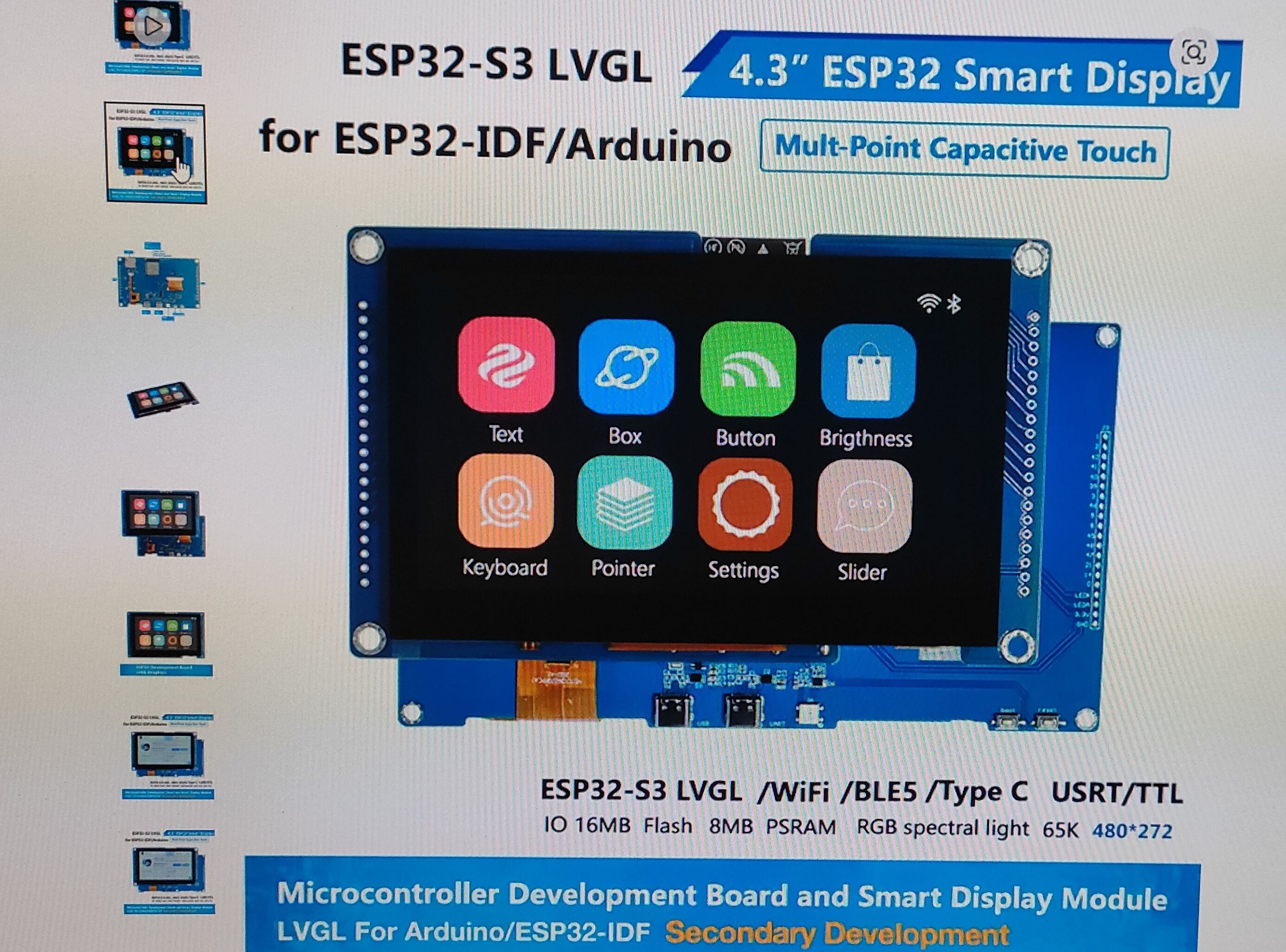

    Good afternoon. Can such an ESP set with LCD be used to create an internet radio?
    • Internet radio and audio file player on ESP32-S3 IMG20251118230210.jpg (1.07 MB) You must be logged in to download this attachment.
    • Internet radio and audio file player on ESP32-S3 IMG20251118224706.jpg (896.2 KB) You must be logged in to download this attachment.
  • #1603 21755874
    DJCheester
    Posts: 2049
    Help: 75
    Rate: 949
    I don't see an audio converter here, so it's out.
    If anything, it's something like this:
    https://pl.aliexpress.com/item/1005008709461693.html
    Here's the converter, but you'd have to redo the whole sketch because this LCD has a different resolution and controller.
    So ready-made boards that you can upload the software to without changes, I haven't seen.
    Greetings...
  • #1604 21756070
    Mis
    Posts: 229
    Rate: 70
    A DAC can always be added externally. The question of adapting the software remains.
    But yoRadio, for example, will go on both boards quoted here.
  • #1605 21756199
    DJCheester
    Posts: 2049
    Help: 75
    Rate: 949
    Of course the pcm can be doped, but I guess the idea is to have everything on one PCB. So it would be better to use the yellow one.
    And then there is the issue of resolution and the display driver.
    Because the Evo3 is a software for OLED, only the master software could be tried. I prefer to assemble everything myself on the PCB as in the project.
    But whatever you prefer...
    Greetings....
  • #1606 21756429
    Mis
    Posts: 229
    Rate: 70
    Take a close look at the yellow one. There's audio on it, only that it's a simple mono amplifier controlled from the ESP's built-in 8-bit DAC. So poorly, and very much so. On top of that, it's a regular ESP32 and not an S3, so there's no PSRAM.
  • #1607 21756444
    DJCheester
    Posts: 2049
    Help: 75
    Rate: 949
    Well, that's a bummer, but thanks for writing.

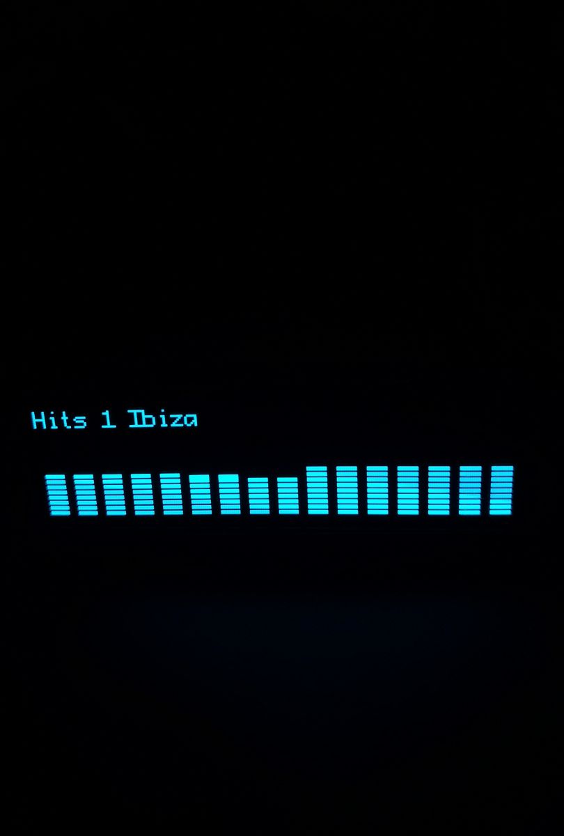

    Hello did I miss something, is there already a version of evo3 with spectrum analyser ?
    Greetings ...

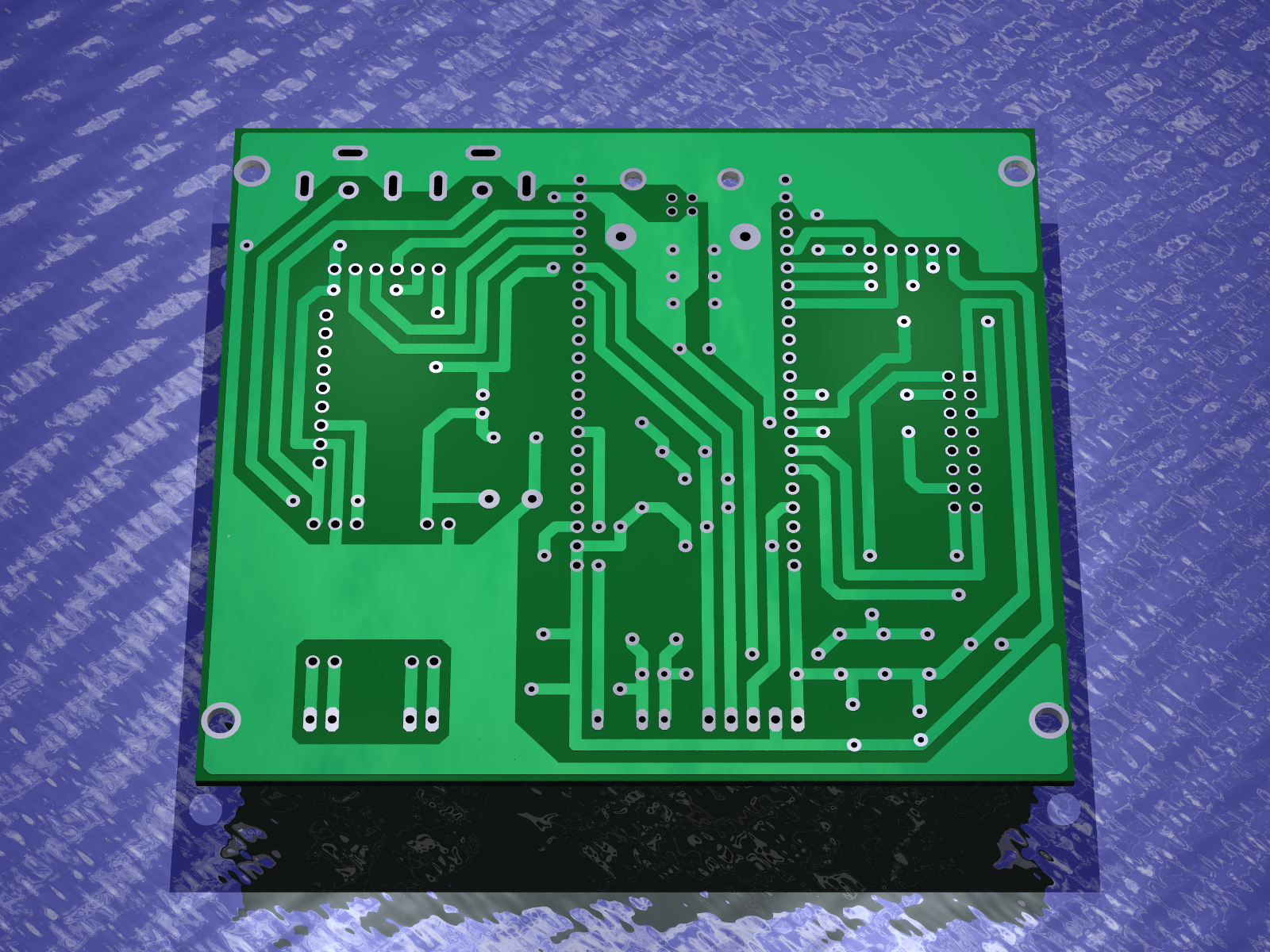

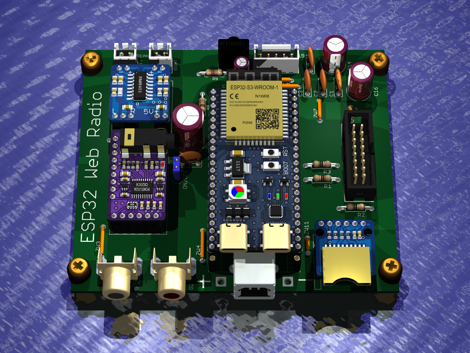

    Hello I started by buying modules on Ali .... and designing the PCB, as for how to install the Arduino and the needed libraries I recently provided a step by step instruction in pdf. It's in the subject line. On github my colleague Robgold has a gerber for his PCB you can order yourself from a Chinese. From what I remember there are SMD components. If you want, I for the version of colleague Robgold's Evo3 have designed a board on through-hole components and modules.
    This is how it presents itself. I already shared the gerber in the topic. But at the moment I have a little modified and if something I will win the gerber for the theme.
    Render of ESP32 Web Radio PCB with through-hole and modular components.
    ESP32 Web Radio PCB with labeled audio, USB, SD, and OLED component slots
    Bottom view of a green PCB with mounting holes and through-hole traces
    Soft of course by a colleague of Robgold.
    It can also be done on a contactor but this is an unstable design.
    Greetings....
