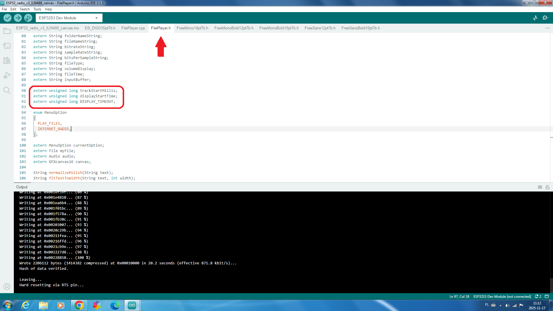

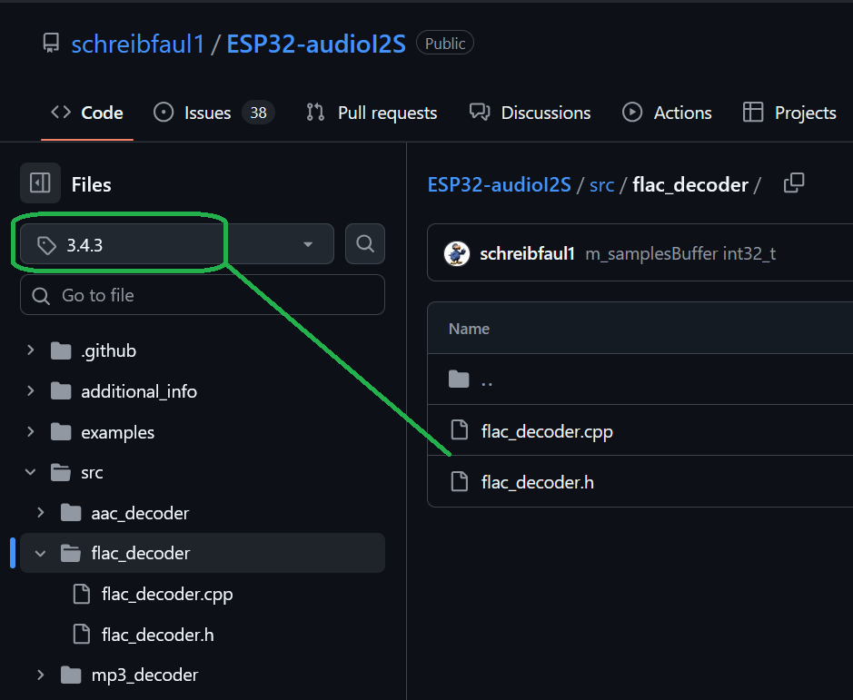

  • Mayster software needs three additional libraries
    #1562 21752268
    bolszoy
    Posts: 64
    DJCheester wrote:
    Dude @bolszoy below I have described the installation procedure from scratch
    https://www.elektroda.pl/rtvforum/topic4041603-1500.html#21748612
    These libraries given there are for the Robgold software
    If you want to load the Mayster software, you also need to have the libraries listed above and for this 3 libraries
    Adafruit BusIO by Adafruit 1.17.4
    Adafruit GFX Library by Adafruit 1.12.3
    Arduinojson by Benoit Blanchon. 7.4.2
    You have it all nicely in the pdf manual what I attached above.
    Greetings....
    Thank you. As for the description above it will certainly be useful not only to me.

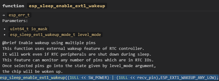

  • GPIO4 EXT1 wakeup breaks audio peripherals
    #1563 21752321
    hevet
    Posts: 347
    Rate: 47
    @robgold I think I have found the solution to my problem. I have changed:
    esp_sleep_enable_ext1_wakeup((1ULL << SW_POWER) | (1ULL << recv_pin),ESP_EXT1_WAKEUP_ANY_LOW);
    back as in version 3.19.19 on
    esp_sleep_enable_gpio_wakeup();
    gpio_wakeup_enable((gpio_num_t)recv_pin, GPIO_INTR_LOW_LEVEL);
    As chatgpt explained, I don't know if he's right or not, but the problem might be my IR pin 4. I used the board from Miniwebradio, and there IR on gpio 4. I have the sensor permanently soldered on for now I won't solder it and check another pin.

  • Version-specific library and wiring inconsistencies noted
    #1564 21752368
    DJCheester
    Level 28  
    Posts: 2089
    Help: 75
    Rate: 958
    bolszoy wrote:
    I would be very grateful. And by the way, looking at GitHub, and the pix that need to be uploaded /depending on the version/, I guess there are some inconsistencies?
    Because, for example, I don't know which libraries and how edited to use for which version. And the V1 is probably already completely wrong - unless I'm mistaken.
    I wonder if anyone else has problems like me?
    This instruction of mine relates to the software of my colleague Robgold (OLED display) version 3.19 i.e. the latest softy.
    V3 Evo version link
    https://github.com/dzikakuna/ESP32_radio_evo3/tree/main/src/ESP32_radio_evo3.19
    And Majstra's software also new version with colour LCD v3. Link
    https://github.com/sarunia/ESP32_internet_radio_v3/tree/main/ESP32_radio_v3_ILI9488_canvas
    Version v2 and v1 (if there was one) are not affected.
    Uploading the Major's v3 soft (colour LCD are different connections - a different schematic to the colleague Robgold's V3 Evo)
    There used to be a version of Majstra's mate v2 it was with two encoders and it too should be able to compile with this set of files what are in the manual.
    Majstra v2 link
    https://github.com/sarunia/ESP32_radio_player_v2
    This is the version with MP3 player, radio and two encoders, there is a diagram on github.
    Regards...

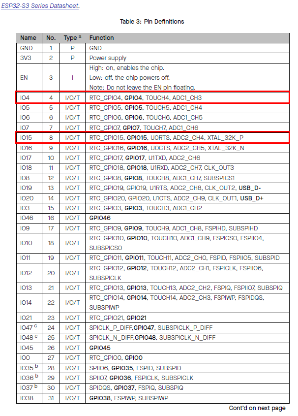

  • ESP32-S3 datasheet shows GPIO4 and GPIO15 usable
    #1565 21752375
    robgold
    Posts: 726
    Help: 10
    Rate: 290
    @hevet all nice and beautiful but chatGPT or any other AI something is screwing up because according to the ESP32 datasheet I followed both pins 15 and 4 can be used for this. The GPIO4 you have in your software has full RTC_GPIO support. Unless I am not seeing something here.
    RTC_ GPIO:
    ESP32-S3 datasheet table showing GPIO functions, GPIO4 and GPIO15 highlighted
    second case:
    esp_sleep_enable_ext1_wakeup function documentation with example code
    I will build your configuration tomorrow because my curiosity about the subject will "eat me up" :D
  • #1566 21752382
    hevet
    Posts: 347
    Rate: 47
    That's why I wrote that I don't know if he's telling the truth 😉 but so far I don't have a problem with the sound, the clock in standby works, switching on only with the power on button works too.

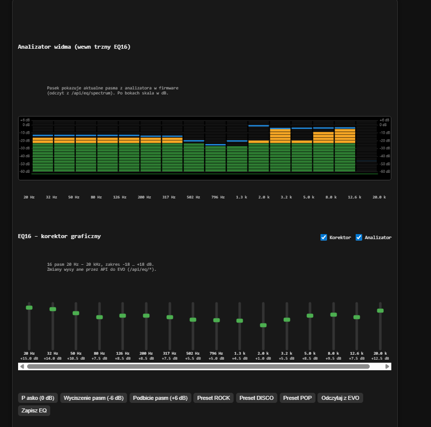

    Spectrum analyzer and EQ interface with frequency band graphs and sliders
    Running the analyser in the EQ API file on the page you have to tick running the analyser .or from the remote control should work

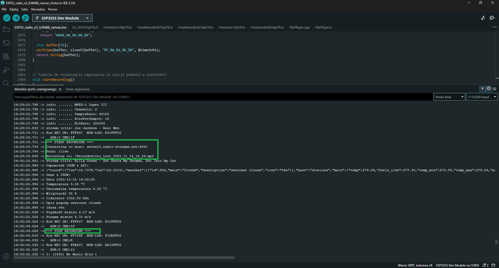

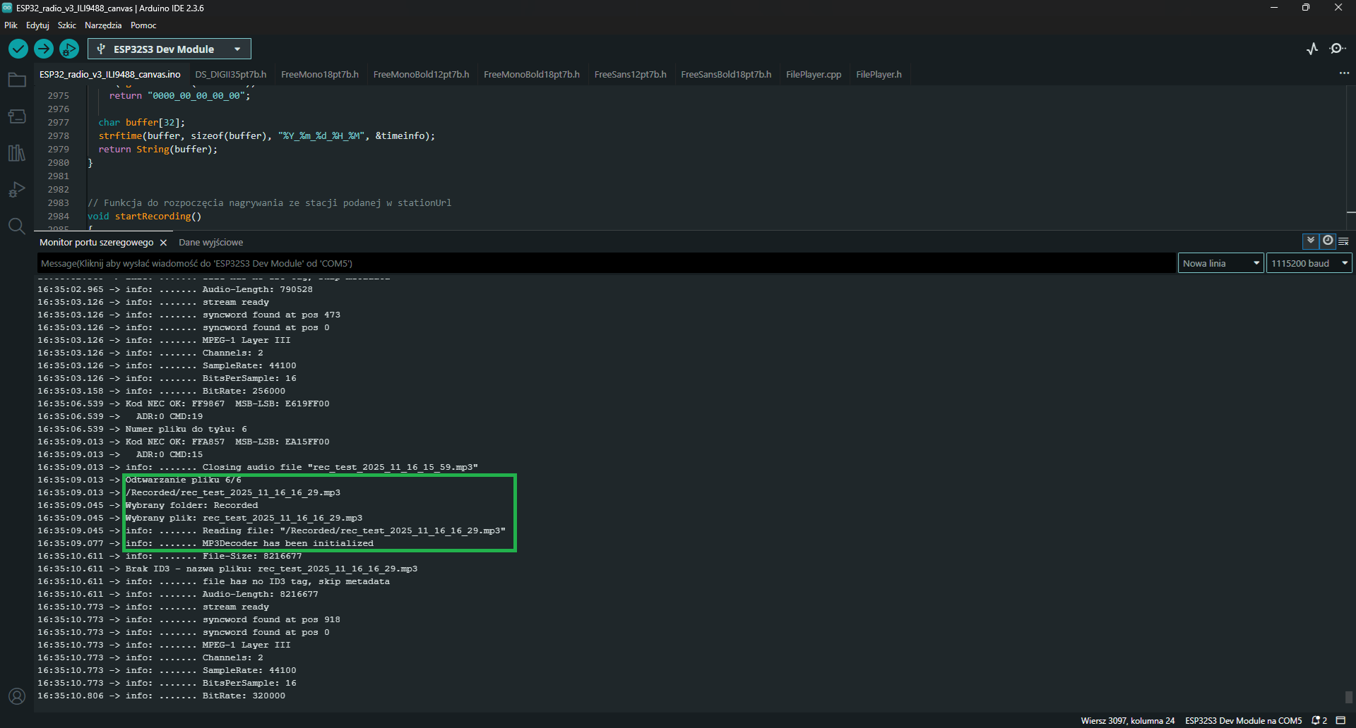

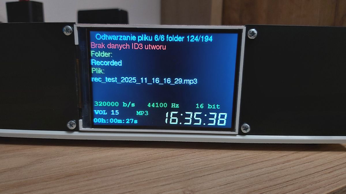

    Another new feature, sure to make quite a splash. Namely, I've managed to figure out a function to record the currently playing radio station. I am currently testing it on a couple of stations that stream in mp3 (e.g. Pure Classix Radio). I had to use the MEMORY button on the remote control, the first press starts the recording which you can see by the REC text appearing to the right of the file type on the screen, the second press of MEMORY stops the recording. The whole thing still needs fine-tuning, but the main idea of recording is successful.
    Recording on the fly involves the ESP32 opening an HTTP connection to a web station at the address stored in the stationUrl variable and downloading the MP3 stream in real time. When the MEMORY button is pressed, the startRecording() function is called, which creates a new file in the /Recorded folder on the SD card. If the folder does not exist, the ESP32 automatically creates it using SD.mkdir("/Recorded"). The file name is generated dynamically in the getRecordTimestamp() function, based on the current time, e.g. rec_test_2025_11_16_16_20.mp3.
    Once the connection is established, the ESP32 sends an HTTP GET request to the station server. Then, in a loop, the handleRecording() function checks if there is data available in the stream and immediately writes it to a file on the SD card. This ensures that the entire MP3 stream is recorded in real time, without having to buffer the entire file in ESP32 memory.
    Recording continues until the user interrupts it with a button or a timeout occurs, which is implemented by checking when the last byte was written (lastRecordRead). If a certain amount of time (e.g. 5 seconds) has passed since the last read, the recording is automatically stopped and the file is closed. When recording is complete, the stopRecording() function closes the file and terminates the connection to the station.
    The result is a full-fledged MP3 file stored on the SD card in the /Recorded folder, which can be played on any player. Recording runs in parallel with radio playback, and the ESP32 saves the stream without decoding it, allowing stable recording at any bitrate and length of broadcast.
    by the way, I have updated the esp32 board manager to version 3.3.3 and do not replace these files libesp_netif.a and liblwip.a because this makes my v3 version take a very long time or not at all to connect to the stream after a power restart, the ESP32-audioI2S audio library also with me in the latest version 3.4.2

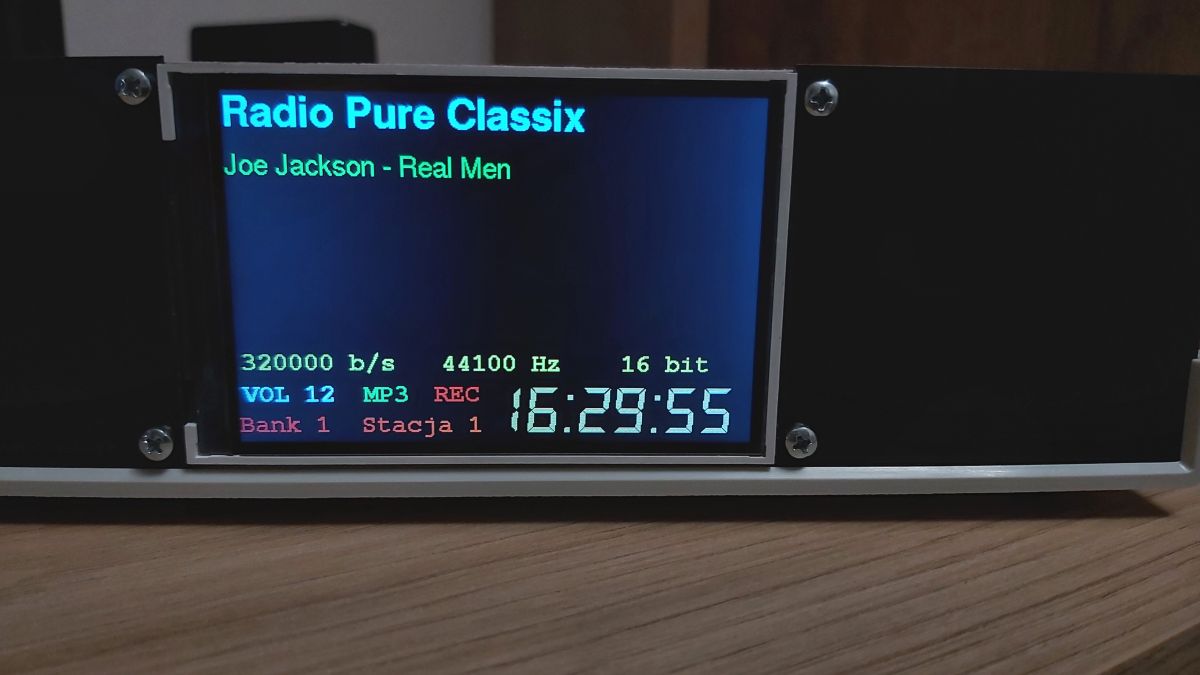

    ESP32 device screen displaying information about a recorded MP3 file.
    ESP32 screen displaying radio stream info and active MP3 recording indicator
    Screenshot of Arduino IDE showing logs from ESP32 recording an MP3 stream
    Screenshot of Arduino IDE showing ESP32 logging MP3 recording and playback process.

    @MAJSTER XXL I recommend swapping the audio library to 3.4.3 (it's as src, it's not in the official release) only you have to manually change its revision in the library description (it's still 3.4.2) and DEFINITELY delete the pre-compiled files in the arduino in the temporary sketch and core folder otherwise the compiler won't notice the swap. Version 3.4.2 has a lot of bugs, problems with FLAC files.
    By changing Core ESP to 3.3.3 do you play the FLAC stations correctly ?
  • Suggesting FLAC decoder file swap for bitrate issues
    #1581 21753631
    MAJSTER XXL
    Posts: 2064
    Help: 164
    Rate: 429
    @robgold those stations that worked well in flac from the beginning of my project do work and now work well, i.e. Radio Paradise and its other channels, Dance Wave, Dance Wave Retro and probably a few more, the vast majority of them croak as we wrote. The important thing is that the flac player has been doing well overall since the beginning of my project - only the bitrates need to be improved, as it sometimes shows silly things.
    but isn't it enough to swap these files from the flac decoder?
    Project view of ESP32-audioI2S showing flac_decoder folder and version tag 3.4.3

    I am trying to compile the ESP32_radio_v3_ILI9488_canvas MAJSTRA file under the ILI9488 display, but I am getting an error that the value should not be constant.
    128 | unsigned long DISPLAY_TIMEOUT = 12000; // Idle time after which the prprogram returns to displaying the radio or playing file
    92 | extern const unsigned long DISPLAY_TIMEOUT;
    C:³³³³³³³³DocumentsArduino³ESP32_radio_v3_ILI9488_canvas³ESP32_radio_v3_ILI9488_canvas.ino:2550:23: error: assignment of read-only variable 'DISPLAY_TIMEOUT'
    2550 | DISPLAY_TIMEOUT = 20000;
    C:C:³³³³³³³³DocumentsArduino³ESP32_radio_v3_ILI9488_canvas³ESP32_radio_v3_ILI9488_canvas.ino:3503:21: error: assignment of read-only variable 'DISPLAY_TIMEOUT'
    3503 | DISPLAY_TIMEOUT = 12000;
    exit status 1
    Compilation error: conflicting declaration 'long unsigned int DISPLAY_TIMEOUT'
    What could this be from? Because I don't think it's a bug in the code?

    in the .ino file is to be:
    Code: C / C++
    in FilePlayer.h file should be:
    Code: C / C++

    DJCheester
    Level 28  
    Posts: 2089
    Help: 75
    Rate: 958
    bolszoy wrote:
    Thanks but it didn't help. I downloaded a new ini file from github, and filePlayer.h. Still the same error I don't understand. I intentionally changed from 20000 to 12000 in the linetype, but now it is as designed.
    C:³³³³³³³³DocumentsArduino³ESP32_radio_v3_ILI9488_canvas.ino³ESP32_radio_v3_ILI9488_canvas.ino:128:15: error: conflicting declaration 'long unsigned int DISPLAY_TIMEOUT'
    128 | unsigned long DISPLAY_TIMEOUT = 12000; // Idle time, after which the prprogram returns to displaying the radio or playing a file
    C:³³³³BolszoyDocumentsArduinoESP32_radio_v3_ILI9488_canvas.inoESP32_radio_v3_ILI9488_canvas.ino:2534:23: error: assignment of read-only variable 'DISPLAY_TIMEOUT'
    2534 | DISPLAY_TIMEOUT = 12000;
    C:³³³³DocumentsArduinoESP32_radio_v3_ILI9488_canvas.inoESP32_radio_v3_ILI9488_canvas.ino:3321:21: error: assignment of read-only variable 'DISPLAY_TIMEOUT'
    3321 | DISPLAY_TIMEOUT = 12000;
    exit status 1
    I found the reason, the new version is already compiling, I have just uploaded and am testing.
    Screenshot of Arduino IDE showing selected code section and successful upload output
    You have to change here as in the screenshot.
    I still changed 20000 to 12000 in the main file but this is unlikely to affect correct operation.
