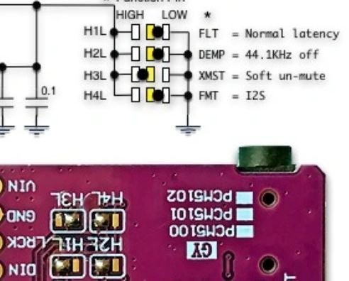

    I made the cables myself, permanently soldered in the PCM and ESP
    I had the jumpers soldered like this
    Image of a PCB fragment with soldered components and a connection diagram. .
    I connected the SCK jumper, disconnected it, gave SCK to GND, tried it, but no effect.

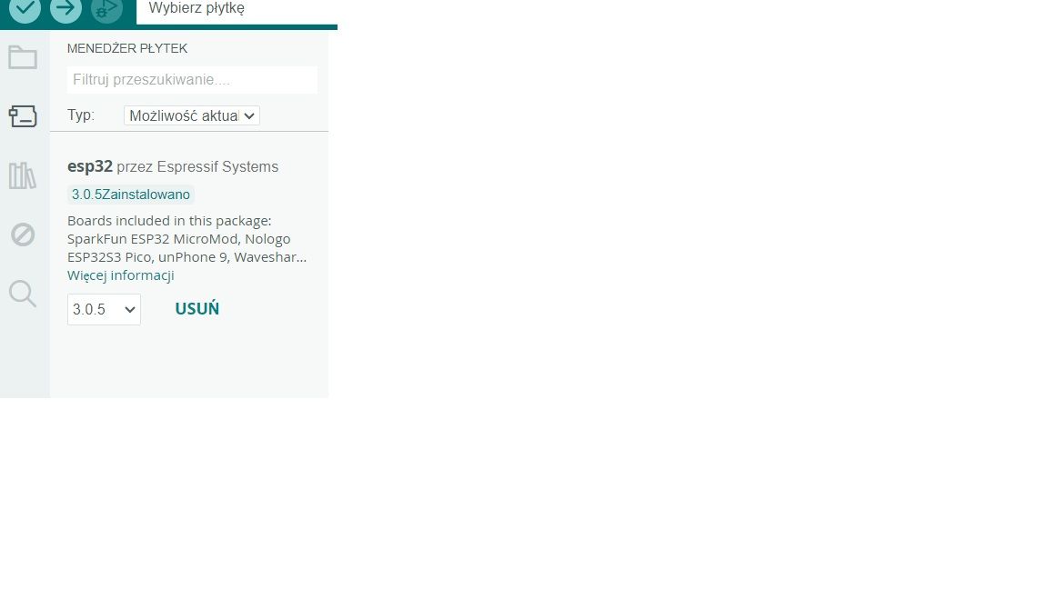

    I don't mean the board version but the esp32 boards version
    Screenshot of the board manager showing esp32 version 3.0.5 installed. .

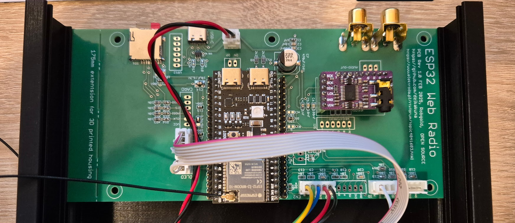

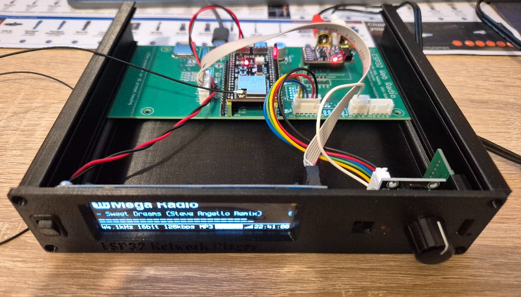

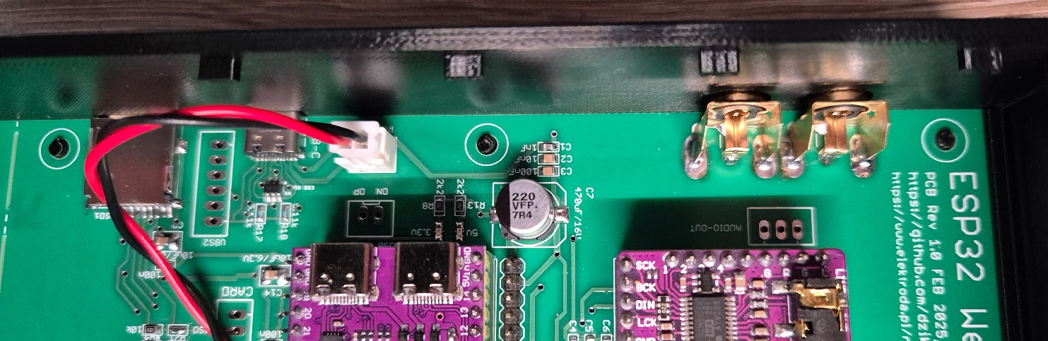

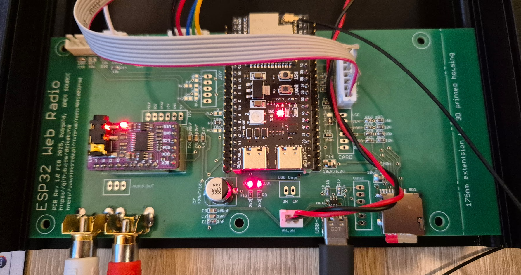

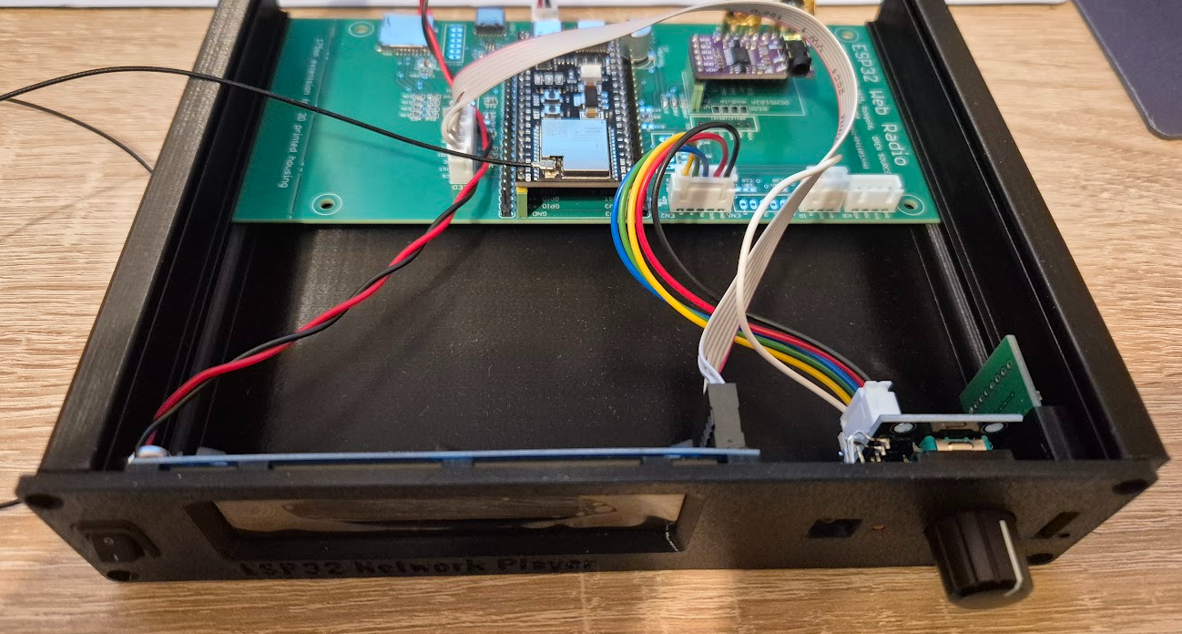

    I put the PCB together today. For a prototype, I'm pleasantly surprised. Everything I designed worked. USB works, SD card works. It "stood up" from the first switch on :) The whole thing fits elegantly into the printed case. I am therefore pleased to announce that the Eagle files as well as the Gerbery are tested and if anyone wants to, they can use and order "blind".
    View of the interior of a prototype device with a mounted PCB and wiring inside a case. .
    PCB with ESP32 and audio components for internet radio. .
    Prototype electronic device with an open case displaying mounted PCB, display, and connectors. .
    Close-up of an ESP32 Web Radio PCB with connected wires and components. .
    @gabar5 I see you are going for a similar solution with the Sony tuner I have prepared. Which tuner are you converting ?

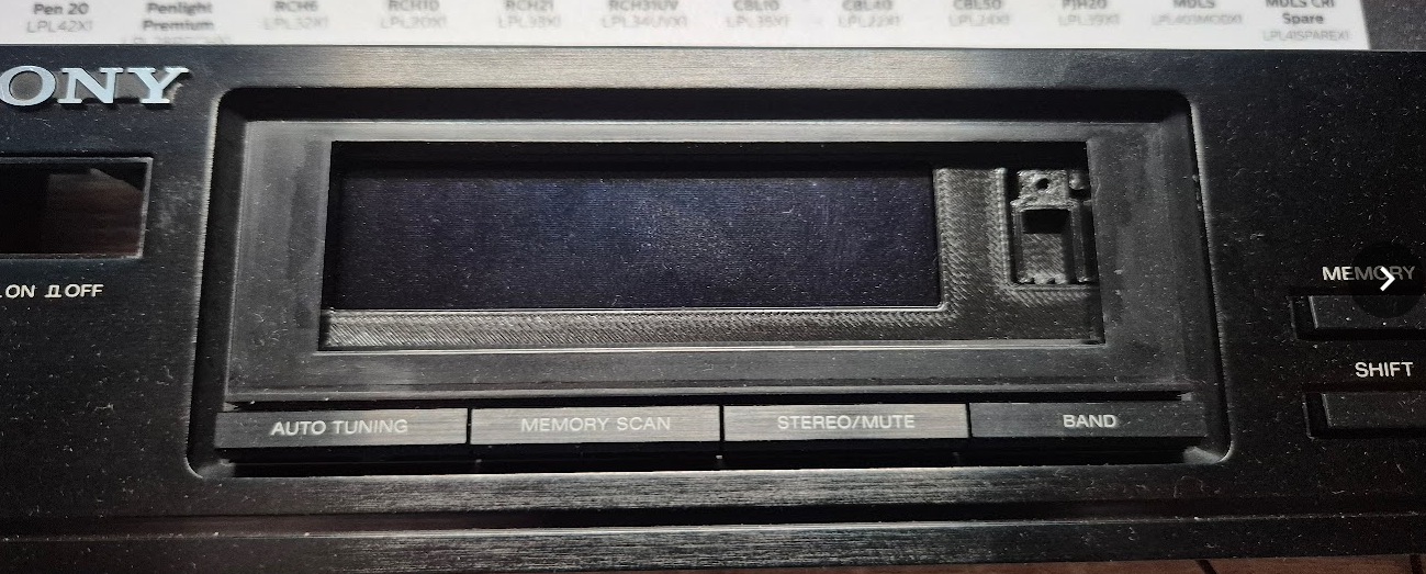

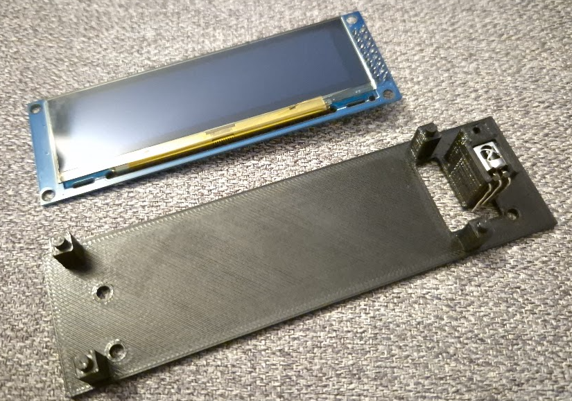

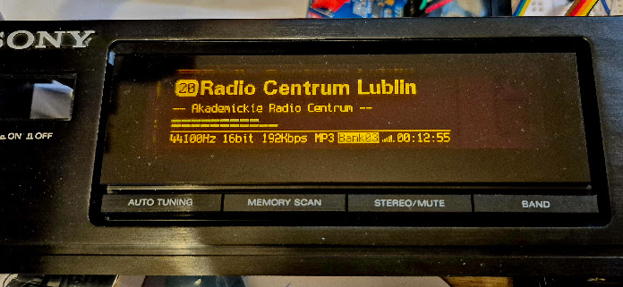

    @gabar5 take a peek at me on GitHub. Link Here you have the finished files of the frame for the display (mounting in place of the original) plus the front cap. The front cover/frame is designed in such a way that it "slips" into the housing, covering up the superfluous part of the OLED. Virtually anything can be used there - power supply, keyboard. A very nice conversion tuner.
    In TME there is an encoder with a long axle Link , which fits this tuner perfectly instead of the original switch/buttons from changing stations to this big knob. The board I've shown has leads for the keypad. In my case, I am just operating the keyboard in the ST-S120 conversion.
    Sony radio panel with OLED display showing Radio Centrum Lublin station. .
    Front panel of a Sony radio tuner with a screen cover. .
    OLED display and plastic frame .
  • #947 21480192

    The culprit turned out to be, as you wrote, the ESP32 version, after uploading 3.0.5 the sound was found.
    @robgold thanks for the link, I managed to print the frame myself beforehand, not so professional but does the job. I left the encoder short, but made up a distance so that. the knob does not go too far and rub. I abandoned the idea behind the original power supply, brought out a 5.5x2.1 connector and a USB socket for power. I connected the RCAs to the PCM. I didn't move the buttons, as I'll mainly be controlling with the remote, if I'll be changing anything at all apart from switching on :) .

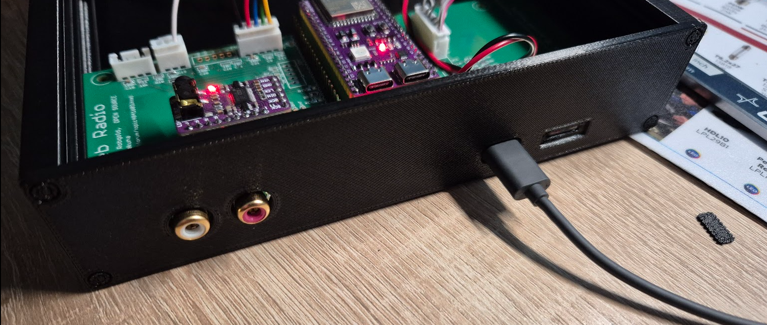

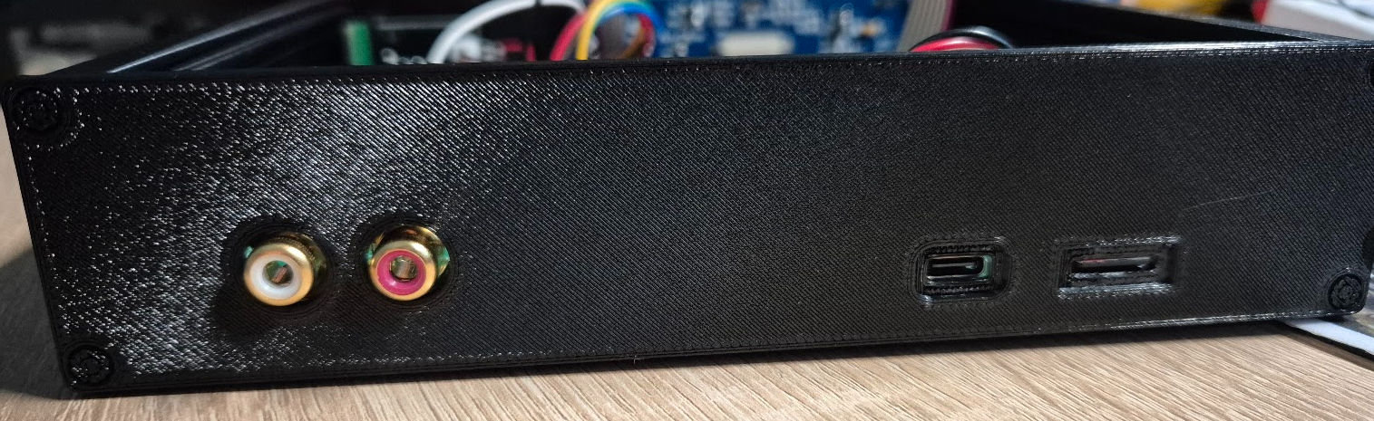

    I have finished the rear part of the case in the printed variant. I eliminated all screws, made the studs to match the holes in the PCB. This eliminates the need for threaded knurled bushings which cuts costs. The built-in micro-SD card slot on the PCB also seems to be a better solution as it is cheaper and in the case of the radio, it is reached in emergency situations. The whole thing looks like this:
    Back of radio casing with ports and PCB with connected cables. .
    Close-up of a PCB with electronic components and wires. .
    Rear panel of a black, printed case with antenna sockets and USB ports. .
    A set of files to print your own radio case can be found on GitHub -> Link .
    And if anyone would like to modify something, I have also uploaded the SKP (Sketch Up) files

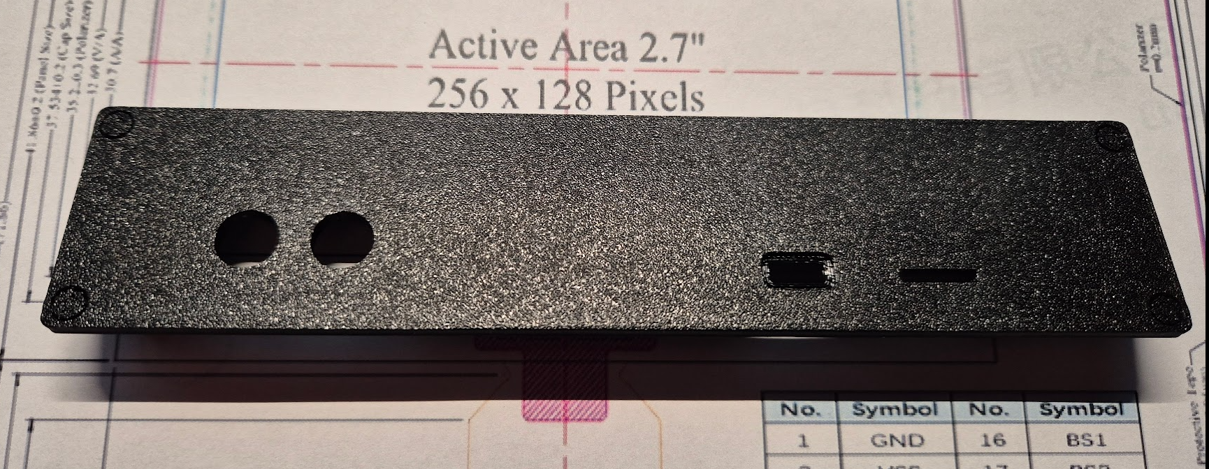

    @gabar5 What do you mean "rotated 180 st" and why ? You may not be able to see it in the photo because the light came in that way, but I need to print with the flat part on the table because I have a textured board and I care about it. I know that this way the PCB mounts are printed in the least durable way but they don't carry loads you don't know what.
    This is what it looks like ultimately:
    Black plastic cover with holes, lying on a sheet with a printed schematic. .

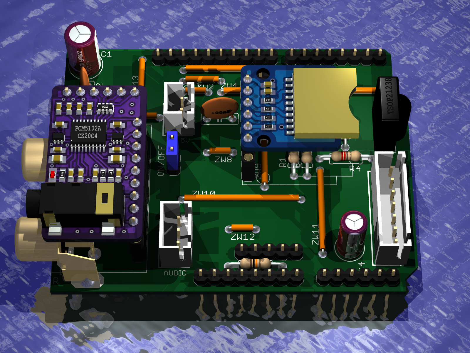

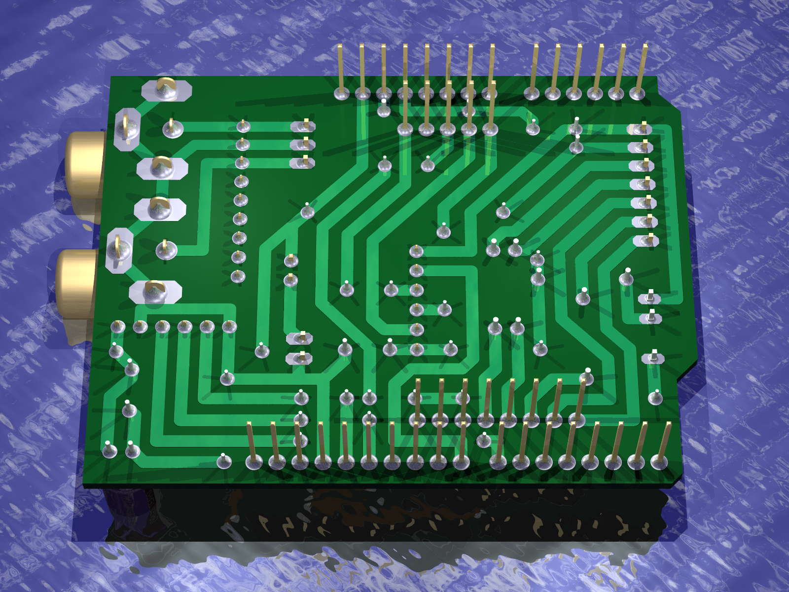

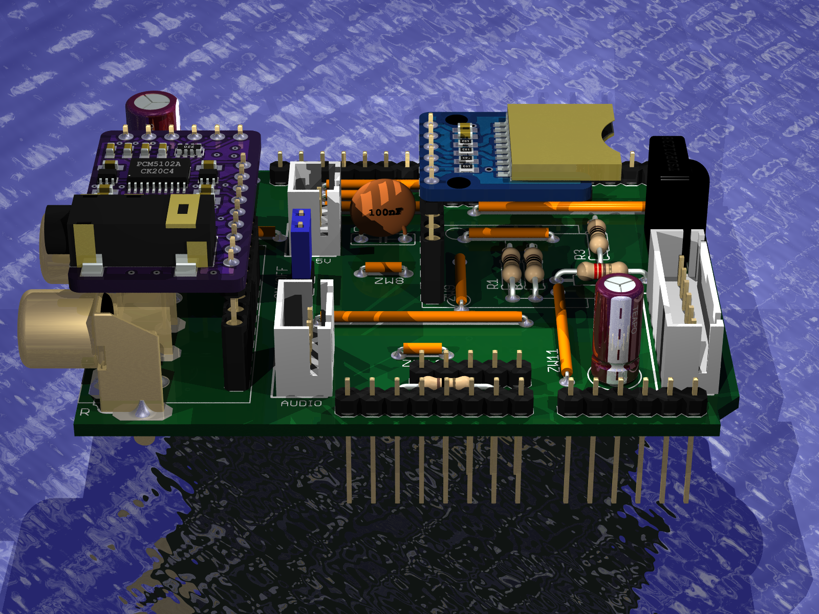

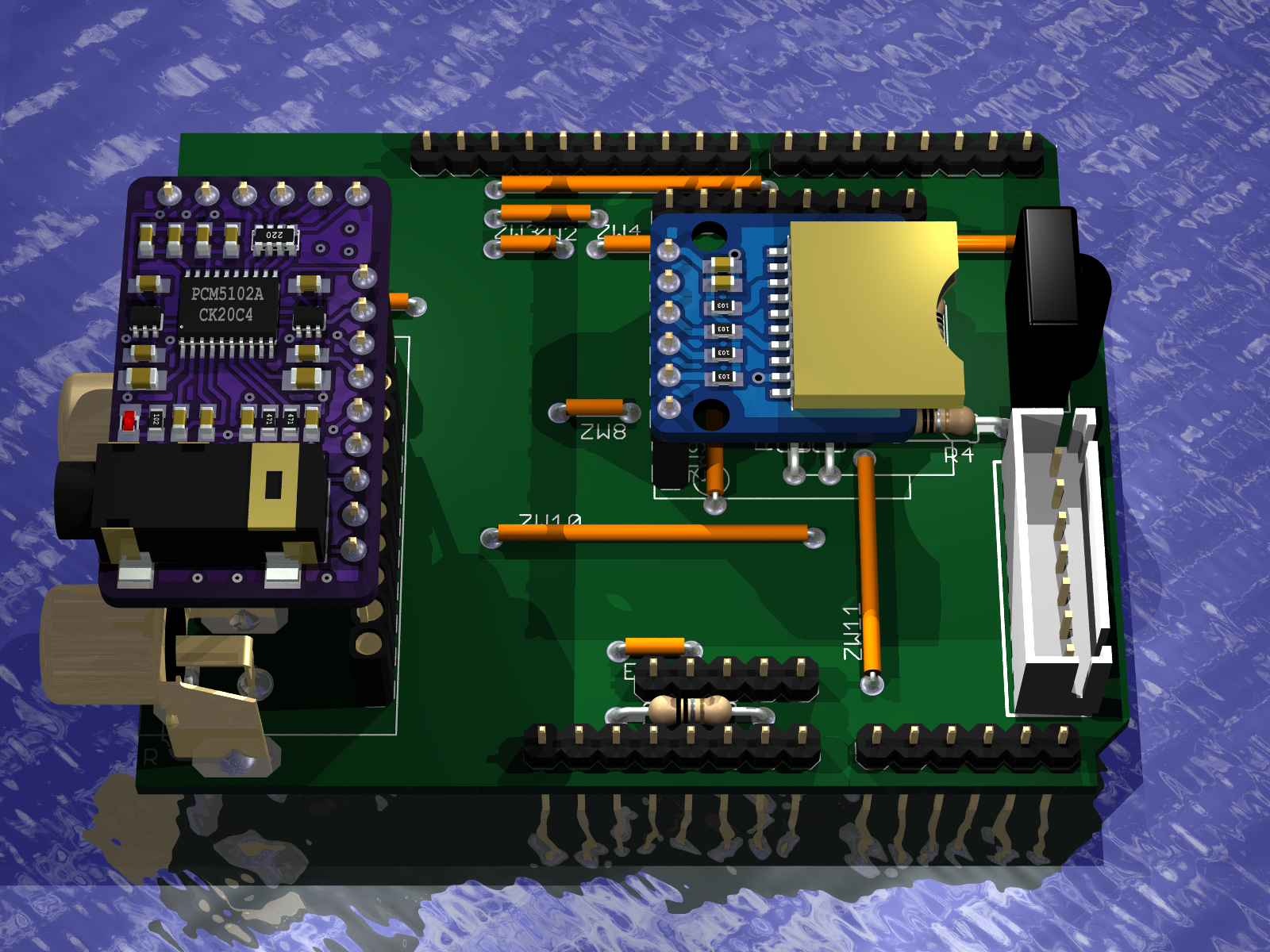

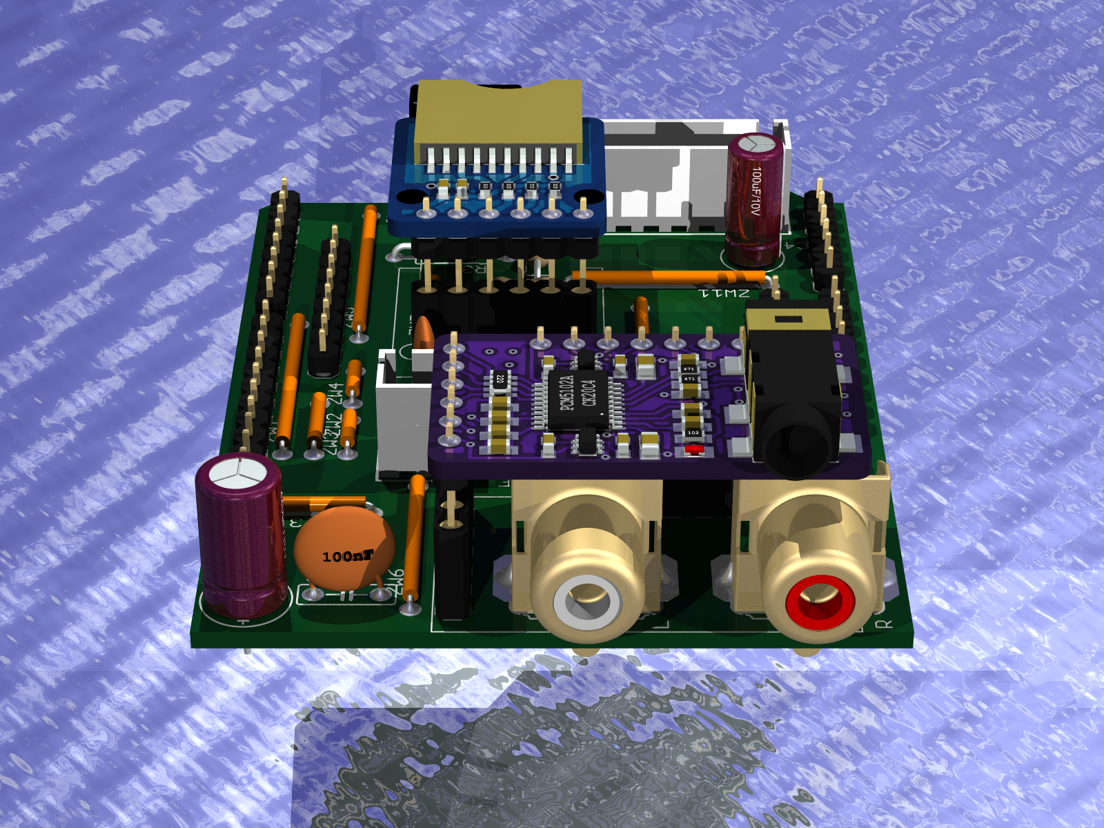

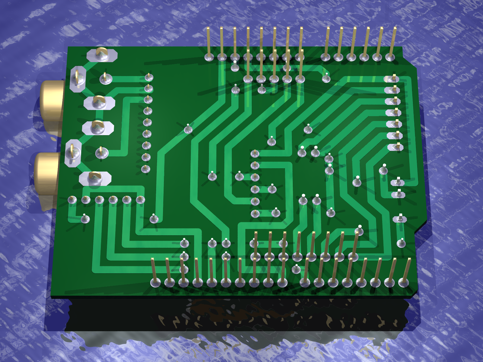

    Hello I have managed to design, in part, an overlay for the ESP32-S3-Uno which I bought and is on its way.
    Additional pads added - it remains a matter of accurate sizing as I sized these accurately based on the photo.
    Render of a PCB with various components, including an ESP32-S3-Uno module. .
    Visualization of a green printed circuit board with visible traces and gold pins.
    No encoder slot for the time being, I rather not envisage an encoder with me in this version, I don't have one fastened in the current version either, everything operates beautifully from the remote control.
    Also the PAM8403 power amplifier is missing there will only be a 3-pin(JST) and 2-pin(JST) audio lead for the PAM8403 module power supply - the module will be plugged in separately.
    As for the pins for OLED, SD and PCM, the ones declared in the software have been retained.
    This is the third version of the radio PCB ;) .
    When I refine it I will of course post it.
    Regards ...
