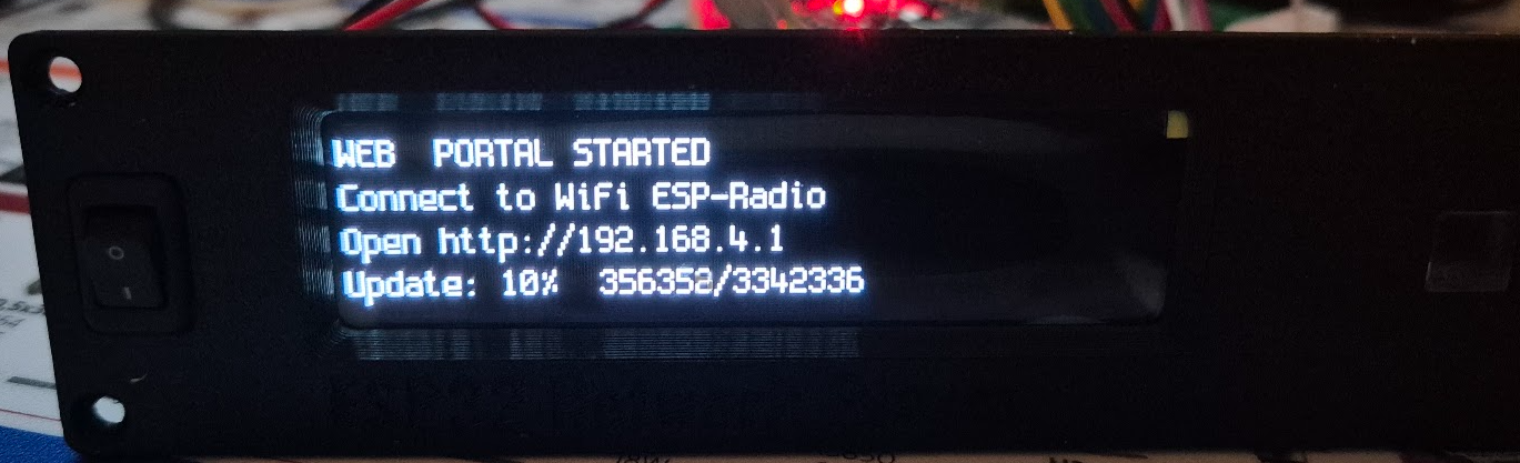

    I've uploaded the update to evo 3.16 on GitHub - Link
    - I've improved the encoder definitions - from now on they don't have to be disabled in the code if they are unconnected. We simply do not physically connect them
    - I have added options to the Recovery mode (enter by holding encoder 2 down and power on) to enable the WiFi Manager portal.
    Connecting to the wifi network: "ESP-radio" and going to 192.168.4.1, under the "Update" tab, we can upload updates without compiling code, running the Arduino. The progress of the update is shown on the OLED display. The bin file needed for the update is on GitHub.

    Recovery mode during OTA update via WiFi manager web page:
    Recovery mode during OTA update on an ESP radio's OLED display. .
