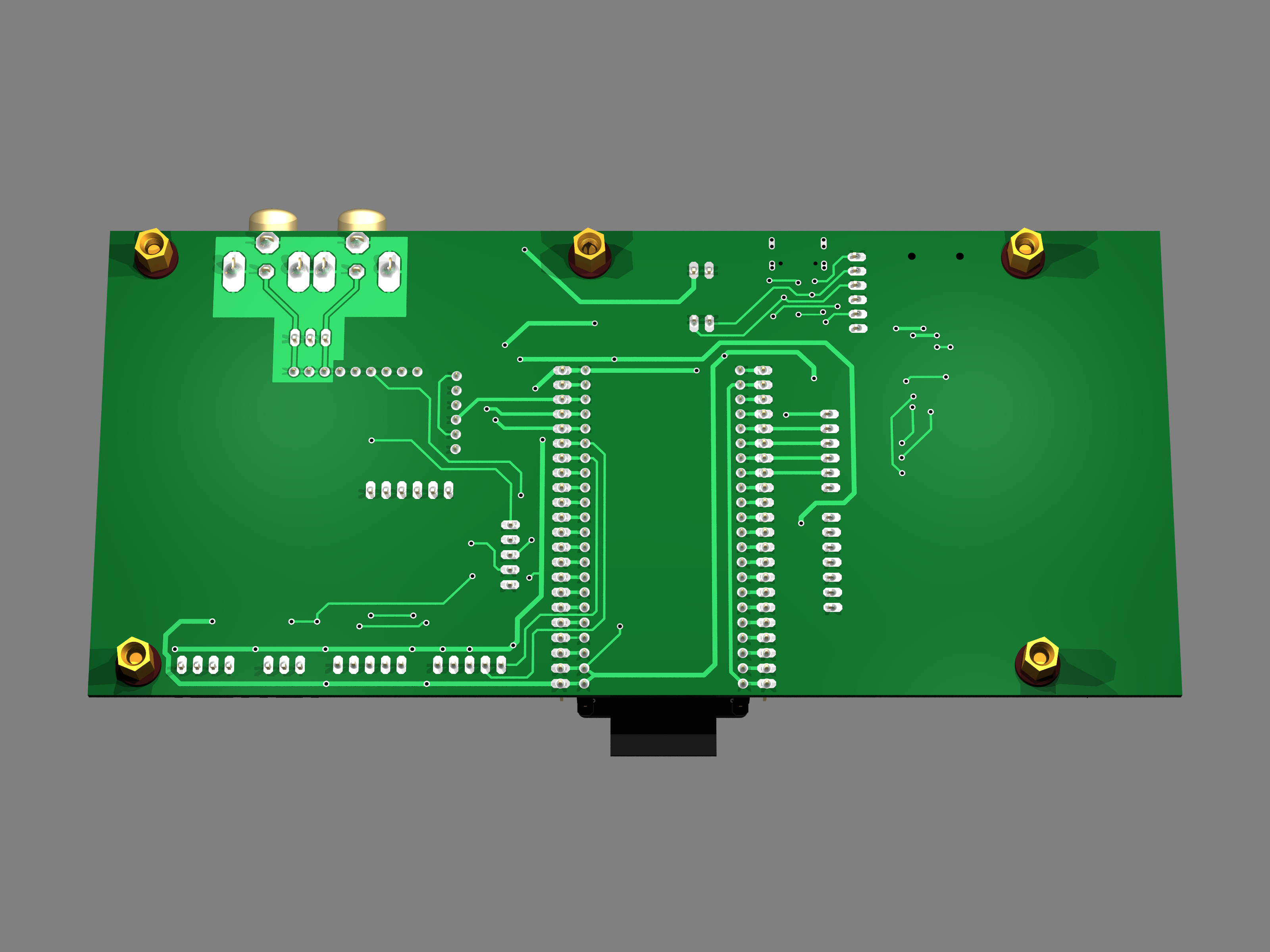

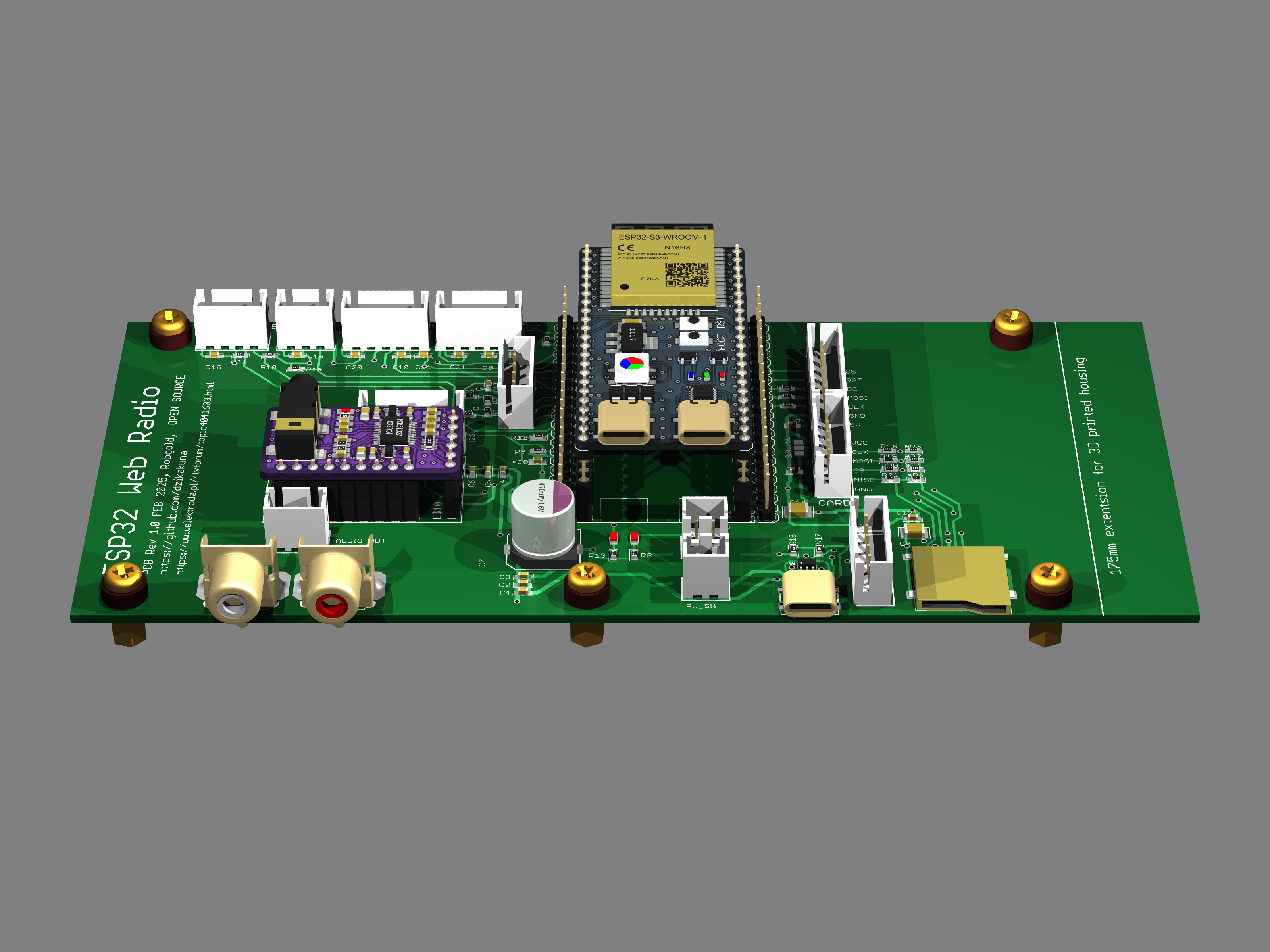

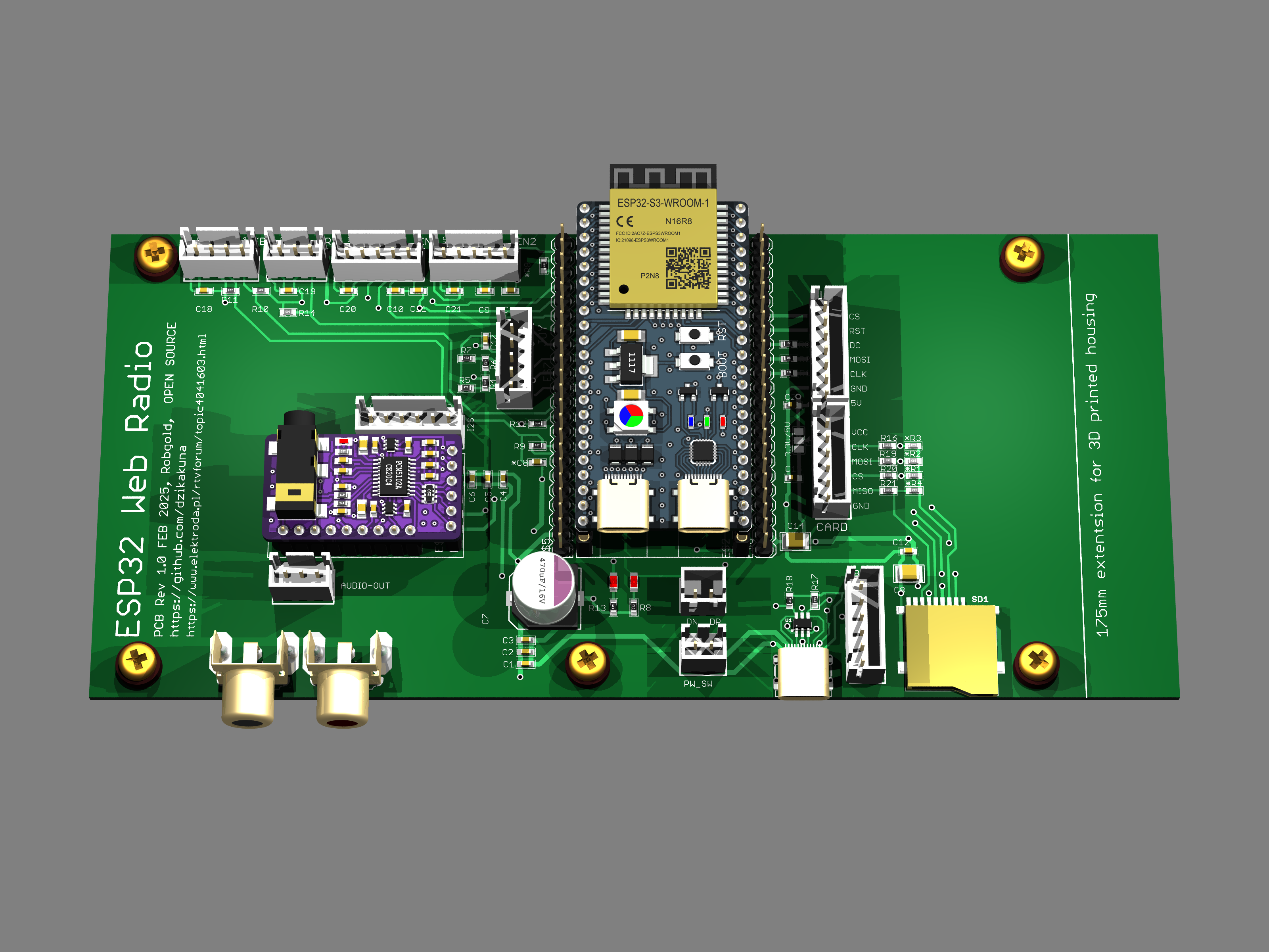

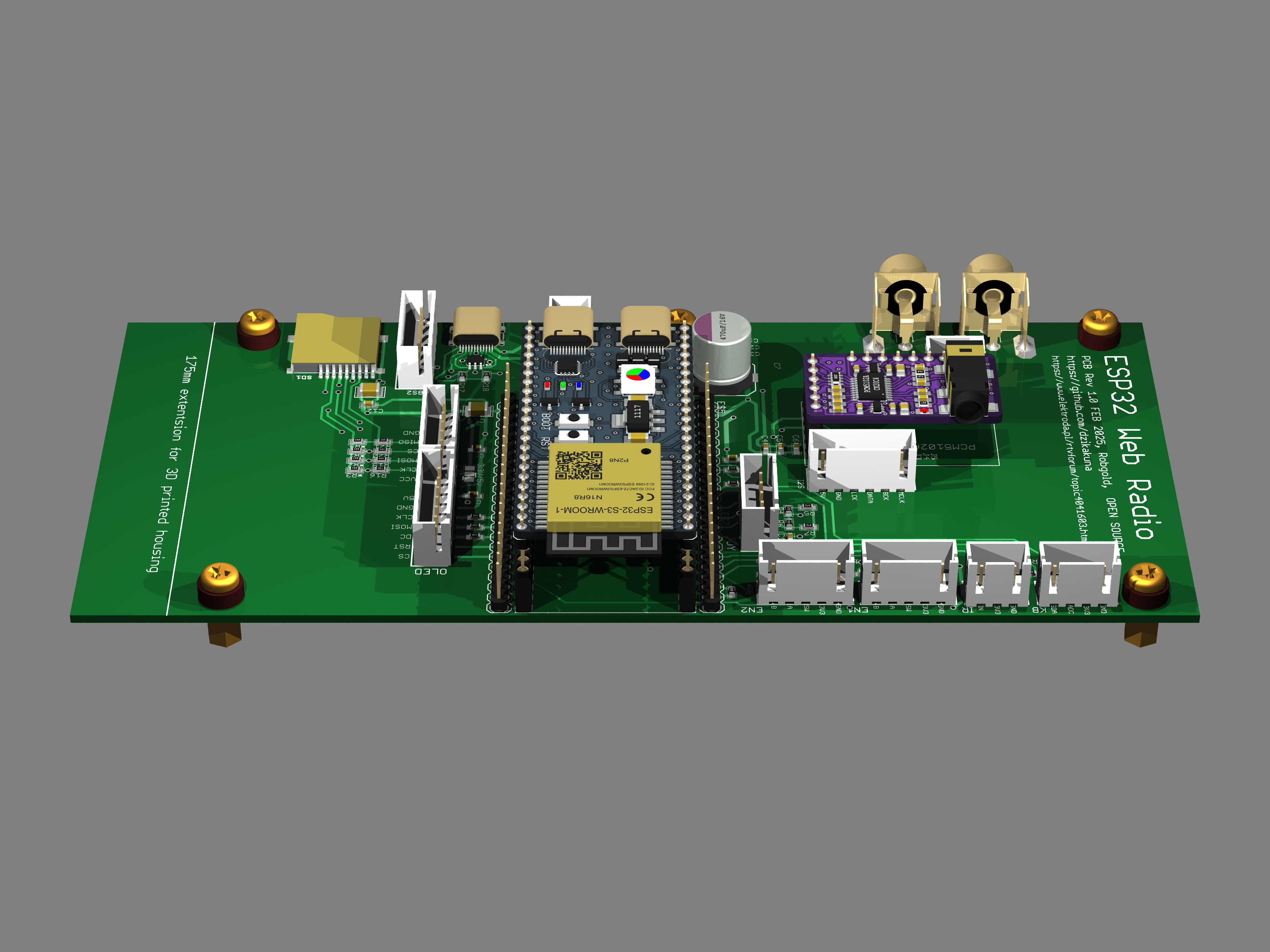

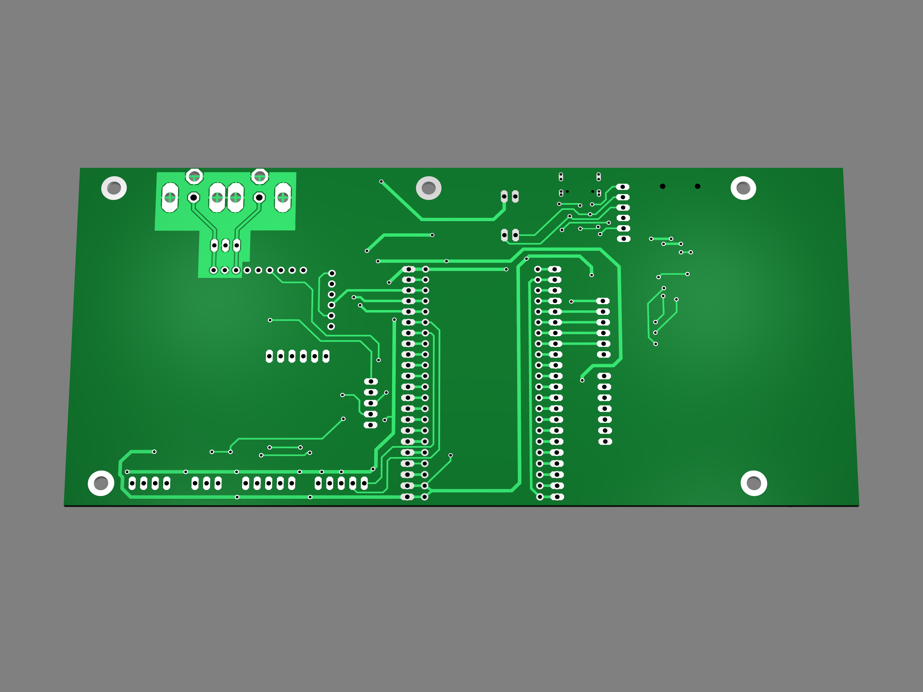

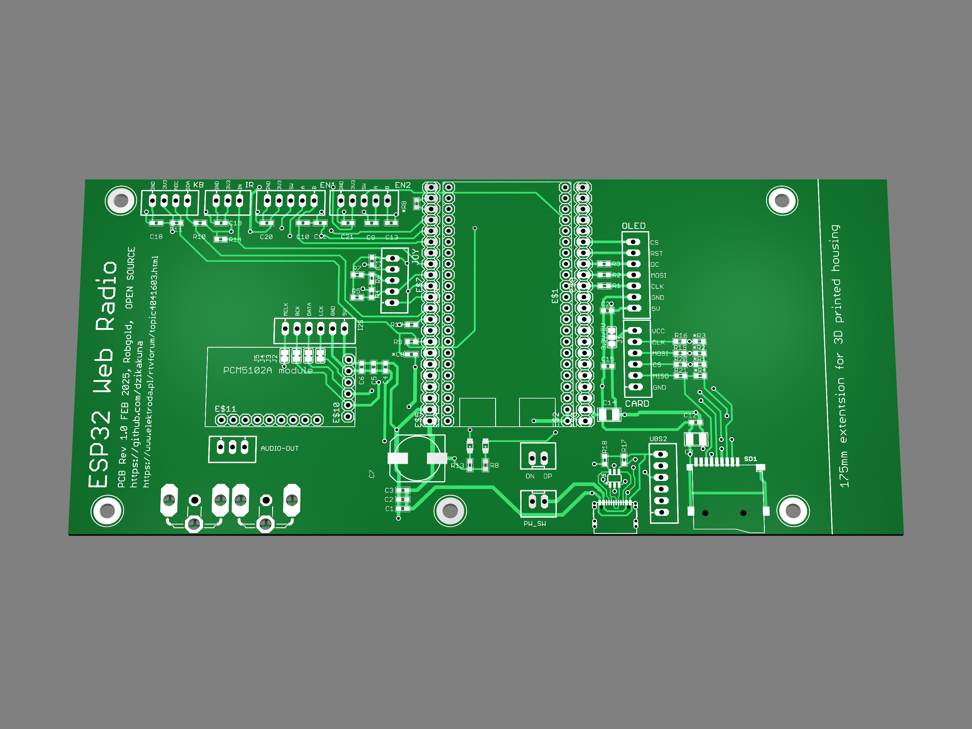

    Hello I am attaching the renderings of the latest version of the PCB by colleague Robgold.
    Render of an ESP32 Web Radio PCB with attached components. .
    Render of a printed circuit board (PCB) showing traces and soldering points. .
    Render of ESP32 Web Radio PCB with various components and connectors. .
    Render of ESP32 Web Radio PCB design .
    ESP32 Web Radio PCB render with component labels. .
    Render of a green PCB with a pattern of circuit traces. .
    Greetings ...

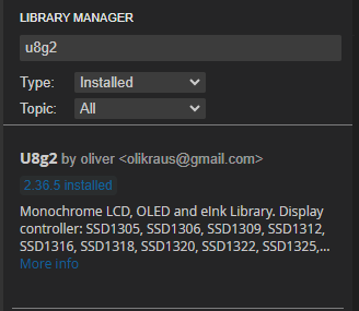

    What version of u8g2 do you have visible in the Arduino ? Have you uploaded the test 2.36.5 correctly with support for this display ?
    Screenshot of library manager with the U8g2 library highlighted in version 2.36.5. .

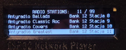

    @MAJSTER XXL at my place nothing like that happens. The stations run smoothly, robgold even turned on the vumeter on the FLAC stations and here there is not even any clipping.

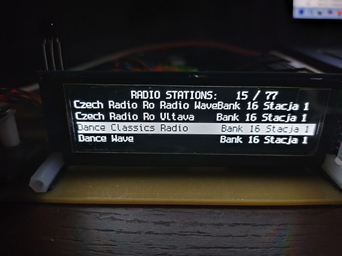

    @robgold I see one problem, exactly with banks 15 and 16. When I turn on the station list on these banks only the first digit of the station number is visible. With stations 1 to 9 it is known to be fine, but stations e.g. from number 11 to 19 have the number 1. I upload pictures to illustrate
    Display showing a list of radio stations with incorrectly displayed station numbers. .

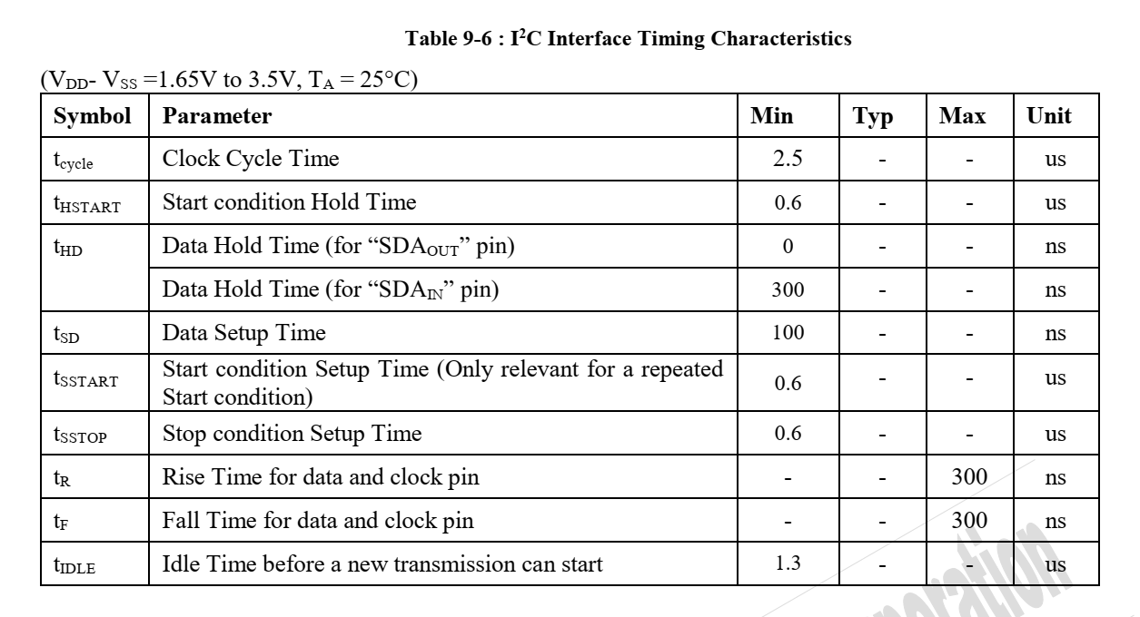

    Generally, I don't recommend the display on the I2C bus, it can't run faster than 400kHz, and that's not much compared to SPI, and somehow its brightness is not that impressive, probably also due to quite small pixels. I will still order the same one on SPI for a test, but I wouldn't expect any cool fluidity there, let's hope I'm wrong....

    @MAJSTER XXL I was just about to write if you set Wire.setClock(400000); and tried to crank it up to 1MHz Wire.setClock(1000000); but as I understand you already tried. I remember when I lowered the SPI to 500k it was terribly slow even loading the station was much slower because the progress bar had to be refreshed. My display has arrived at the airport in China and is awaiting transit so I assume it will arrive after the weekend.
    @hevet The problem has been since the bank update with banks >9 and stations >9, I misgenerated the files. I have discussed this with Majster before. Download yourself banks 10-16 again from GitHub -> i.e. do a "network update". It should be OK.

    I have just done an update and nothing changes.

    @hevet, are you sure you did the update from the web ? Do it again. Before I upload something to GitHub I test it at home. I don't want to write the classic "weird, it works for me" but that's exactly what it is :) .
    Display showing a list of radio stations.

    @robgold of course I tried, according to the manual the minimum clock cycle of the i2c bus is 2.5us, that is a setup for 400kHz, it looks like it doesn't accept more than that anyway, I'll check with the analyser later, because even setting it to 4MHz doesn't change anything, everything is muddled by this, the whole radio control operation....
    Table showing I²C interface timing parameters, including symbols, parameter names, minimum, typical, maximum values, and units. .

    @MAJSTER XXL, convert this display piece to SPI and problem solved. It's a shame to pay for another one and they are not cheap. Two thin wires nicely done and flooded with UV mask should not disturb your aesthetics.
    Added after 3 [minutes]: .
    And such another note have you tried "Wire.setClock( 400000UL); with that UL at the end (what Unisigned Long) because I don't know if the Arduino doesn't read it like an Integer and still sets you 100k by omitting that parameter.

    @robgold the problem only occurs on banks 15 and 16, the others from 1 to 14 are ok.

    Bank 15 is OK. In Bank 16, I changed the names a bit because unfortunately, when copying the names, characters outside the ASCII range were copied and it was a bit off. Check now.
  • #868 21469264
    hevet
    Posts: 346
    Rate: 47
    Board Language: polish
    @robgold It's fine now. Thanks :) .

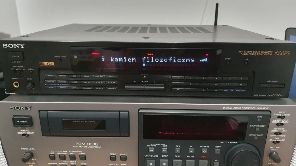

    Someone on the Sony forum showed off such a conversion, and I have to say it's impressive.
    Here is a description from the user
    "I would like to share my humble opinion after a week of using the Sony DAR1000ES SAT tuner modified for internet radio by Marcin Pakuła.
    The whole modification is based on the factory DAC installed in the sat tuner. The DAC is of very good quality so it was a shame to throw it away. Only the necessary modules are added. Everything nicely and neatly mounted, I would say better than factory 😃.
    It works stably, without lag, provided that you use the radio stations that transmit at a higher birate. I often get lag on black metal stations (approx. 60kbps - so not great).
    With stations from 128kbps and above I have not had any problems. Of course, everything also depends on the wifi range (the tuner is connected to the internet via wifi). The wifi range is visible on the front panel of the DAR1000. A larger antenna can be used, which is attached to the rear of the tuner.
    Control is by means of buttons on the front panel, the original RM-D1000 remote control, a universal remote control application on a phone/tablet, or an application written by Marcin especially for this purpose. In the application, we can search for stations, save them to our own list, which we can then modify and finally save in the tuner's memory and as a file (copy) on our computer. Marcin modifies the applications on the fly, if he notices that something works unstable/problematic. In general, we worked together on the app and everything that had any problems was fixed. All software is stable and works without any problems. Marcin Pakuła is a very nice man and patiently answers questions and guides you "by the hand" if someone has problems with the installation. The software in the tuner is written in such a way that it tells you on the screen what to do during installation.
    The stations have "rds" which means they display information about the current station and the currently playing song.
    This is my second DAR1000ES after modification. The first one is made into a spectrum analyser. The one with the internet radio tuner is a very interesting solution and I will say honestly that I am listening to the radio again 😃.
    About the modification itself. The DAR1000ES tuner of course you have to have your own. You send it to Martin and he takes care of the rest. All enquiries regarding price, deadlines and technical matters should be directed to Marcin.
    I for my part highly recommend Marcin himself as well as his modifications."

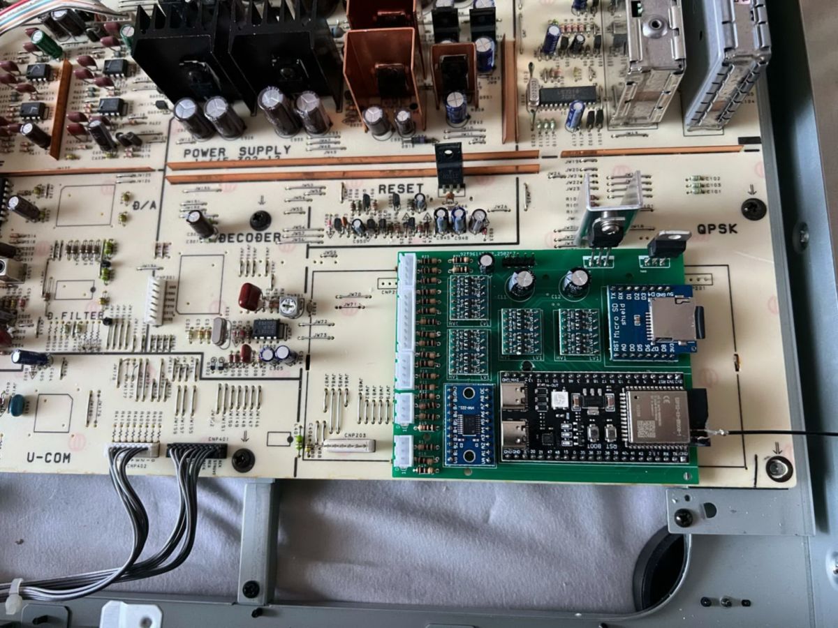

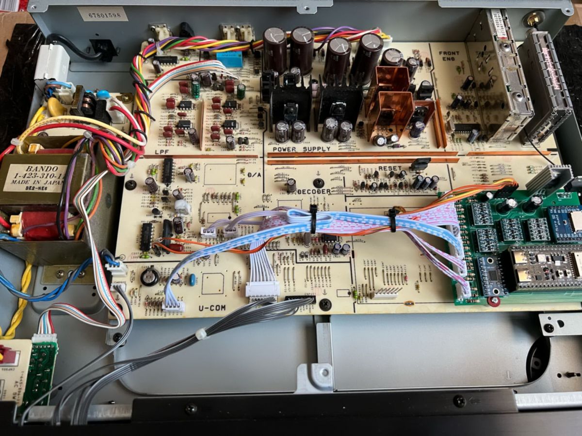

    Interior of a modified Sony DAR1000ES SAT tuner with additional modules. .
    Motherboard of the SAT tuner Sony DAR1000ES with an installed additional module. .
    Modified Sony DAR1000ES SAT tuner with a display showing text. .

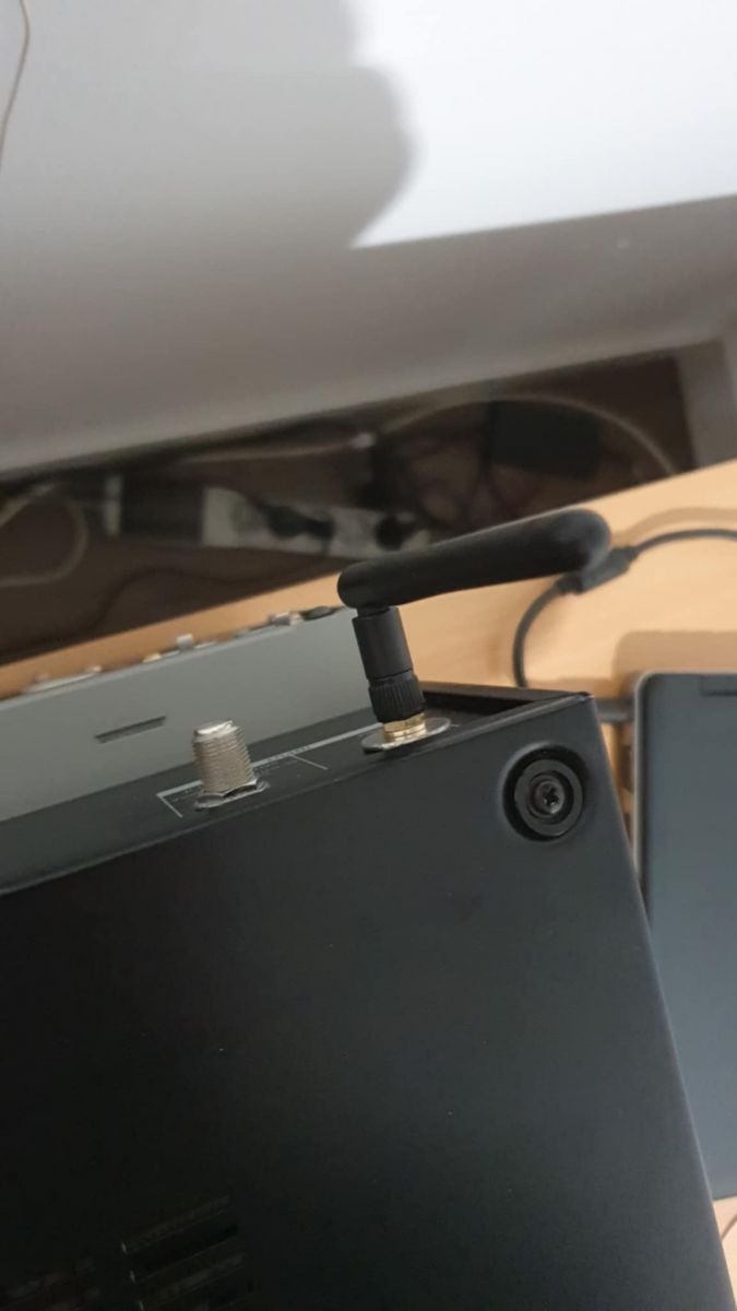

    Close-up of the rear section of a Sony DAR1000ES tuner with an additional WiFi antenna. .
    As far as I am concerned, a cool idea without "destroying" the original too much.
    It is known that we have the DAC at home, I am more concerned about using the original display :) .

    Latest version 3.15 - sometimes with screen cleaning there is rubbish. When I move the volume, returning the screen is OK. I get a lot less hangs. I have the impression that my display is not ok. With ESP32 yoradio works. On ESP32S3 yoradio doesn't work - effects like on Majster's old library. On the forum radio (ver. 3.14 or 15 in the screen rather works correctly.... unless it is the screen that causes such hangs, lack of refresh or pendency.
    I only have the 2nd encoder - the first one is defined by definition:
    // Encoder 1 - grounded for the player
    #define CLK_PIN1 -1 //6 // Connection from pin 6 to CLK on right encoder
    #define DT_PIN1 -1 //5 // Connection from pin 5 to DT on right encoder
    #define SW_PIN1 1 //4 // Connection from pin 4 to SW on right encoder (button)
    // encoder 2 - used for radio
    // swap pins for 2 for convenience as pins are next to each other
    #define CLK_PIN2 6 // Connection from pin 6 to CLK on right encoder
    #define DT_PIN2 5 // Connection from pin 5 to DT on right encoder
    #define SW_PIN2 4 // Connection from pin 4 to SW on a right-hand encoder (button)
    Station numbers on bank 16 I only have the tens digit visible. How does it connect from the network? Via WEB?
    Radio display with ESP32 player and electronic components. .
