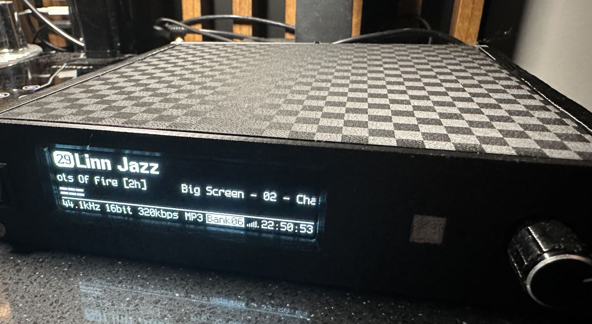

    After several hours of listening ... it only resets on FLACs for me.
    Jazz on 128 kbps in mp3 is unlistenable. It hurts my ears so much that I'm thinking how to set up my server with banks and get rid of these ear-crippling streams in my headphones. Is it enough to change the addresses locally stored on the SD card ?
    I close the case ;-) because there is nothing to bury anymore ;-) .
    Music player with a display showing Linn Jazz radio station. .

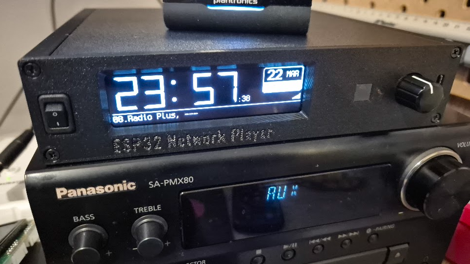

    Clock:
    Wollie's library doesn't allow you to mix audio from the stream along with telling the time. You have to turn one off and run the other. Even someone recently asked this question on GitHub -> Link . To make this cool you would have to slowly mute the audio, turn off the stream , read the time and turn on the stream. The problem is that often turning the stream back on will start playing ads. To think about.

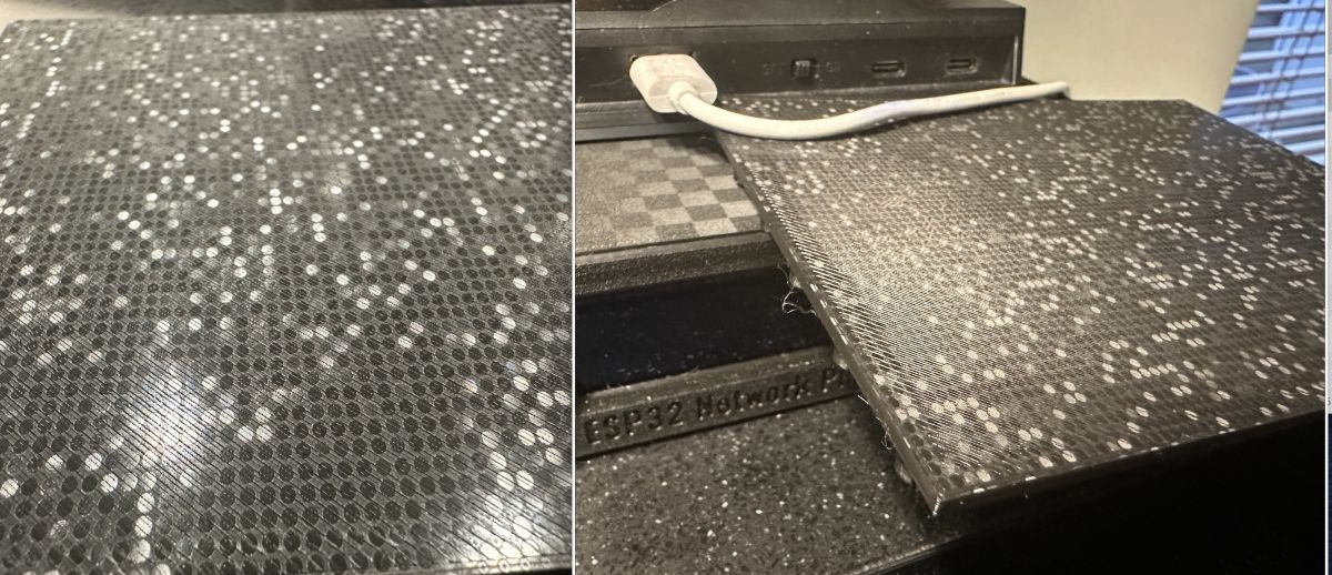

    Casing:
    Very nicely this top case came out of that 'carbon' board. Print yourself an IR window on a plain plate and cover with a piece of car window tinting film. It won't be visible. Did you print with PLA or PETG ?

    Homemade ESP32 music server displaying time and radio station. .

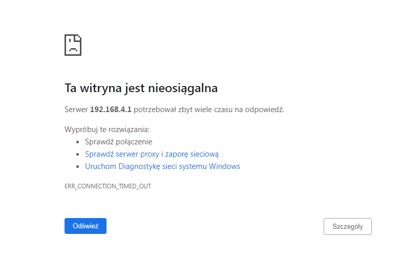

    Hello, I cannot get this web interface to work
    I have a hotspot from my phone and the radio is playing on it, I also connect with my computer under the same hotspot and type the radio page in the browser
    http://192.168.4.1/
    And I have only this, on the phone also only this and uploaded the soft yesterday
    Error message: This site is unreachable. The server 192.168.4.1 took too long to respond.
    What am I doing wrong, I would appreciate your help.

    You enter the IP address the radio has assigned to the hotspot.

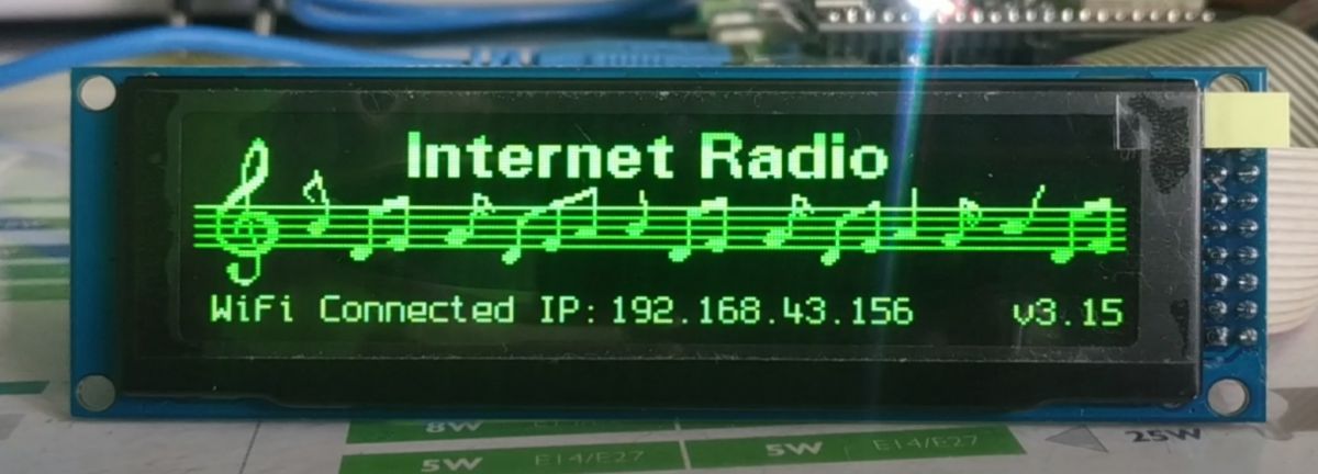

    During start-up, the IP number assigned from the network, hotspot or wifi to which we are connected appears under the notes for a moment (2sec). And this is the number to be entered into the browser.
    Internet radio screen displaying IP address and treble clef. .

    So you are talking about ?
    OLED display showing the text Internet Radio with connected WiFi and IP address and software version information. .
    Oh and the icon and radio graphics files should be directly on the sd, i.e. in the root directory ?

    Casing:
    Very nicely that top casing came out of that 'carbon' plate. Print yourself an IR window on a smooth plate and cover it with a piece of car window tinting film. It won't be visible. Did you print with PLA or PETG ?
    This is my first print on this board. Cool effect. Super quality and inexpensive (I got 35 zł for 256x256mm (another board already jumped in for 43 zł unfortunately) Housing - window of course from PETG clear as you recommended. The casing made of PETG without the raft and it peeled off due to shrinkage and one side came out messy. I didn't have black PLA at the time and will probably print again with PLA. The top is Sunlu PLA+ (it threads a bit). Everything fitted perfectly of course.... A lot of those auxiliary lines in sketchup but that made the effect great. Thanks

    A curiosity - a different plate for 3D printing. Smooth with texture.... The light and reflections shimmer like diamonds. Also a cool effect.
    3D printing plate with a smooth surface and texture. .
