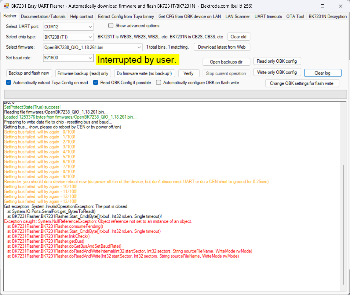

    Do the new BK7238 RTS/DTR reset really works for you guys? For me, it works only on 115200 baud.
  • #244 21839129
    Posts: 5153
    Help: 442
    Rate: 906
    only 115200 for me - v256
    otherwise it looks like it's starting but then doesn't. exception in image is me manually using stop button
    Screenshot of BK7231 Easy UART Flasher showing “Interrupted by user” and an error log
    Added after 3 [minutes]:

    ahhh... i see issue,... at least in my test code. Port had old baud value

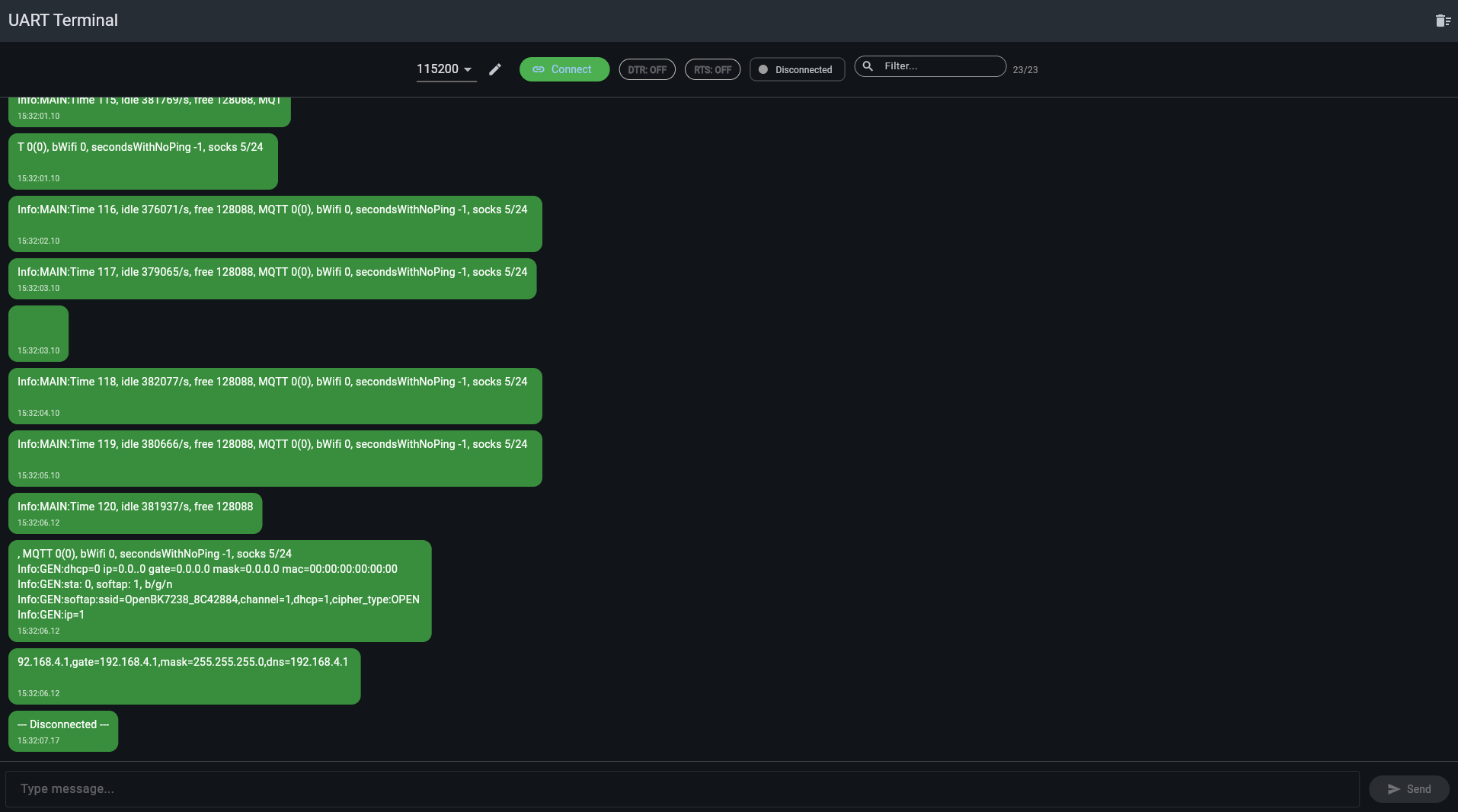

    UART proof of concept released:
    https://github.com/openshwprojects/OnlineSerialTerminal/
    Shall work on Android and on web and windows.
    This is ONLY TERMINAL, not a flasher.
  • #254 21839483
    Screenshot of UART Terminal with green log messages and “Disconnected” status

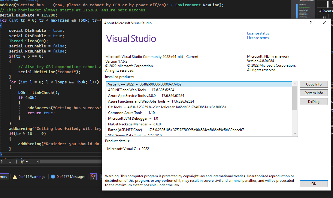

  • #258 21839588
    Posts: 14699
    Help: 656
    Rate: 12743
    Visual Studio or on GitHub:
    “About Microsoft Visual Studio” window showing installed products, with code editor in the background.

    Posts: 14699
    Help: 656
    Rate: 12743
    Why not Visual Studio? That way you'll also be able to debug.

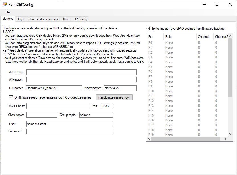

    Posts: 5153
    Help: 442
    Rate: 906
    just playing with _lv values and their potential inclusion in Easy Flasher config of OBK on extraction after original firmware backup (plus plain-text indicator), eg:
    Screenshot of BK7231 Easy UART Flasher showing JSON data and a GPIO pin configuration description.
    but I notice only after a REAL backup/extraction from device do we see the extractions show under the configuration form in main flasher tab
    FormOBKConfig window on Generic tab with Wi‑Fi and MQTT fields and a pin list table on the right
    so no visibility of OBK roles that will be assigned until you do it for real. is this correct? am I missing something obvious?
    Yes, you can copy json to one of the importer forms in web app or cloudcutter page, but then you're not using EF's logic.

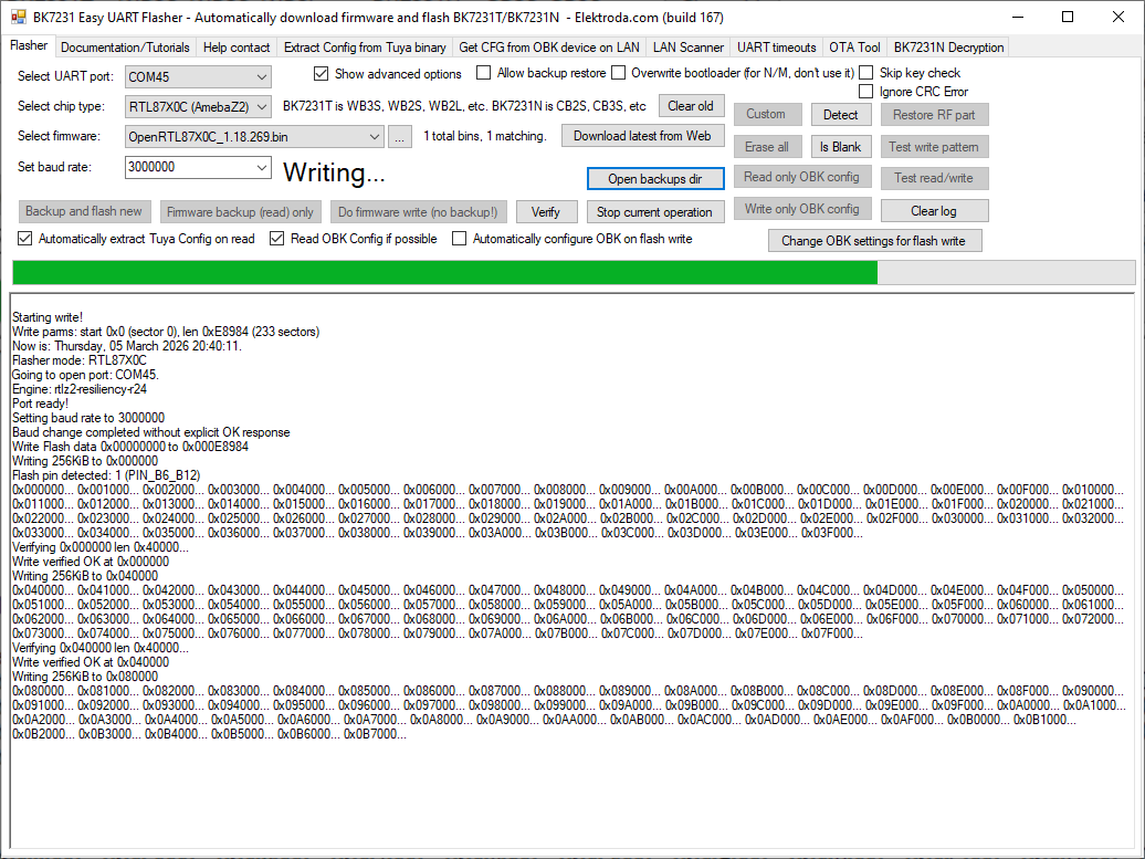

    - Per-window retry (3 attempts per 256KB window) — if the SHA256 of the whole window doesn't match after all chunks read, the entire window is re-read from scratch, with a re-link attempt between tries
    (two independent retry layers — a window can survive up to 3 chunk-level failures per chunk AND up to 3 full window re-reads if verification keeps failing)
    write retries:
    - Per-window retry (3 attempts per 256KB window) — if XMODEM transfer or post-write hash verify fails, the window is re-sent, with baud fallback to 115200 and re-link between attempts
    -Final full-image hash cross-check on completion
    -Baud fallback to 115200 on baud change failure
    -Hash polling uses 200ms slices so Stop button remains responsive
    -ChangeBaud rewritten with two-attempt handshake and verified OK response
    -Should cleanup com port/release buttons on all exit paths
    -Port open/close lifecycle made safe and idempotent
    -TryPingLink added with configurable retry count
    -RunWithRecovery / RunWithRecoveryBytes wrappers added — all major operations (hash read, flash transmit) retry with re-link on failure rather than giving up immediately
    -ReadTimeout stack introduced so nested operations can push/pop timeouts safely without leaving the port in an inconsistent state
    -MemoryBoot command table scan: null return from DumpBytes no longer throws silently — skips the entry and continues scanning
    -ReadFlashId: null return from DumpBytes now throws a clear exception rather than causing a NullReferenceException on the next line; calling code in doRead catches it cleanly with port close and error message
    -ChangeBaud failure in read and write: now closes the port before returning, preventing GUI lockup

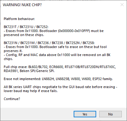

    -flash pin detection (A7_A12 or B6_B12)

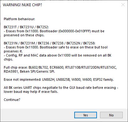

    -update erase all confirmation box text to make clear erase support on each platform
    -make erase all button and com port release after completion for all platforms

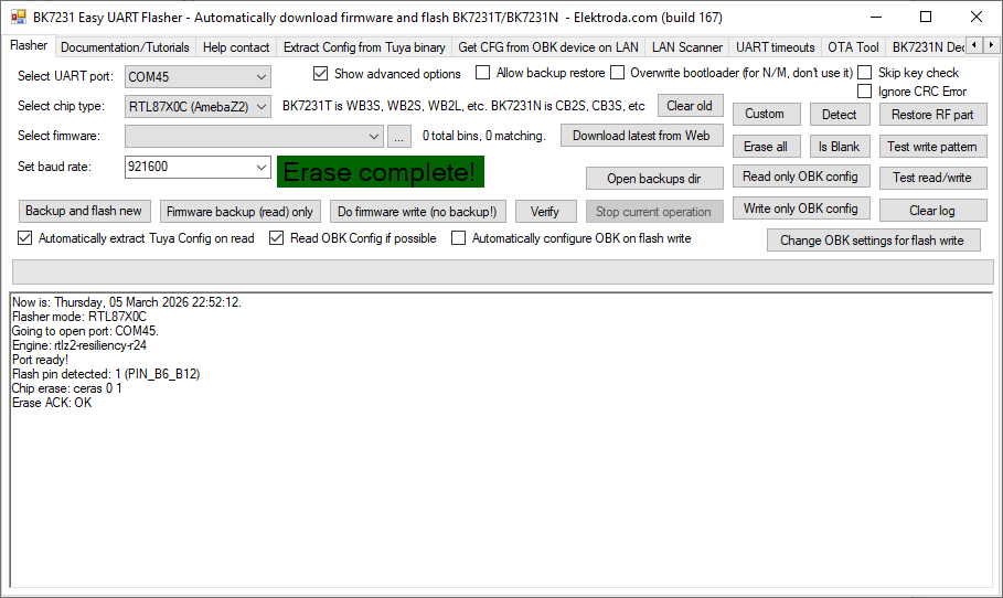

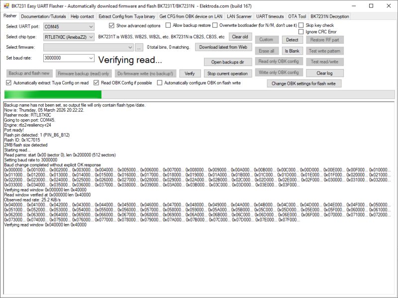

    Screenshot of BK7231 Easy UART Flasher showing “Verifying read...” and a flash read log.
    Screenshot of BK7231 Easy UART Flasher showing “Writing…”, a progress bar, and a scrolling write log
    Warning dialog “WARNING! NUKE CHIP?” listing platforms and effects of a full chip erase
    Screenshot of BK7231 Easy UART Flasher showing “Erase complete!” and an operation log
