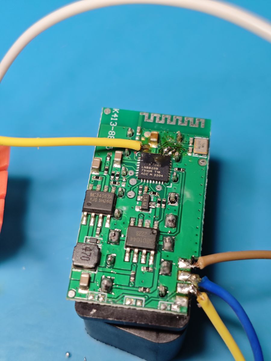

    Oh, so you have LN8825B? How much is LN8825B different from LN882H? Same SDK? Same binary? How are the protocols similar?
  • #182 21805393
    insmod
    Posts: 1432
    Help: 168
    Rate: 455
    Completely different. Except for bootrom protocol. And it's baud rate is 117000 (or close enough), not 115200.
    Ramcode was ported from LN882H, but there is a major bug with write.
    It writes ok, but hangs right before it receives EOT.
    ROM version is Jun 19 2019/21:01:04

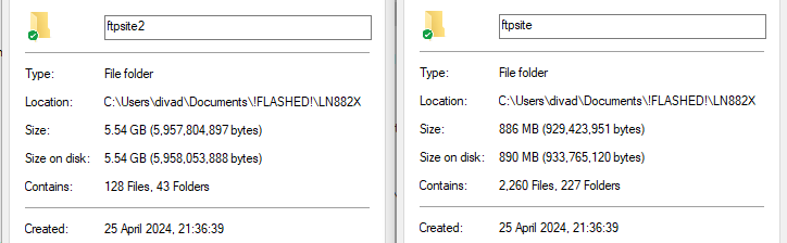

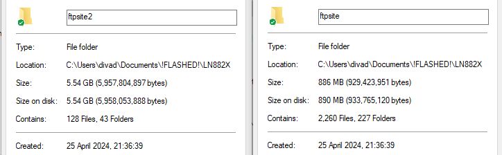

    There used to be 2 Lightning Semi FTP sites but they stopped working a while ago. I ripped everything off it a couple of years ago.
    also, source for boot rom?
    List of source and binary files in an SDK project folder on Windows
    I can stick the lot somewhere if you want it all.
    Folder properties comparison: ftpsite2 5.54 GB and ftpsite 886 MB

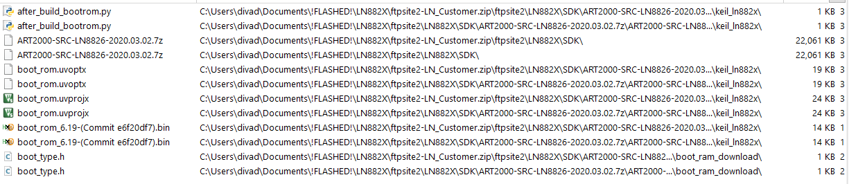

    There is actually a ramcode source code in one of those archives, good
    I probably won't use it...

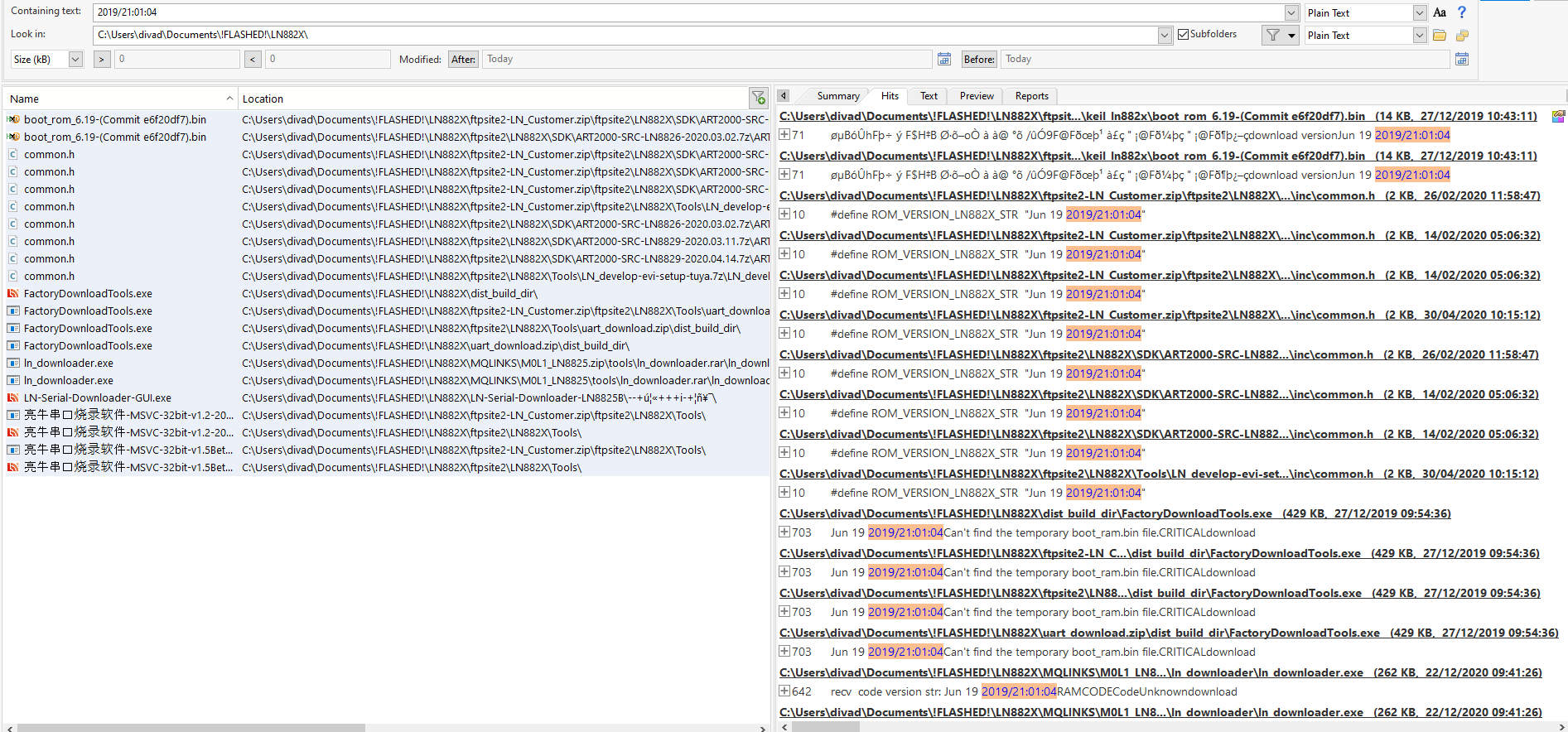

  • #188 21805863
    Posts: 5212
    Help: 446
    Rate: 914
    other sightings of that date/time
    Screenshot of file search tool results showing matches for the string “2019/21:01:04”
    LN882H and LN8825B flashing verified on CH9102, CH340C, FT232RL

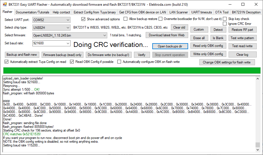

    #190 21806165
    Posts: 5212
    Help: 446
    Rate: 914
    LN882H - onboard WCH CH9102 no problems 5x write 5x read 921600.
    Electronic module with microcontroller and USB connector on test board
    Added after 4 [minutes]:
    also fine with my CH340C
    Added after 25 [minutes]:
    'FTDI' FT232RL works too 5x.
    A small thing. CRC matching message shows completion in log but GUI status doesn't go beyond "Doing CRC verification..." after writing
    BK7231 Easy UART Flasher interface flashing firmware to LN882H chip

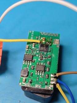

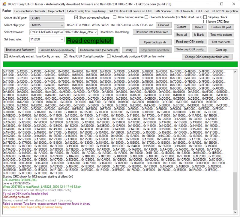

    Added after 11 [hours] 30 [minutes]:
    LN8825B success
    Screenshot of BK7231 Easy UART Flasher with Read complete! on green background
    Electronic module with LN882H chip and soldered wires on PCB
    Added after 3 [minutes]:
    just a few bytes difference to your dump

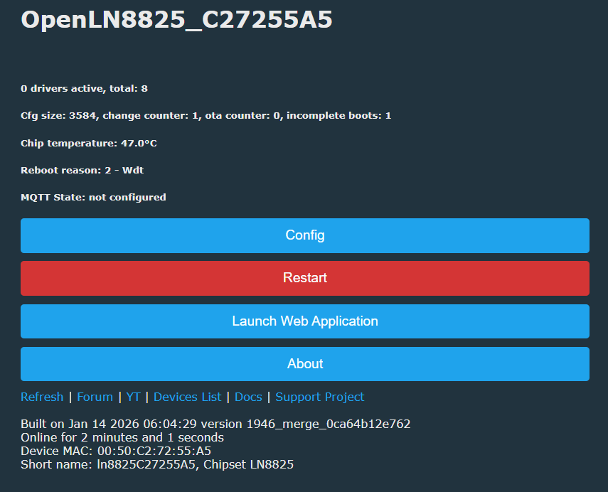

    I've written LN8825B OBK and the 2 Tuya flash backups a few times now and it's been OK. Also, the two Tuya backups boot and can be paired with app.
    OpenLN8825 device interface with system status and config/restart buttons

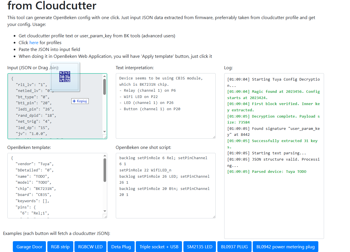

  • #208 21817855
    Posts: 14755
    Rate: 12881
    I've updated template parser here:
    https://openbekeniot.github.io/webapp/templateImporter.html
    It should be able now to parse drag and dropped 2MB Tuya file.
    Cloudcutter tool interface with JSON input, config interpretation, and logs
    Added after 10 [hours] 19 [minutes]:
    Next step: integrate into web app and then just read from OBK firmware itself at runtime?

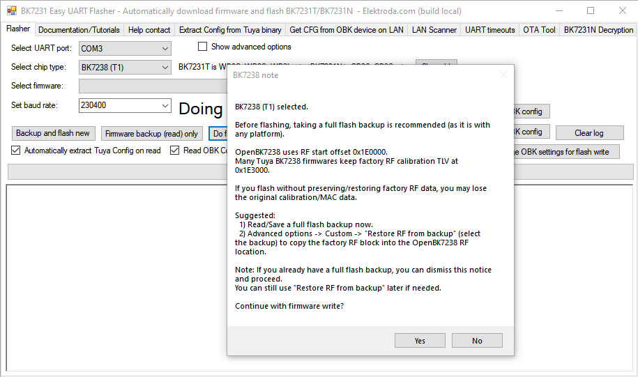

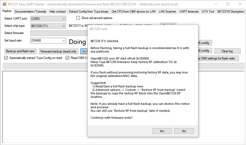

    BK7238 backup notice?
    BK7231 Easy UART Flasher window with RF backup warning message
    or maybe have it for any platform that supports RF restore, making special mention of BK7238 when shown?
  • #210 21821129
    DeDaMrAz
    Posts: 620
    Help: 34
    Rate: 130
    I got a simple question about this 7238 RF calibration "issue", why not make this automatically in the flash write process?
