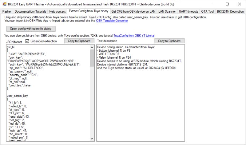

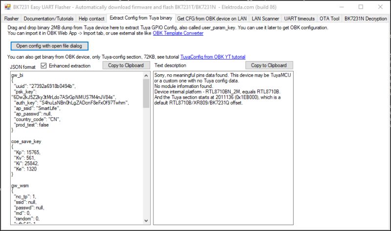

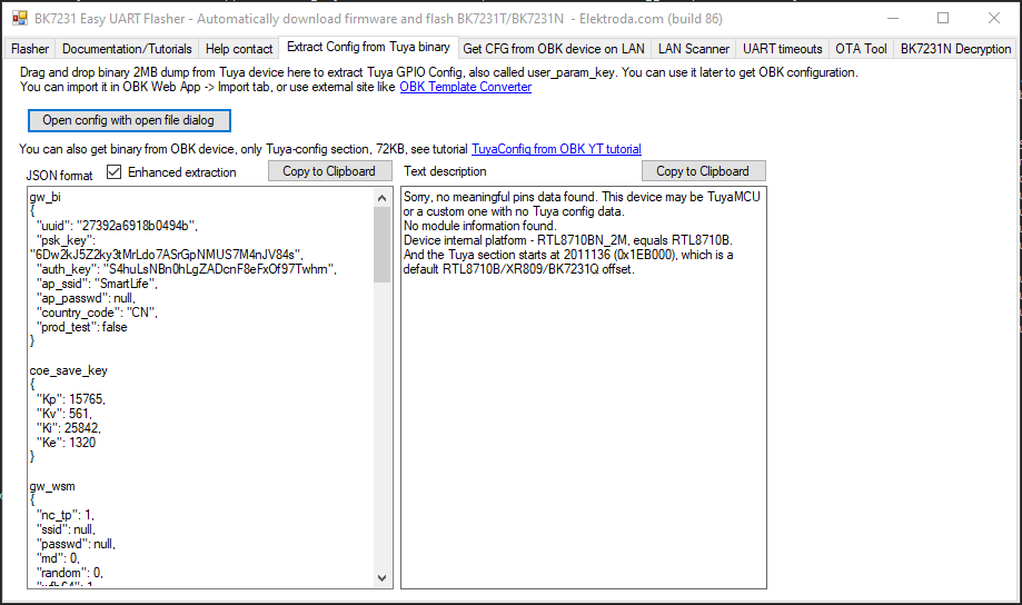

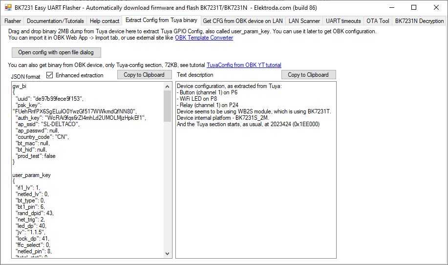

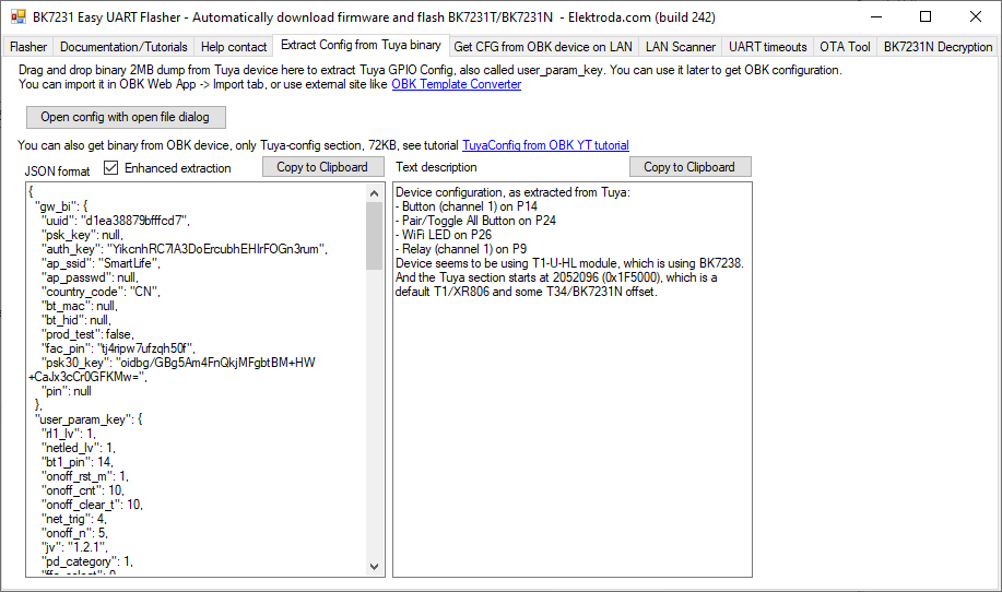

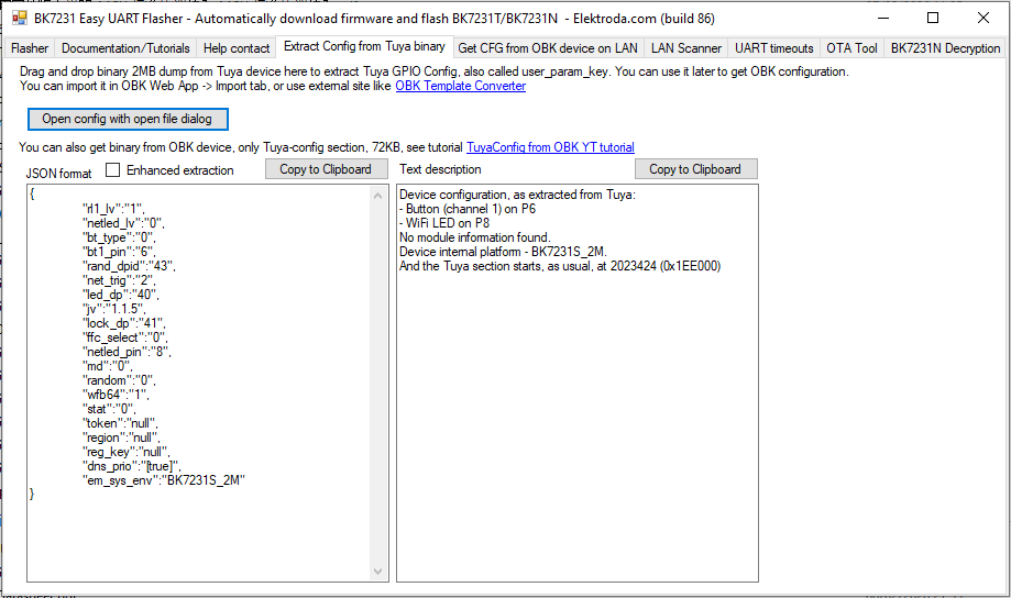

    OK. I hope this is a step forward. It took ages to get it right 😫
    Enhanced extraction toggle in Easy Flasher to pretty-json and present all decoded blocks in the Tuya KV.
    Screenshot of BK7231 Easy UART Flasher showing JSON configuration and a text description panel
    Works on all the encryption methods Easy Flasher now handles. Enhanced extraction box will also re-run the text description pipeline, when checked, so missing pin translations should appear. I attach two dumps where the traditional extraction did not catch all/any so you can see this in action.
    Screenshot of BK7231 Easy UART Flasher showing JSON output and a device configuration text description
    The traditional presentation layer has not been changed and I have tested the "automatically configure OBK on flash write" function still works, though it doesn't benefit from the enhanced extraction findings.
    more dump demos:
    Screenshot of BK7231 Easy UART Flasher showing Tuya JSON config on the left and a text description panel on the right
    https://github.com/openshwprojects/BK7231GUIFlashTool/pull/104

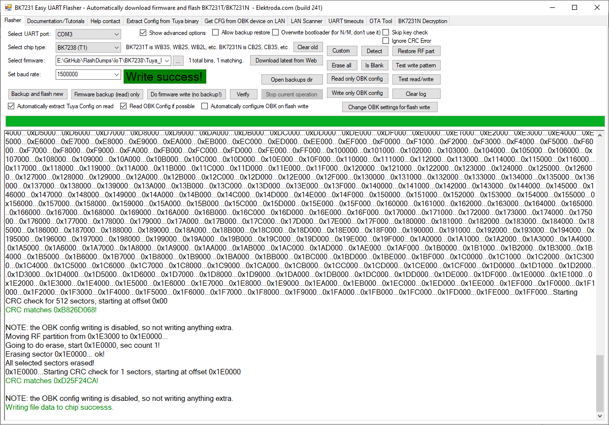

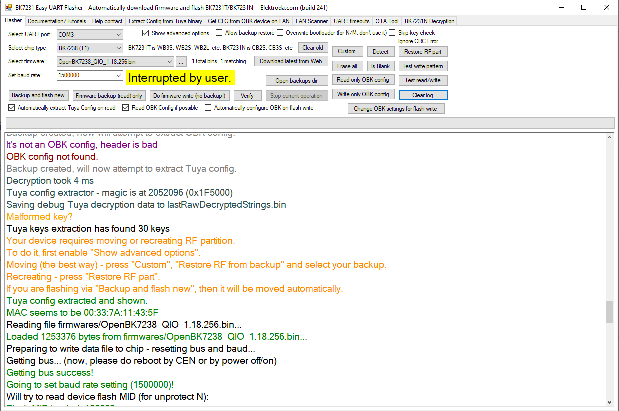

    cool
    Screenshot of BK7231 Easy UART Flasher with log output and the message “Interrupted by user.” Screenshot of BK7231 Easy UART Flasher showing “Write success!” and flashing operation logs.
    insmod wrote:
    Accidentally included read/write logging changes in BK7231Flasher
    generally, I tend to prefer more logging
  • #220 21833414
    insmod
    Posts: 1424
    Help: 164
    Rate: 446
    >>21833408
    Well, it's basically the same, except removed "Writing sector" / "Reading" and "ok!". Much more compact without them.
  • #221 21833416
    Posts: 5153
    Help: 442
    Rate: 906

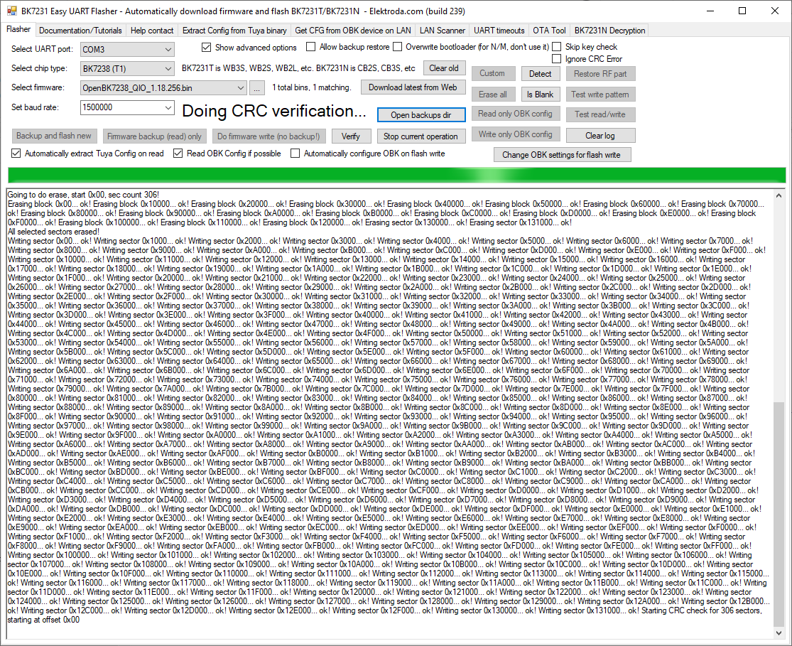

    ah i see. yes, much better removed. before:
    Screenshot of BK7231 Easy UART Flasher showing erase/write logs and “Doing CRC verification…” status.

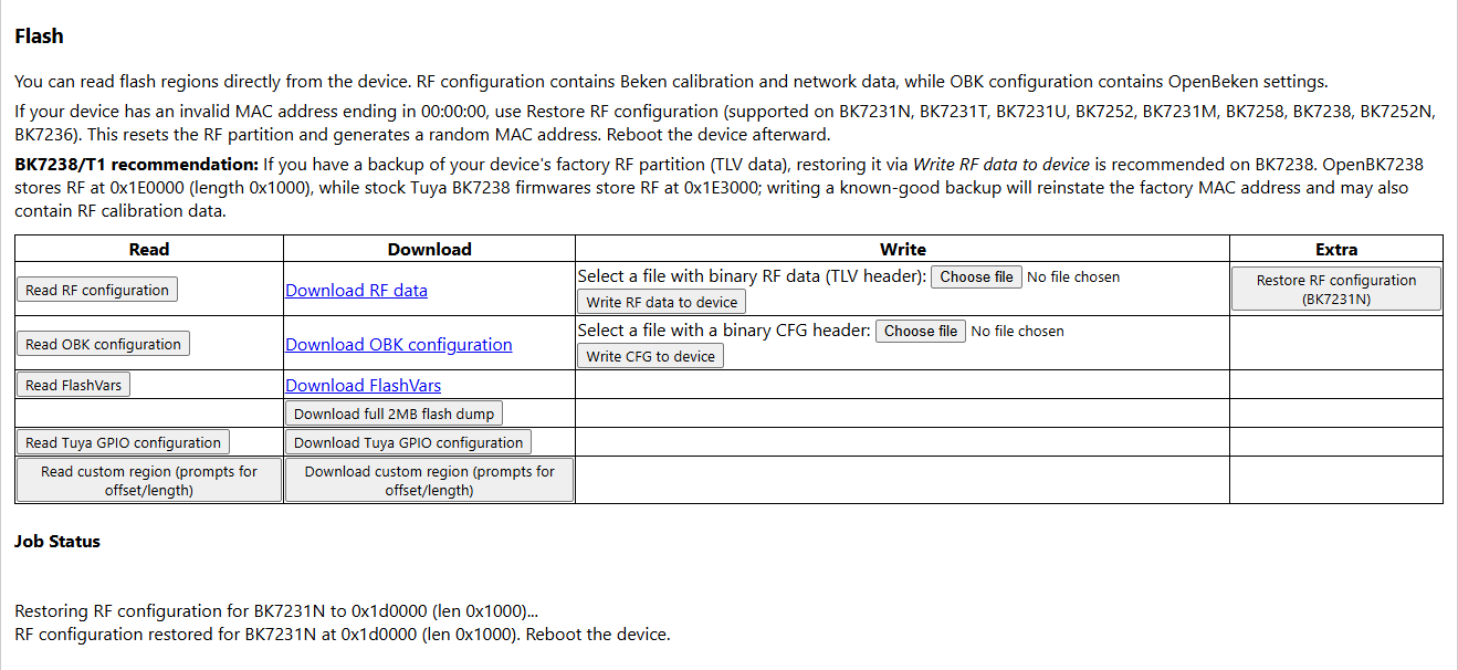

    #227 21834229
    Posts: 5153
    Help: 442
    Rate: 906
    Can we add RF restore to Web App separatel, without first merging cosmetic PR?
    working on something now. will submit for review shortly

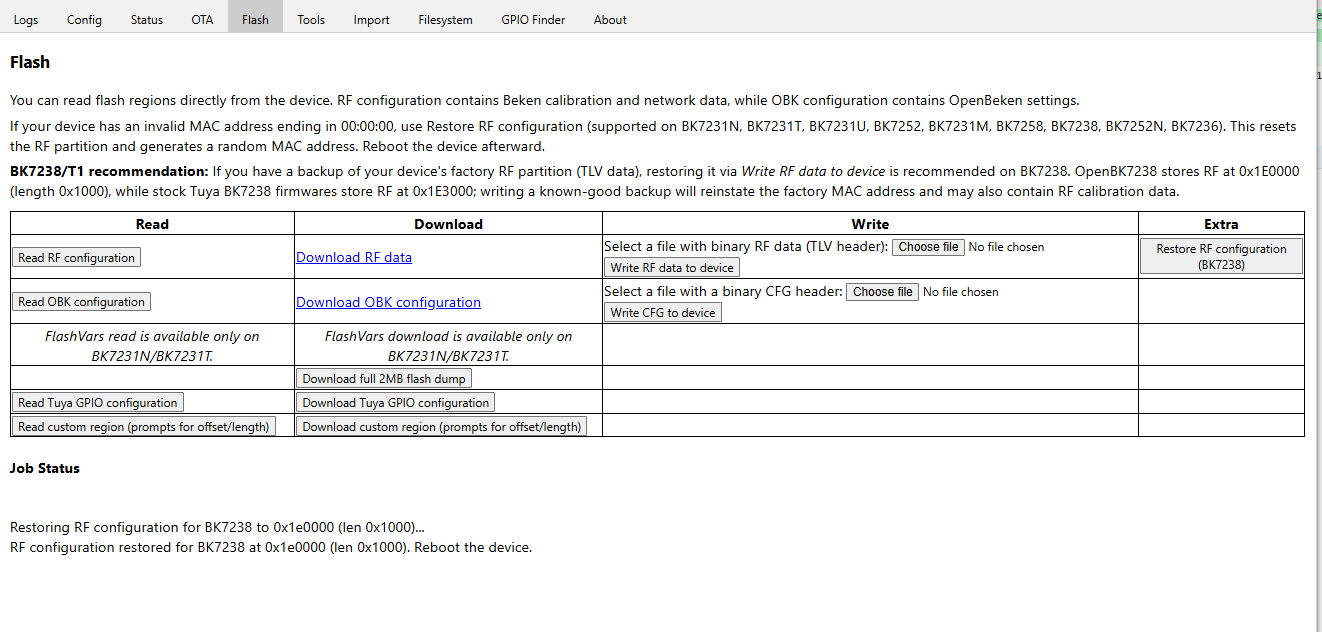

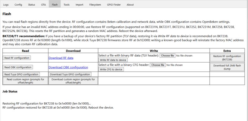

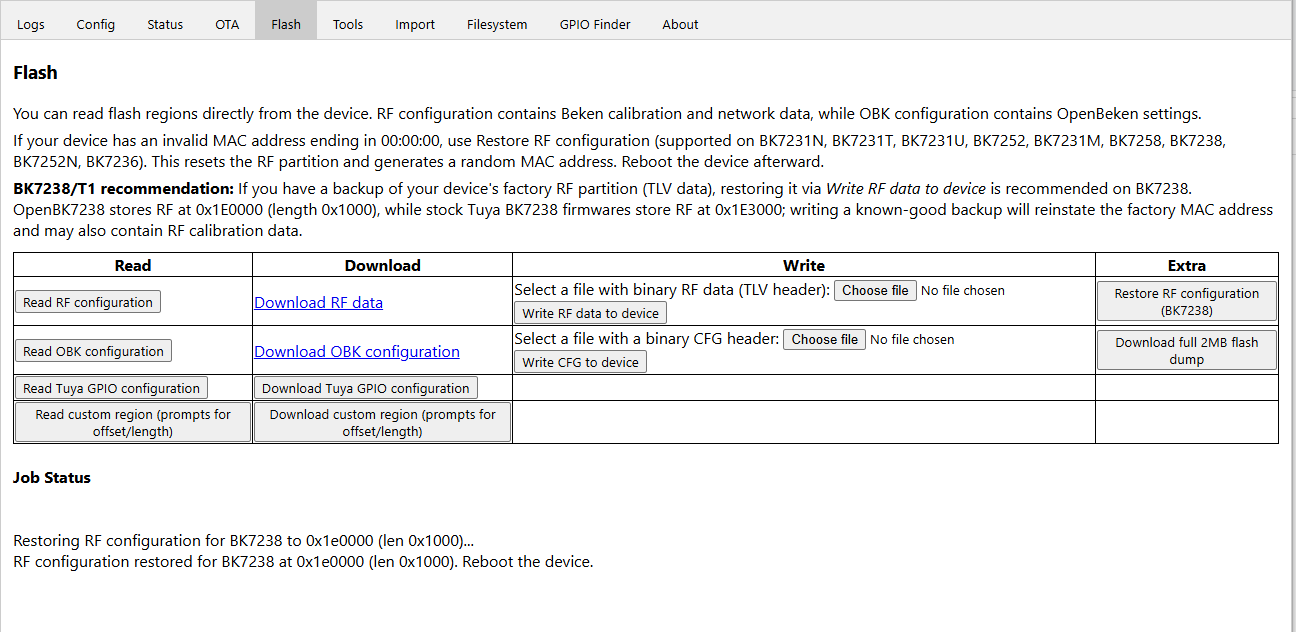

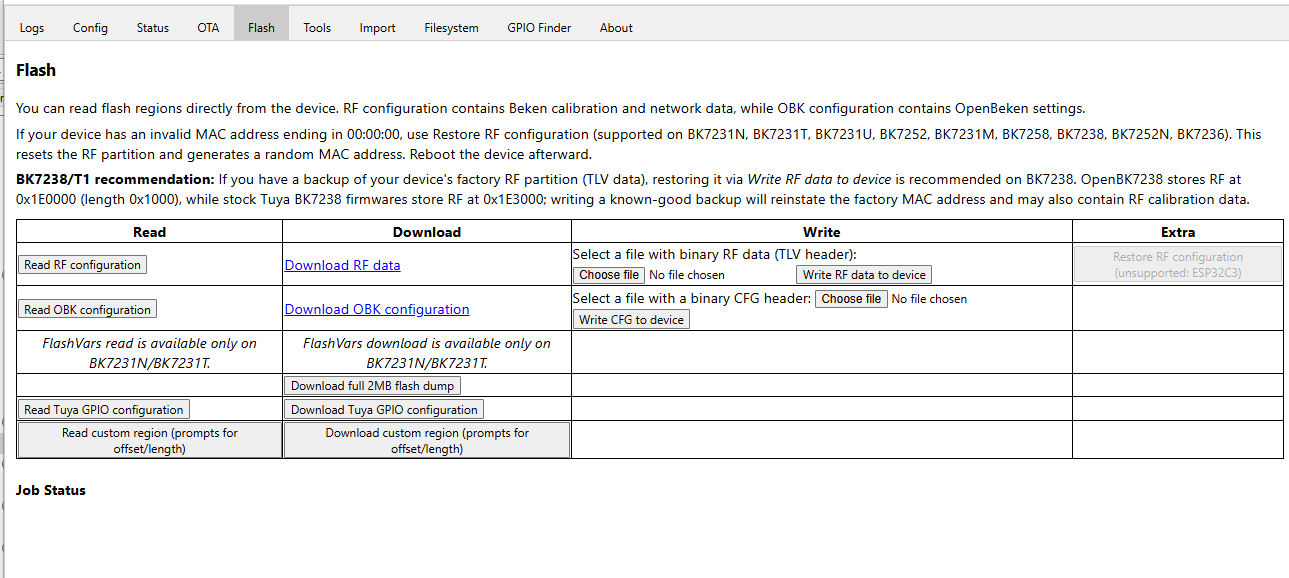

    Added after 51 [minutes]:
    Restore RF now supports BK7231N, BK7231T, BK7231U, BK7252, BK7231M, BK7258, BK7238, BK7252N, BK7236. bytes and offsets are from https://github.com/openshwprojects/BK7231GUIF...b/main/BK7231Flasher/Utils/RFPartitionUtil.cs
    Restore RF button is only active for supported chipsets, current chipset shown on button. Additional logging to job status for chipset/offset being written for.
    FlashVars read/download only active for BK7231T/N
    Screenshot of Flash tab in a web app with a “Restore RF configuration (BK7238)” button.
    Screenshot of a “Flash” page with RF/OBK read-write table and “Restore RF configuration” button
    tested RF restore on N and 7238

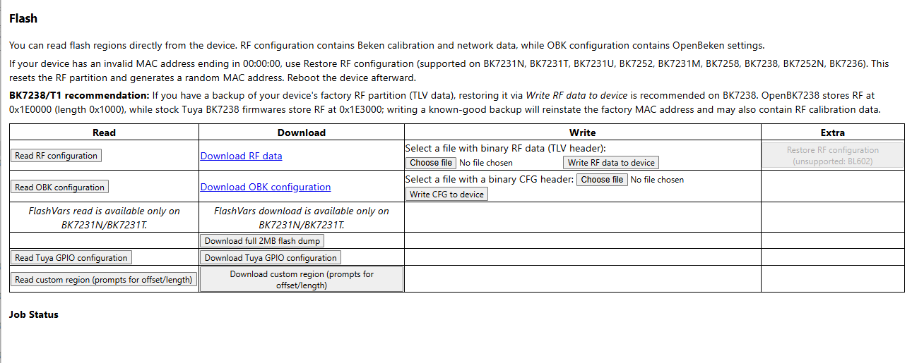

    BL602:
    Screenshot of a web app for reading, downloading, writing, and restoring RF/OBK flash data for Beken chips
    ESP32C3
    Screenshot of the “Flash” tab showing a table with read, download, and write options for RF/OBK configuration
    https://github.com/OpenBekenIOT/webapp/pull/266

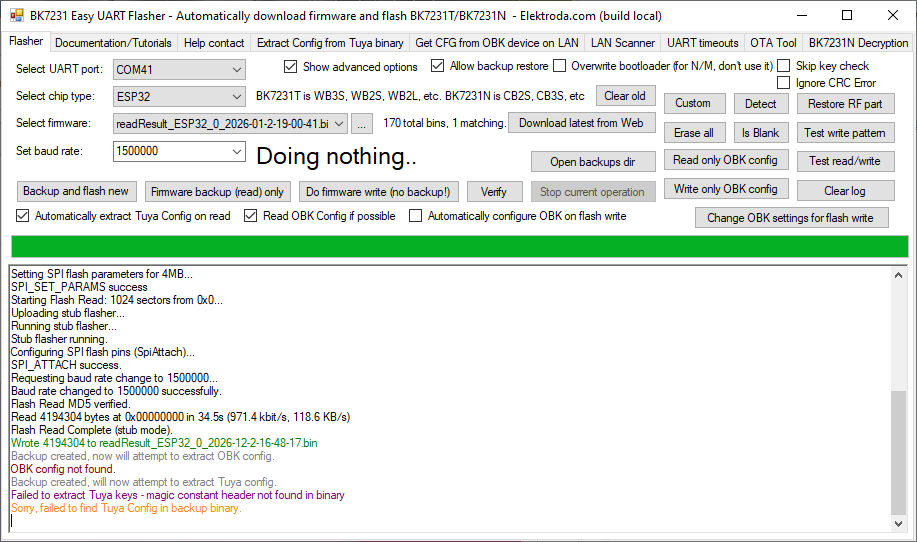

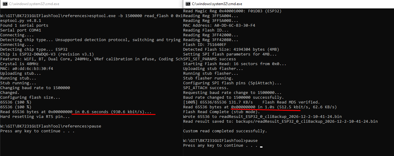

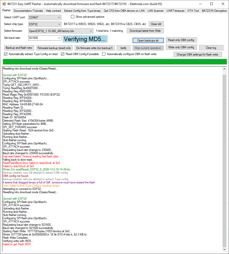

    ESP32 stub support, but not as fast as esptool yet
    Screenshot of two cmd.exe windows showing esptool.py logs for reading an ESP32 flash memory
    Added after 6 [hours] 6 [minutes]:
    @divadiow
    Screenshot of BK7231 Easy UART Flasher showing ESP32 flash read log and config-related error messages

    #233 21837442
    Posts: 14699
    Help: 656
    Rate: 12743
    Generic ESP32 development board. ESP32 stub should be able to read and write. I also added command line mode and test function.
    File manager list of BAT files named test_esp32_64K and test_esp32_read variants
    I will probably first also normalize command line arguments to be 1:1 as in esptool.
    New release should be ready. Let me know if ESP32 read/write (fast version with ram stub) works for you, and is command line bat working as well?

    interesting, I always need to manually do download mode on my ESP-WROOM-32 board.
    Screenshot of BK7231 Easy UART Flasher showing ESP32 flashing log and error “Failed to get Flash MD5”.
    esptool is OK though
    Added after 4 [hours] 31 [minutes]:
    threw ESP32 flasher code at LLM and with this code my ESP32 does its IO0/RST dance successfully
    https://github.com/openshwprojects/BK7231GUIF...in...divadiow:BK7231GUIFlashTool:esp?expand=1
    writing works but read always stops at the same point though at any baud. not explored why, just wanted to see if the reset could be made to catch
    Screenshot of BK7231 Easy UART Flasher showing ESP32 flashing log on COM47 and an MD5 verification error.

    Interesting, any thoughts @insmod ?
    We can accept your change but you need to put it into a separate class... but I am suprised, for me reset works on my LilyGO T-CAN485 and on my nodemcu 32.
  • USB hub caused flaky ESP32 flashing
    #239 21838042
    Posts: 5153
    Help: 442
    Rate: 906
    hmm, it was more a sloppy test to see what it would take to get working.
    Added after 47 [minutes]:
    split it out. no idea if it's generally better or just better for my specific board though - still not sure what's happening with my read. does this build work for you?
    https://github.com/divadiow/BK7231GUIFlashTool/actions/runs/22002549255
    I'll see if I've got another original ESP32
    Added after 17 [minutes]:
    wow. ok. my ESP32 is just a little sensitive it seems. moved off USB hub. build 250 does work :)
    interesting my build seemed to catch OK on hub though.
  • #240 21838164
    Posts: 14699
    Help: 656
    Rate: 12743
    Wait, so.. the way you access DTR pins matter? C# api does not work on hub but winapi does? I was sure it goes through the same API...
    Anyway, is that one ready to merge?
