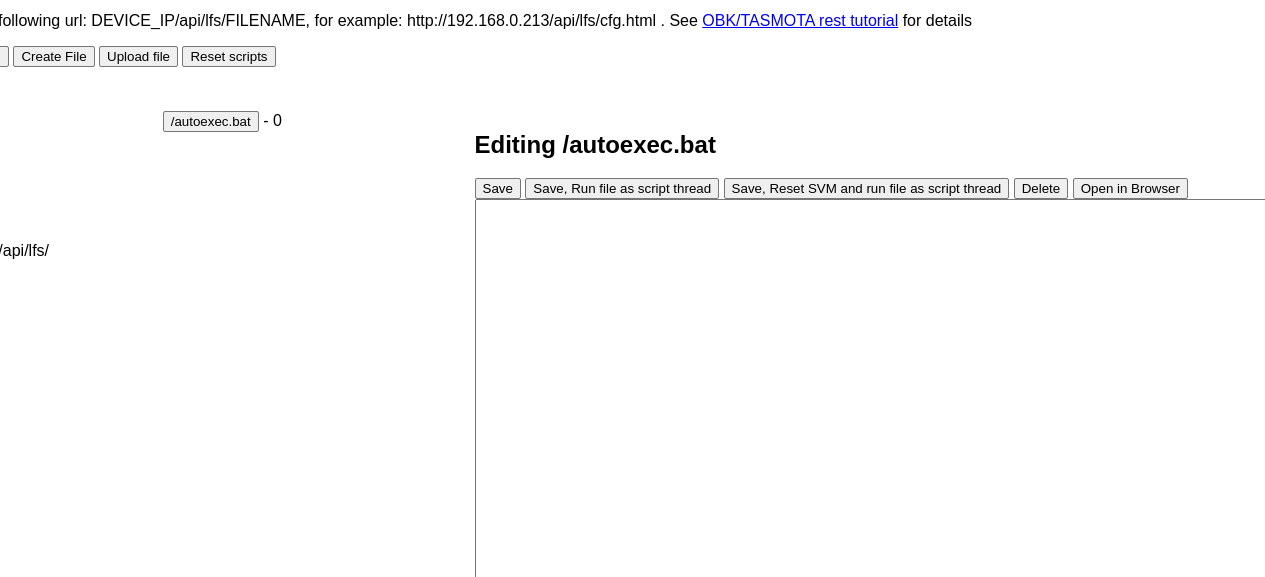

    how can I create the autoexec.bat for all the drivers? Do you have the cleanest way for the setup of this switches?
    Thanks.
  • Requesting autoexec.bat setup for all drivers

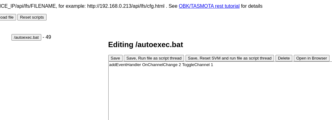

    #366 21498573
    rufus4
    Posts: 65
    Rate: 9
    >>21498510 Drivers you can start as a startup_command under cfg or in the autoexec.bat.
    Don't know if there is a best way.
    But with your device you need to have autoexec.bat for the script addeventhandler... anyway.
    my startcommand is for example:
    backlog startDriver NTP; ntp_setServer 192.168.1.1; ntp_timeZoneOfs +0; PowerSave 1 ;startDriver BL0942
    not shure how it would be correct in autoexec.bat, but it works in my case like this:
    startDriver NTP

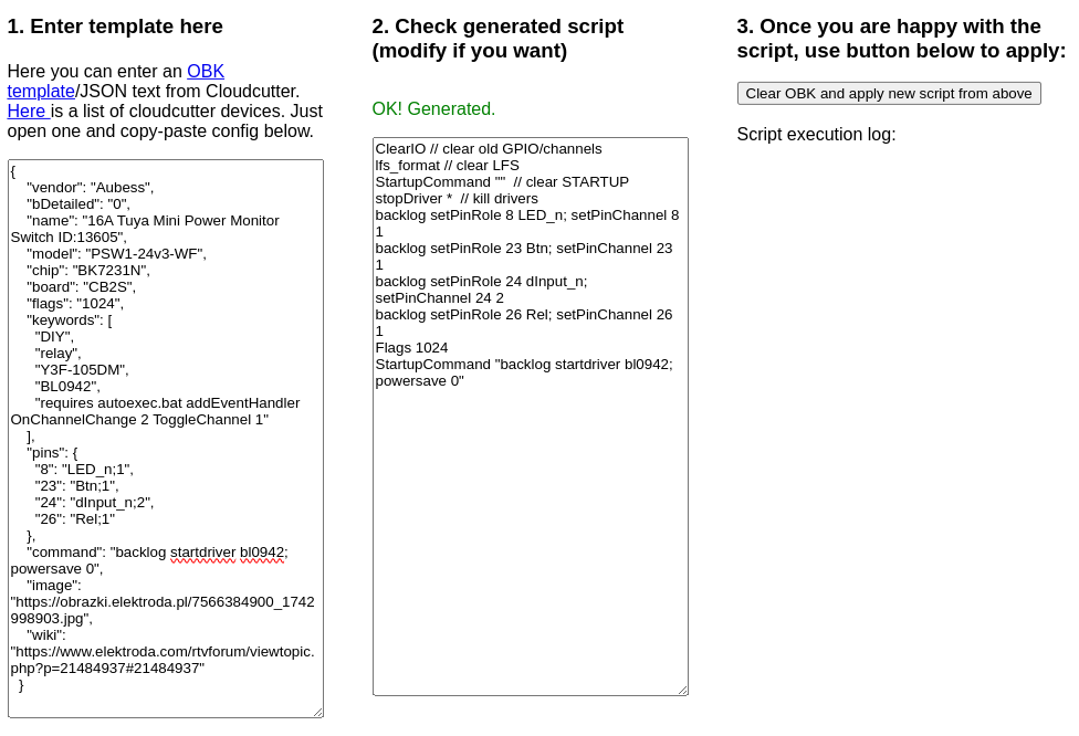

  • #367 21498643
    badboy3004
    Posts: 19
    Hello divadiow, rufus4
    do I understand it right?
    I copy paste it here:
    User interface for generating and applying OBK configuration scripts.
    What should i write inside the autoexec.bat file here:
    User interface for editing the /autoexec.bat file with save and run options.
    Thank you both very much for support.
  • Template should only add the channel-change handler
    #368 21498971
    rufus4
    Posts: 65
    Rate: 9
    >>21498643 To be honest, I never imported a template. I allways configured pins etc seperately.
    But yes, you can do it like this. And in the littlefs folder you write only
    addEventHandler OnChannelChange 2 ToggleChannel 1
    because startupcommands for drivers etc. are in the other setting section under startup_command.
    template (requires... so its still missing in the generated script):
    "requires autoexec.bat addEventHandler OnChannelChange 2 ToggleChannel 1"
    generated script (so this will be set):
    StartupCommand "backlog startdriver bl0942; powersave 1"
    hope this is right and understandable...

    Editor interface for the /autoexec.bat file showing code.
    Thanks.

  • Channel 2 toggle event fixes the relay mapping
    #371 21502251
    rufus4
    Posts: 65
    Rate: 9
    >>21501849Are the channels for the pins configured like this?
      "pins": {
        "8": "LED_n;1",
        "23": "Btn;1",
        "24": "dInput_n;2",
        "26": "Rel;1"
    and littleFS like this?
    Actually this works. If not, I don't know what else could be wrong in your setting.
  • #372 21502267
    Posts: 14677
    Help: 656
    Rate: 12703
    He might have not rebooted and added the change handler twice. If added twice, the handler command will be run twice and will cancel each other...
  • #373 21503040
    badboy3004
    Posts: 19
    >>21502251
    Now is dInput at 2 and it seems to work. I will test it next days.
    Thank you for the support.
