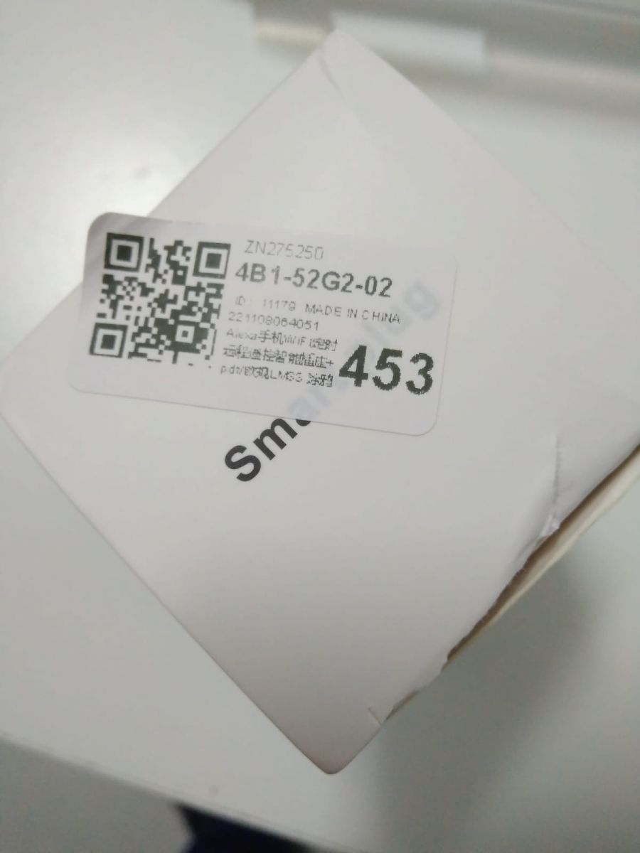

    Rate: 42
    Hmm are all the packaging marking etc the same? I can submit your alternate pinout to templates database but users will have to guess which one is which.

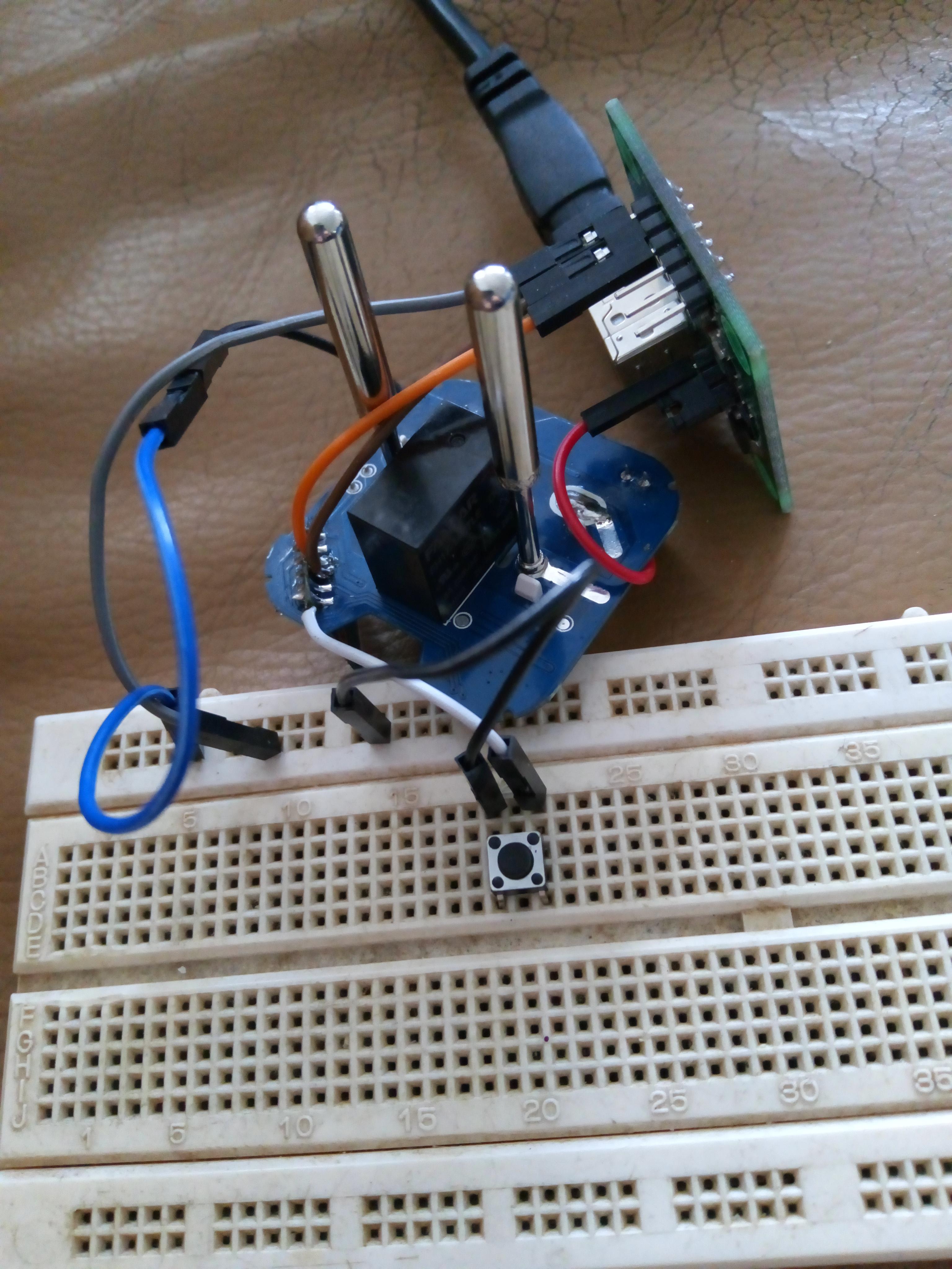

    Hi,
    I have this device and connected the correct wires and did everything right. But I can't program the CB2S! Why? There is no BK7231Flasher.exe file on github. Please provide a pre-compiled version of the flasher! I'm currently working on an old system and I am not able to install visual studio. I have downloaded "OpenBK7231N_QIO_1.15.347.bin" and want to flash that file. Is that the correct bin file or do I have to burn another (bootloader) file first? Please help me with a precompiled BK7231Flasher.exe.

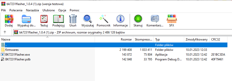

    To make it easier for everyone to be able to do this:
    1) Download flasher tool from http://..../BK7231Flasher.exe or http://.../BK7231Flasher.zip.
    2) Download bin file from http://..../firmware.bin or http://..../firmware.zip. Found the link on this forum.
    3) Flash the file
    That would be great. Thanks in advance.
    Most people won't edit the flasher code and just want the exe file. Providing this file will also prevent malware being made and published somewhere else with the same name. Yes, I googled "BK7231Flasher.exe". I even wanted to use the outdated python flasher, but posted this instead.

    Ps. the flash board is a self made board with FTDI chip. Power is provided by 5V jumper position that's not used (3V3 is connected). The button is to reset the controller and start the programming. I will probably replace the relay with a solid state relay (Sharp S216S02).

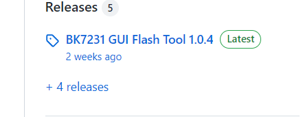

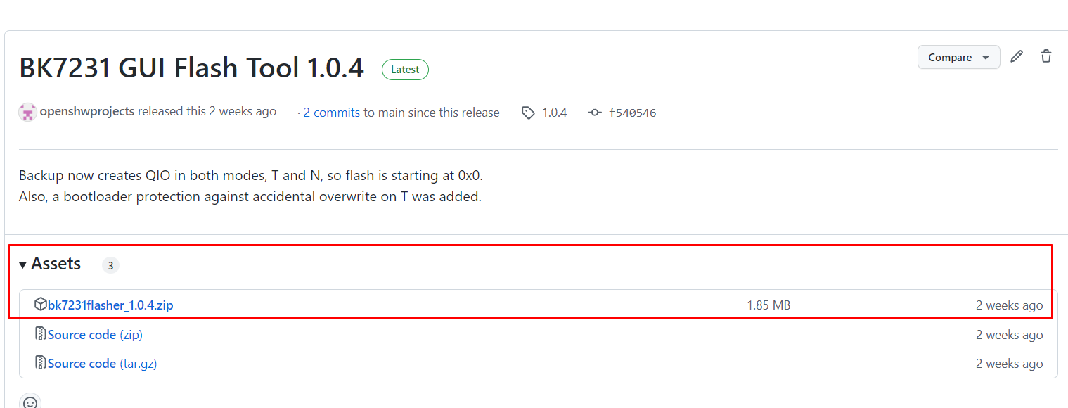

    Hello @erikvanboxtel . Precompiled version is available always, from the very beginning of the flasher. Have you checked "Releases" tab on the right?
    It's here:
    https://github.com/openshwprojects/BK7231GUIFlashTool/releases

    Where do you have a topic with missing Flasher link?
    PS: You can also use bkWriter 1.60 or hid_download_py. Read more here:
    https://www.elektroda.com/rtvforum/topic3951016.html

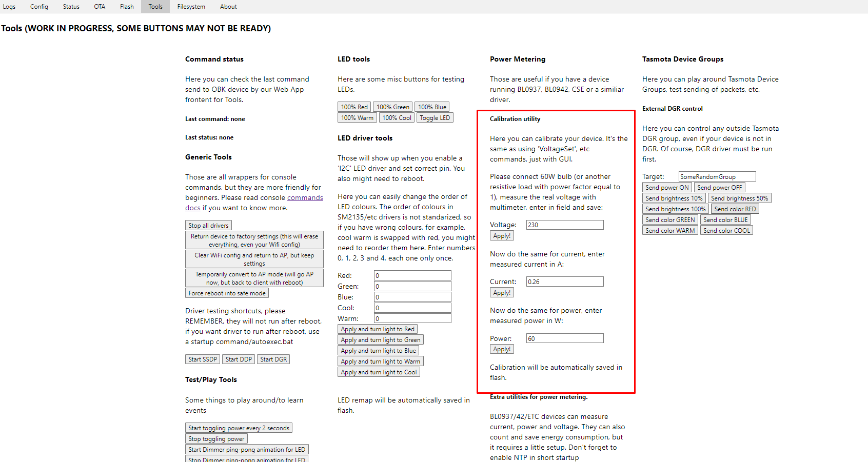

    I also did the calibration.... I visited the "Launch Web Application" and selected the right device. I did the "StartDriver BL0937" command and after that I did these "Execute custom commands" with the correct parameters to calibrate the device:
    - "VoltageSet 228"
    - "PowerSet 100"
    - "CurrentSet 0.42"
    I have a question. Why do you have to set voltage, power AND current for this calibration (P=U*I?)? Is voltage (AC voltage measurement Fluke) and setting power or current not enough?

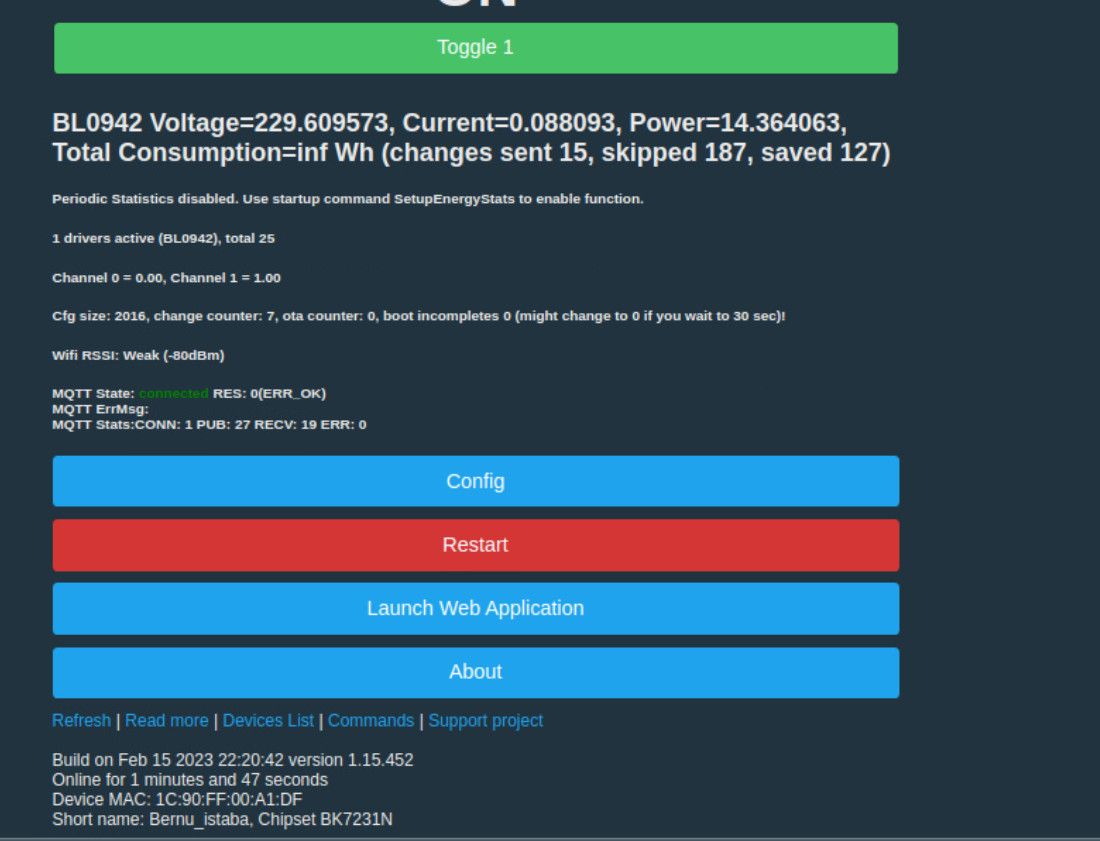

  • #65 20441517
    kokskrustnagla
    I am new in this project. I need some information. I flash 2 devices BK7231N CB2S Model: 4B2-39G1-01 ZN366877_01 with openbk7231N_1.15.452. But one of this device did not shows total consumption. In the front page I se Total consumption=inf Wh.
    I try to reset, calibrate the voltage but nothing change. Below I added photo. Maybe You have some solution for that.
    Best regards Tuya LSPA9 smart socket - teardown, OpenBeken flashing guide for CB2S, BL0942
  • #66 20441576
    Posts: 14677
    Help: 656
    Rate: 12703
    Hello, please try EnergyCntReset command.
  • #67 20441879
    kokskrustnagla
    Thank You, it works.

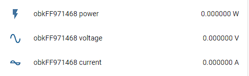

  • #69 20489793
    mminkov
    Posts: 18
    Hi there, after version 1.15.584, my socket with BL094 can't measure voltage and power consumation. Recalibrate needed?

    In a meantime, I added calibration interface to Web App (so you don't have to use VoltageSet commands etc):

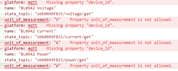

    @p.kaczmarek2 I've been trying to launch a very similar product
    https://www.elektroda.com/rtvforum/topic3968081.html
    But I'm not receiving any signals from power metering.
    Also I've copied your YAML for the PM sensors but it throws a ton of errors:
    (I've modified the obk0696FB33 with my device mqtt name, but the errors are still there
  • #85 20513999

    Hello @sirlouen . It looks like you are trying to write YAML code for OpenBeken device by hand, which is not a recommended method. Do you know that OpenBeken currently supports Home Assistant Discovery, so the power metering device can be added to your HA with just a few clicks?
  • #86 20514017
    sirlouen
    Level 4  
    Posts: 12
    Great it works now in HA.

Quick 3-step power-calibration (BL0942)
  1. Plug a 60 W incandescent bulb.
  2. In Web‐App → Tools enter real 230 V, 0.26 A, 60 W.
  3. Click “Calibrate”. OBK stores constants and restarts driver [Elektroda, Wimmi, post #20957896]
