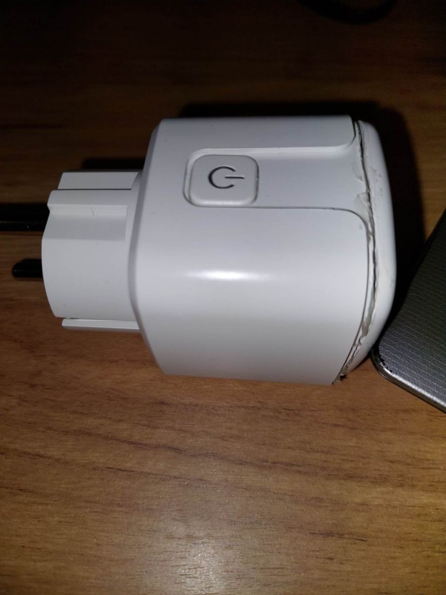

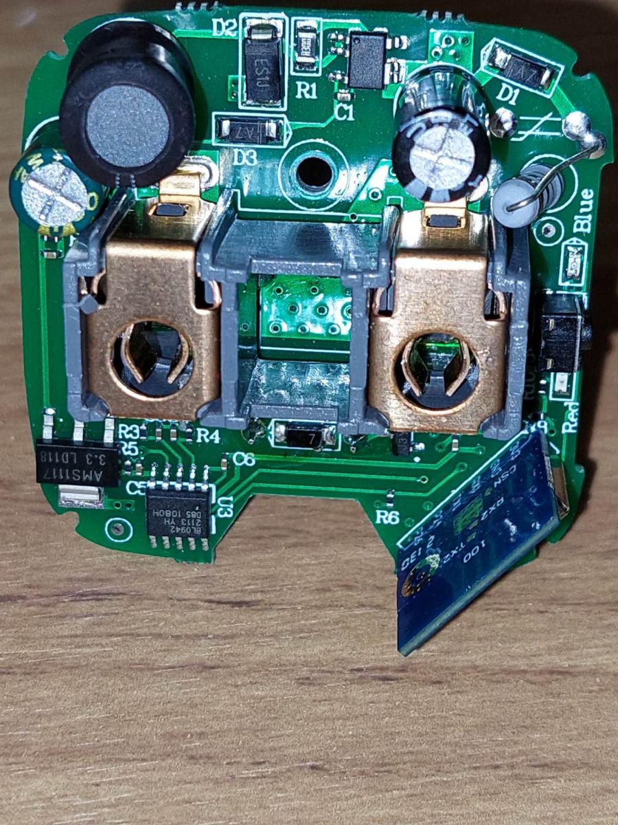

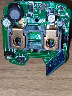

    piratee
    Posts: 69

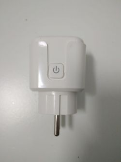

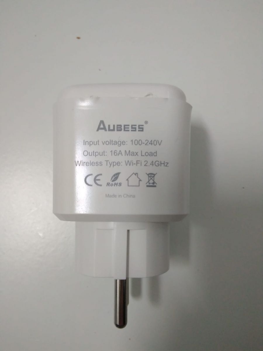

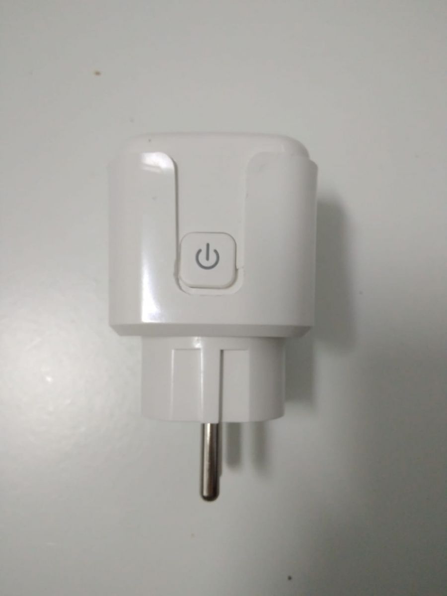

    Smart plug socket purchased on AliExpress.
    Inscription on the underside :
    Model : LSPA9, Input ,Output : AC100-240V, 16A(Max) ROHS

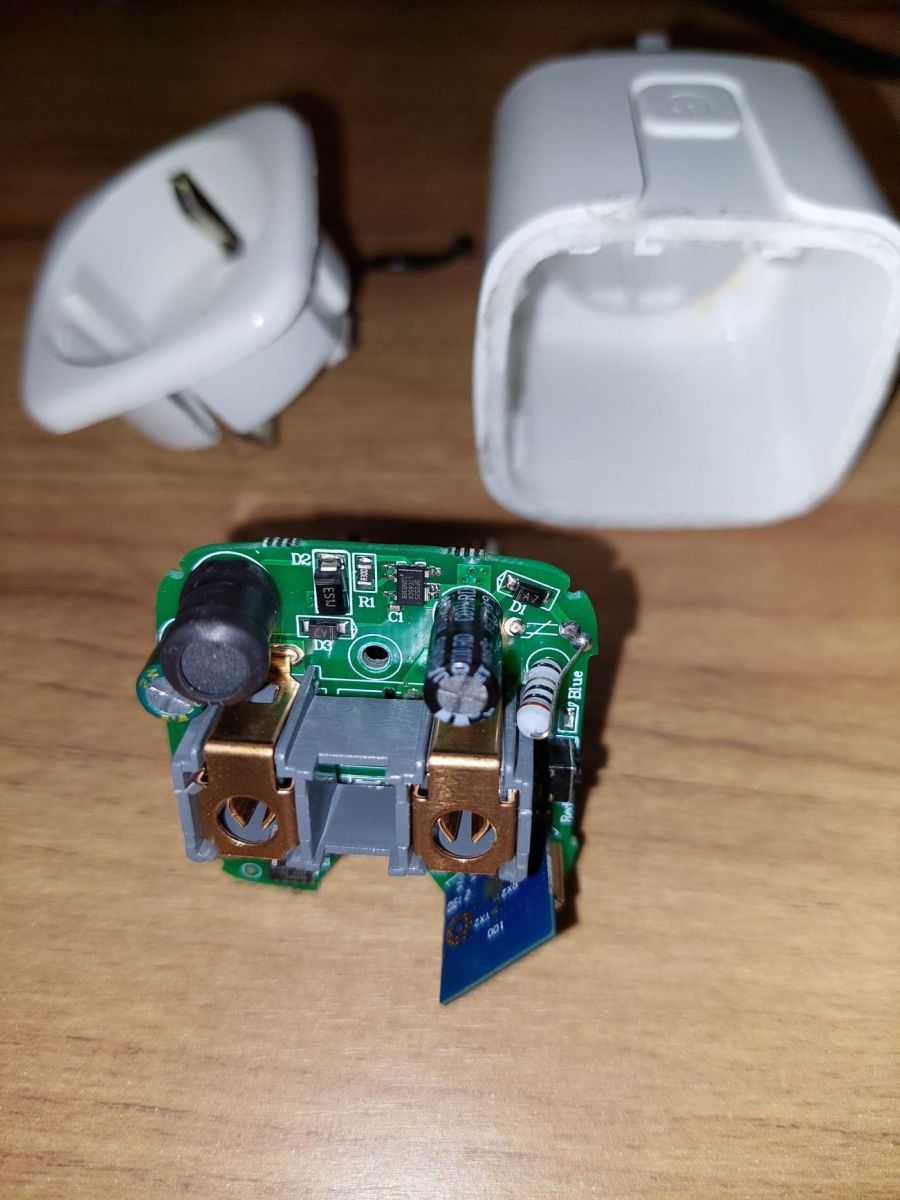

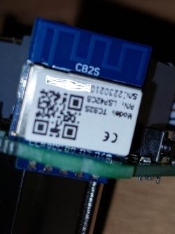

    Inside is the TCB2S chipset.
    To get to the inside of the socket you unfortunately have to cut off the top from the top using a knife.
    To remove the electronics from the inside you have to unscrew 2 screws.
    Currently the socket has Tuya firmware as far as possible I will want to upgrade to software for normal HA integration.
    Regards

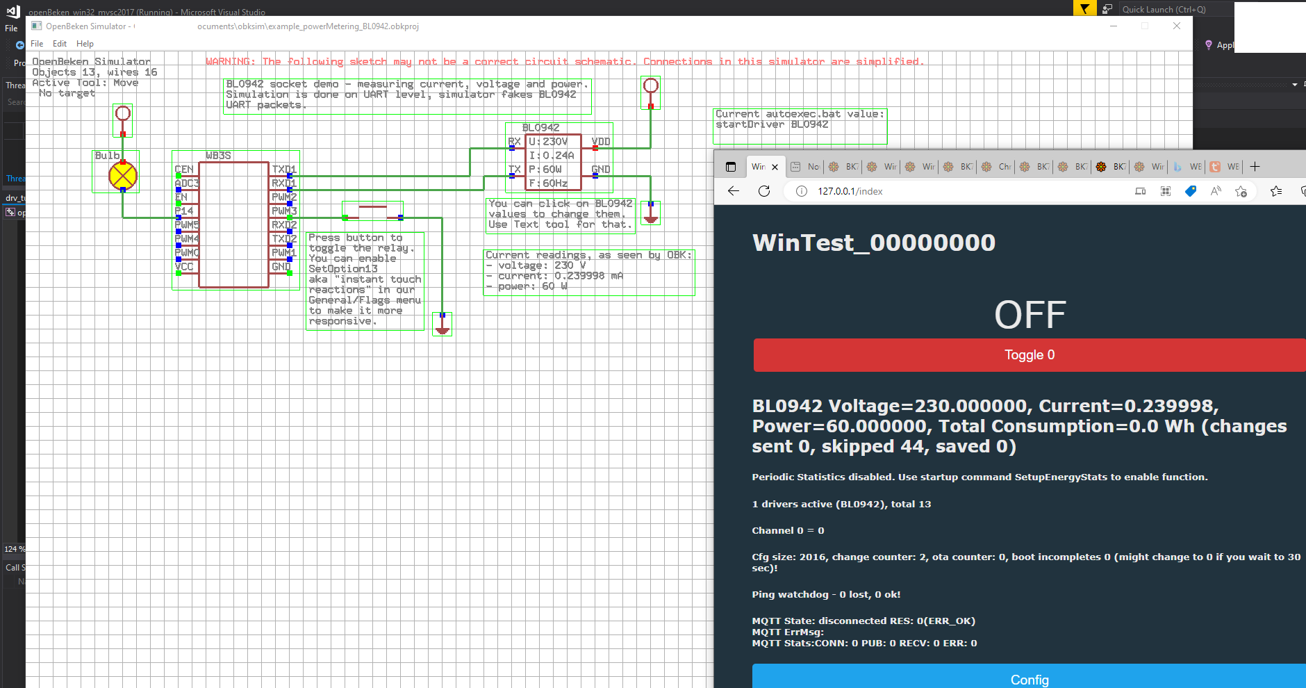

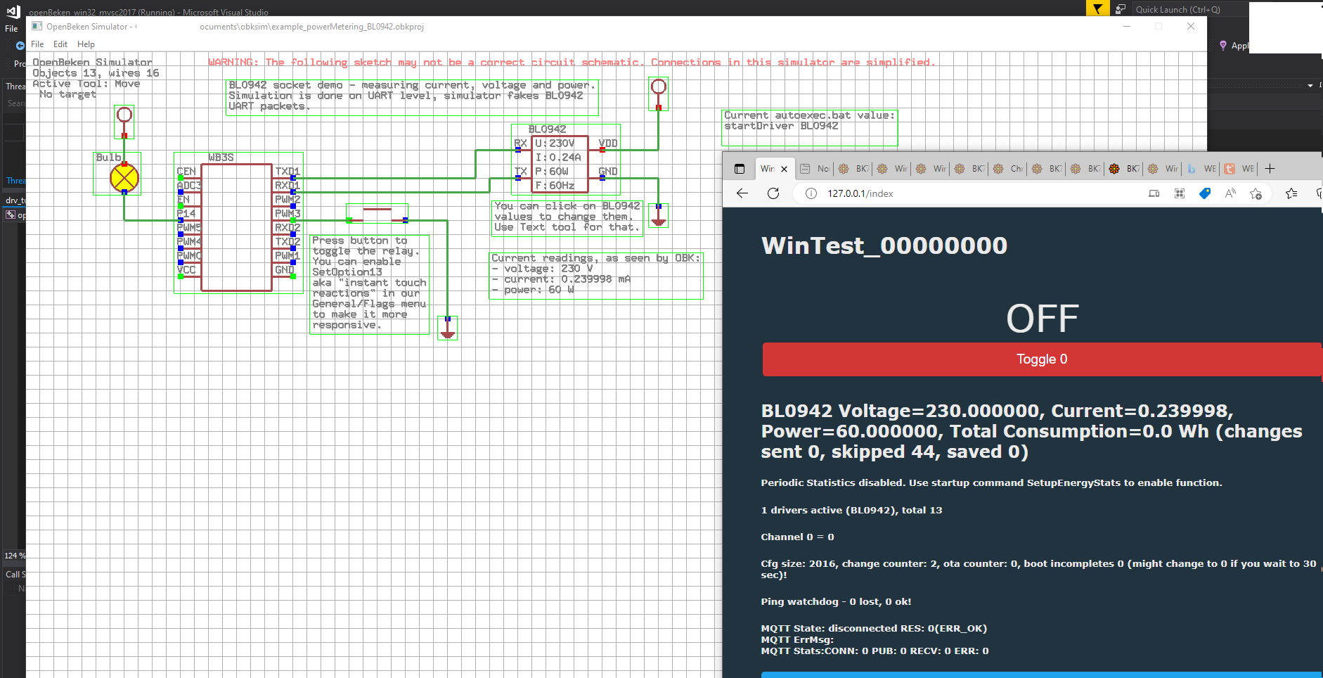

    I am also testing a power metering socket, but a virtual one - in soon-to-be-released OpenBK simulator:
    Spoiler:
    Tuya LSPA9 smart socket - teardown, OpenBeken flashing guide for CB2S, BL0942

    Hello @sq3evp . My soft currently supports BK7231T, BK7231N, W600/W601, W800/W801, BL602 and XR809, and I have almost ready support for the RTL platform.
    In turn, sockets for ESP are known - they are supported by Tasmota, so I do not deal with the ESP platform.
    Here's my repository:
    And I also have Windows support - an IoT device simulator, used to streamline project development, where you can also create scripts and test automations - for learning:
    Spoiler:
    My software is still being developed, but if there is a socket with a processor for which SDK and toolset are available, I can support them sooner or later. The goal of the project is to support more platforms and give users freedom from the cloud and freedom in their configuration.
    It looks great, almost like a Proteus.
    I'm looking forward to it!!!

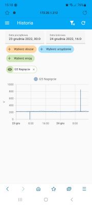

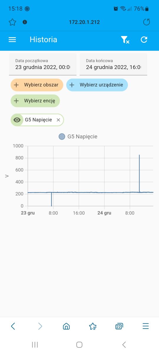

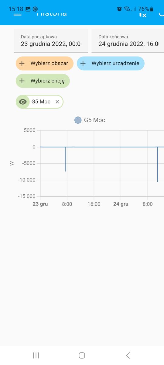

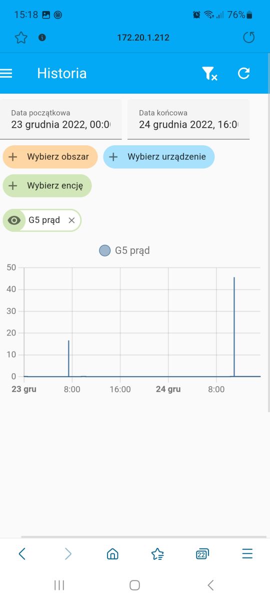

    I have this problem with strange negative peaks on the charts. This is happening to me on 2 different reworked outlets. Tuya LSPA9 smart socket - teardown, OpenBeken flashing guide for CB2S, BL0942
    It appears irregularly and more or less at a similar rate once or twice a day. I don't know where to look for the error, can someone point me?
  • #46 20350445
    Posts: 14586
    Help: 654
    Rate: 12608
    Hello @madart, I haven't seen it, maybe @valeklubomir knows something more about it, he has quite a lot of OBK sockets active all the time, but from what I remember it was only a top-down power limit - PowerMax command.
    But generally I can fix it for you in 5 minutes, just clamp negative results to zero. Would such a solution suit you?
    Just write, does it occur with BL0942 or BL0937?
  • #47 20350592
    madart
    Level 26  
    Posts: 892
    Help: 79
    Rate: 64
    Both are BL0942. Is there any command to reset such negative results? Because in general, I was surprised by the fact that these sockets can count the current in both directions, normally it does not occur because it is impossible to replace the plug with the socket, but when it is disarmed, soldering on the contrary is already possible
  • #48 20350604
    Posts: 14586
    Help: 654
    Rate: 12608
    At the moment there is no, but I can add, for example, a flag.
    Can you still write to me, do you only have a negative power measurement or current too? Basically, I'm not sure now if these are "measurements" at all, or it's not like there's some sort of glitch. Well, but in BL0942 we check the packet checksum and reject packets with interference, so strange.
  • #49 20350610
    piratee
    Posts: 69

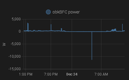

    I did not look at the measurements earlier and I see that I have peaks at five current and power. (as a consequence, renergy will also be miscalculated) BL0942.
    Regards
  • #50 20350634
    madart
    Level 26  
    Posts: 892
    Help: 79
    Rate: 64
    For me, only the power has such a negative peak, the current and voltage do not show it
  • #51 20350640
    Posts: 14586
    Help: 654
    Rate: 12608
    @madart @piratee do the peaks occur only when there is zero current/power consumption, or quite randomly?
    I'm asking because I want to know if I should:
    a) convert its value to 0
    b) skip this measurement (and wait for the next measurement in 1-2 seconds)
    EDIT: I tend to skip it
  • #52 20350648
    madart
    Level 26  
    Posts: 892
    Help: 79
    Rate: 64
    On one it happens at zero consumption, but the other is still loaded with 20W
    Imo, it's probably better to ignore such an erroneous measurement and give the next one
  • #53 20350650
    piratee
    Posts: 69
    This is how it looks in HA, I would probably skip it
    Tuya LSPA9 smart socket - teardown, OpenBeken flashing guide for CB2S, BL0942 Tuya LSPA9 smart socket - teardown, OpenBeken flashing guide for CB2S, BL0942 Tuya LSPA9 smart socket - teardown, OpenBeken flashing guide for CB2S, BL0942
  • #54 20350667
    Posts: 14586
    Help: 654
    Rate: 12608
    The build is already uploaded, from now on it skips such measurements, but you can turn off the appropriate flag.
    All you have to do is make an OTA and you can test if it's better (nothing else needs to be configured)

    Hello. The text is translated so I apologize if it is not clear enough.
    Kaczmarek2, the work you do is impressive, as well as the attention and patience you show every day.
    I would like to help more, but my means and knowledge are very limited, so here goes my modest contribution to the growth of this community.
    Aubess 16A smart socket with CB2S wifi board with BK7231N chip and BL0937.
    It looks like a clone of LSPA9 but the configuration changes something:
    P6 ---> BL0937CF1
    P7 ---> BL0937CF
    P8 ---> LED_n
    P23 --> Btn
    P24 --> BL0937SEL
    P26 --> Rel
    regards

    For my Aubess plug, it is a little different:
    P6 ---> BL0937CF1
    P7 ---> BL0937CF
    P8 ---> LED_n
    P11 --> Btn - I guess there are different versions inside, outside looks the same as yours.
    P24 --> BL0937SEL
    P26 --> Rel
