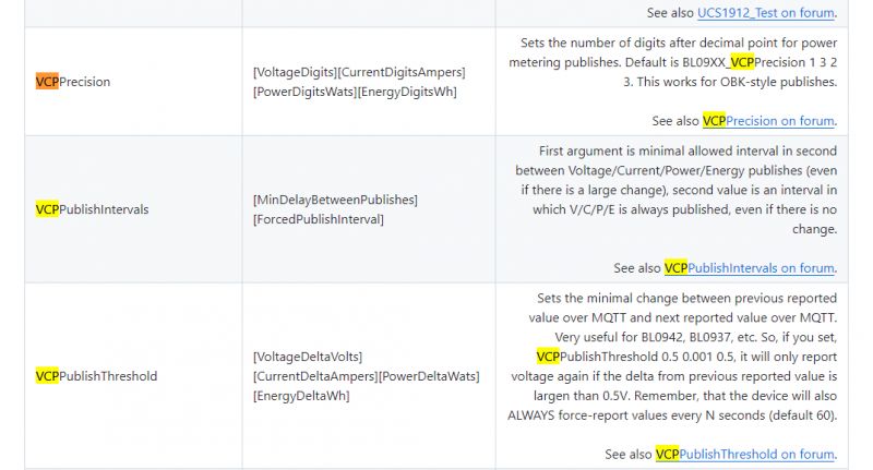

    carlig833
    Posts: 23

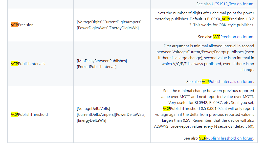

    I have a tuya smart-plug based on CB2S and BL0937. I am pretty happy with the OpenBaken firmware.
    The only little problem is that I find the smartplug is a bit too "chatty" over MQTT.
    It sends almost a message a second despite it is turned off. Would it be possible to reduce and filter that?
    domoticz/obk0D722ACA_sp1/power_reactive/get 0.00
    domoticz/obk0D722ACA_sp1/power_factor/get 1.00
    domoticz/obk0D722ACA_sp1/voltage/get 236.4
    domoticz/obk0D722ACA_sp1/current/get 0.011
    domoticz/obk0D722ACA_sp1/power_apparent/get 2.80
    domoticz/obk0D722ACA_sp1/power_reactive/get 2.80
    domoticz/obk0D722ACA_sp1/power_factor/get 0.00
    domoticz/obk0D722ACA_sp1/voltage/get 237.4
    domoticz/obk0D722ACA_sp1/energycounter/get 81.194
    domoticz/obk0D722ACA_sp1/energycounter_today/get 81.194
    domoticz/obk0D722ACA_sp1/current/get 0.000
    domoticz/obk0D722ACA_sp1/power_apparent/get 0.00
    domoticz/obk0D722ACA_sp1/voltage/get 234.5
    domoticz/obk0D722ACA_sp1/power_apparent/get 2.79
    domoticz/obk0D722ACA_sp1/power_reactive/get 2.79
    domoticz/obk0D722ACA_sp1/voltage/get 235.2
    For example, I would like to get an update when the measure changes at least +/- 10% of their value.
    I also completely not interested in voltage, power_reactive, power_factor and so on.
    What are the options to influence this?[/code]

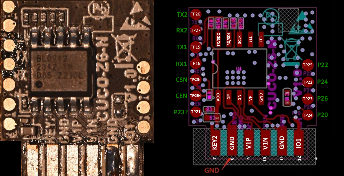

  • #303 21258802

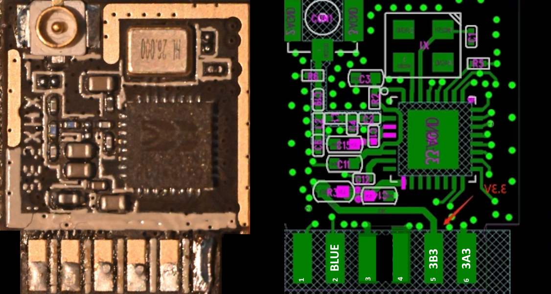

    baramuse
    >>20928892
    Hi, I have opened up exact same models, could you tell me where did you get the 3.3v and gnd ?
    I guess TX the upper pin (3rd from top) on your photo and RX the lower one ?
    I can't find anywhere a detailed photo/pins of that CUCO Z6N...
    Cheers
  • #305 21258871
    Posts: 5121
    Help: 441
    Rate: 904
    Please post detailed photos of your module/device if you can
  • #306 21259900
    Posts: 5121
    Help: 441
    Rate: 904
    I have asked Gosund for some information about the CUCO-Z6-N module and they have supplied this image. It's not terribly clear, but most of the module text is decipherable
    The image shows a software user interface and electronic module CUCO-Z6-N schematics with visible pins: TX, RX, GND, 3.3V. Instructions are in Chinese.
    • img_v3_02fj_7b369208-c4b4-4f92-87f5-8faafb0e7ebg.zip (245.28 KB) You must be logged in to download this attachment.
  • Request for help reading module silkscreen labels
    #307 21260269
    Posts: 5121
    Help: 441
    Rate: 904
    As a demonstration I've probably got too much time on my hands, here's a re-labelled version of both sides alongside photos of the actual module.
    I can't quite make out some of the text on the green side. If anyone has a module and can check my working and fancies filling in the blanks, please do.
    Image shows an electronic module with visible components and its schematic. Image of an actual module and its circuit schematic.

  • #309 21262397
    baramuse
    >>21260269
    That is awesome thanks a lot @divadiow and @dwmw2, there is all the info needed.
    I'll try with SOIC probles on the BL0942 and then with the pads if I can't get them all !
    Cheers

  • BL0942 driver publishes extra MQTT telemetry

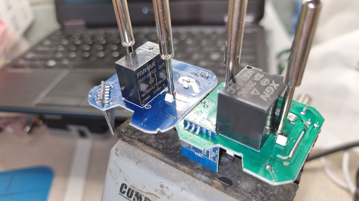

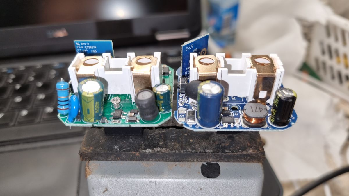

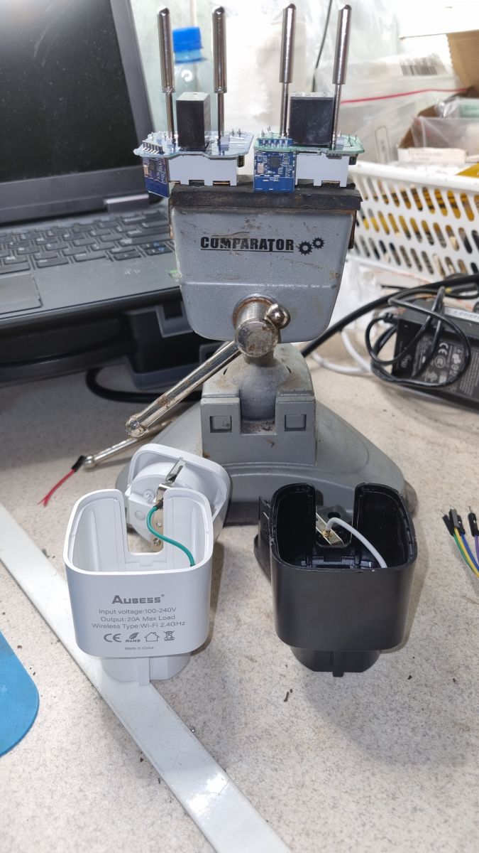

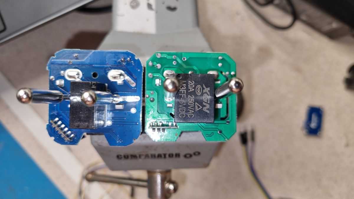

    donatasr
    Dark Man wrote:
    Today I flashed another 3 sockets with BK7232N, of which 2 are noname and 1 is Aubess (there was about a dollar and a half yeast from these nonames - I bought them at a different time than these nonames in the Choice option on AliExpress).
    In appearance, the housing looks identical. On the other hand, on the Aubess socket there are prints about the current, although it is false because it is supposed to be 20A max and inside there is a 16A relay. There are larger 20A relays in noname sockets.
    Who was copying whom? 😂
    Some comparison photos below.
    Two Aubess smart sockets with blue PCBs mounted on a clamp. Two Aubess smart sockets with blue PCBs and relays on a workbench. Two PCBs of different colors attached to a device. Two blue Aubess smart socket PCBs.
    The Aubess socket has only one LED (nonames have 2 blue ones, although sometimes older sockets used to have one red).
    How can it be used to show the status of wifi connectivity and the state of the relay after connecting to WiFi?
    Where did the Tools tab in the Web App Gui go? It has not been there for at least a dozen or so versions, and there was a nice menu for current calibration :(
    Now I had to do the same commands :/
    Also from at least a dozen or so versions, the preview of logs on the phone is terribly broken - i.e. buttons and squares for birds with descriptions enter the log window instead of being underneath.
    I have got blue one PCB Aubess smart socket. Did not flashed with opensource custom firmware yet . But one of my smart sockets failed. Relay clicks in 2-3 minutes interval and led lights for a second while powering on. Opened it, checked for voltages, 5V and 3.3V are present. Maybe CB2S chip failed. Is it possible to re flash it with factory firmware, as you have same blue PCB as mine, are you able to share archive of orginal firmware?
  • #319 21311471
    Posts: 14677
    Help: 656
    Rate: 12703
    >>21311271 I'd still suggest checking the capacitor. It's usually the capacitor. See related topic:
    https://www.elektroda.com/rtvforum/topic3898805.html
    NOTE: It has to be replaced with low ESR one.
    EDIT: You can also try disconnecting the socket from mains and powering it's 5V (or 12V, depends on model) lane from power supply and observing if the problem still occurs.
  • #320 21312490
    donatasr
    >>21311471
    Applied 5V to capacitor, and received same issues. Led lit at power on, relay switched on, and bouncing with 2-3 minutes interval. Is there a method of checking CB2S chip.
  • #321 21312626
    Posts: 14677
    Help: 656
    Rate: 12703
    Desolder CB2S, make 2MB flash backup, and flash OBK and see if OBK works. You can always restore Tuya from backup if you want.
    Related tutorial:

    mrsergio07
    Level 4  
    Posts: 7
    Hi, finally I have successfully flashed my LSPA9 with OpenBeken and configured it in home assistant. But I want to reduce the sampling rate at which it is sent by MQTT, as currently, the voltage for example, is being written every 15seconds and therefore taking up space in the database
    Thanks
  • #323 21355633
    Posts: 14677
    Help: 656
    Rate: 12703
  • #324 21359804
    mrsergio07
    Level 4  
    Posts: 7
    Thanks, now it works better with VCPPublishIntervals
    Could you publish recommended autoexec.bat and flags for this device?
  • #325 21360768

    I looked at your pictures in first page and noticed awful lot of wires - certainly more then in my setup. I can see there birds nest of wires but no actual explanation if 4 standard connections to chip are not enough - how it actually should go.
    edit
    Eventually I did desolder it from board and was able to flash it. I always consider that approach as last solution - it is always high risk to destroy something. I don't have hot air soldering equipment.
    Now I have another problem. I did use wifi setup with OBKConfig and flash seems to go successfully but socket refuses to connect. Blue led just keeps flashing. I am sure that password I entered was correct - I am using it same way as copy paste with all my devices.
    Is there possibility to somehow turn on safe mode so I could connect and check what is wrong?

    Desoldering WiFi module is sometimes required for successfull flashing.
    4 standard wires (3.3V, GND, RX and TX) should be enough.
    There is safe mode possible:
    https://github.com/openshwprojects/OpenBK7231T_App/blob/main/docs/faq.md
    Question: I entered wrong SSID and my device is not accessible. How to recover?
    A: Do five short power on/power off cycles (but not too short, because device might have capacitors and they need to discharge every time). Device will go back to AP mode (aka Safe Mode). Remember that in Safe Mode, pins are disabled, drivers are also not run, so don't worry if you see your device seemingly not responding to buttons, etc, etc.

How do I make BL0942 power readings appear on CUCO-Z06-N / GoSund EP2?
  1. Remove flashing wires so UART1 is free.
  2. In Web Console run startDriver BL0942 9600 (newer boards use 9 600 baud) [Elektroda, Wimmi, post #20957896]
  3. Attach a known resistive load and calibrate with VoltageSet/CurrentSet/PowerSet. Values are saved automatically [OBK docs].
Voltage, current or power stay at 0 — what to check?
• Confirm SEL pin pulled low (UART mode) and RX1/TX1 continuity between BK7231 and BL0942 [Elektroda, p.kaczmarek2, post #21036066] • Disable PowerSave for BL0937 devices; enable or disable for BL0942 depending on stability [Elektroda, p.kaczmarek2, post #20715289] • Re-flash latest OBK (> 1.17.458) which fixes wrong CF/CF1 mapping [OBK changelog].

MQTT floods my broker every second – how to throttle?
Run mqtt_broadcastInterval <sec> (typical 30 – 300 s). For change-only posts: VCPPublishThreshold <ΔV> <ΔC> <ΔP> <ΔE> (e.g. 10 0.2 2 0.1) [OBK cmds; Elektroda, carlig833, #21111858].
