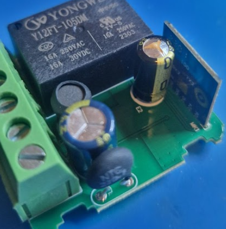

    I already have another socket from this series of clones in which, after some time (a few months) of continuous operation, the current measurement results began to jump even despite recalibration.
    In the case of no actual consumption, they are 0-20W and with a 72W bulb, for example, they are 50-90W.
    CB2S
    BL0937
    capacitors are not swollen
    I did an update to the latest version of the OBK but this did not change anything.
    What could be the cause?

    Either you have enabled PowerSave 1 which spoils the accuracy of the interrupt counts on BL0937, or the capacitors, however.
    Just recently @DeDaMrAz and I had a similar problem:

    I immediately made sure I had Powersave 0 and re-summoned this command but it didn't change anything.
    In my case there are no signs on the capacitors.

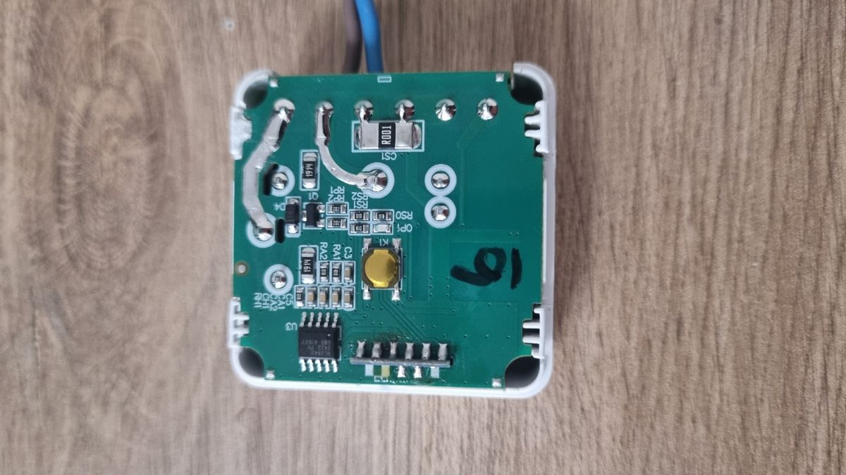

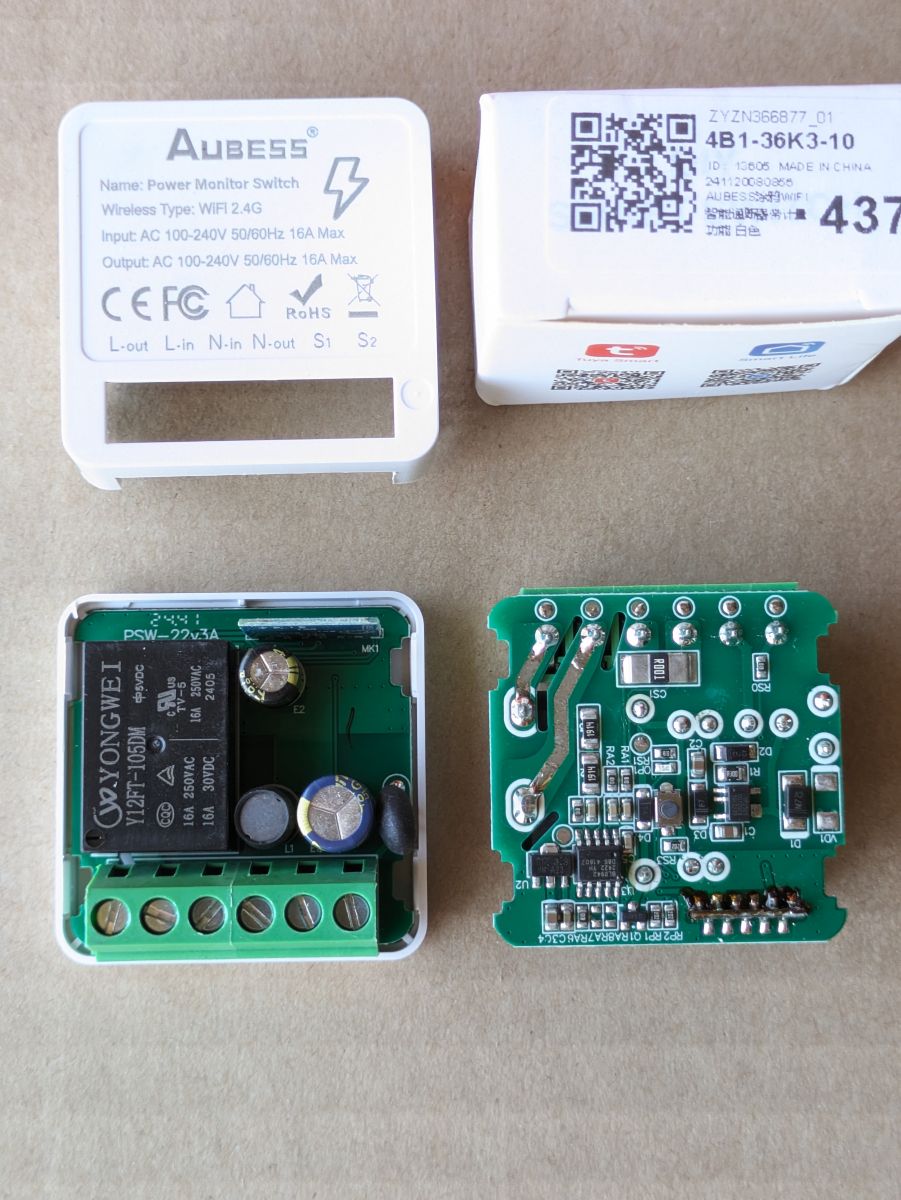

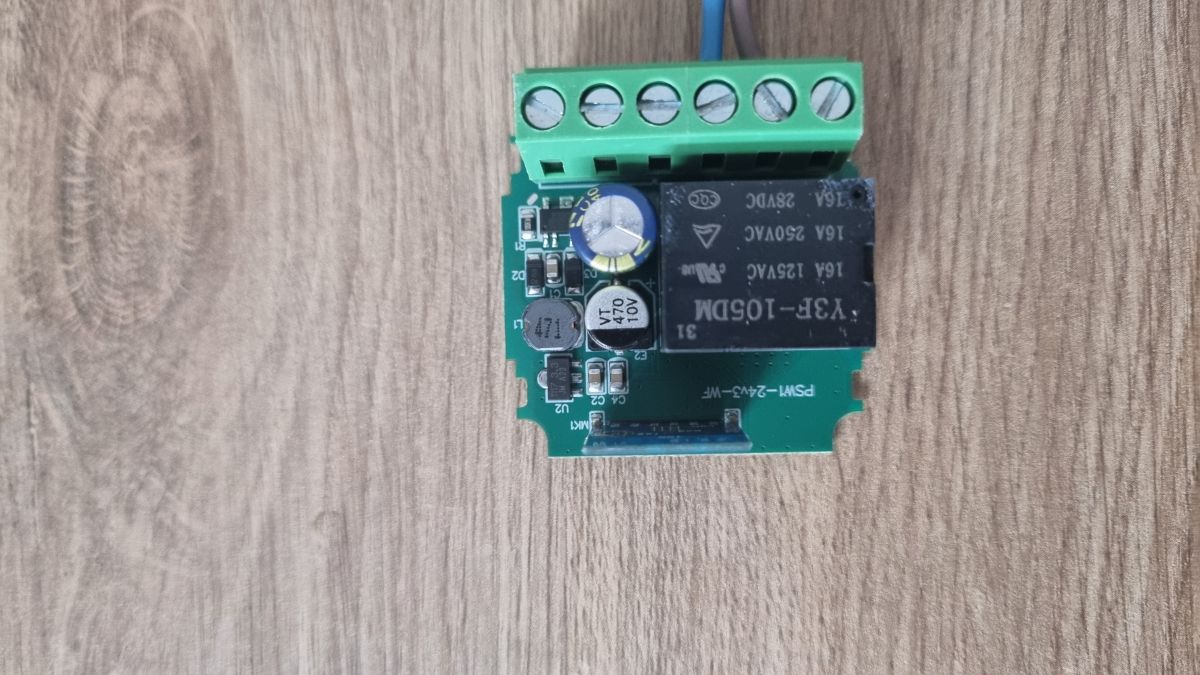

    #339 21484937

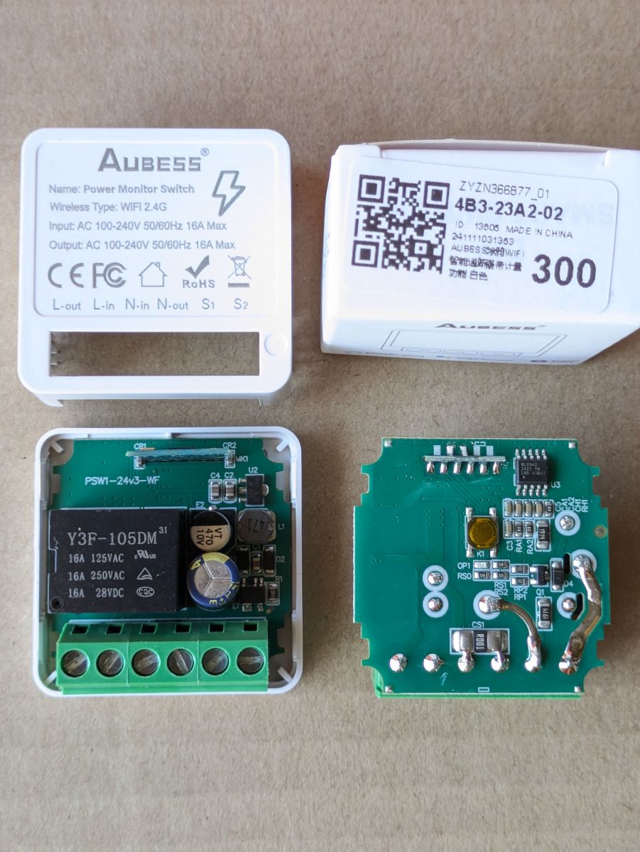

    badboy3004
    Posts: 19
    I`m new here at the forum.

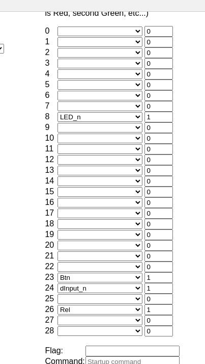

    I have a problem with this switch:
    Electronic module Power Monitor Switch with AUBESS label.
    Pin 8: LED_n on channel 1
    Pin 23: Btn on channel 1
    Pin 24: TglChanOnTgl on channel 1
    Pin 26: Rel on channel 1
    If I set the Pin24 to TglChanOnTgl than the switch is switching randomly on and off. As you can see at the MQTT messages. But I can´t figerout why it is doing this.
    User interface of an electronic application displaying device status information.
    Active flags are:
    2, 6, 10, 21, 27, 38, 40, 44,
    The BL0942 and Powersave 0 is seted.

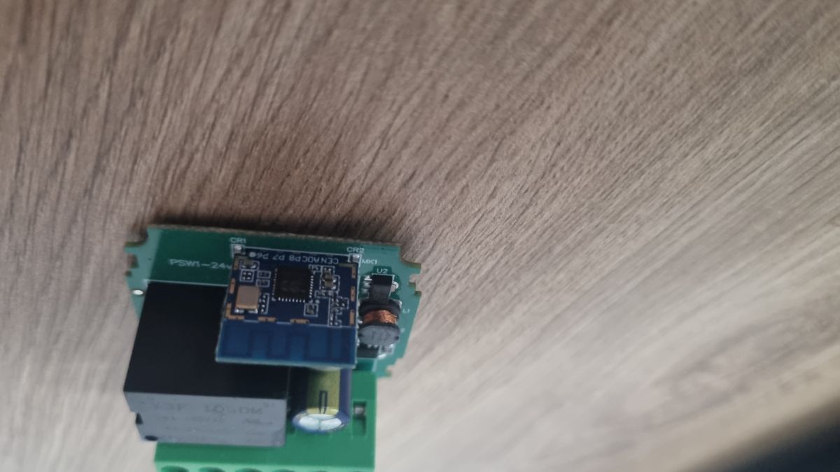

    As you can see something is triggering the button. But the switch is on my table and no body touched it.
    Can sobody tell me what´s going on?
    Thank you.

    Probably a known issue: https://www.elektroda.com/rtvforum/topic4027953.html]
    but the strange thing is that:
    Info:GEN:23 Button_OnLongPressHold
    Is btn on P23 working? Can you do Tuya config extraction?

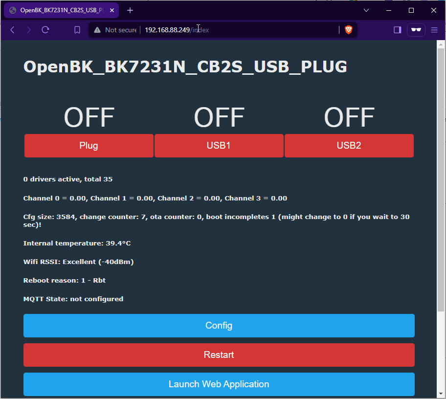

    handy gif!
    Web interface displaying OpenBK device status information.
  • #343 21487532
    badboy3004
    Posts: 19
    Hello @All,
    I made two Tuya dumps of two switches.
    All Buttons are working. If you press it or through the browser or acting in homeassistant.
    They switch off randomly.
    Do you have an idee why i can´t use TglChanOnTgl?
    Thanks for helping.
    • BK7231N_TuyaConfig_Licht_Eltern.bin (72 KB) You must be logged in to download this attachment.
    • BK7231N_TuyaConfig_Herd_L2.bin (72 KB) You must be logged in to download this attachment.

  • Questioning whether P24 pin mapping is wrong
    #347 21495708
    badboy3004
    Posts: 19
    my device is different as you can see. All components are present.
    Printed circuit board with electronic components on a wooden background.
    Close-up of a green printed circuit board with electronic components on a wooden surface.
    Electronic module with components on a wooden background
    Yesterday I installed ESPhome on one switch. And it has still this glitches.
    Maybe the P24 Pin is wrong. How can I test it? Just try and error.
    Thanks.
  • Use dInput_n instead of TglChanOnTgl
    #348 21496005
    rufus4
    Posts: 65
    Rate: 9
    try to set
        "8": "LED_n;0",
        "23": "Btn;0",
        "24": "dInput_n;0",
        "26": "Rel;0"
    for me it seems to work without unexpected behaviors.
    edit:
    just tested TglChanOnTgl. this is absolutely not working like it should! So go for dInput_n.
    ps:
    this device has no template on the device-list yet. how to get this done? does somebody need to open a topic with this device?
  • #349 21496049
    badboy3004
    Posts: 19
    Hello rufus4,
    for the switch it worked now.
    Thank you very much.
    I will see how stable the configuration now is.
    But so far it seems working fine now.
    Thanks again.
  • #351 21496098
    badboy3004
    Posts: 19
    On my device all action is happening on channel 1.
    Thanks.

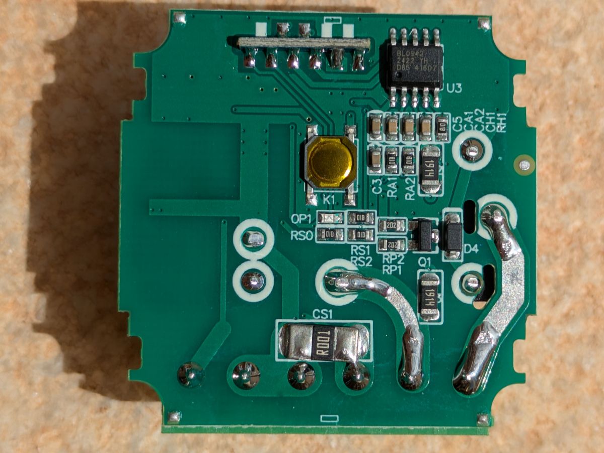

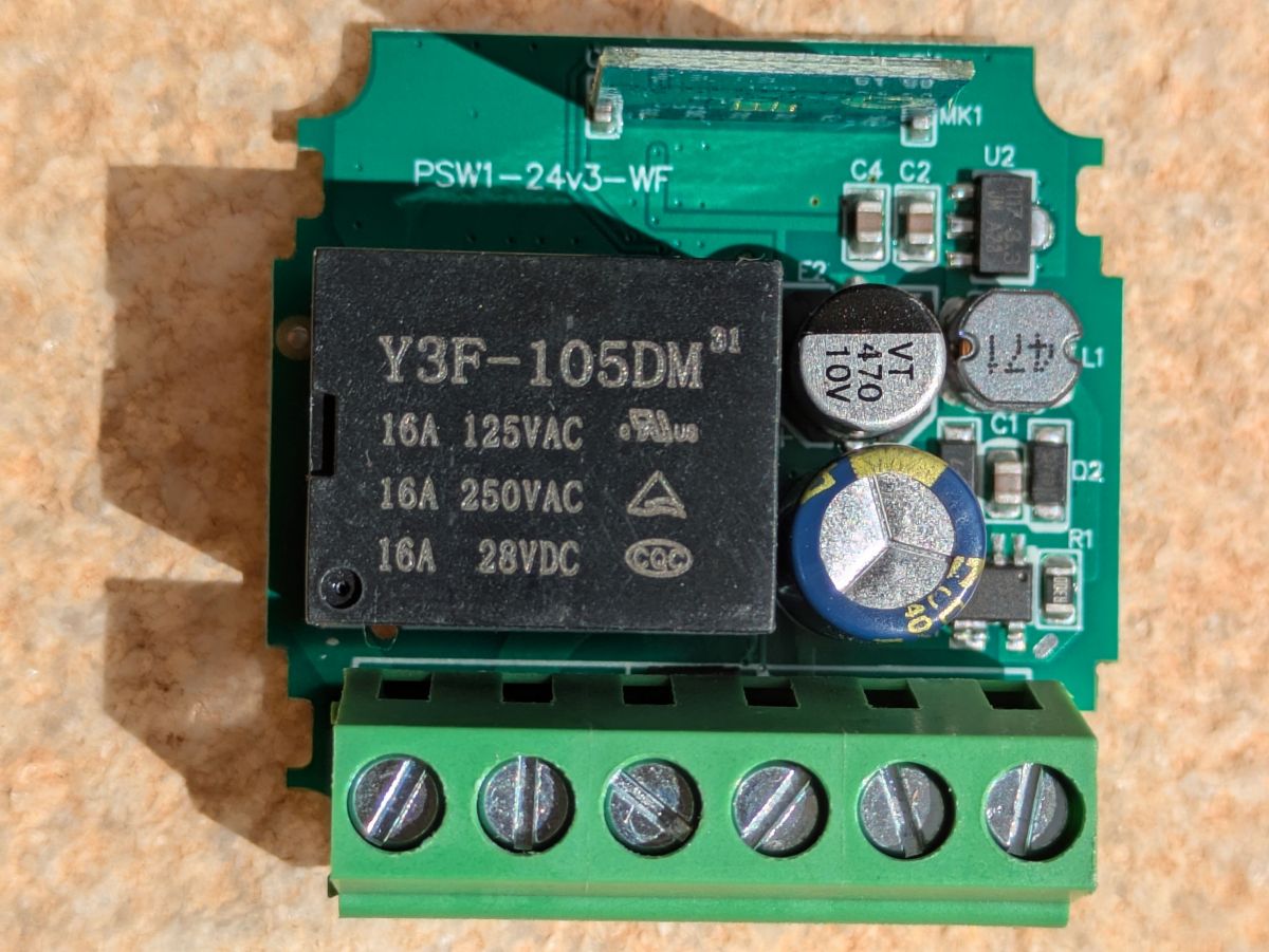

  • Questioning channel 0 vs 1 in the template
    #353 21496115
    rufus4
    Posts: 65
    Rate: 9
    >>21496085 thanks @divadiow
    template is correct as far. all pins on the same channel. but the picture you linked is a other model with different pcb.
    see the ones from @badboy3004 or these:
    Close-up of an electronic module with a Y3F-105DM relay and circuit components.
    Printed circuit board with various electronic components.
    Added after 5 [minutes]:
    may I ask what will be the difference if it is channel 0 or 1, if everything is on one channel? (my template works with channel 0)
  • #354 21496128
    Posts: 5121
    Help: 441
    Rate: 904
    ok thanks. changed to the top one you posted. still Aubess branded device?
  • #355 21496133
    Posts: 14677
    Help: 656
    Rate: 12703
    Choice between channel 0 and 1 for single relay device is purely cosmetic, no functionality changes here. Just do not confuse channel numbers within single device, if you set button to channel 1 and relay to channel 0, then this button will not control this relay.
  • Both Aubess versions work with same template
    #357 21496141
    rufus4
    Posts: 65
    Rate: 9
    >>21496128 yes, still same Aubess. they sell two different versions as same product. caseshell is the same. both come with CB2S board. (naked without emi shield)
    please wait, I make better fotos
    thanks for clarification @p.kaczmarek2
    Added after 49 [minutes]:
    okay, the fotos are not better but more informative. both are AUBESS ID:13605
    just checked if both hardware versions working with the same configuration. and they do work with the same template/settings.
    AUBESS power monitoring switch module with visible interior and casing.
    Disassembled Aubess power monitoring switch showing the casing and circuit boards.
