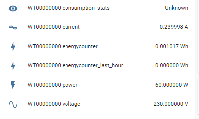

    The discussion about new devices with BL0942 not receiving any data (while my old LSPA9 still works - probably a different connection on PCB is the issue) has been moved here:
    OpenBeken - new BL0942 device is not receiving any data from energy meter
    Those new devices are not even in LSPA9 form, so let's keep it in the separate topic so people can google the issue. Thanks!

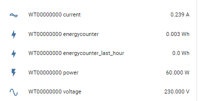

    Posts: 18
    kokskrustnagla wrote:
    I am new in this project. I need some information. I flash 2 devices BK7231N CB2S Model: 4B2-39G1-01 ZN366877_01 with openbk7231N_1.15.452. But one of this device did not shows total consumption. In the front page I se Total consumption=inf Wh.
    I try to reset, calibrate the voltage but nothing change. Below I added photo. Maybe You have some solution for that.

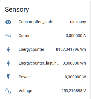

    Best regards Tuya LSPA9 smart socket - teardown, OpenBeken flashing guide for CB2S, BL0942
    I too use same socket, but variable "energycounter_last_hour" is 0 and not change, please tell something
  • #93 20548059
    Posts: 14758
    Rate: 12886
    Hello @mminkov , do you have NTP running? Do you have energy stats enabled?
    Here is an example short startup command for BL0942 socket:
    backlog startDriver BL0942; SetupEnergyStats 1 30 120 1; startDriver NTP; ntp_timeZoneOfs 1

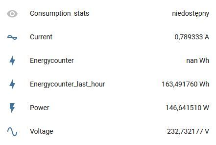

    After programming and connecting, it shows
    Energy Total per kWh
    in the nest tab and in HA
    Tuya LSPA9 smart socket - teardown, OpenBeken flashing guide for CB2S, BL0942 Tuya LSPA9 smart socket - teardown, OpenBeken flashing guide for CB2S, BL0942
  • #95 20552079
    Posts: 14758
    Rate: 12886
    The topic has already been discussed, you can clear the counter:
    EnergyCntReset
    Let me know if it helped.
  • #96 20552154
    Nargo
    Posts: 495
    Help: 45
    Rate: 206
    Thanks. Works.
    I didn't read the thread properly.

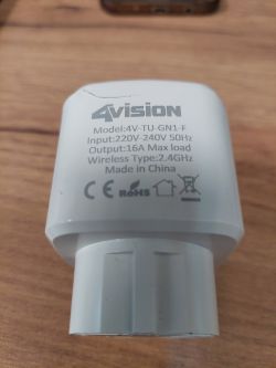

    piratee
    Posts: 69

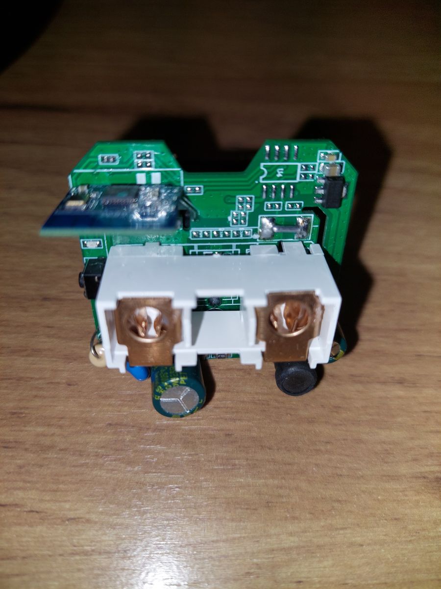

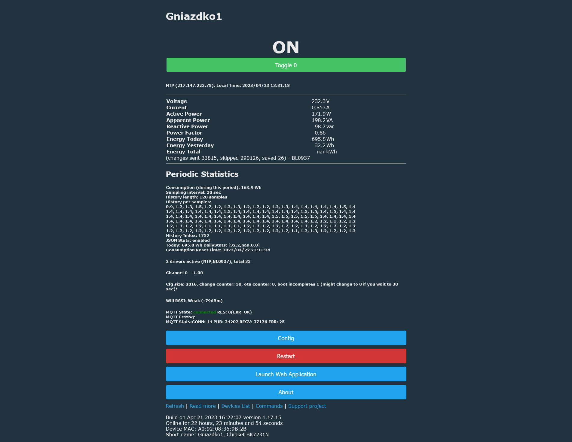

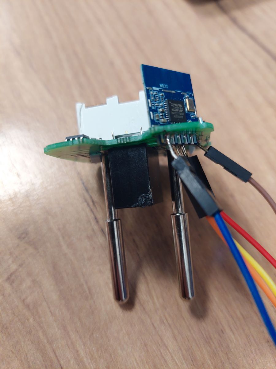

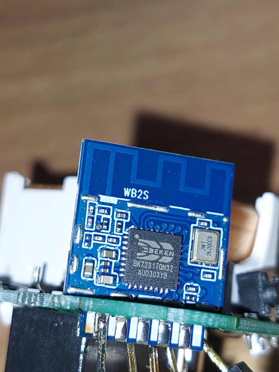

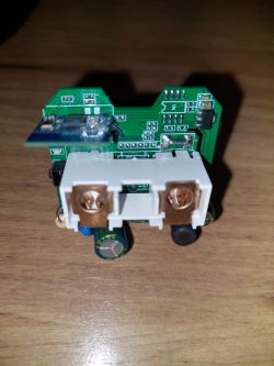

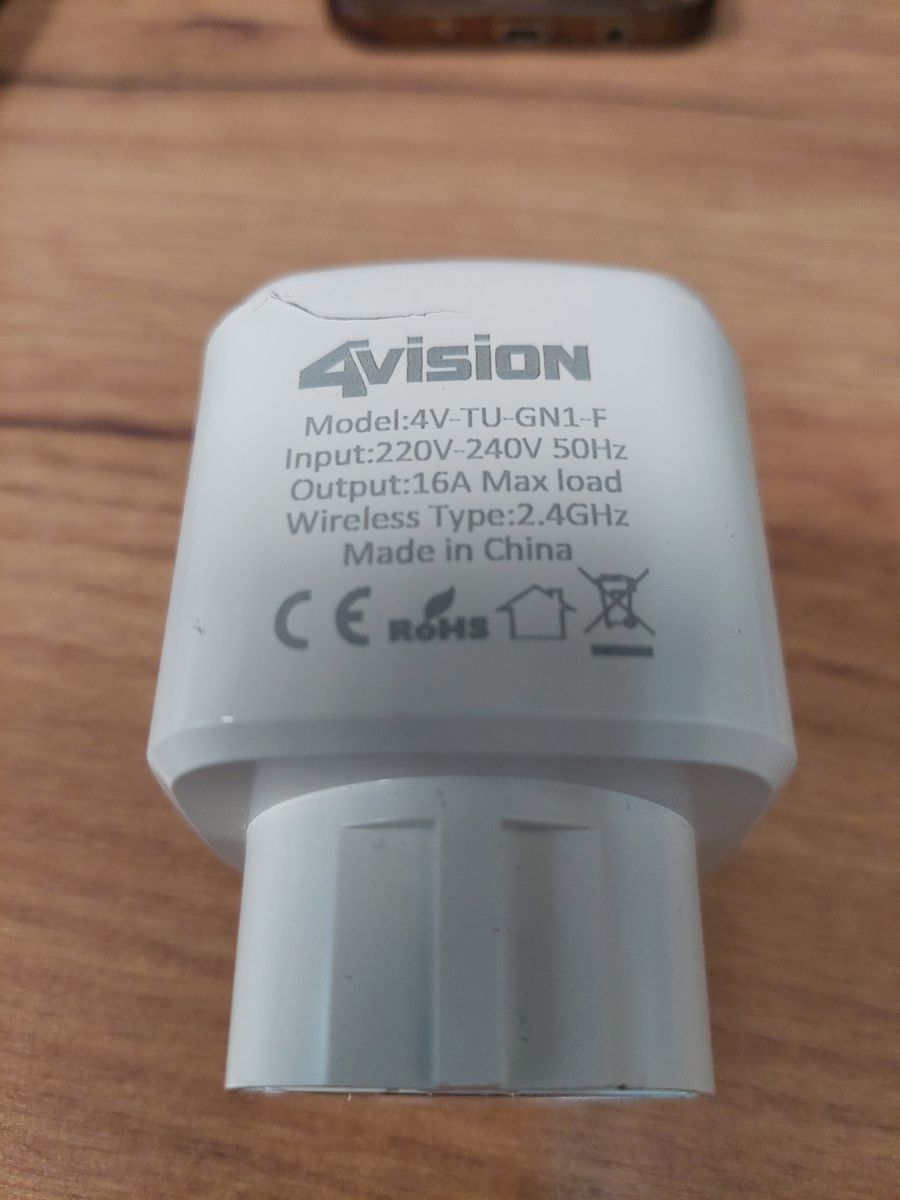

    I am converting my friend's socket to WB2S and measuring energy.
    4vision socket Model 4V-TU-GN1-F
    Energy measurement BL0937
    I can't find a thread in Polish with this chip.
    Firmware read in the connector.
    • readResult_BK7231T_QIO_2023-25-4--08-28-33.bin (2 MB) You must be logged in to download this attachment.
  • BL0937 pin mapping needs verification
    #98 20554515
    Posts: 14758
    Rate: 12886
    Hello, please post a picture of this device.
    Here is the OBK template (Web App -> Import and paste it there, then accept):
    Verbal description:
    - Relay (channel 1) on P26
    - WiFi LED on P6
    - Button (channel 1) on P10
    - BL0937 ELE on P7
    - BL0937 VI on P8
    - BL0937 SEL on P24
    Check if it works, because I'm not sure if I have swapped pins of BL0937.

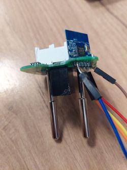

  • Direct VCC, GND, RX and TX flashing works
    #99 20554529
    piratee
    Posts: 69
    I will add that you do not need to desolder the chip plate, just connect to VCC, GND RX and TX.
    Photos Tuya LSPA9 smart socket - teardown, OpenBeken flashing guide for CB2S, BL0942 Tuya LSPA9 smart socket - teardown, OpenBeken flashing guide for CB2S, BL0942 Tuya LSPA9 smart socket - teardown, OpenBeken flashing guide for CB2S, BL0942 [img-3] [img-4] Tuya LSPA9 smart socket - teardown, OpenBeken flashing guide for CB2S, BL0942 [img-6]
    Added after 26 [minutes]:
    When confirming the configuration, I get a message
    Switching on the relay from the button and it works programmatically, I'm checking the measurement right now
    edit:
    Energy measurement is working properly.
    Thank you for your help.
    Build on Apr 25 2023 08:12:33 version 1.17.47
    script execution log:
    Send started... send 0/12... send 1/12... send 2/12... send 3/12... send 4/12... send 5/12... send 6/ 12... send 7/12... send 8/12... send 9/12... send 10/12...FAILED! Invalid command "StartupCommand".

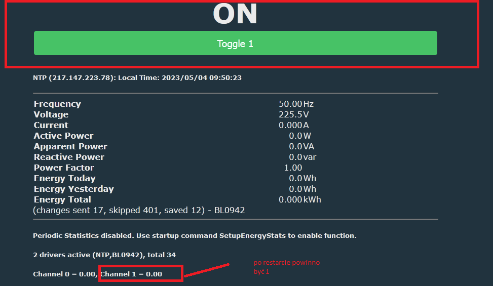

    2. can it be done programmatically so that if we click from the "Restart" application, it does not disconnect and connect the relay?
  • #103 20557270
    Posts: 14758
    Rate: 12886
    In every possible menu, would you like undo at the top? Only in options? And where/how exactly?
    It is rather impossible for the reboot not to disconnect the relay, unless even in the case of the option with state memory, and such a short moment when the firmware starts up is long enough that the relay loses power for a moment and opens.

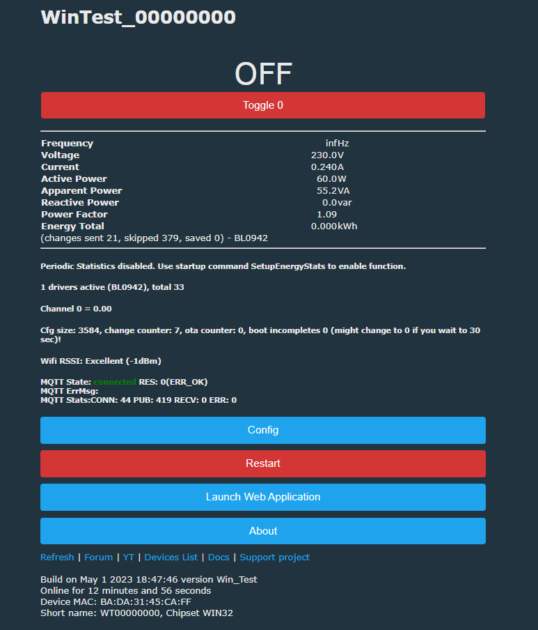

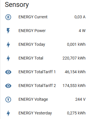

    I would like to add a new command to change the display in the GUI and sending the precision of the results via MQTT:
    Voltage 253.2V
    Current 0.000A
    Active Power 0.0W
    Apparent Power 0.0VA
    Reactive Power 0.0 var
    PowerFactor 1.00
    Energy Today 0.0 Wh
    Energy Yesterday 0.2 Wh
    Energy Total 8.197 kWh
    so that instead of giving the energy consumed in Wh, it can be immediately converted into kWh with one decimal place.
    This is dictated by the fact that other smart sockets that I have on ESP from Tasmot always send in kWh and I have universal automations to many sockets in Node-red calculated per kWh.
    It would also be helpful to limit/round the results to e.g. 1 decimal place - because accuracy to 6 decimal places is not so necessary :)
    Thanks

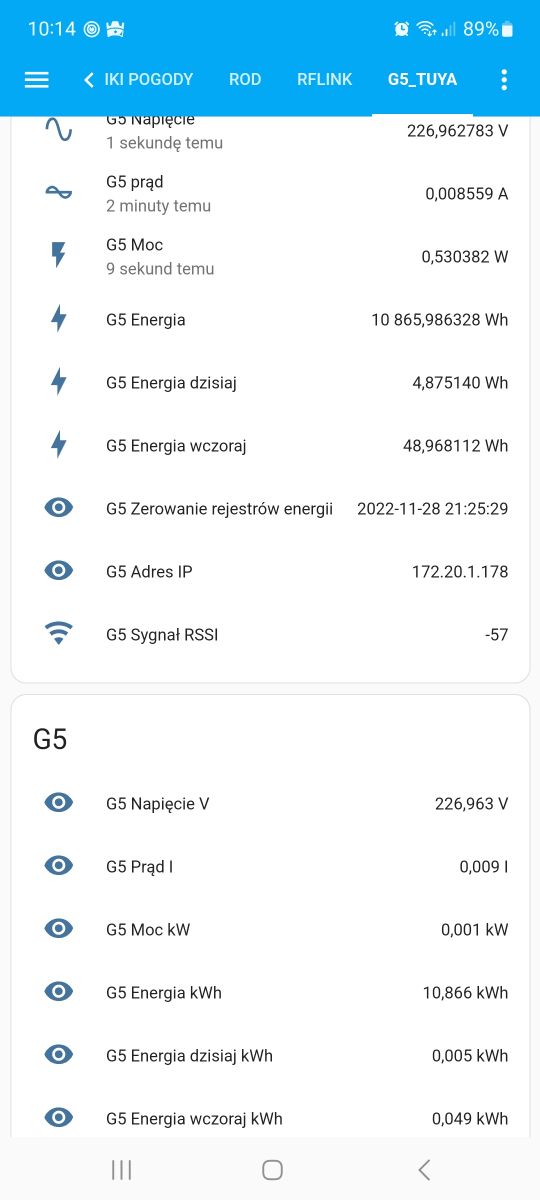

    I would not like to create new sensors using a template, so it would be useful to set the precision at the OpenBeken level
  • Home Assistant value_template rounding to 3 places
    #113 20562546
    Posts: 14758
    Rate: 12886

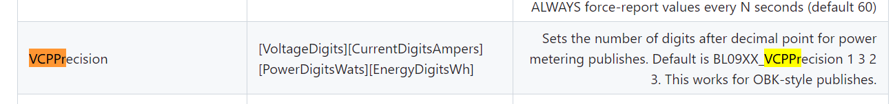

    Thanks
    I can very easily add this to you from the built-in Home Assistant Discovery:
    val_tpl {{ float(value)|round(3) }}
    This is the value_template for Home Assistant rounded to 3 places, I haven't checked how well it works yet, but maybe it would work?
    Of course, there is also the question of how many places we round up to. It's best to choose the number of seats rigidly, it's the easiest way.

    I have this template for this socket:
    Of course, the name G5 and unique are by. my needs
    Templates:
    - sensor:
    - name: "G5 Energy kWh"
    unique_id: "temp_1"
    unit_of_measurement: "kWh"
    state: "{{ ( states('sensor.g5_energy' ) | float / 1000 ) | round(3) }}"
    - sensor:
    - name: "G5 Energy today kWh"
    unique_id: "temp_2"
    state: "{{ ( states('sensor.g5_energy_today' ) | float / 1000 ) | round(3) }}"
    - sensor:
    - name: "G5 Energy yesterday kWh"
    unique_id: "temp_3"
    state: "{{ ( states('sensor.g5_energy_1h' ) | float / 1000 ) | round(3) }}"
    - sensor:
    - name: "G5 Power kW"
    unique_id: "temp_4"
    unit_of_measurement: "kW"
    state: "{{ ( states('sensor.g5_moc' ) | float / 1000 ) | round(3) }}"
    - sensor:
    - name: "G5 Voltage V"
    unique_id: "temp_5"
    unit_of_measurement: "V"
    state: "{{ states('sensor.g5_voltage' ) | round(3) }}"
    - sensor:
    - name: "G5 Current I"
    unique_id: "temp_6"
    unit_of_measurement: "I"
    state: "{{ states('sensor.g5_prad' ) | round(3) }}"

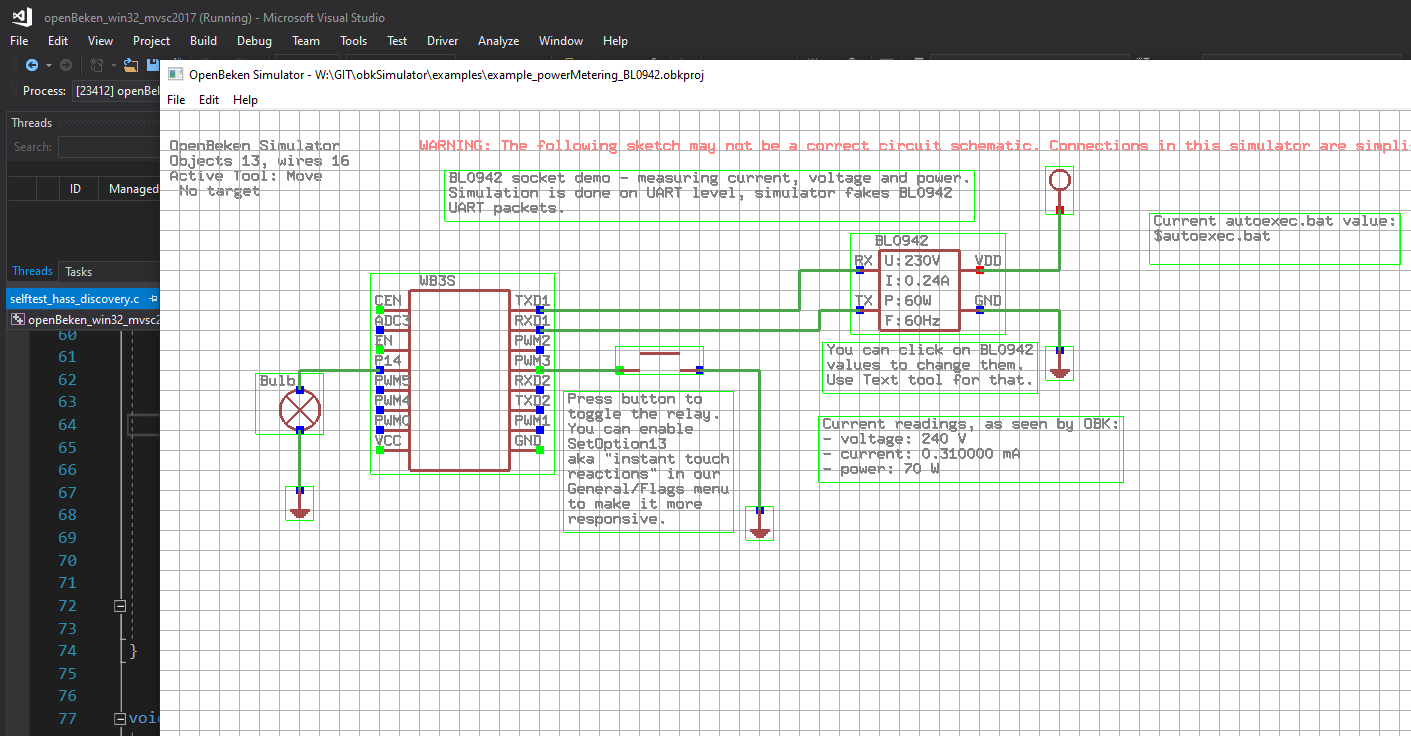

  • Hass discovery for virtual BL0942 socket
    #115 20562802
    Posts: 14758
    Rate: 12886
    I can do exactly the same on the Hass Discovery side of yours and then you will automatically have it. Without writing yaml by hand.
    Only @piratee why always round(3)? Voltage up to 3 decimal places until you need?
    I have a virtual socket here on BL0942, we'll try to work something out:
    This is what it looks like:
    And after changes with an example rounding it looks like this:
    Would such a solution suit you? Ew. for voltage e.g. less decimal places

    all Energycounter entities - kWh unit, to two decimal places
    From what I remember, it sends Tasmota and it is sufficient :)
  • VCPPrecision command adds per-value decimal places
    #118 20563182
    Posts: 14758
    Rate: 12886
    So opinions are divided. I added the VCPPrecision command that allows you to specify how many decimal places there are for different values separately, along with the default setting:
    I can't rather change the OBK publishes from Wh to kWh at the very level. This would break current users' systems. Ew. I could add to Discovery the ability to change the unit with a flag or something similar.

  • Relay state resets to 0.0 after reboot
    #120 20565858
    piratee
    Posts: 69
    When the change with the number of digits after the decimal point will be introduced (I am asking out of curiosity), I have a free mini switch with measurement - I can test on it
    Is it possible to change the time of data publication after mqtt - I can't find it?
    I noticed one more thing that after reboot the state of "channel"=1 is 0.0 instead of 1
    Build on May 1 2023 06:08:19 version 1.17.77
    When I turn it on and off it does 1.
    Restart misreads the state of the relay.
