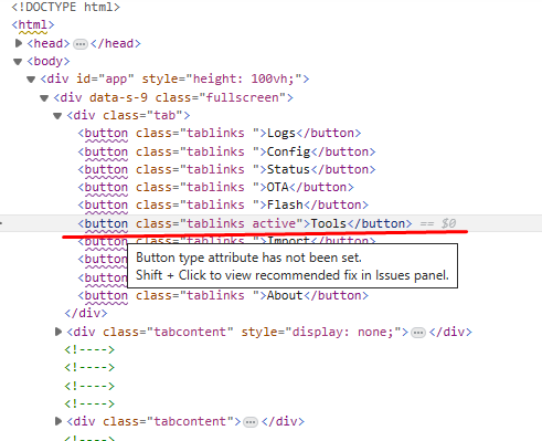

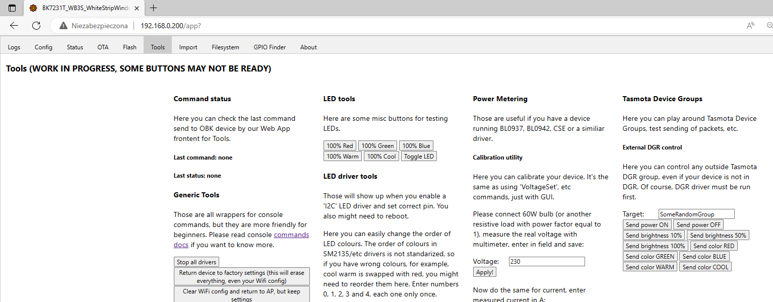

    Don't have the tools tab? What browsers did you check on?
    Tuya LSPA9 smart socket - teardown, OpenBeken flashing guide for CB2S, BL0942
    And in the source of the page, in HTML, it is not there either?

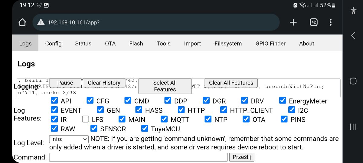

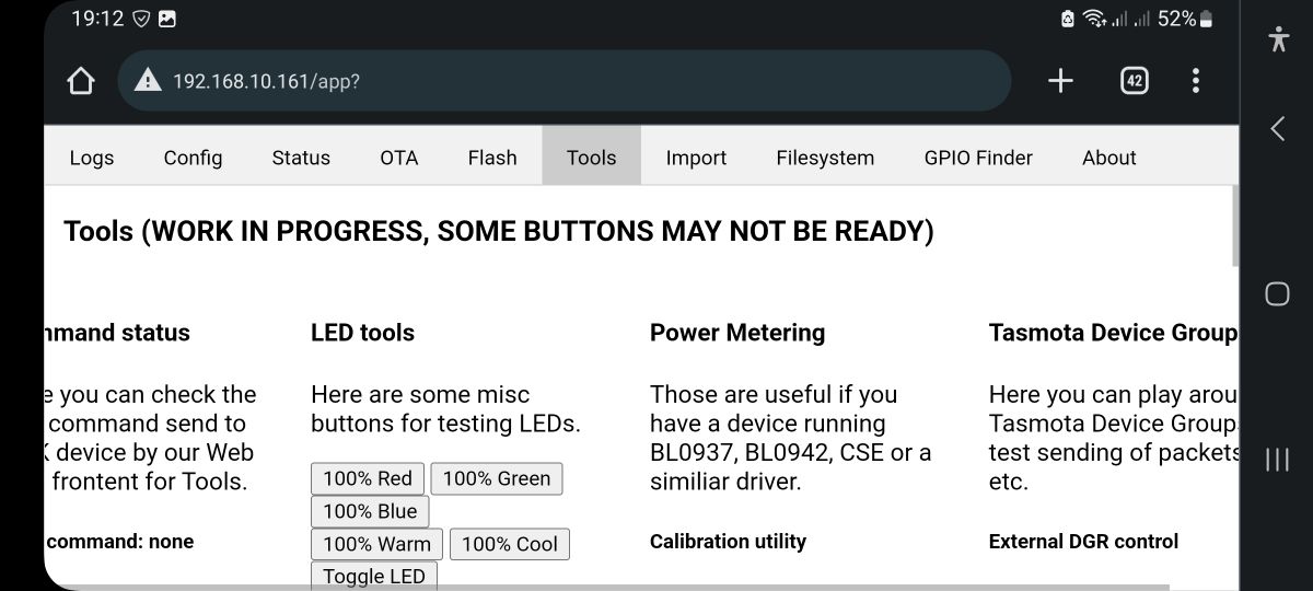

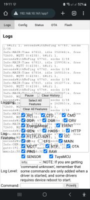

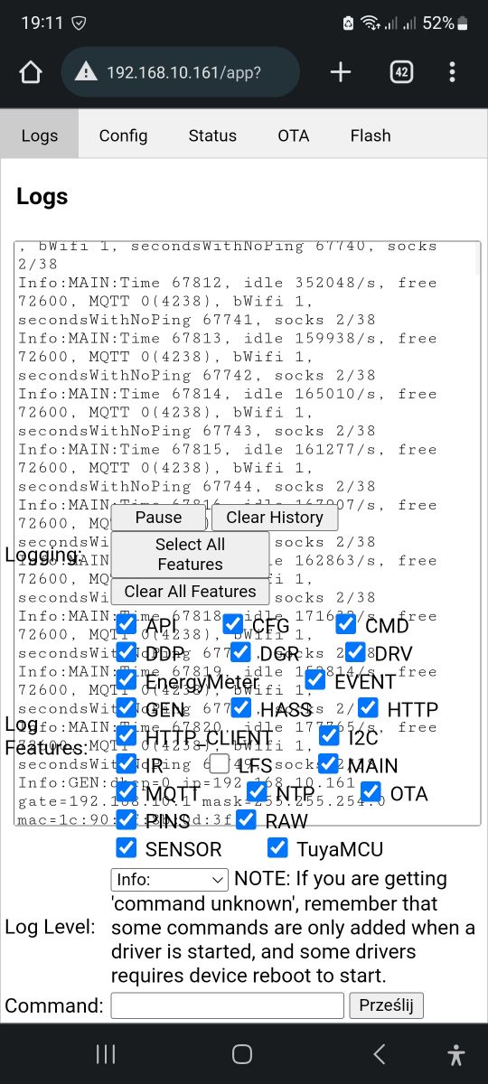

    I'm using Chrome for Android.
    I checked that there are only a few tabs in portrait mode (the rest don't show, swiping won't do anything). The Logs tab as you can see is terribly messed up, but the others (the ones visible) display fine
    However, in landscape mode, the other cards are shown but the cards
    Logs - mixed
    Config, Tools - texts on the left side are truncated
    Tuya LSPA9 smart socket - teardown, OpenBeken flashing guide for CB2S, BL0942 Tuya LSPA9 smart socket - teardown, OpenBeken flashing guide for CB2S, BL0942
    The WLED software for ESP8266 has a nice solution for matching the page to mobile browsers - what is visible in the columns on the computer is adjusted in the form of one column on the phone.

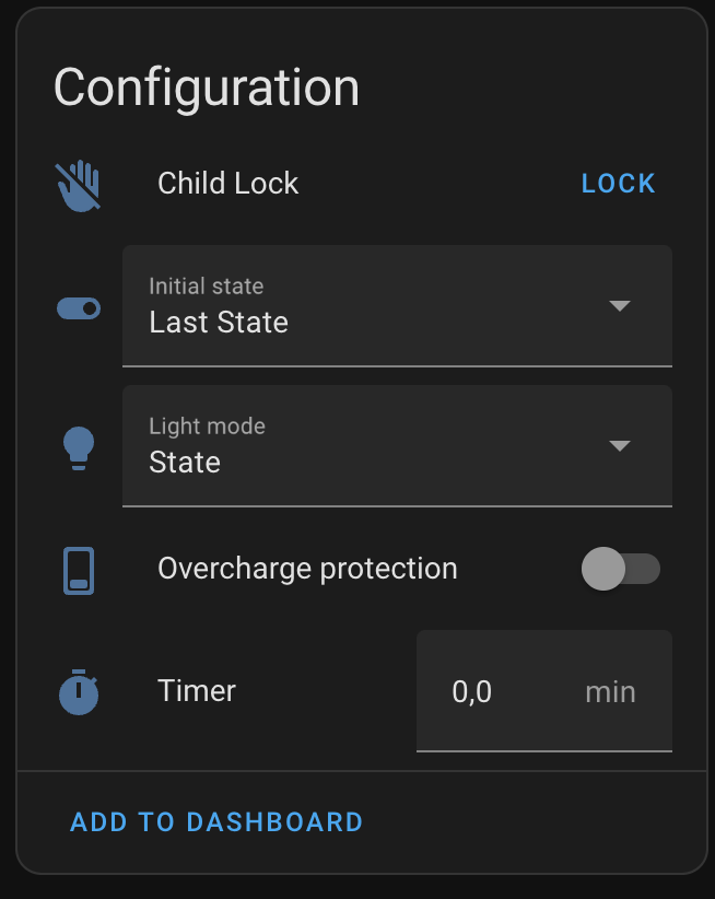

  • #180 20628705
    rakalexei
    Posts: 21
    @p.kaczmarek2 Hey, how can we add these to HA? At least the timer is nice to have.
