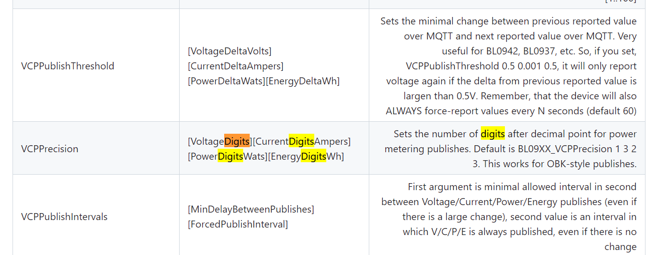

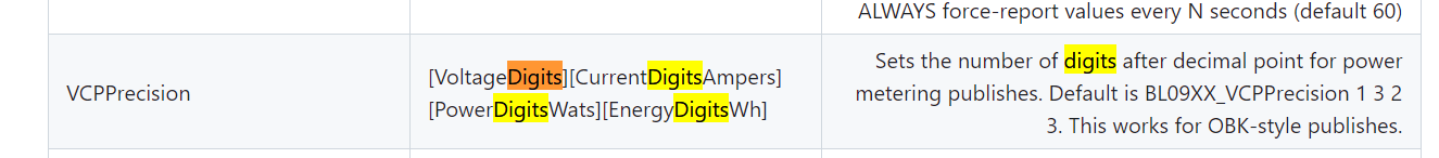

    piratee wrote:
    When the change with the number of digits after the decimal point will be introduced (I am asking out of curiosity), I have a free mini switch with measurement - I can test on it
    Everything is uploaded on a regular basis, the command:
    Tuya LSPA9 smart socket - teardown, OpenBeken flashing guide for CB2S, BL0942
    should be in the last build. can you test?
    I try to test myself and @DeDaMrAz helps a lot lately, and I also write self-tests, but still, there can be mistakes.

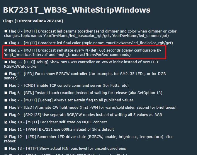

    piratee wrote:
    Is it possible to change the time of data publication after mqtt - I can't find it?

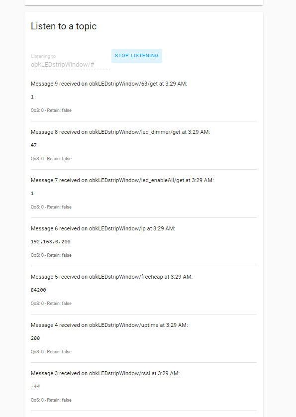

    Which data? There are commands for that, separately for Tasmota-style TELE and for regular publishes.

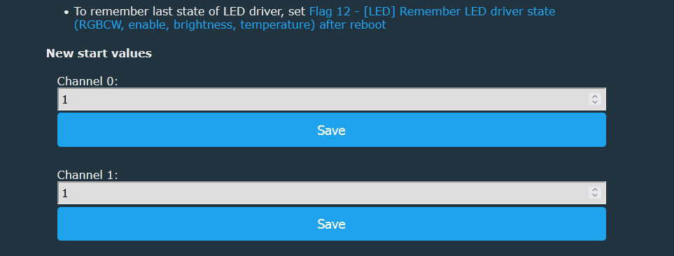

    piratee wrote:
    I noticed one more thing that after reboot the state of "channel"=1 is 0.0 instead of 1
    Build on May 1 2023 06:08:19 version 1.17.77
    When I turn it on and off it does 1.
    Restart misreads the state of the relay.
    The relay is disabled by default. Are you using something like "startup value -1", i.e. remembering the previous state?
    I also throw a flag that allows you to turn on energy reporting in kWh instead of Wh. You can also test it and let me know if it's ok. Today I will also be making a tool for easy testing which GPIO has what role.
    I added fields for the second WiFi network, but connecting to it is not programmed yet. For now, these fields do nothing.

    I have enabled 1
    I do not see the kWh flag, and the alternative network is visible for configuration
  • Startup 1 refresh bug fixed for LSPA9

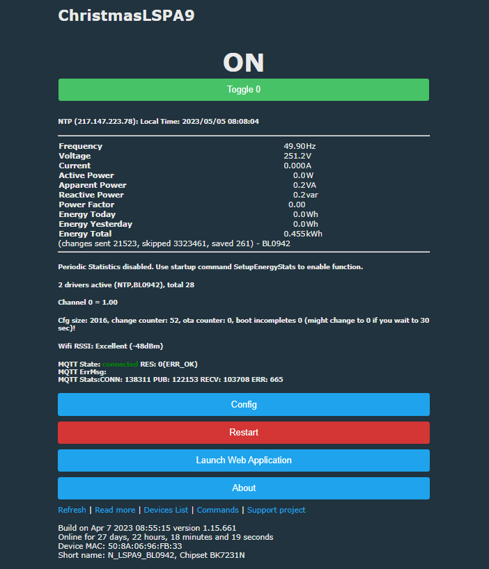

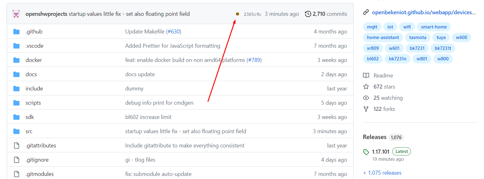

    EDIT: Okay, I'm testing this with Startup 1, on my LSPA9 with a nice uptime of 27 days:
    EDIT2: And that's interesting, you're seriously right, the first refresh shows it wrong:
    I'll check it right away.
    Added after 4 [minutes]:
    EDIT: Oh, now I know why it didn't refresh, I'm uploading a fix and it will be correct from the next build, thanks @piratee

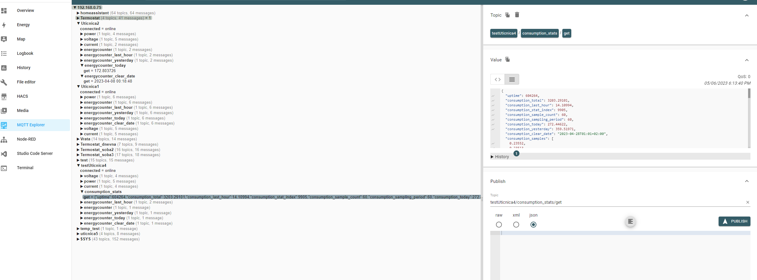

    testing on latest Build on May 1 2023 18:22:57 version 1.17.85
    I don't think it's 101 anymore and it lights up the channel on this one after reboot
    shows in kWh when the flag is lit.
    in MQTTExplorer is
    and on the socket api

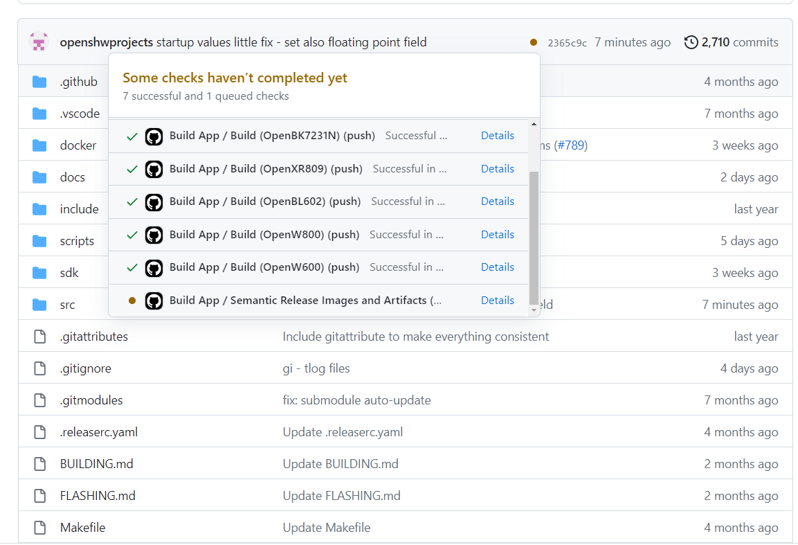

    #125 20567325
    Posts: 14807
    Rate: 12972
    Only the next version, which will appear in a few minutes, will have a fix for displaying the channel with the startup value. Now it still compiles, as evidenced by the "orange ball" at commit:
    Our builds are done automatically online, but you have to wait a few minutes after uploading the patch to receive binary files.
    1.17.102 with the fix will be released soon.
    Just a moment:

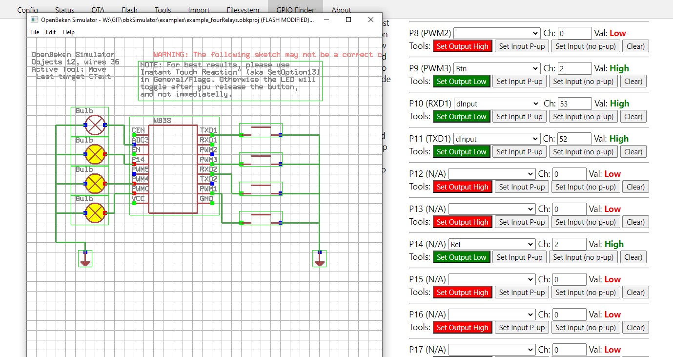

  • GPIO Doctor to quickly identify relay pins

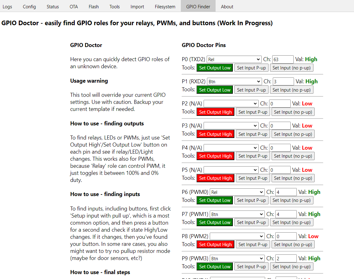

    If you have time, I'm uploading GPIO Doctor in the evening, which allows you to quickly test on which pins the relays are (so as not to search manually):
    You know what it is, right? As the device is fresh after uploading the firmware, you need to look for which GPIO is, for example, a relay, and this tool from the screen will allow you to easily click it without refreshing the page at all.

  • PinDoctor helps identify relay, button, and LED GPIOs

    PinDoctor (or what should I call it?) will require an OBK update, but it works pretty well already:
    Thanks to this tool, you will be able to quickly find GPIOs with a relay and a push-button and an LED (WiFi or regular), again and again testing the pins, also in the title LSPA9, as well as in any other product.
    Are these other recently added things working ok? In case of problems, please report what is wrong.

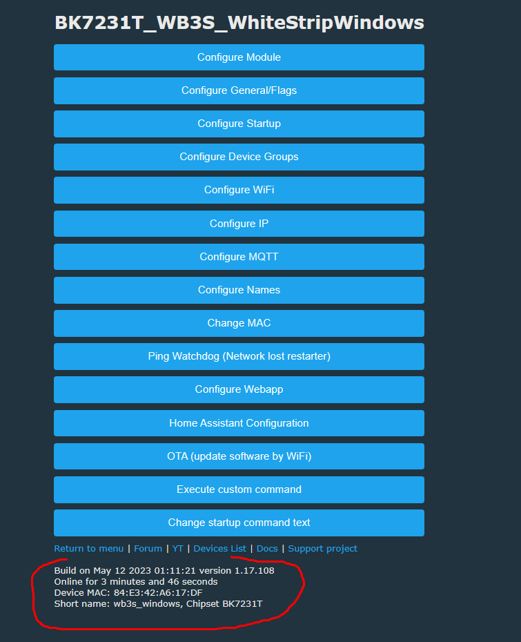

    I fired the version:
    Build on May 5 2023 10:21:44 version 1.17.104
    But somehow I don't really know how to test GPIO Doctor.
    You have to do the settings and look what is happening or will it detect what is connected to the pin?

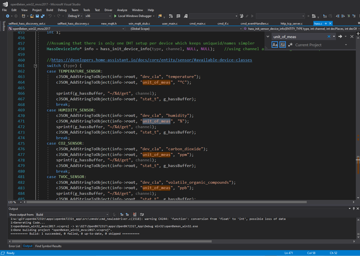

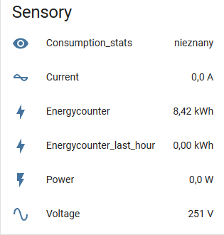

    2. Why is MQTT transmitted
    while Home Assistant Discovery does not create the appropriate entities for this data?
    3. Why is the "consumption_stats" entity created? It still has an unknown state. Maybe I don't know something.
    This is probably the result of cooperation with two contributors who probably did not communicate well and Mr @iprak did not include what @valeklubomir publishes in Discovery ... I will deal with it soon, but it's good that you pay attention.
    It's JSON. There's some data there. This can be enabled/disabled with the SetupEnergyStats command. Here's a screenshot of what it looks like now from the contributor:

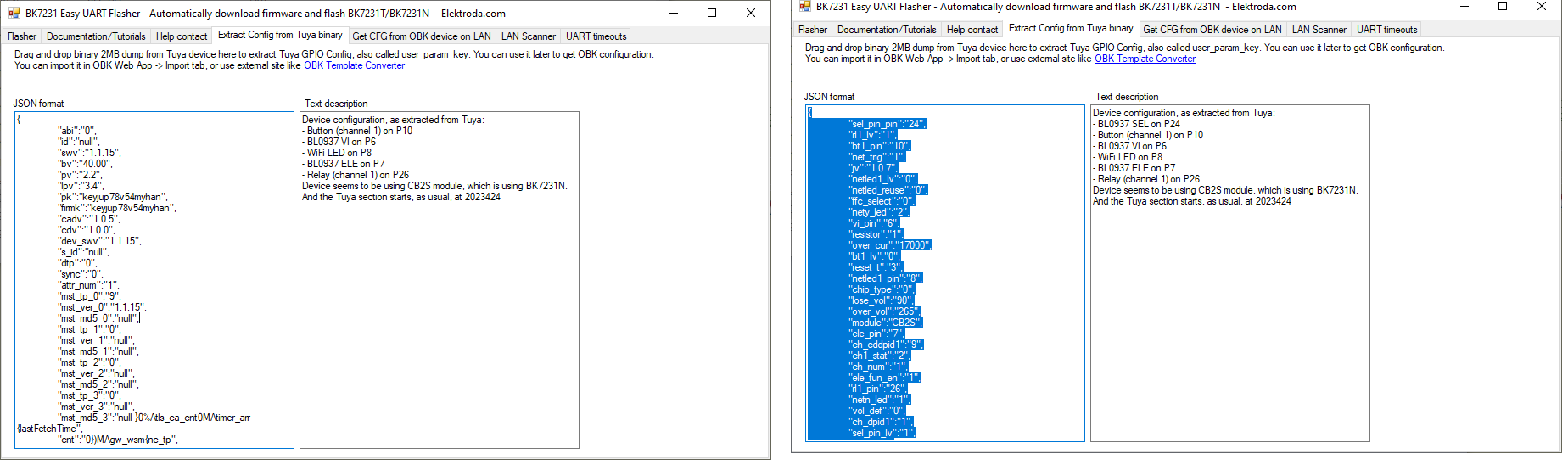

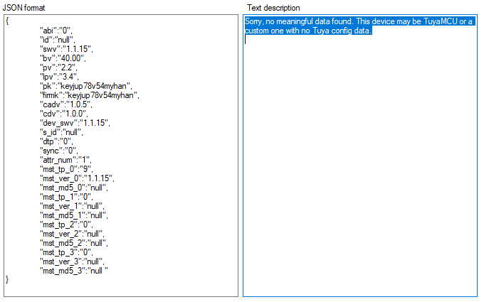

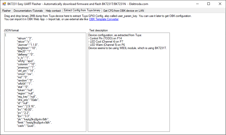

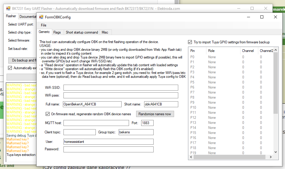

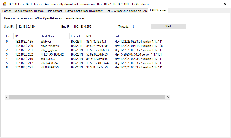

    I got mine too and it was TYWE2S. Here's the report:
    TYWE2S without GPIO0? Alternate pin layout and flashing Tasmot, ESP8285
    Dark Man wrote:
    but again it has a different version of Tuya, which is also not supported, so probably tomorrow, I mean during the day, I will disassemble, program and then I can test "GPIO Doctor" - although in my opinion the name "GPIO Tester" is more suitable.
    I'll think about the name, I'll admit that I saw your post quite late.

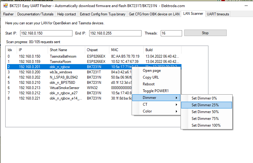

    And now there is a new solution.
    How to download the new flasher from here:

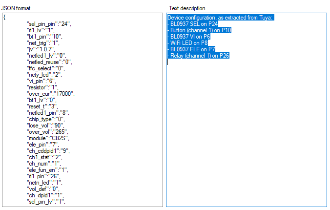

    And before you load the 2MB backup, he can see the Tuya configuration:
    and get the pinout/JSON to paste into Web App:
    Dark Man wrote:
    2 more LSPA9 clones on the way :P from Aliexpress Choice
    Let me know what came, I had no way to order a second one, because I think one per account (or even per IP/system, I don't know how they fingerprint, unless changing the user agent didn't help).
    @piratee also see the new flasher from here: https://github.com/openshwprojects/BK7231GUIFlashTool for simple devices should be able to detect pins by itself and give their list / JSON to be copied to Web App ->Import

  • Flasher now reads Tuya configs and edits OBK settings
    #139 20576831
    Posts: 14807
    Rate: 12972
    Recently, flasher was basically developed, so there are no big firmware updates.
    Flasher can now read various Tuya configurations from a 2MB batch:
    He can also edit the OBK configuration:
    Basically right now flasher can configure GPIO OBK itself while flashing, and can also enter your WiFi into the device, so you don't even need to pair via access point mode all automatically.

    I'm not sure what you mean now, as far as I know OBK doesn't generate any Yaml where is the IP/date of resetting from unit_of_measurement. What you write sounds like a setting that is already fully in your HA, except for OBK. I set unit_of_meas in Discovery only for sensors, unless some error has crept in:
    The Hass Discovery upgrade is planned, but I'm not sure how to do it yet, there are several options:
    - just add all possible entities there as they are, for each, rigidly
    - or give flags like "whether to add IP entity" etc
    - or give the possibility of customization, e.g. by showing the generated discovery yaml to the user before sending it, along with the possibility of editing

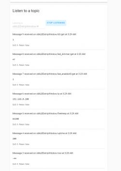

    piratee wrote:
    But do you mean just doing publish or connecting to discovery?
    I just added publish the name of the SSID network for now, Discovery will see later. I think you need to finally give some configuration to this Discovery to enable additional options.
    Yes, I mean just publish
    (whatever publishes Rssi , and IP )
    Hmm, so finally RSSI and IP publishing works for you, or not? Maybe you don't have something enabled? look here:
    This is configurable via mqtt_broadcastInterval, but don't overdo it, don't set it too low.
    Do you mean it's not in Discovery?
    So, if you have any comments, feel free to give them, I will try to help, sooner or later. Today I would like to release a new version of the flasher, and then we'll see.

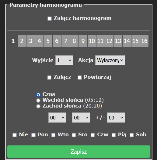

    can you make an on/off schedule on openbeken, e.g. in the socket
  • OpenBeken scripting for scheduled light states
    #145 20577177
    Posts: 14807
    Rate: 12972
    You have functions in the documentation addClockEvent and in the scripts you have the option to check the hour/minute (in case of reboot...), you also have the option to remember the last state. That's enough to make a good schedule.
    https://github.com/openshwprojects/OpenBK7231T_App/blob/main/docs/README.md
    In the example configurations of OpenBeken autoexec.bat there is a bit about this:

    PS: What do you think about adding an option to Flasher to scan the entire network for devices with OBK and automatically backup their configuration to one folder? Such a dump of all OBK from the network. In the 4096 byte format, one CFG sector in the binary file.
    This can be a nice option, ESPHome has a group update from Tasmota Manager, you can also do OTA Update.
  • Web app overlay can generate flash script
    #147 20577211
    Posts: 14807
    Rate: 12972
    The visual overlay can be done in the Web App, so that flash simply generates a script in the background at zero cost, but it's also a job for a day or two.

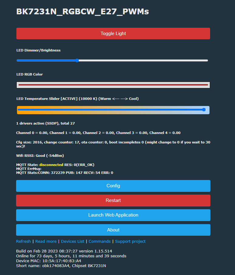

    Added after 4 [hours] 1 [minutes]:
    EDIT: Such a curiosity - uptime 73 days - it's a shame to update some devices, but I need to test something.
    Added after 40 [minutes]:
    EDIT: scanner:

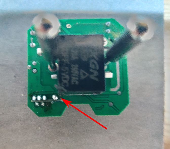

  • Need alternate connection for CB2S P26 relay pin

    brenard
    I recently buy two quite similar devices and flash it with OpenBeken. To flash it, I had to disolder the CB2S board from the main board. I have trouble on one of it two because I broke the pin on the main board matching with the CB2S P26 pin where the relay is normally soldered. Without this pin, I can solder it back and my relay is not working. Anybody have an idea where I could link the P26 pin on the main board to fix my problem ? It's a 5VDC relay so I imagine their is some components between this pin and the relay to convert the 3.3V of the BK to the 5V of the relay.

    Dark Man wrote:
    As for the new BK7231GUIFlashTool, unfortunately, with today's screenshot from the socket with CB2S, it did not manage to extract the pinout:
    Can you send me the binary with it.
    It took a while but please :)
    One file is read correctly and the other is not.
    • readResult_BK7231N_QIO_2023-14-4--00-01-18.bin (2 MB) You must be logged in to download this attachment.
    • gniazdko LSBA9 readResult_BK7231N_QIO_2023-06-5--21-28-00.bin (2 MB) You must be logged in to download this attachment.
    Btw does this Scanner build work for you by IP of devices?
